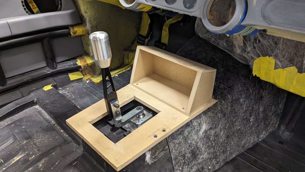

Adjusting the storage compartment.

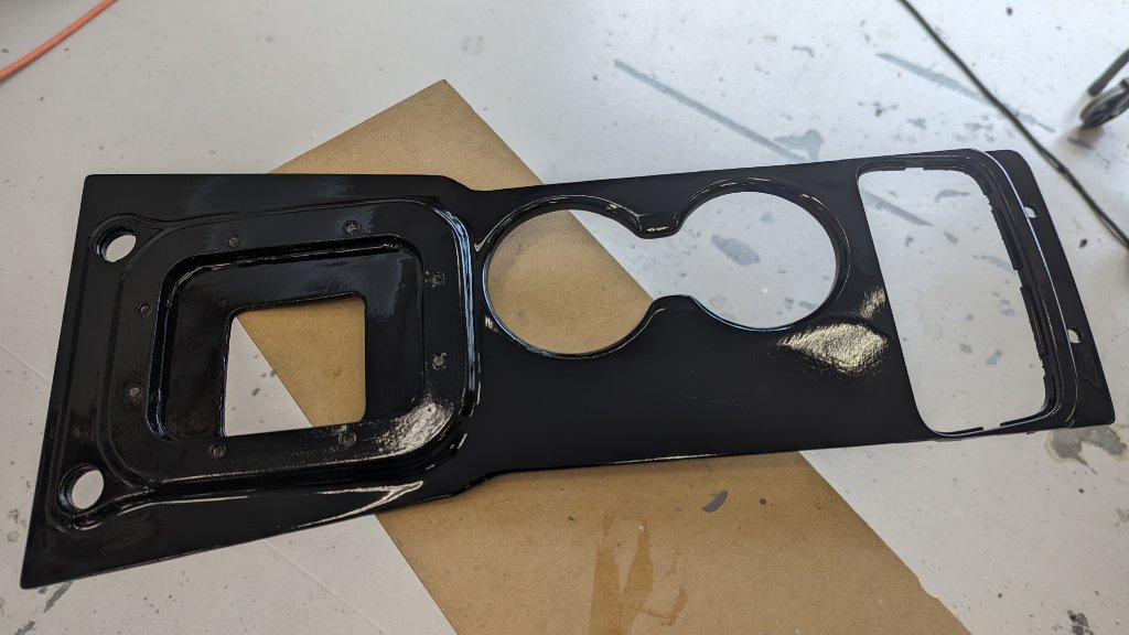

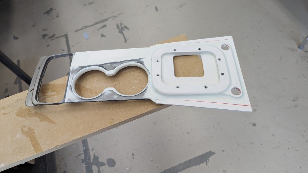

Attachment 80732
Filler doesn't stick great to this soft plastic but good enough to just be a final smooth. Pretty sure I'm going with leather cover here. Like the rest of the interior parts I've built, just trying to give the interior shop a baseline to work with, then let them sprinkle their voodoo on it.

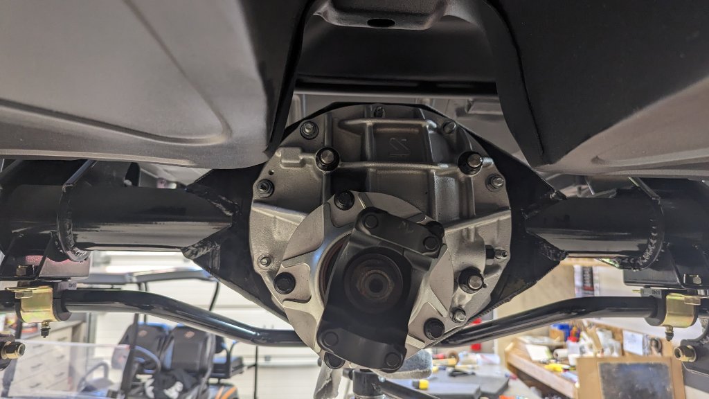

Hung the center section just to measure for the axles.
Attachment 80734

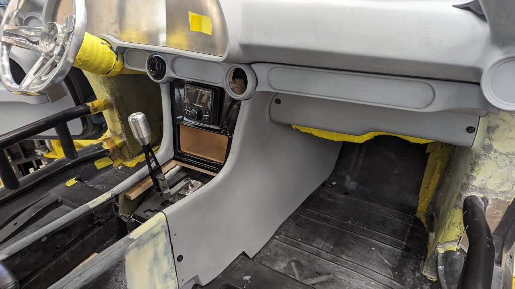

Adding some dimension to the waterfall.
Attachment 81439
Attachment 81440
Attachment 81441
Attachment 81442

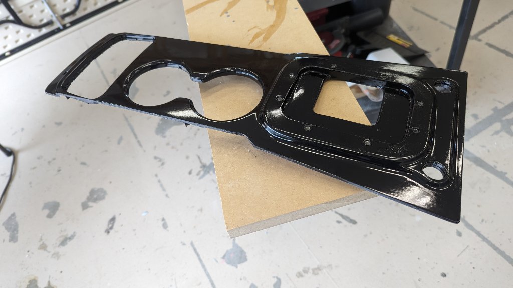

Put down some black epoxy to give the wrap a good surface.
Attachment 81443
Attachment 81444
Had originally planned to do these inserts in carbon fiber but the shapes have tight enough 90's that the only right way to do is make molds and vacuum bag them....going with wrap instead, either carbon look or brushed metal look.
Attachment 81445

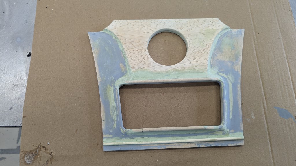

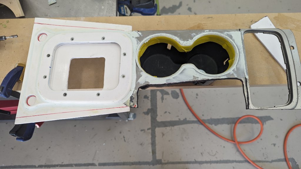

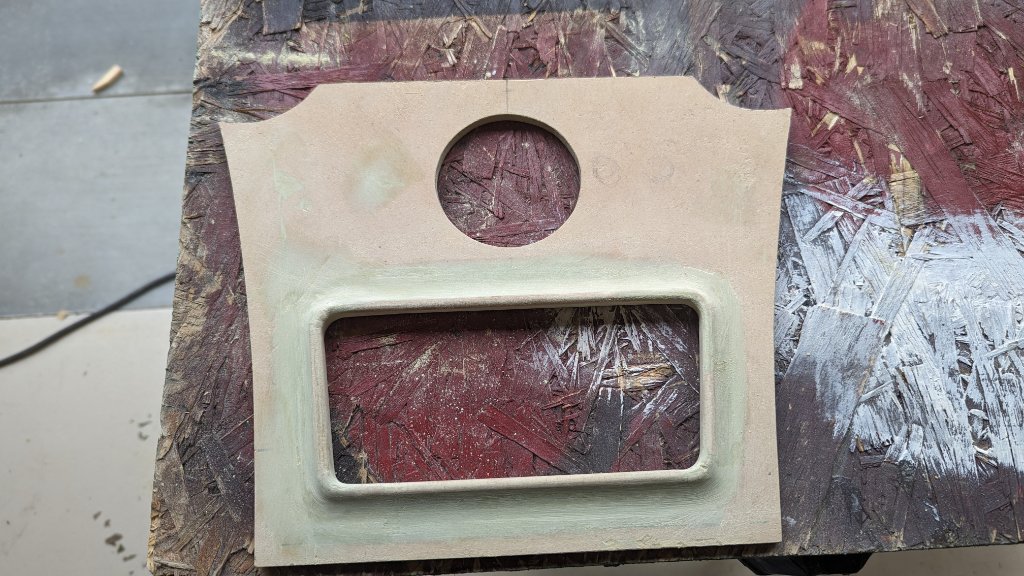

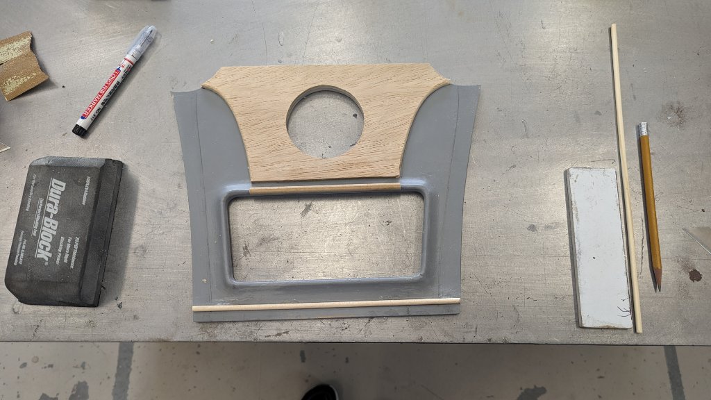

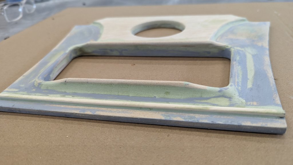

Working out the center console insert.
Attachment 81446
Attachment 81447
Attachment 81448
Attachment 81449
Attachment 81450
