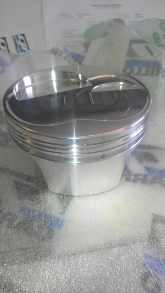

Pistons and rings just came in so all I need is head studs and a cam. Motor vids are a few months away. Have not decided on an injection system, either AEM or Holley. May have a line on a throttle body off of an RO7.
What amazes me is I will be running an LS firing order and we called Comp cams. They have 50mm, SB2 cam blanks with an LS firing order sitting on the shelf. Just need to come up with specs to have it ground.
http://i1138.photobucket.com/albums/...psda1ysj0p.jpg

It is going to be on the edge for sure. Pistons were made with the wrong pin height, not our fault, so they are making a new set. 6 to 8 weeks which translates into 3 to 4 months.

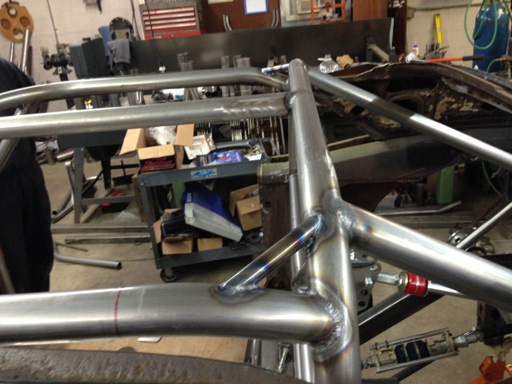

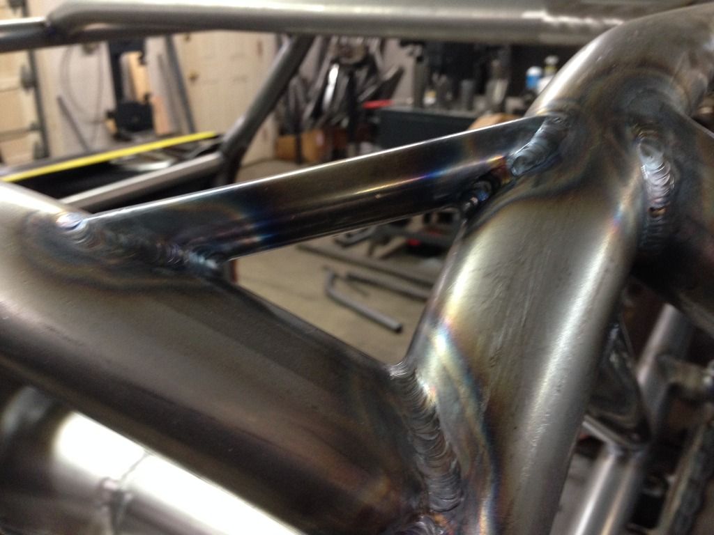

Now that this thread got brought back up, I need to update.

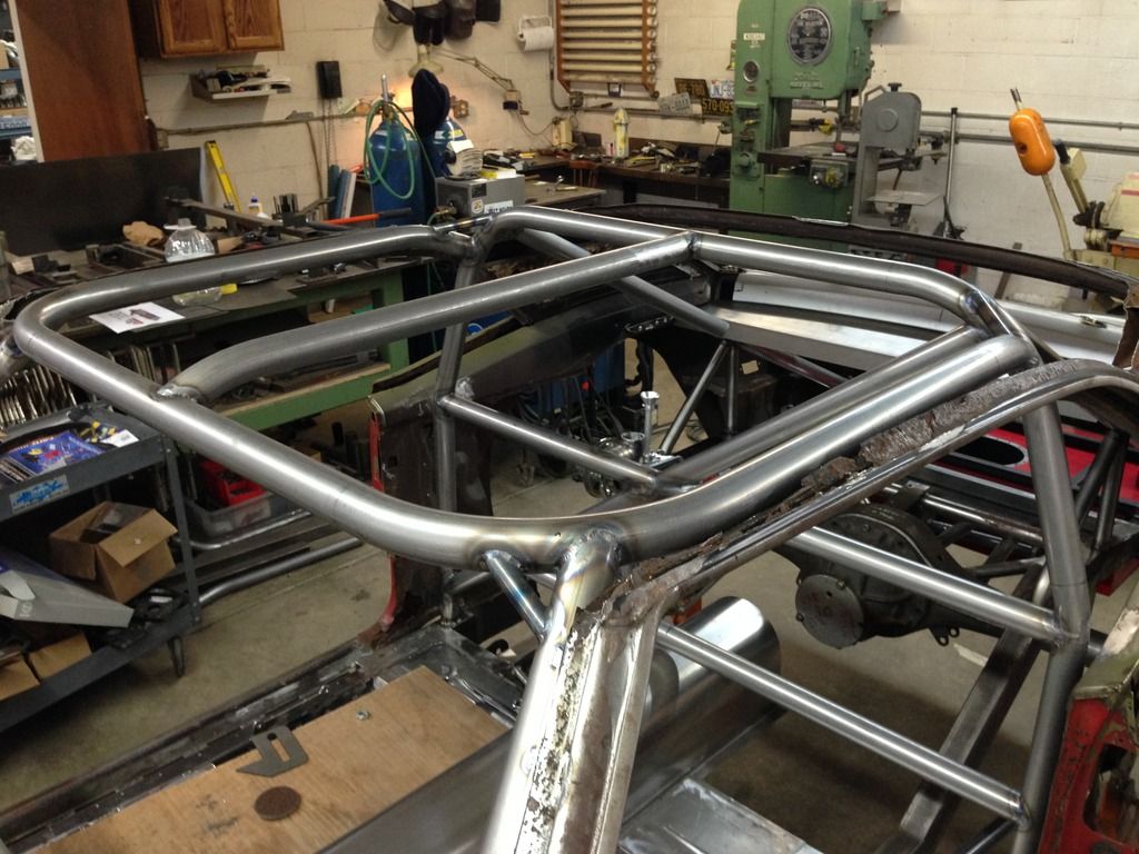

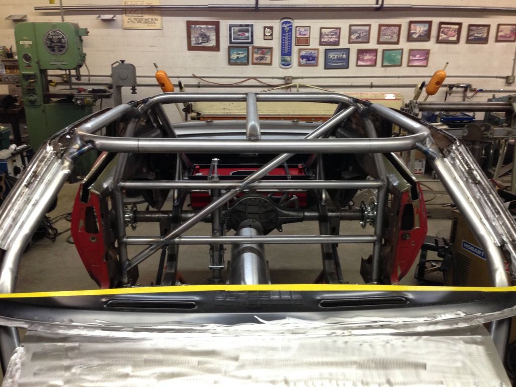

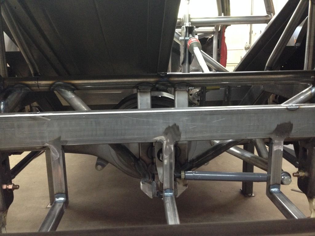

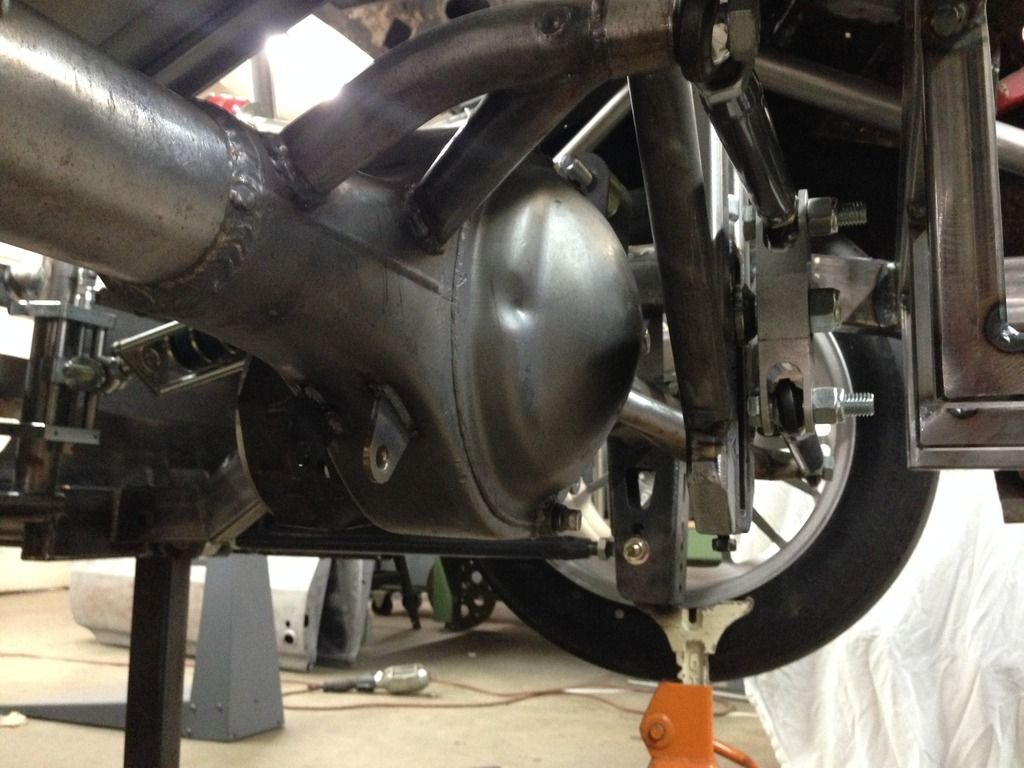

Center bar on cage and gussets
http://i1138.photobucket.com/albums/...pshqmjd7uf.jpg
http://i1138.photobucket.com/albums/...psemlybeic.jpg
http://i1138.photobucket.com/albums/...psw82wojd5.jpg
http://i1138.photobucket.com/albums/...psugudzrkb.jpg

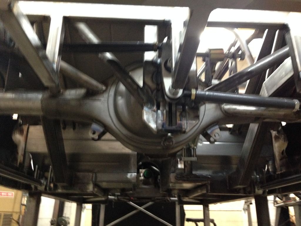

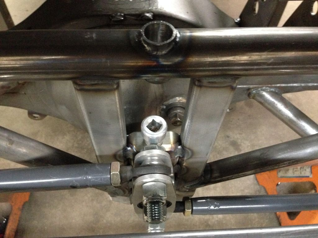

Payton King 06-10-2015 01:12 PM

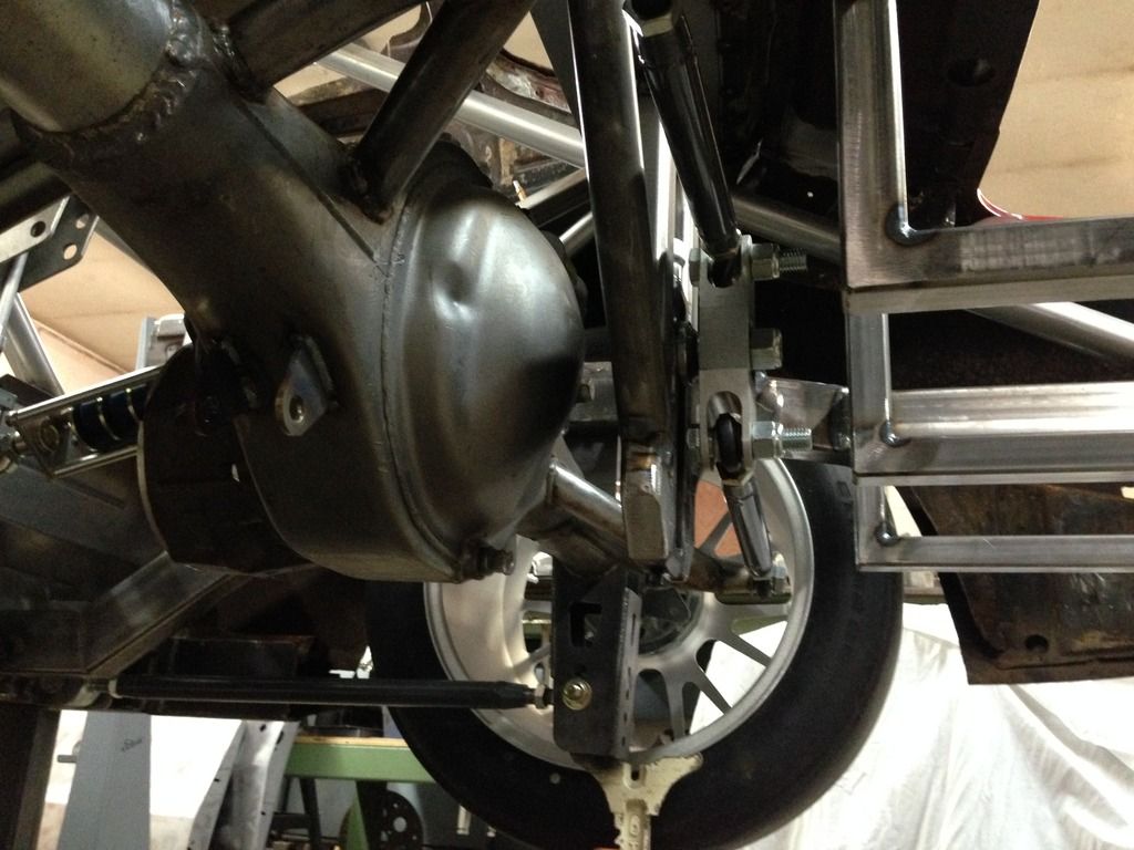

The watts mount was too low to the station tubes. We cut it out, modified it and added the trick adjuster so we can make fine changes instead of an inch at a time like it was before.
http://i1138.photobucket.com/albums/...pscmfeunfz.jpg
