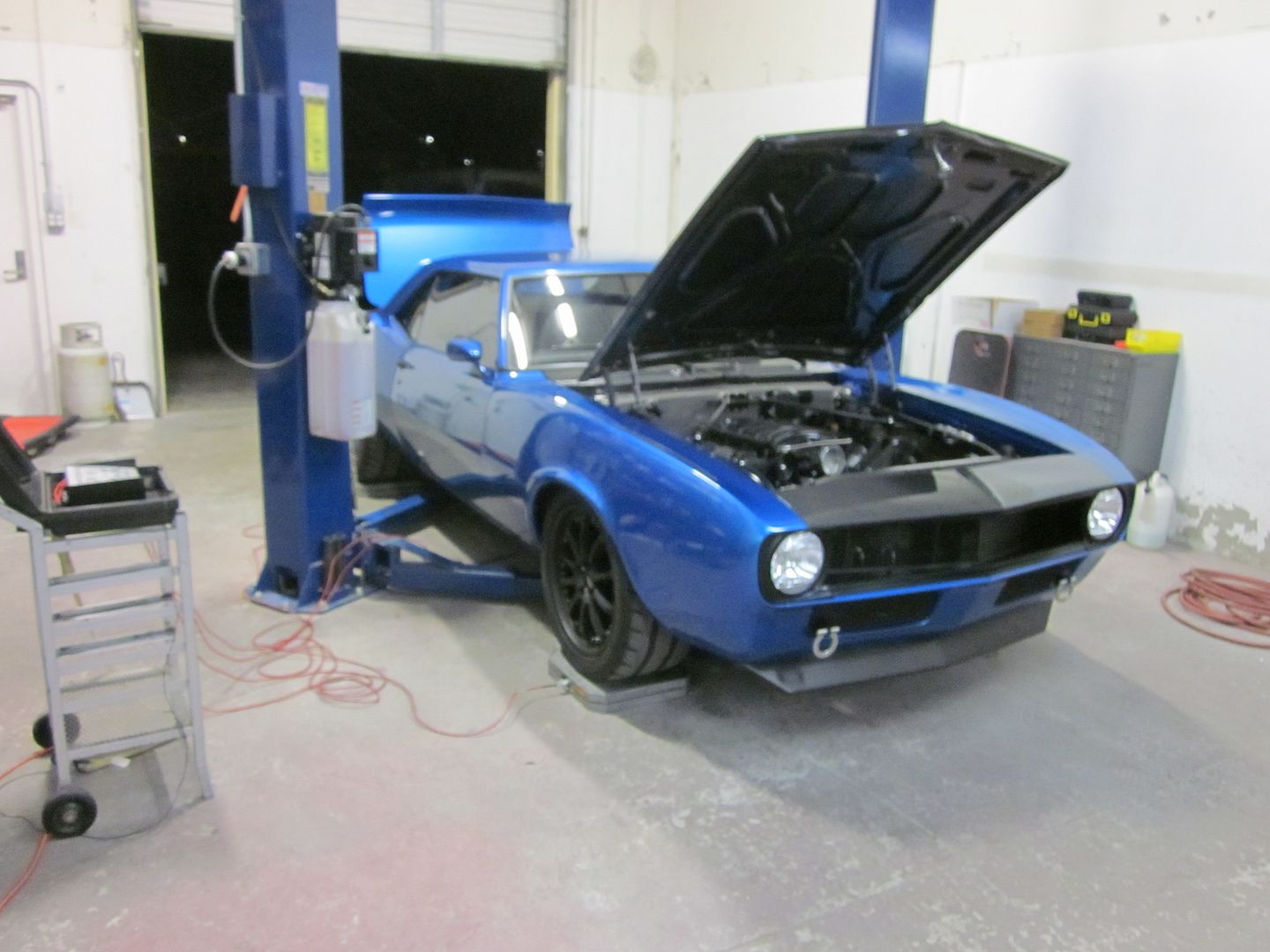

We put the car on scales today! I thought that we would be a bit lighter on the car.. but the car is pretty well balanced ..
Dry with ¾ fuel
Total weight: 3655
Front : 1910 52.2%
Rear: 1764 47.7%
Left: 1783 48.7 %
Right: 1874 51.2%
Cross: 1846 50.4%
With Driver & ¾ fuel
Total weight: 3852
Front : 1999 51.8%
Rear: 1855 48.2%
Left: 1926 50.0 %
Right: 1926 49.9%
Cross: 1934 50.0%
http://i1015.photobucket.com/albums/...n/IMG_1767.jpg
