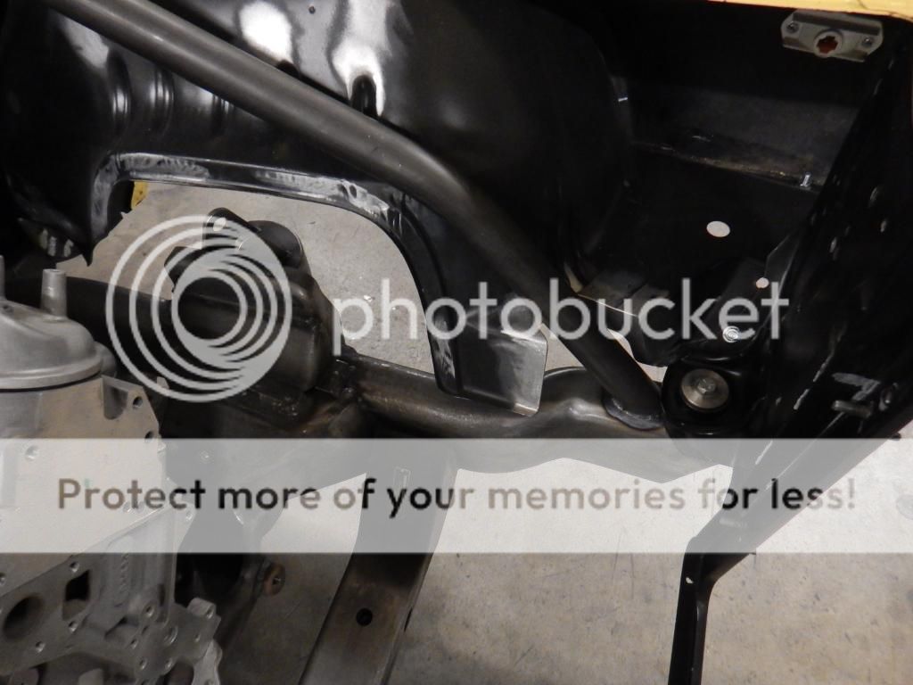

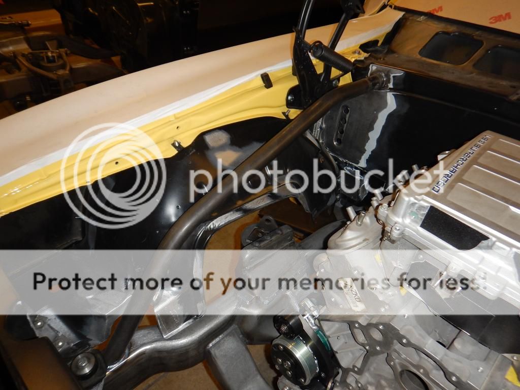

When I was looking at Hellfire at SEMA I noticed there were no down bars. With the 2 cars being very similar to each other why is JA2.0 using them?

Stielow 02-18-2015 07:32 AM
Originally Posted by nicks67ca (Post 595229)
Looks Great!
JA had them to start off with so we reinstalled them. I don't think they are really needed but it should stiffen the front a bit.
Hellfire had carbon inner fendrs and modifing them for front down bars would be hard. With JA steel inner fenders it is easy to cut and weld.

http://i439.photobucket.com/albums/q...psoymybhkf.jpg
http://i439.photobucket.com/albums/q...psqbzfyrcl.jpg

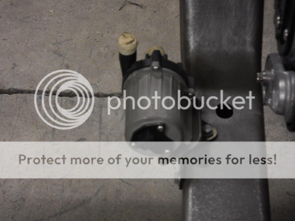

ZR-1 intercooler pump
