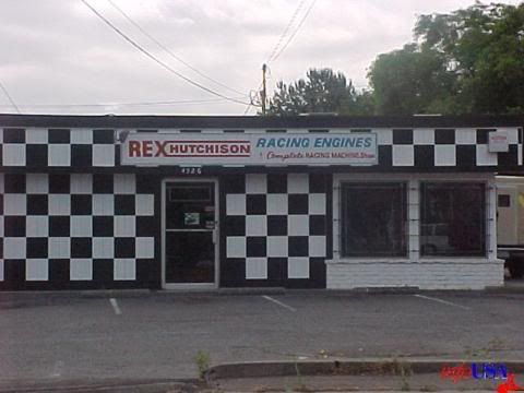

We dropped the engine off on Saturday.
http://i207.photobucket.com/albums/b...Camaro/rex.jpg
I'm sure some of you locals have heard of Rex Hutchison Racing in Sacramento, CA. They have built a solid reputation over the years, firmly rooted in local level and national level racing. We have known the owner personally for 14 years, and treats us like we buy an engine every month. I still remember him from back in 1995 (I was 12), when my dad had a 454 built for our Eliminator. The shop tour they gave us was incredible, and probably the first time I understood the addiction to horsepower.
However, when it came to building my engine, I started out a bit skeptical of my dad's recommendation to call Rex. I didn't like the idea of an engine build by a shop that I considered "old school." Aluminum heads, solid roller cam, high revs, pro touring...I didn't see my ideas meshing well with a shop that's been around since the stone ages. Long story short, my misconceptions were smushed when I spoke with Dan, who is arranging the details of my build as we speak. Not to mention Rex, who makes you feel like his grandkid within about 10 minutes. We got a shop tour again...the fully-ported LSX 454 with a sheetmetal intake quelled any fears I had about the shop stuck in the stone ages.
