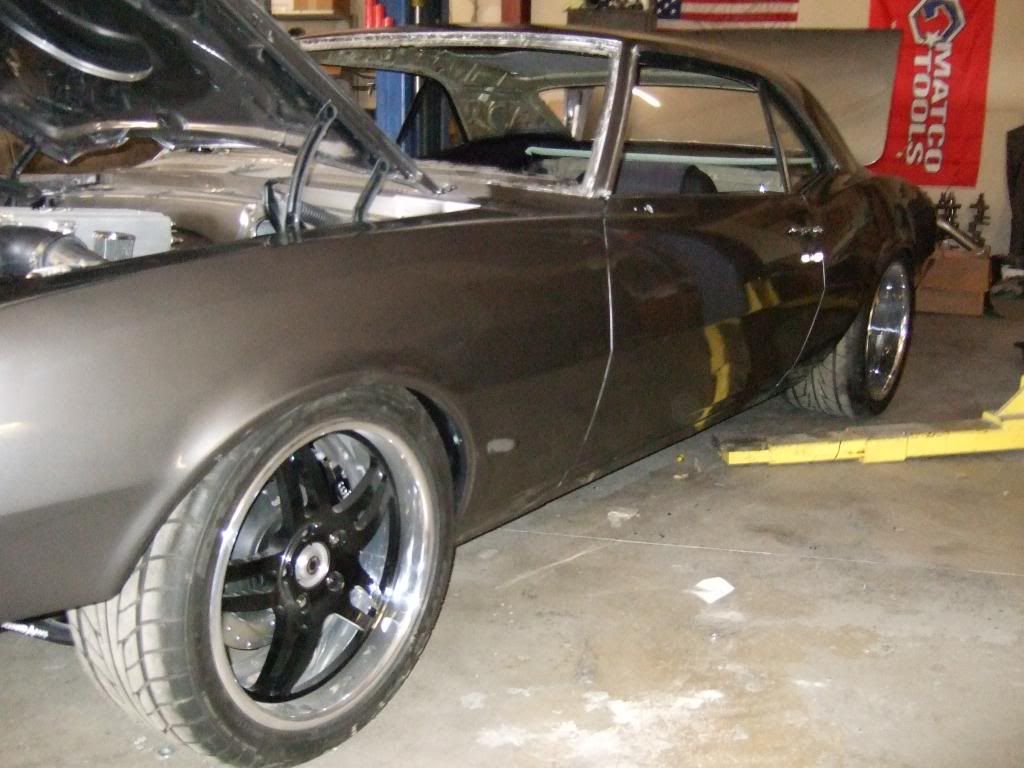

Vegas69 10-03-2008 12:09 AM
Looking good man....this is a tough stage. I wouldn't push to hard because the details are very important. It's at that stage. The fuel pump setup has me a little worried. The dash looks killer. The paint looks like Tony's rendering. I like it man.:thumbsup:

Vegas69 10-03-2008 12:25 AM
It's straight uphill to the pump from the sump. Definitely not ideal. It may work ok for a while but I bet you end up redesigning it sooner that you like. I spent more hours than I would like to admit plumbing fuel systems in my beast. Aeromotive would tell you the same thing. External pump is just not ideal to be honest on these cars.
Well, I hear ya, and it is less than ideal. But this motor was in a nearly identical car before mine with same A1000 pump (mounted in same location) and a stock tank (no baffling, no sump) and the only issue they had was when fuel got to below 1/2 or 1/4 tank fuel. So I am hoping the baffling and sump will solve that.
But yes you may be right. This thing could end up getting redone. :(
