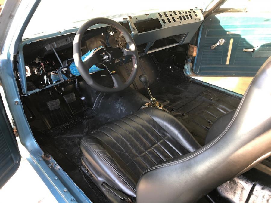

5 Attachment(s)
Got the steering column hub adapter in, had to see the Momo on the car. Seems to work well.

Great updates and that is the steering wheel that I want for my car.
