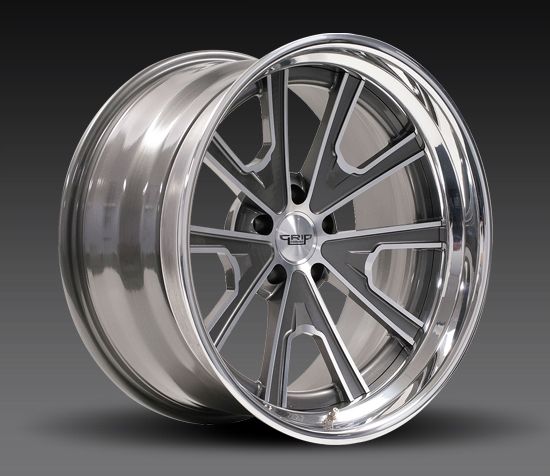

FETorino 12-29-2012 10:34 PM
You can get a quality wheel that looks like that but it will cost you.
http://www.forgeline.com/products/gr...large=1&asdf=0
http://i291.photobucket.com/albums/l...ps581418a1.jpg
