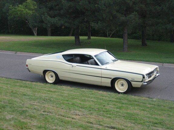

The stance on this Torino is just right...
http://i144.photobucket.com/albums/r...psa0440ab9.jpg
WSSix 04-05-2014 07:50 AM
That white Torino looks good with those steel wheels on there.

65 347 04-21-2014 09:15 PM
Where did you find 17 inch steel wheels? I love the super stock look.
Originally Posted by FETorino (Post 545122)
I love the look of poverty caps. For a long time I considered doing the same thing but in 18". 18" gives you a better selection of tires with some height to fill up the rear.
A 285 fits out back with leaf springs and no tubs I did a 285 17 on teh rear of mine for the first time around. I think a 275 40 18 for the rear and a 255 35/40 18 for the front on 18x10s. That's 25"/26" tall front and 26.5" tall rear. They will fill the wheel wells up. I had a 245 on a 8.5" wheel up front with my shock tower suspension so I'm sure you can fit the 255 as long as the car isn't super slammed. I still have my custom arched leafs that Dever Spring made for me hanging around (about 2" lower ride height). If you get out this way I'd give them to you. :thumbsup:
:cheers:
http://i291.photobucket.com/albums/l...ps7f7bf8b1.jpg
jarhead 04-22-2014 03:48 AM
347---
The fastback isn't mine, those are Wheel Vintiques brand 17x9's.
Joe
