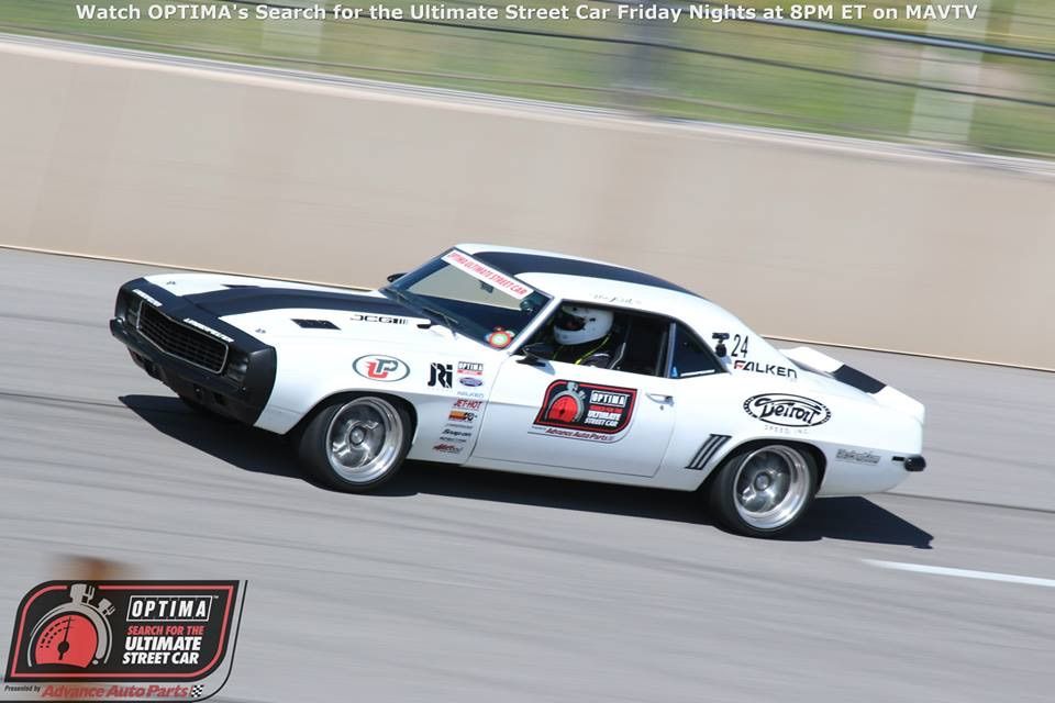

Jake,
Is the entire car wrapped? How has the wrap held up to rock chip and other misc battle wounds?

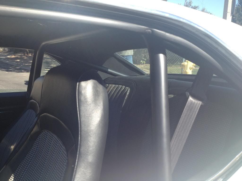

Do you have any pics of the cage? I've checked your website and this build thread, but I can't find any pics.

Yep the entire car is wrapped. It's held up really well to chips but I've been disappointed by how hard it is to clean. Cone marks and road course rubber usually rub right off paint but with the wrap I have to spend hours with a polishing pad to get off a lot of stuff. It still looks darn good though when clean.

I'll see if I can dig up some cage pics... It's a 4 point that JCG made us and is the exact same as the one in blu balz.

This is all I can find.
It ties into the rear frame rails and the harness bar comes out in seconds with a couple of pins which is nice for fitting more stuff back there.
