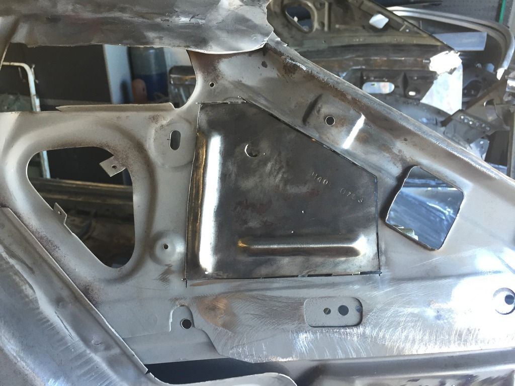

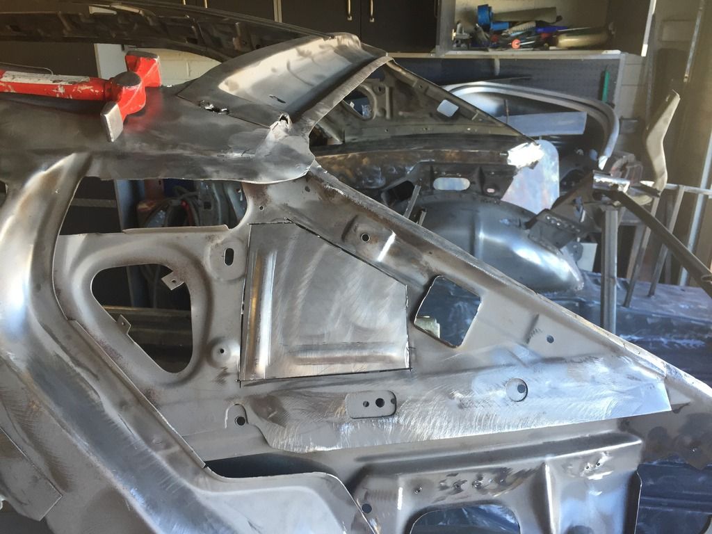

as for my build I didn't get much done, just some rust repair
http://i1368.photobucket.com/albums/...psuyryqcmm.jpg

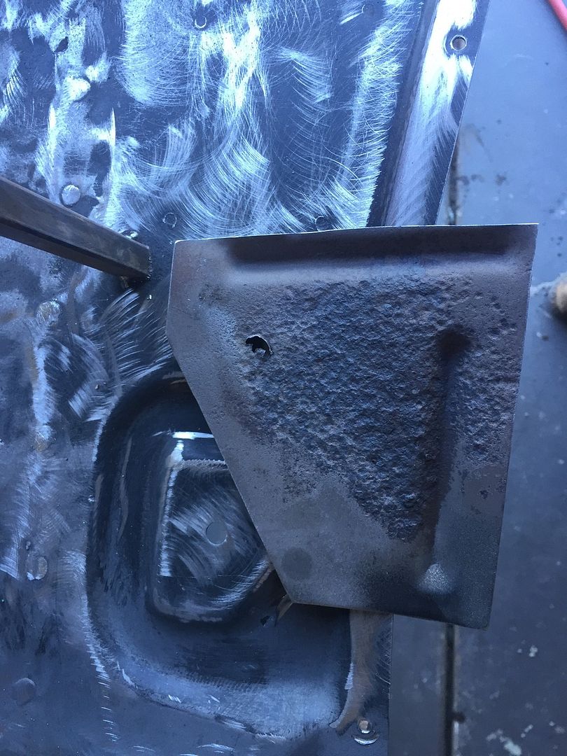

Up in the inner sail panel there was one small rust spot. looks like condensation
build up over the years I suppose.

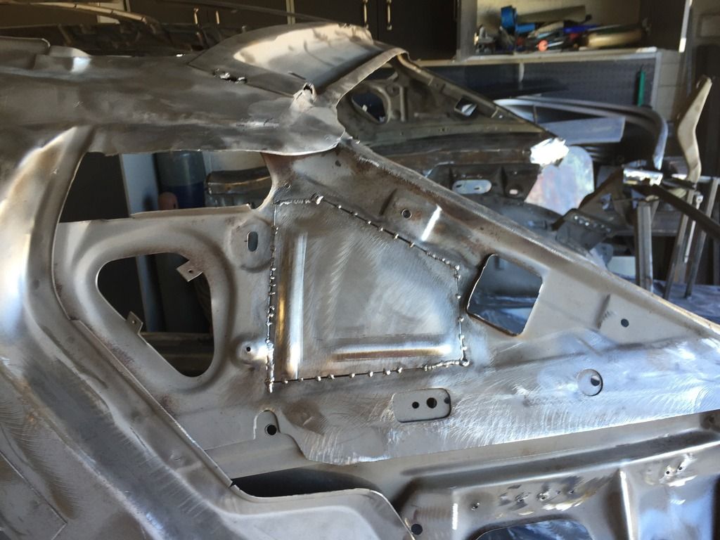

http://i1368.photobucket.com/albums/...pskjsyzz50.jpg
http://i1368.photobucket.com/albums/...psmgajdepk.jpg
JDODDS187 05-09-2016 05:54 AM
Took a little hammering to get the shape right but in the end it fit pretty well
http://i1368.photobucket.com/albums/...psfvrieuho.jpg
http://i1368.photobucket.com/albums/...psidun0idq.jpg
http://i1368.photobucket.com/albums/...psffammcev.jpg

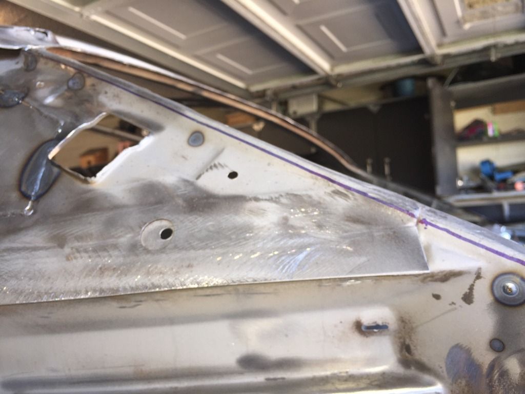

JDODDS187 05-09-2016 06:10 AM

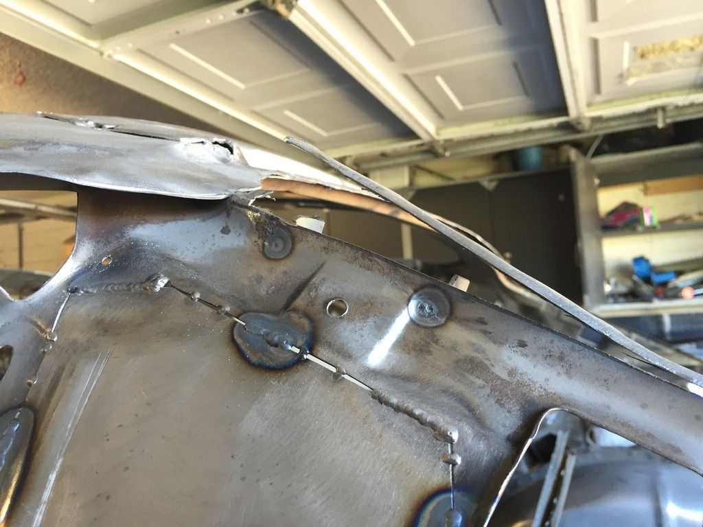

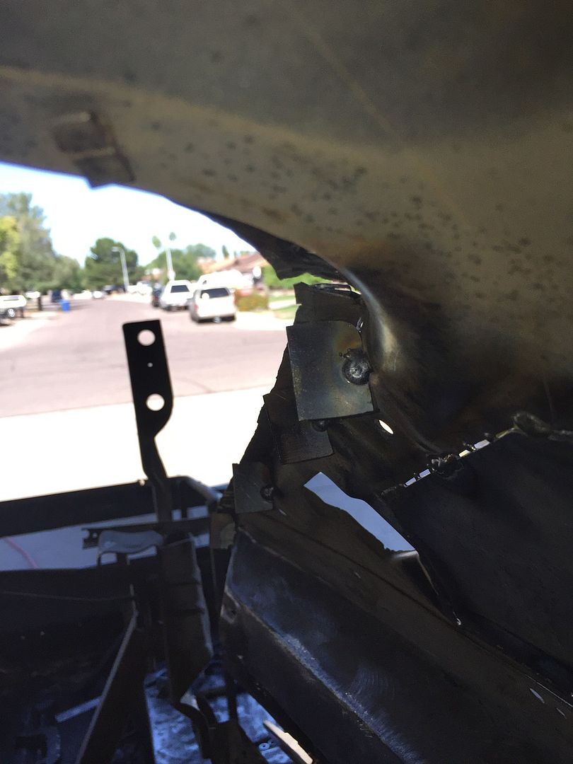

Next I began to work on the area where the quarter panel attaches on the side of the rear window, I made some tabs to locate where the original edge sat, to make sure I followed the same line, there is a slight curve here
http://i1368.photobucket.com/albums/...pskskjjztj.jpg
http://i1368.photobucket.com/albums/...psvi3viwlm.jpg

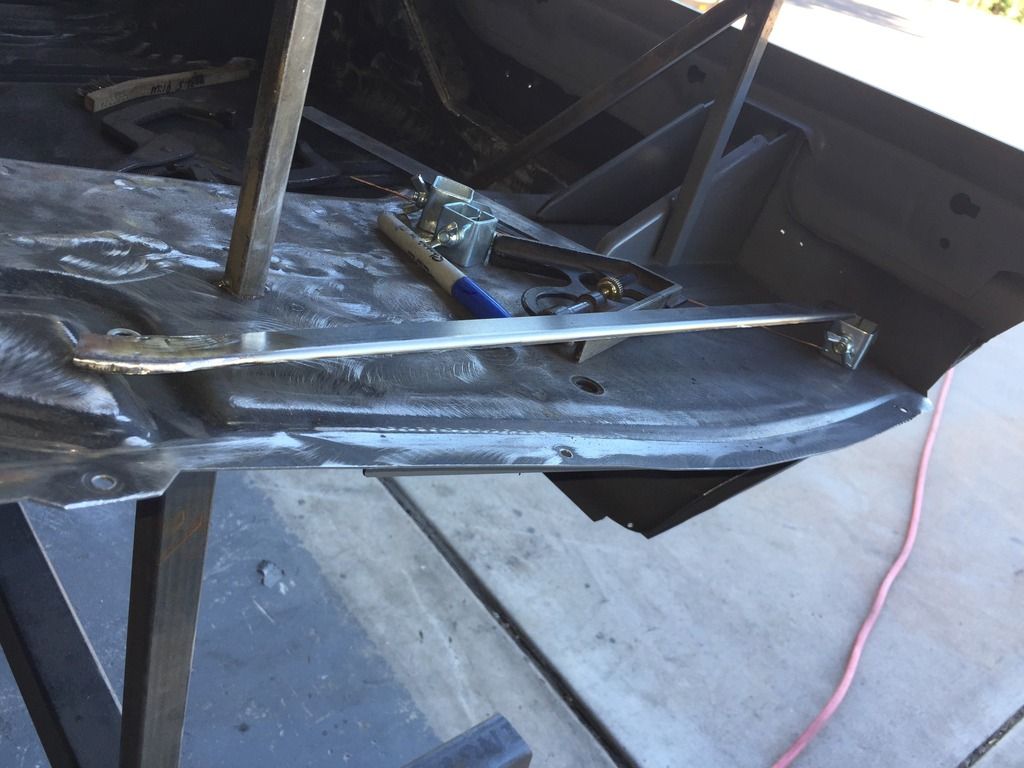

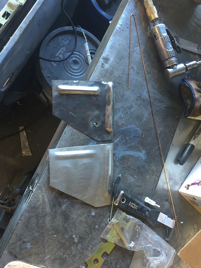

I didn't get much further than this,
http://i1368.photobucket.com/albums/...psjnxymt86.jpg
I got it welded and test fit the quarter, I have a high spot so it needs adjustment
Here is the only other pic I have of this at the moment, But basically it was a piece of 18ga that I had made into 5/8"x5/8" angle then I trimmed off one leg just past the bend, It would have been much easier to just replace the one 5/8" leg and not cut down the side but there was some rot that creeped down and I wanted to make sure I got it all.
http://i1368.photobucket.com/albums/...psmz1oioei.jpg
