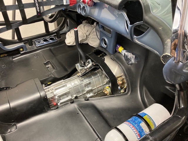

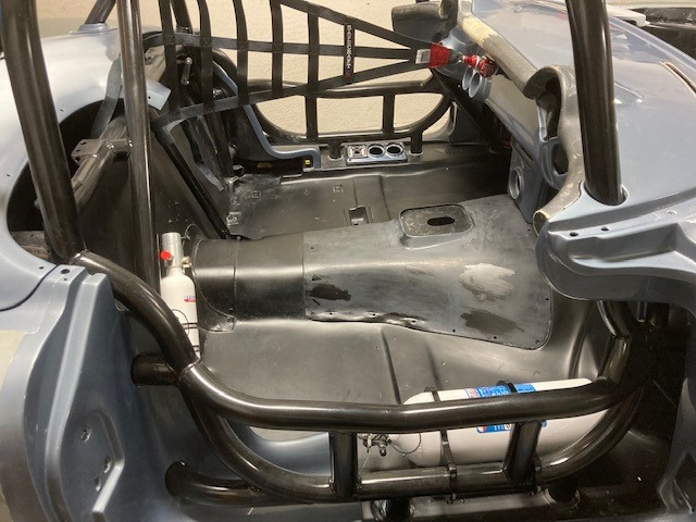

Haven't posted for a while, but since I have started installing stuff with expiration dates (fire suppression, window nets, fuel cell, etc.), I guess I am committed to finishing this thing sometime in the near future. Had the drivetrain in, but pulled it out to make a couple of modifications to make some items more accessible and/or easier to service. That work is done and the drivetrain is going back in.

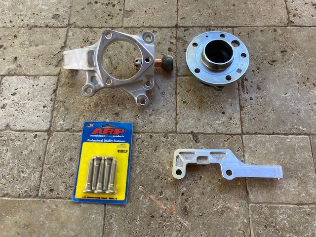

This is as far back as I could get the motor. I ran into the roll cage dash bar, the windshield, and my right foot. LOL I also got new spindles from Speedtech. I am replacing my early ATS spindles with new, stronger ones machined from 7075 aluminum. Thanks Blake for the custom machine work.

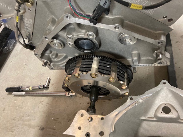

Also got the clutch installed for the final time.
Attachment 76919

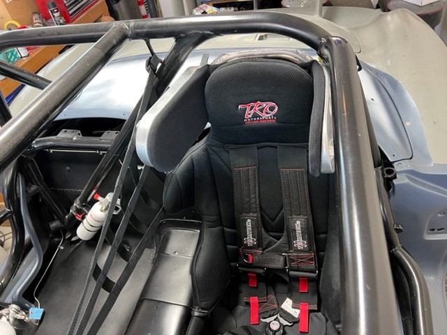

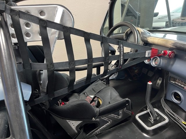

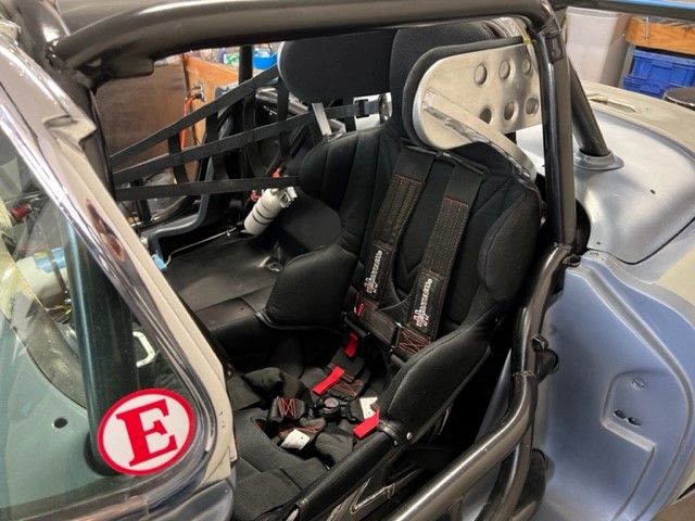

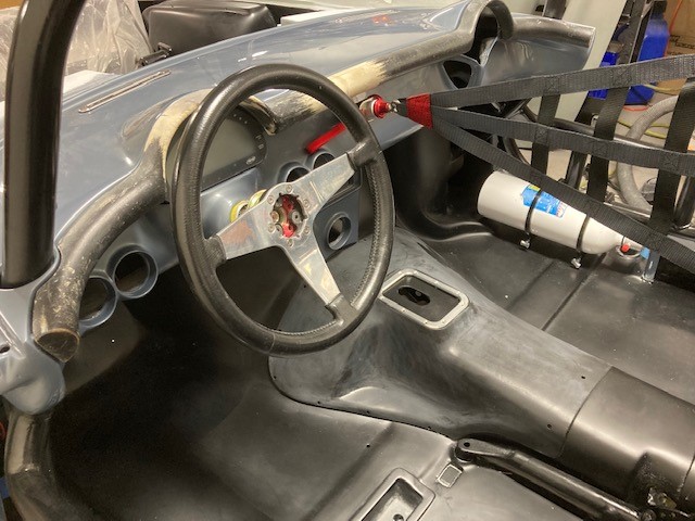

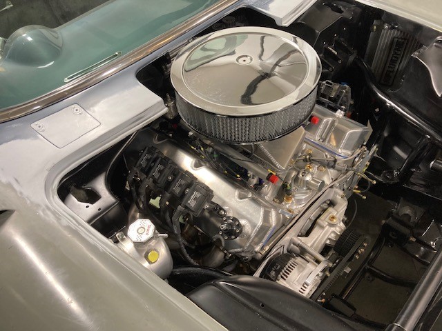

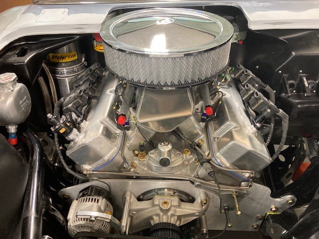

mfain 02-20-2022 02:28 PM
5 Attachment(s)

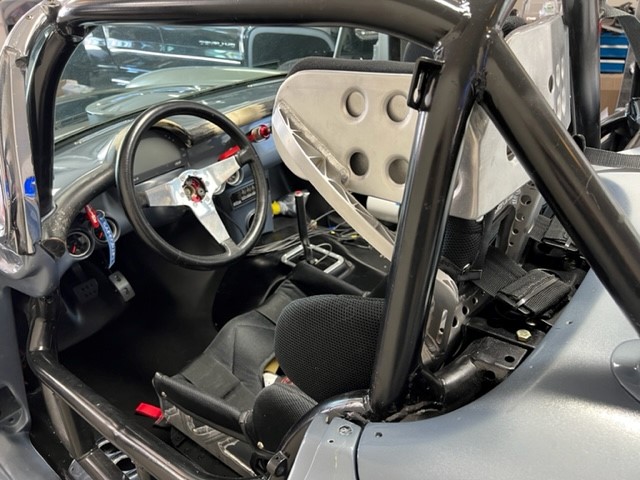

Received and installed a custom built seat from TKO Motorsports. Nice seat!
Some progress.
