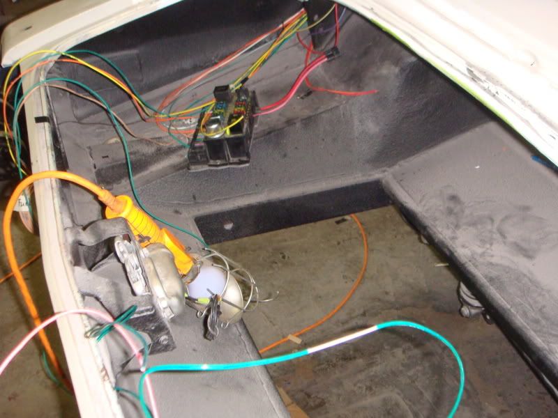

Also started with the wiring - because of the aftermarket AC system and my desire to keep the firewall clear, under dash space is at a premium. So I am going to put my fuse panel in the trunk:
Some where over here - have not decided how to mount it yet:
http://i168.photobucket.com/albums/u...A/DSC00812.jpg
The battery is going in about the same spot on the passenger side. Hole is for the fuel tank.

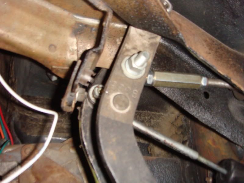

Ok, got some new pictures of the clutch and brake pedals up. Obviously they will be coming back out to get refinished, but I wanted to mock everything up and get it placed right, etc.
http://i168.photobucket.com/albums/u...A/DSC00820.jpg
http://i168.photobucket.com/albums/u...A/DSC00821.jpg

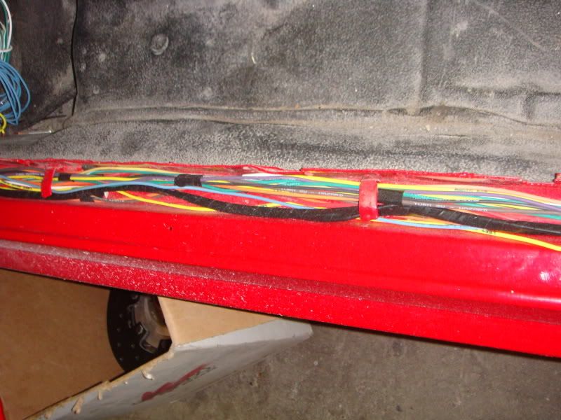

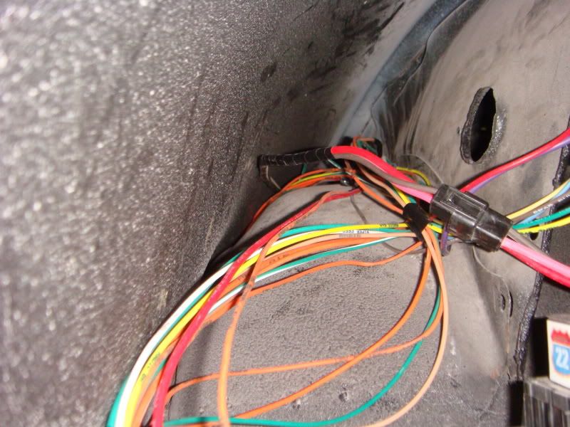

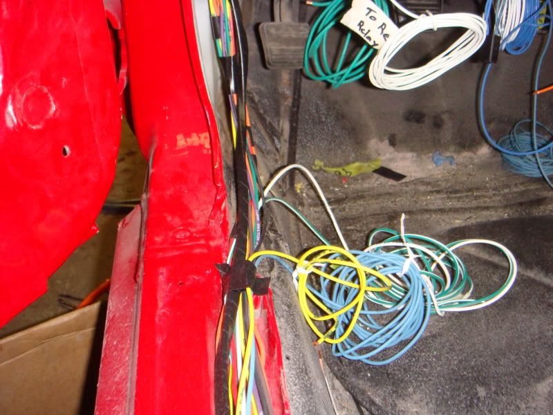

And the rear wiring is done! Well sort of... ok, fine, the wires that go through from the rear passenger compartment to the trunk area is done. And the tail light harness is done too.
Here is where the wires come through into the trunk area:
http://i168.photobucket.com/albums/u...A/DSC00827.jpg
Rear window defrost will work again!
http://i168.photobucket.com/albums/u...A/DSC00824.jpg
http://i168.photobucket.com/albums/u...A/DSC00818.jpg
