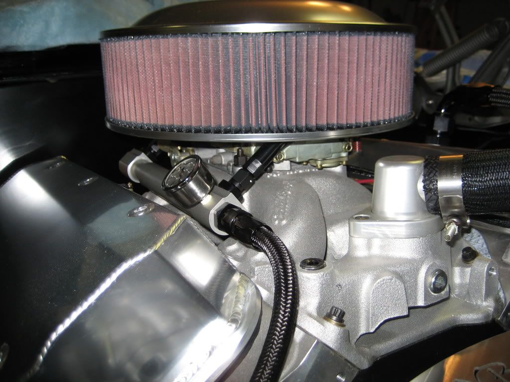

Update:
After all the talk of one fan not doing the job, I called the radiator manufacturer and they make a dual spal setup for my radiator. It's all wired with an individual relay per fan. I still need to tidy up the wiring a little in the photo.
http://i200.photobucket.com/albums/a...9/IMG_0854.jpg
http://i200.photobucket.com/albums/a...9/IMG_0850.jpg
I got the throttle completely set up and adjusted along with the carb mounted. The fuel system is turn key minus the gas cap and gas:D

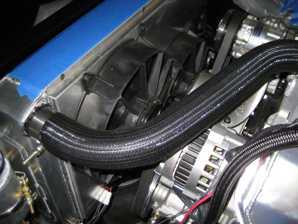

Love the project so far. The only thing I'm not "feeling" is the black mesh covering your radiator hose. And it's not so much the covering as it is how it looks unfinished and rough on the ends.
Is that how you plan on running it or is that just for now?
Vegas69 06-29-2008 02:12 PM
Thanks guys. I am not sold on it either Steve. It doesn't look as shiny without the flash and I have yet to trim some of the ends. In fact Tyler thought the power steering lines were the same AN hose I am using everywhere else. One day I like it the next:D It's really hard to cut it straight. It looks good on the power steering lines since it's a smaller diameter and that is the same material I am using on the wiring. I may just end up cleaning up the hoses and shining them up a little. Heater hoses and AC lines will probably be the deciding factor on the radiator hoses.
skatinjay27 06-29-2008 05:57 PM
why not use the little heatshrink type hose clamps... they you can have the mesh over the hose but the ends will be covered and look finished? amd imo they are the cleanest looking clamps.
http://www.jegs.com/p/Gates/943359/10002/-1/10603
Vegas69 06-29-2008 07:38 PM
Thought about those actually....tough to get a heat gun on the water pump inlet and not sure I trust them in the long run. I like the look of the NHRA approved clamps I am using. They aren't going to let me down.

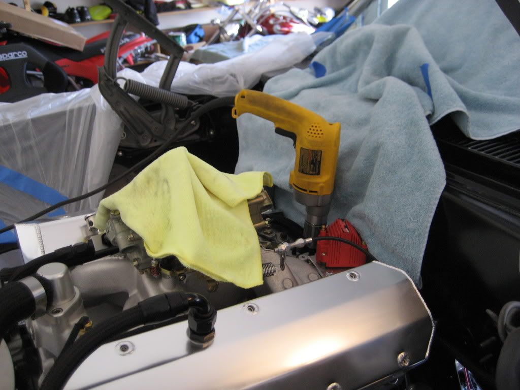

She is alive. Hooked up the dash panel and ignition switch so I could watch my oil pressure while priming the engine. Pretty exciting to see the fruits of my labor turn into something like lights. Turned over the engine briefly to check the starter shimming and it's perfect.
http://i200.photobucket.com/albums/a...9/IMG_0865.jpg
http://i200.photobucket.com/albums/a...9/IMG_0868.jpg
Primed the oil pump for quite a while to make sure I had no leaks. I am running braided 350 hose and a remote oil filter on the front passenger frame. Everything looks great. The distributor is now stabbed and spark plug wires are done.

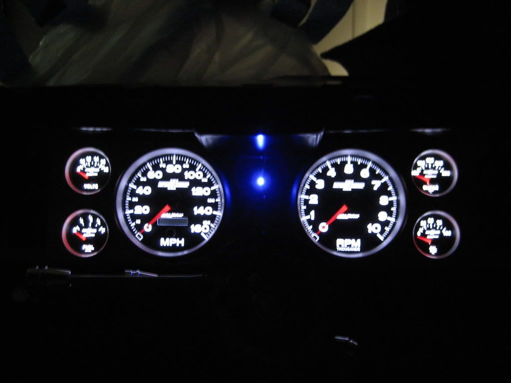

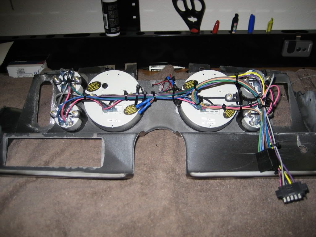

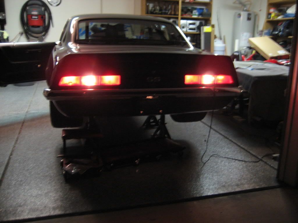

Late last night I realized the dash lights weren't working. The right turn signal also was not functional. I dug in this morning and found blown fuses in both circuits. I definitely had a short on my hands. For those of you that are not real savvy with electronics the key to finding the short is eliminating segments of the wiring that you think has the short. In these old cars it's a piece of cake. It turned out to be my brand spanking new right front parking lamp. They must of chaffed the wires during assembly. I unplugged it and everything is perfect. I'll probably disasemble it and try to fix it vs send it back.
My first view of the gauges at night. :D
http://i200.photobucket.com/albums/a...9/IMG_0871.jpg

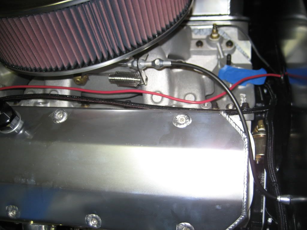

I spent most of the rest of the night installing my emergency brake cable. Cut the lokar cables have everthing set up perfect. Push down on the pedal and it's rock hard and the wheels aren't moving with a breaker bar. About the third time it sinks to the floor. Pile of crap OER front cable broke third pull. :unibrow: So brand new OER parts are my two bugs to fix for the night. My works flawless.

waynieZ 07-10-2008 07:46 AM
Looking good! hey did you notice those large gauges when lit look like they have Chevy emblems in the center . Keep picking at it your getting closer.
Wayne
Vegas69 07-10-2008 08:12 PM
Good call Wayne:cheers:

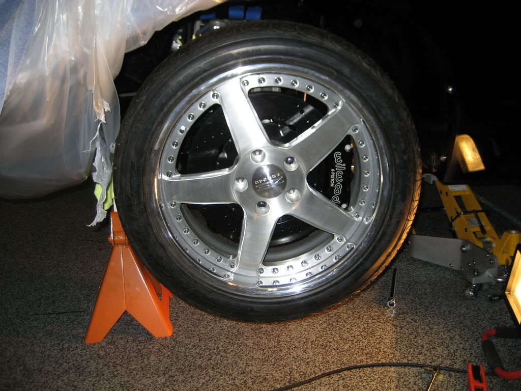

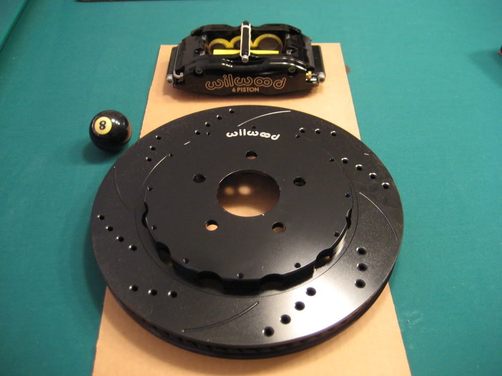

Well I finally got my front brakes. Have to say Frank over at Prodigy Customs came through for me as always. 13" rotors have been on back order and he hooked me up with 14" for free. Keep in mind guys that I have spent a nickel or two thisyear with him so don't go asking. :lol: They are flipping huge!
http://i200.photobucket.com/albums/a...9/IMG_0880.jpg
http://i200.photobucket.com/albums/a...9/IMG_0893.jpg
I have only had time to install the drivers side. Had to buy C6 bolts from Chevy for the mounting brackets. I also had to clearance the spindle slightly with a aggressive file for the caliper bracket to mount flush. Plenty of clearance now and the wheels fit nice as well. Drivers side is all shimmed out and ready for some fun.
http://i200.photobucket.com/albums/a...9/IMG_0895.jpg
http://i200.photobucket.com/albums/a...9/IMG_0889.jpg

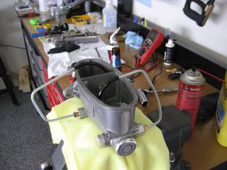

I now have brakes too! Fought a couple leaks with the connections around the master cylinder. Loosening the lines and retightening them did the trick. I vaccuum blead them last night. The old lady let me borrow her leg. Brakes feel great, no leaks, really like the feel of them so far. DSE dash is fully bolted in along with the column, steering wheel, brake switch, drivers seat is in. When it's done I'll post all the photos.
Made a homemade bench bleeder.
http://i200.photobucket.com/albums/a...9/IMG_0932.jpg
http://i200.photobucket.com/albums/a...9/IMG_0933.jpg

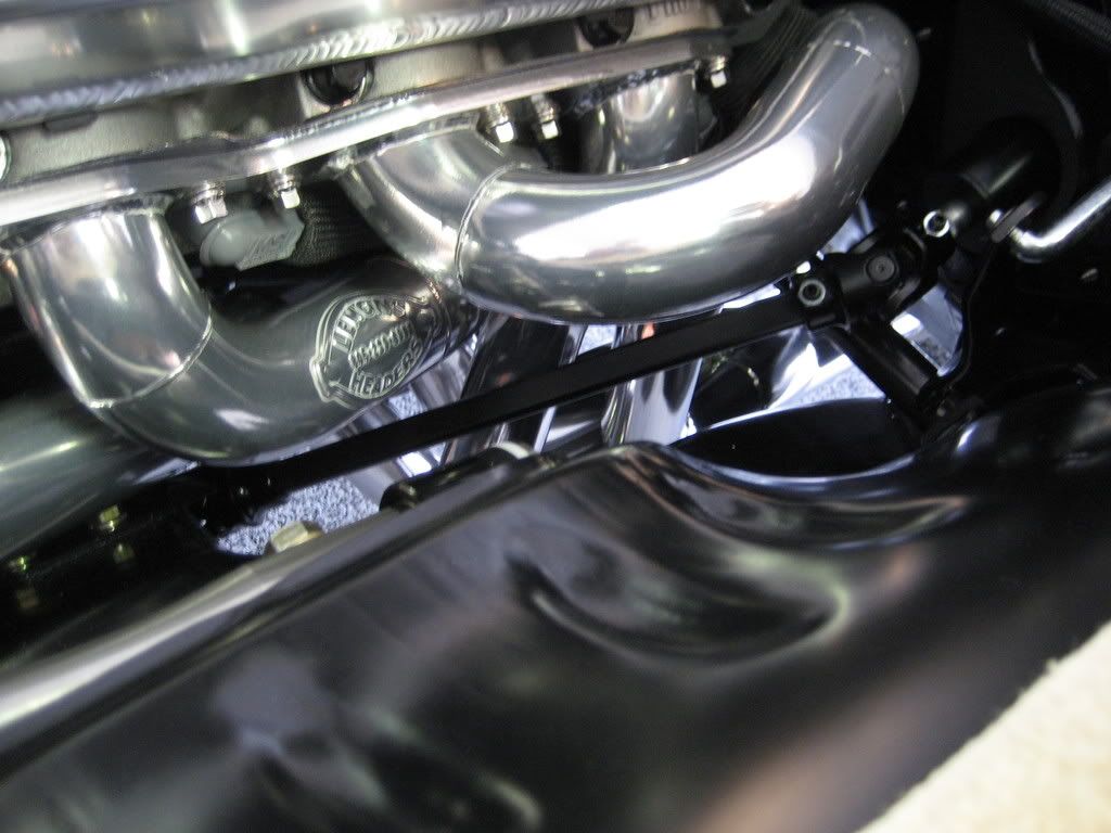

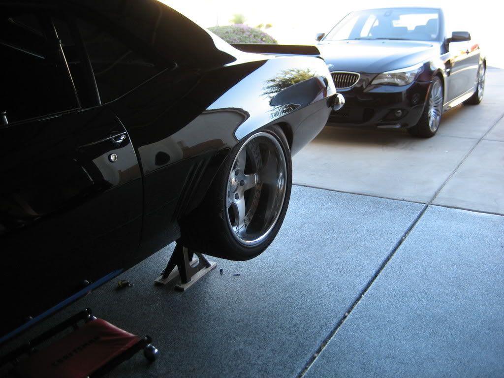

Thanks boys....AJ, Saturday is out. I dropped her tonight and the body and the tires were best friends. I could get 5 turns out of the front coil overs and managed 1/8 of an inch clearance.:D Don't have a spanner wrench for the front yet. So basically oil line, stance, hood keep me from showing up. I'll have it knocked out very soon. Looks killer on the ground!!!!!!!!!!!!!!!:_paranoid
tones2SS 07-23-2008 03:44 AM
Those LEMON headers look good & HUGE!!!
The must flow pretty well huh?:thumbsup: :cheers:
Post pics of her on the ground and ready to roll when you get some free time.
Denvervet 07-23-2008 08:47 PM
I'd love to see what Tyler came up with getting the exhaust thru and out the back. I forgot to ask why you decided to go with an exterior fuel pump rather than an internal one. ...besides the $$. All looks very cool.... I mean bad.:thumbsup:
