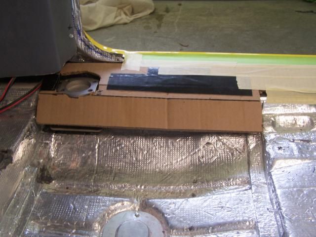

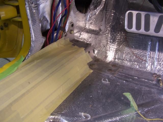

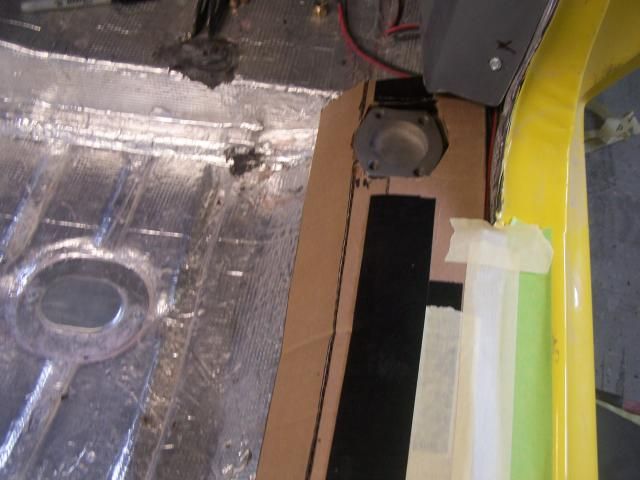

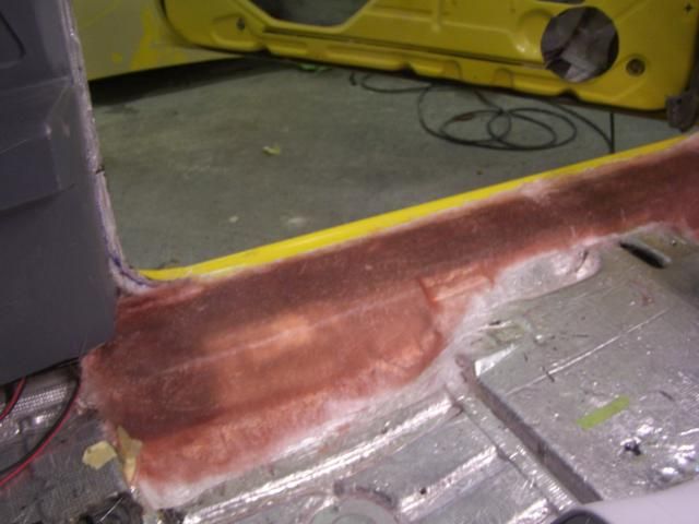

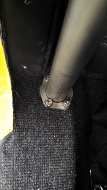

bolt-in door bars

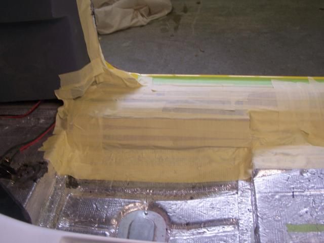

Nice car, you do great fiberglass work.... Question, how did you bolt the front of your door bars to the floor. any pictures?
zingercustoms 12-15-2014 10:49 AM
For the front bolt down are , we just did it per the directions, take out the kick panel and carpet, drill holes etc..we mocked up cardboard to go around rear mount and to front mount then made a fiberglass panel that finished it all off and leveled it all so when we added carpet it just covered it up.
