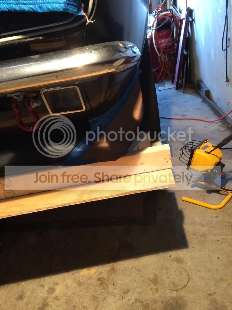

Congrats man!! Did you make your splitter? how far under the car does it go?
Beach Cruiser 07-23-2014 03:55 PM
Yes, all the way to the oil pan, I'll post some build pics up if there interest

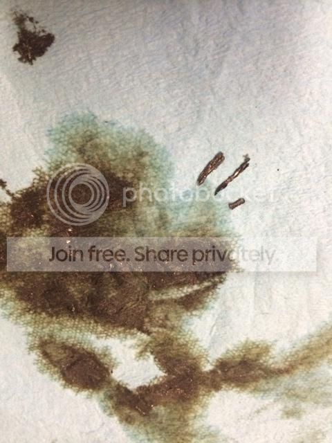

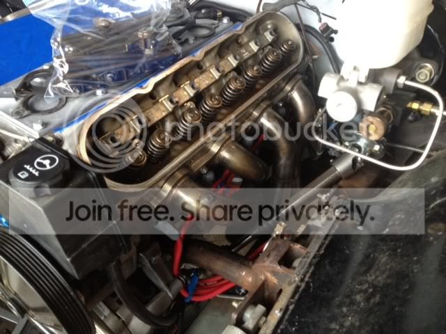

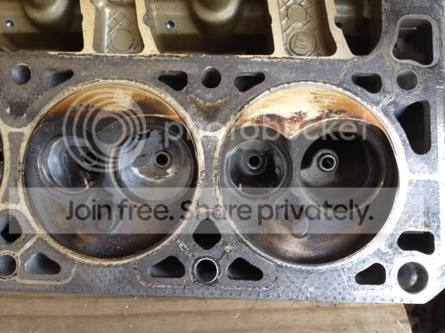

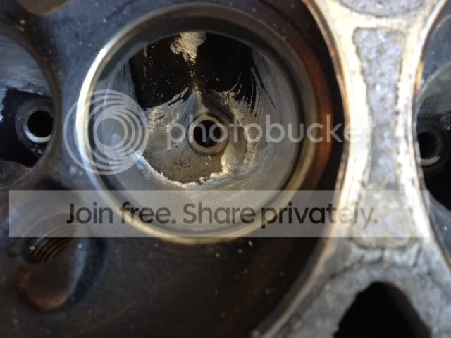

Ok, so the trans is at the shop that built it. We pulled the cover yesterday and all the teeth are still good, but it has a spot where it binds up if it's in gear. It spins freely not in gear. They are going to break it down and try and figure it out. As I suspected some metal went through the third gear clusters, so this is what my magnet picked up out of the oil I drained:
http://i539.photobucket.com/albums/f...psf1066fab.jpg
No sign inside the tranny where it may have come from, very strange. The poor transmission only had 40 mins of run time on it.

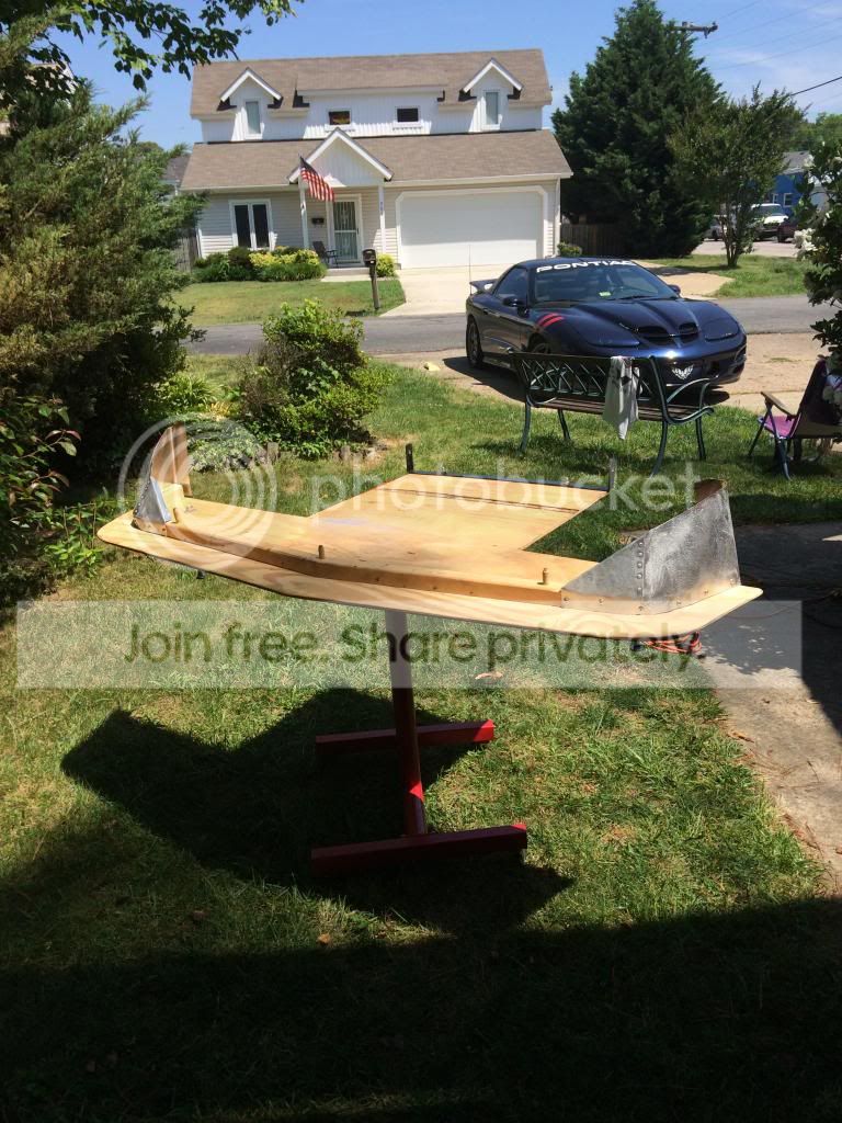

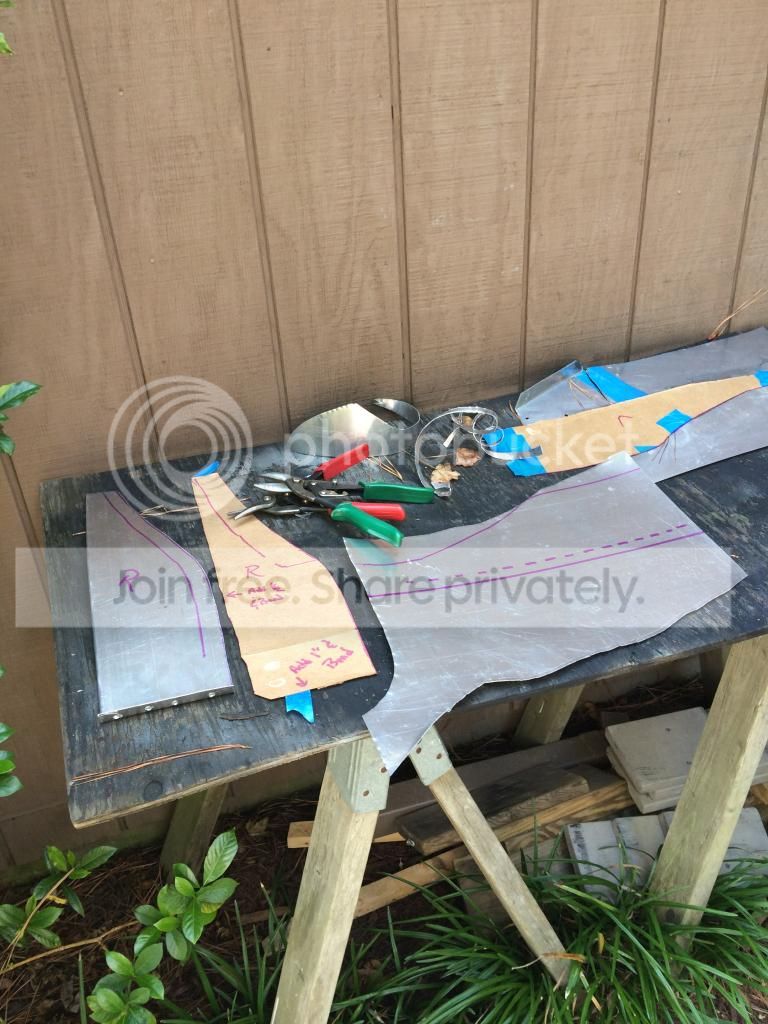

As Promised, here are my splitter build pics. I didn't want to spend a bunch of money so this was just a prototype to see if it works. I could feel a difference in the car even at Highway speeds, but I didn't get enough track time to really push it and learn to lean on in the corners. As you can see I made it out of plywood and a 2x4! total cost is under $20!

Thanks for the splitter build pics. Gives me a good direction for making mine for the 69.What did you make the final from.. 1/8 or 3/16 aluminum?
Beach Cruiser 08-05-2014 11:04 AM
Most guys use Alumalite, Mine's still plywood :lol:

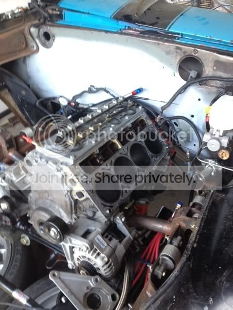

Beach Cruiser 09-08-2014 06:37 AM
Got the motor out this weekend and set up in the garage for the tear down. Good thing I decided to do this because I found a lot of metalish stuff in the oil when I drained it. Got the new stuff in from http://www.improvedracing.com/ on Friday :ups: Here's a few updates:

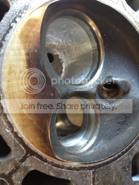

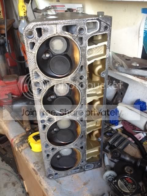

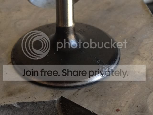

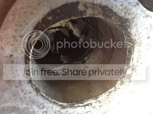

Well I got the most of the motor disassembled now, I'm not really happy with what I found inside. The rods have a lot of "slop" in them, I mean I can turn the crank a couple of degrees before the rods move and you can see the crank moving inside the rod caps. I'm pretty sure it's toast and needs a complete rebuild other than me just slapping some bearings in it putting it back together. I did find a very well priced LS6 shortblock close by that only has 40K miles on it, so if it checks out I'm going to use that. After I pulled the pan and saw what was swirling around in there It was an easy call! I can't believe this thing was still running and not making any knocking noise!
http://i539.photobucket.com/albums/f...ps8qf5hrhe.jpg
I'm gonna take a little time and clean up some of this too while It easy to get to.

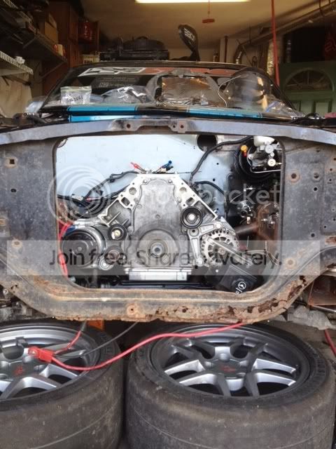

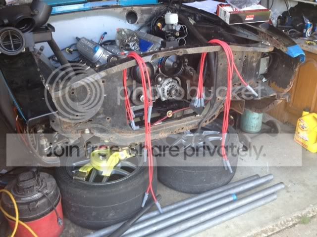

Got the frame rails and crossmember all painted up, cleaned up the harness some (it's hidden when the motor is in the car) need to get a little paint on the firewall and then I'm done under here. Should be picking up the LS6 early this week and the fun begins! Also my copy of Grassroots motorsports came in yesterday, Page 63! They even gave me the majority of the page!

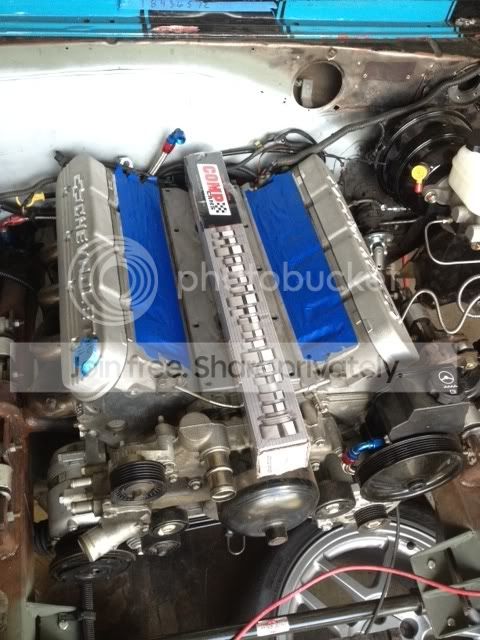

Beach Cruiser 10-06-2014 07:55 AM

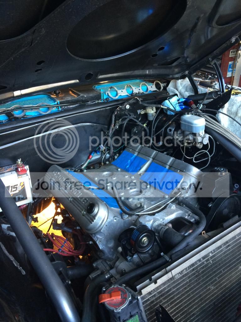

Well this weekend went a little better than last week. Got the motor all assembled and running in the car. Sunday was a long day, but I had a couple guys come over and help me drink all my beer and turn a few wrenches. Still lots of little stuff to go over, but those I can do by myself. Deadline is Oct 17th, AutoX is on Oct 19 then it's getting loaded up to get hauled to Daytona for Nov 1-2 track weekend.
