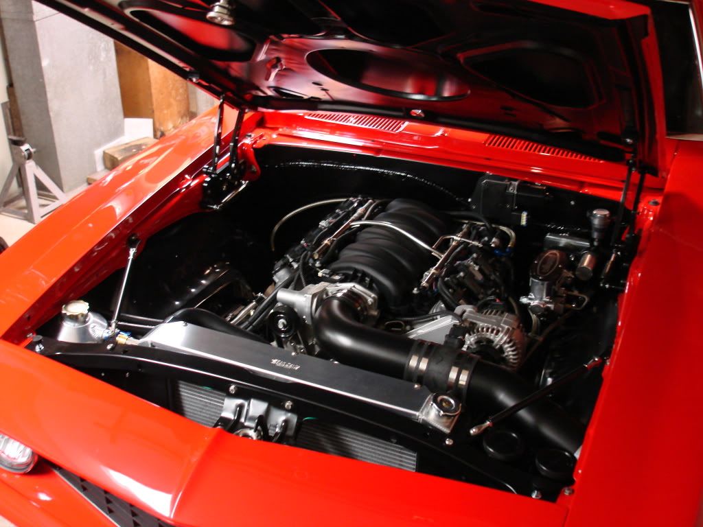

Good news to report :yes: , the engine didn't want to run more than about 10 seconds. So I was checking the MAF pin placement in the connector and relized I flipped the air temp sensor wires. After correcting the mis wiring in the MAF connector, I also had heater water leaks in the bulk head plumbing at the firewall, I really dont like those oring hose barb fittings so I tore it all out and switched it to AN stuff. The engine ran great, pig rich but Im sure speartech did that to ensure his ECU doesn't lean out a new engine. The throttle by wire is a very strange feel to me, especially after coming back from a long cruise in my 67 SB camaro(finally nice weather on the east coast). The Ls7 is so refined, my son and I are looking under the hood at the ls7 idling at 800 rpm and we looked at each other and said it seems so stock, does that thing really make power. I mean it idles like your daily driver. I finally tracked down Ed Hutchins, he's a master tuner, Im gonna try and get him to come to my house to tune this thing, next step is a test drive. Bought a couple ring bros/DSE trinkets in the pics, moving forward.
The RB Button head bolts with the large counter bored washers, I wish I could do the whole engine compartment.
http://i168.photobucket.com/albums/u...cture270-1.jpg

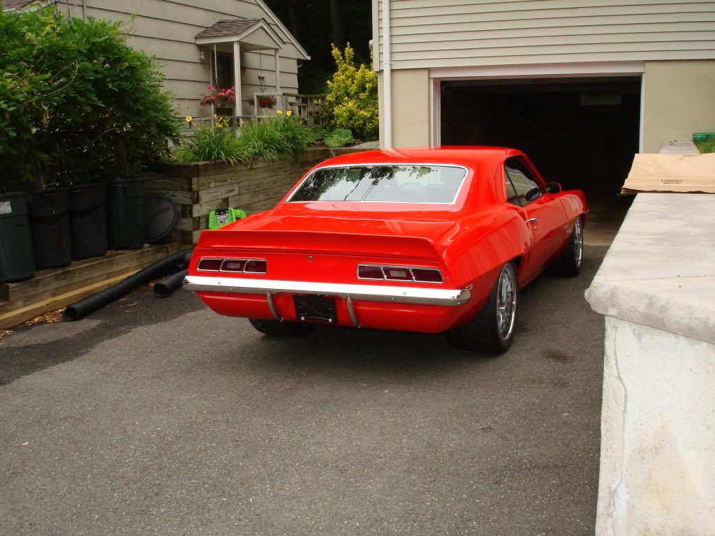

Finally got the short dumps on the mufflers, I actually cut them off a perfectly good set of magnaflow tail pipes, just for 8 inches of turned pipe with an expanded end, what a waste. They probably would have sat around my shop for the next two decades anyway.
http://i168.photobucket.com/albums/u...Picture265.jpg

Do you mind sharing what pieces you used for your intake and air cleaner?
Also, where did you source them from?
67ragtp 05-23-2011 09:58 AM
Wayne- Thanks, I do feel a lot better, it just needs to be dialed in. I will keep you posted.
ModernMuseum- Thankyou, Dont mind at all, the intake tubing is from spectre performance you can purchase through summit or jegs. One 90deg 4 inch OD alluminum tubing with a 7 inch leg- part number 97990 and one 22 deg 4 inch OD alluminum tubing with a 6 inch leg- part number 97290
The filter is K&N part number RE-0870
And an AEM dry flow pre-filter part number- 1-4001
The MAF housing and sensor is a Powermax- powerMAF 100 its basically a stock ls7 hitachi sensor with there custom housing.
I used spectre's couplers. Hope this helps- Rich

I've seen a lot of people route it this way. I'm guessing your air cleaner is routed into the void in the fender well? Do you think you're pulling in relatively cool air this way? Just curious, as I've seen people build air boxes to separate the air cleaner air from the engine bay.
67ragtp 05-23-2011 01:13 PM
If you look at the drivers side head light, just to the right of it is the grill opening and its taking in outside air. I imagine it has to be cooler than the filter being directly under the hood. Yes, the filter is almost completely under the front fender. You could build a sheet metal wall where it enters the fender isolating the filter from the engine bay, I dont think its necessary though. Scott G was very helpful when I was designing mine and informed me that it is a very dirty area and the pre-filter is a must. I would have never thought of that, I guess his filter got pretty dirty in short amount of time.

Any particular reason you pointed your exhaust inward like that? Do you think you get much more noise that way vs running it all the way to the back?

Straight down and it resonates off the pavement, can be even more annoying than the way I have it setup. By pointing them at each other and slightly down Im hoping for some slight noise cancelation. No matter how I look at it, it sucks. Also tried to direct the exhaust gas away from the inside of the wheel so I cut the angle accordingly. I would love to have full tails going out the back which would be significantly quieter but there are to many monkey bars back there. I try to do every thing I can myself with car building, exhaust systems have become my nemisis. It didn't seem obnoxiously loud while running in my basement, so it will have to do for now.

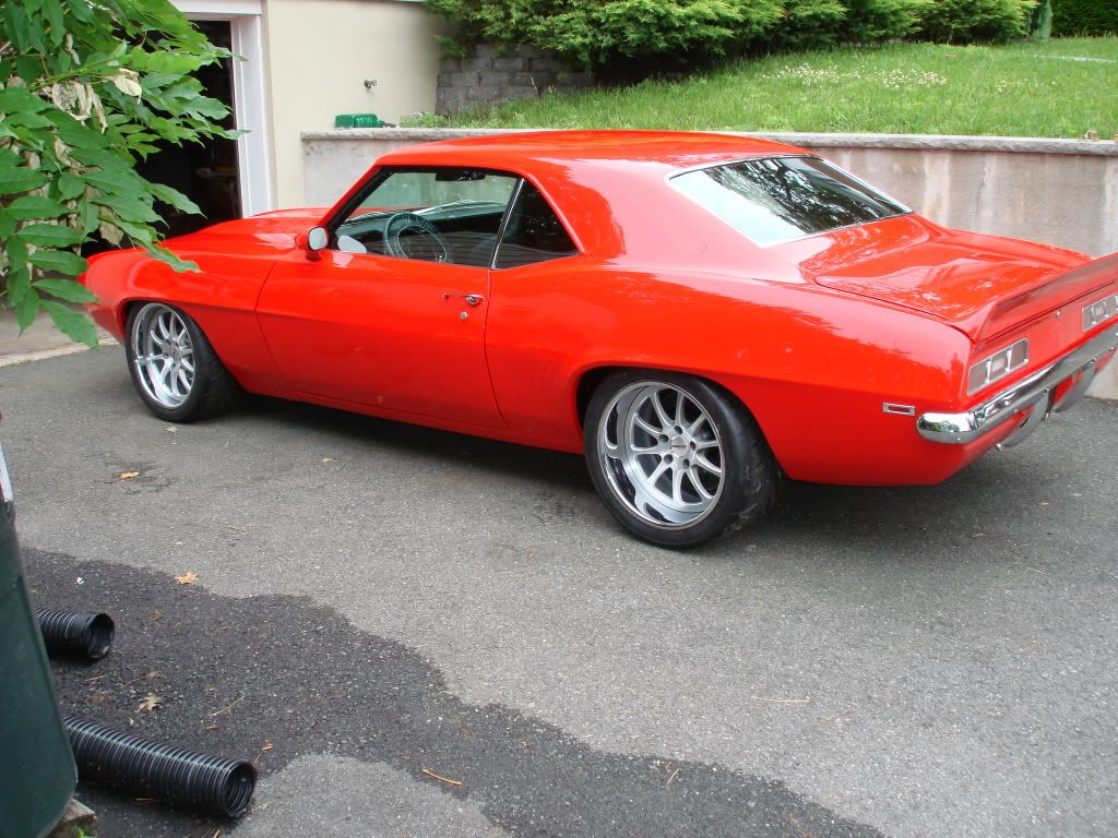

67ragtp 06-12-2011 01:37 PM
Well it finally got out on the driveway, exposed to the sun. First time since it came home from paint, one year later. Ran the engine for a while, Fan turned on at 200, I was happy to see that working properly, off at 190. The second fan never turned on, dont know what the set point is. First check was steering, couldnt move the wheel, and the brake pedal was bouncing all over the place. This is a hydraboost system so we jacked up the front end and turned the wheel a half million times and pumped the brake pedal another half million times. It feels alot better now. The hyd clutch needed 2 turns on the clevis linkage, and hopefully Im not bottoming out the master, pedal is hitting the floor board so I believe it is stopping before it hits the bottom of the master. The clutch feels good, drove up and down the driveway a few times and it seems to work nice, grabs just off the floor. I couldnt take it out for a maiden voyage since the the front fenders are practically sitting on the tires.
I think the Wilwood WS6 calipers were a poor choice on my part there just to big and the .250 spacer to clear them pushed the 10 inch forglines out enough to be to close to the edge. Ive got a little over 2 deg of negitive camber in this thing and cant get it to clear. I hope adjusting the ride height helps. My rims are a 7 inch inner and a 3 inch outer, Im wondering if I went to a 2.5 inch outer hoop making the rim a 9.5" would the 275 tire fit on it and would it be in the front fender a 1/2 deeper. If this makes sense please comment. Heres some pics almost complete outside. Thanks Rich
http://i168.photobucket.com/albums/u...Picture279.jpg
http://i168.photobucket.com/albums/u...Picture280.jpg
http://i168.photobucket.com/albums/u...Picture281.jpg
http://i168.photobucket.com/albums/u...cture282-1.jpg
http://i168.photobucket.com/albums/u...Picture284.jpg

Wow Rich...major props, she looks great from every angle! FYI, my Forgelines are 6.9" BS so I think you're right on the money. DSE does not use the C6 control arms as the AME sub on my bucket but I believe it's the same geometry and wheel clearance (i.e. 18x10). Front fender width should be very close also, which means time to roll those lips or get a diff front caliper? Keep me posted!
