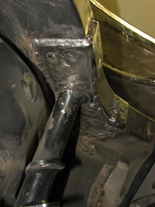

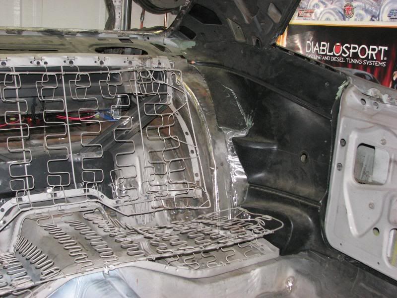

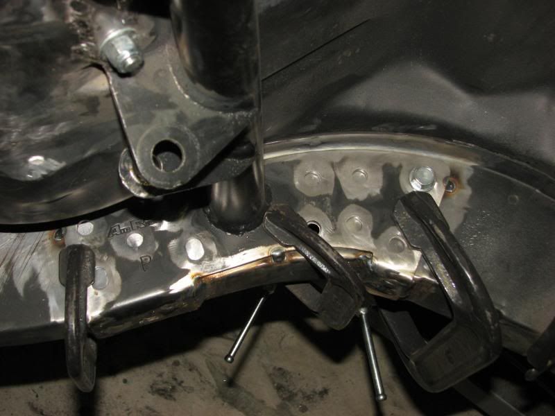

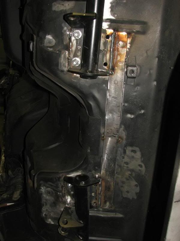

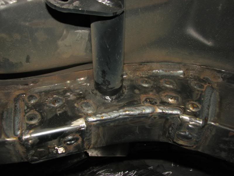

The original Air Ride brackets in the rear bolted in with self tapping bolts/screws in like 10 spots. I wasnt to keen on the whole self tapping bolts... I even stripped 2 of them when I tried to sinch them down tight. At first I was planning on keeping them "bolt in" just in case I ever want to pull them out....but I came to the conclusion of "who am I kidding...I'm not going to change the set-up". So I decided to weld them in for good. I prepped the brackets and drilled quite a few more holes.....17 total....for spot/plug welds, and welded the entirer perimeter...should be rock solid.
Original set-up...
http://i229.photobucket.com/albums/e...I/IMG_0190.jpg
All Prepped....all the powedercoat is off around the edge and holes, its just kinda hard to tell
http://i229.photobucket.com/albums/e...I/IMG_4602.jpg
http://i229.photobucket.com/albums/e...I/IMG_4593.jpg
All welded in.....not always the prettiest beads, but I'm pretty sure I got good penetration on the bracket and frame rail
http://i229.photobucket.com/albums/e...I/IMG_4608.jpg
http://i229.photobucket.com/albums/e...I/IMG_4606.jpg
There is a bracket on the inside of the car connecting the two plates, but since I was welding stuff in anyway, I decided to add a welded plate on the outside to connect the two brackets...just alittle more strength...what the hell...
http://i229.photobucket.com/albums/e...I/IMG_4605.jpg

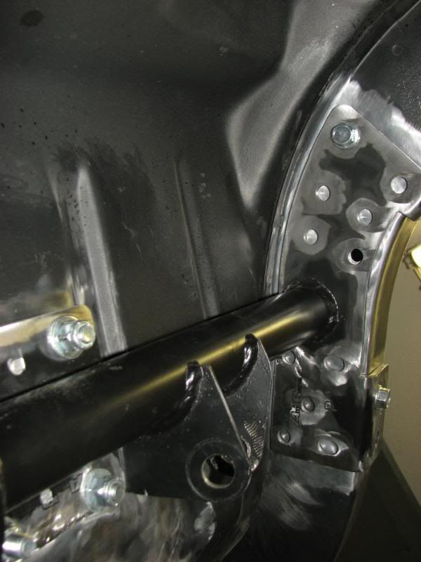

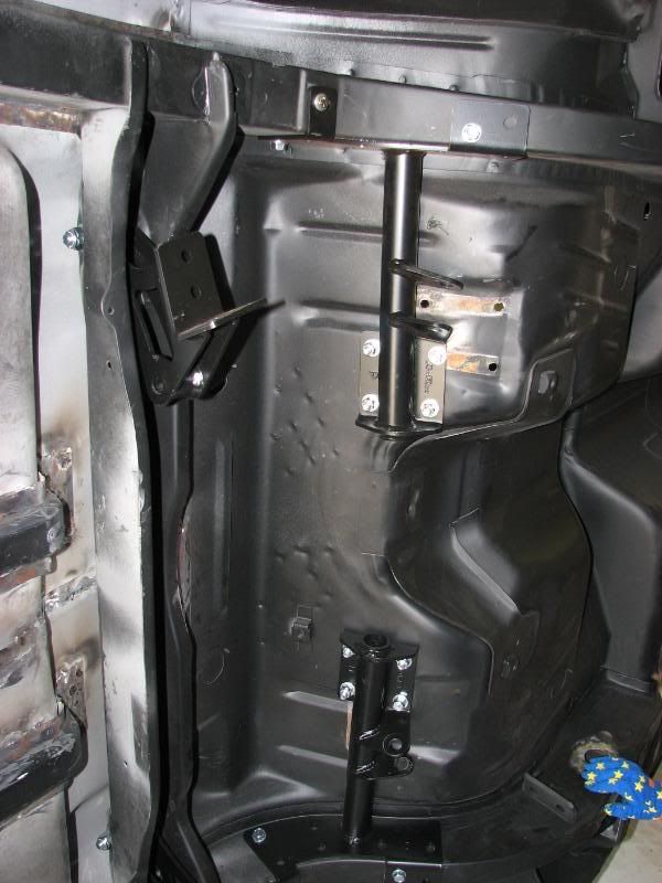

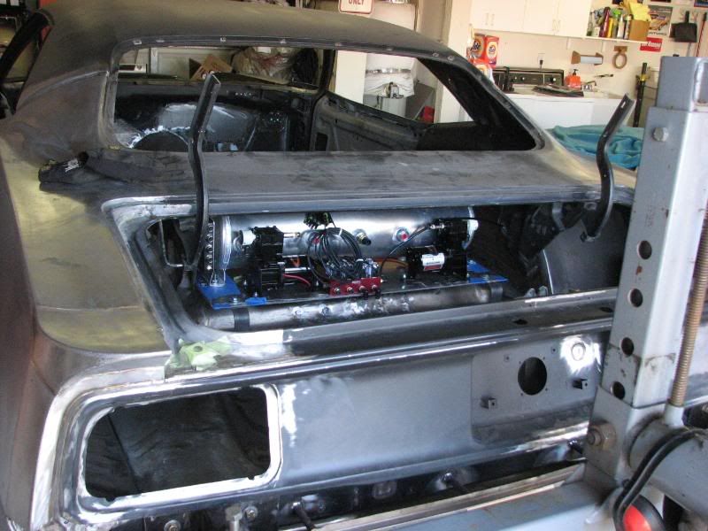

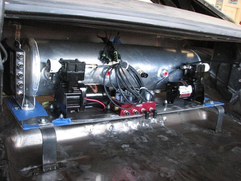

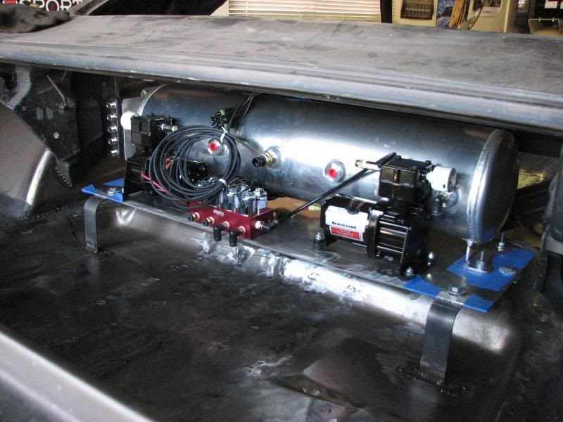

Then I got all my Ridetech compressor stuff. When I mocked everything up I had some concerns with the speaker hole in the rear deck. I do plan on having a stereo....but will probably not listen to it much :). I wanted to sink the stuff as deep into the trunk as possible to retain as much trunk as I could. But if I did, the tank sat right under the speaker hole and left about 2 inches from deck to tank...not enough for a speaker. Ridetech has a more narrow and taller 7 gallon tank, that would fit between the speaker holes, but was just a tad too tall to fit.
So ultimately I ended up mounting the stuff towards the back of the car more than I had hoped for, so I did lose more trunk than I would have liked, but its the best compromise I could come up with. I should be able to get a speaker in there. I had thought about flipping it all around, but that would put all the connections on the back and make it real hard to get to if/when I need to.

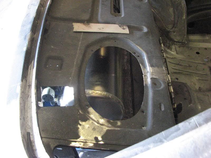

I tried to come up with a bunch of ideas for the speakers..... there isnt much room towards the outside....plus I may run a cage and need some space for the downbars..... turning them at an angle wouldnt change anything since its the magnet that is the issue. I though about going smaller, but couldnt find a decent 3 way speaker that would work. Thought about rasing them up.....I though of a 100x different option but finally just went with this.....
I also did a rough trim on the original rear panel to fit the tubs. I'm planning on using them as a good starting place for the final ones. I think I should be able to use them as the base and add some fiberglass etc etc and then get them covered. If nothing else I use them as a template.
