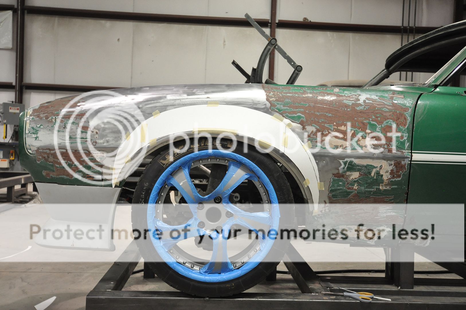

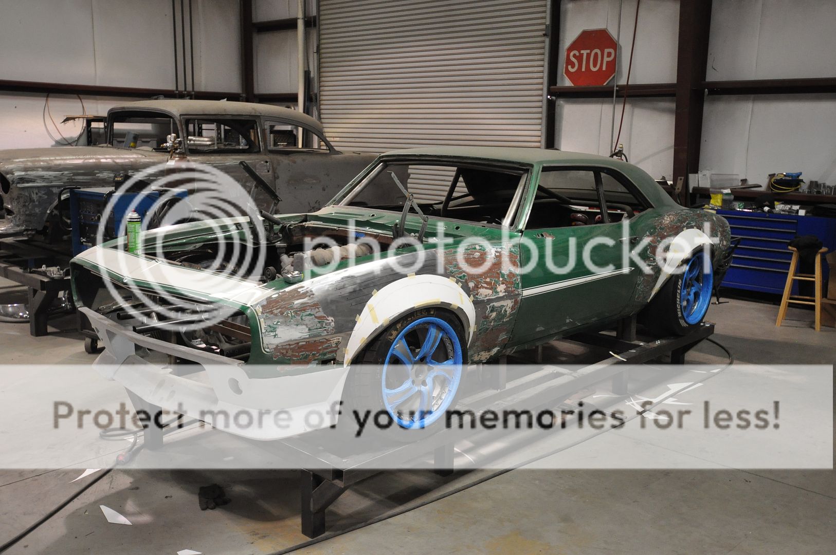

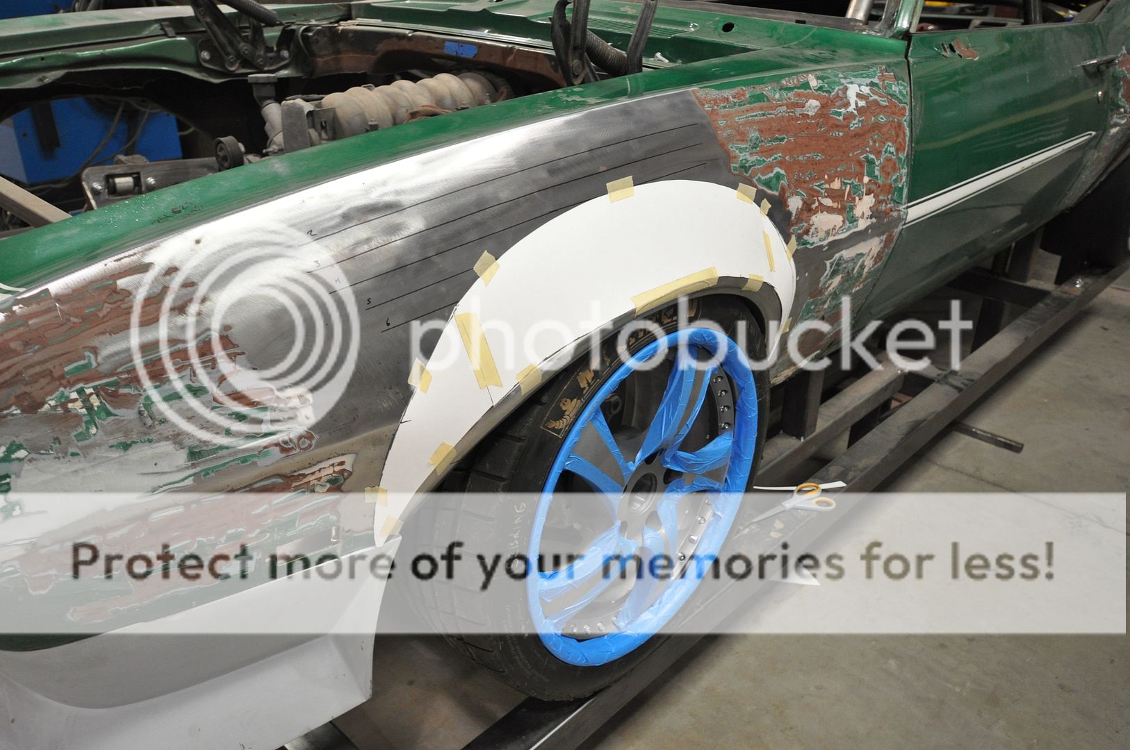

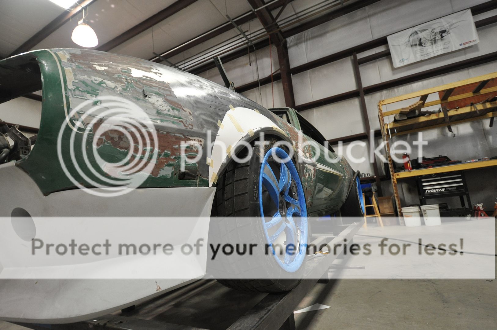

More updates. Remember- I did not choose any of the renderings to base the wide body off of. Ultimately I didn't fall in love with any of them, so we are doing a combo of a stretch with a flare. Think of a combo of the way the SCAR camaro was done with a bit of the Gulf Camaro.
Here is the car getting mocked up with flares only; we will be cutting the fenders and quarters much more to reduce the flare size and make it have more of a 'designed' look vs 1971 flares. NOTE: These are Photobucket hosted, so if you see a red X the site is blocked or we exceeded bandwidth (not likely.)
Front fender flare mock up
http://i616.photobucket.com/albums/t...ber2010001.jpg
Head on view
http://i616.photobucket.com/albums/t...ber2010002.jpg

96z28ss 12-09-2010 12:16 PM
Rodger should hire someone that designs fender flares for a living to come up with some ideas.
Just kidding those look good.
phillym5 12-09-2010 01:02 PM
Those look good.... thats how i would have done it!!

lhkustoms 12-09-2010 02:43 PM
Tyler, its lookin pretty good I think it will look awesome with the combination of a wide body and small flare. I am sure your gettin a little excited to see much forward progress. :cheers:

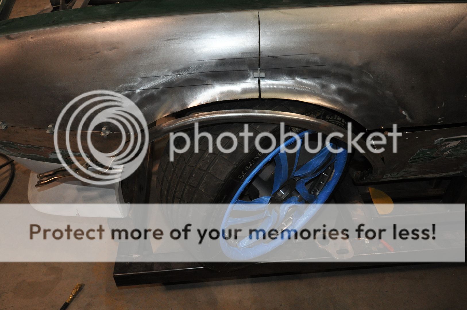

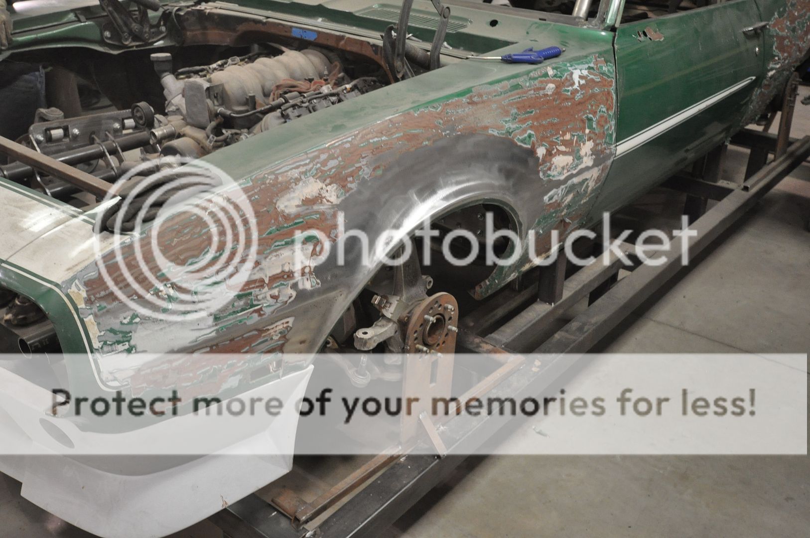

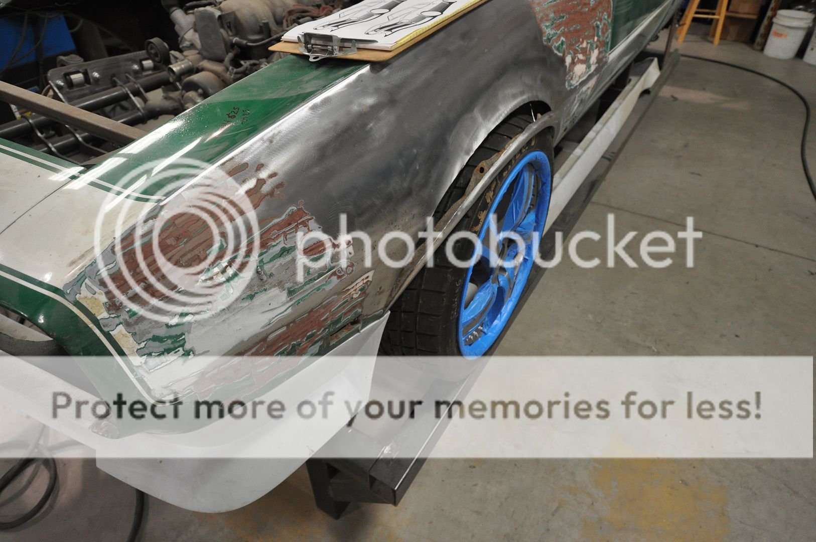

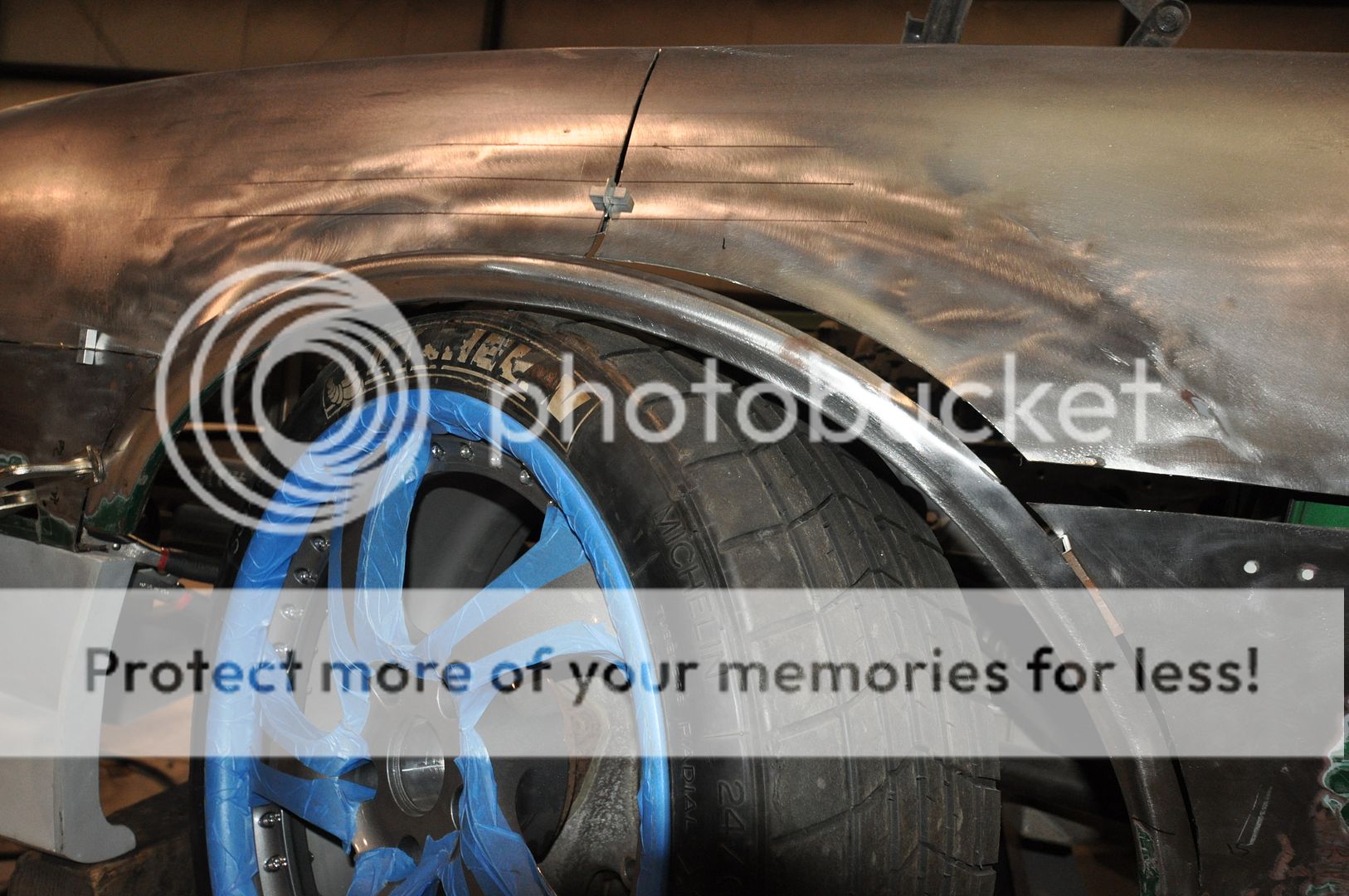

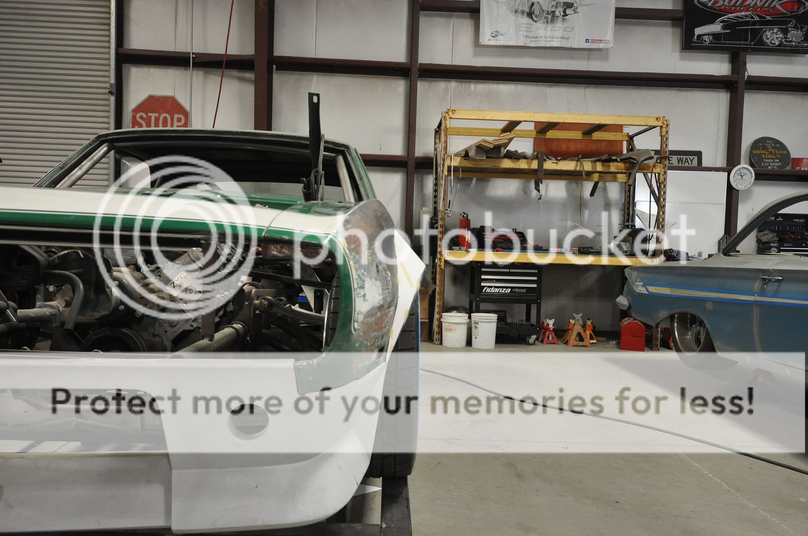

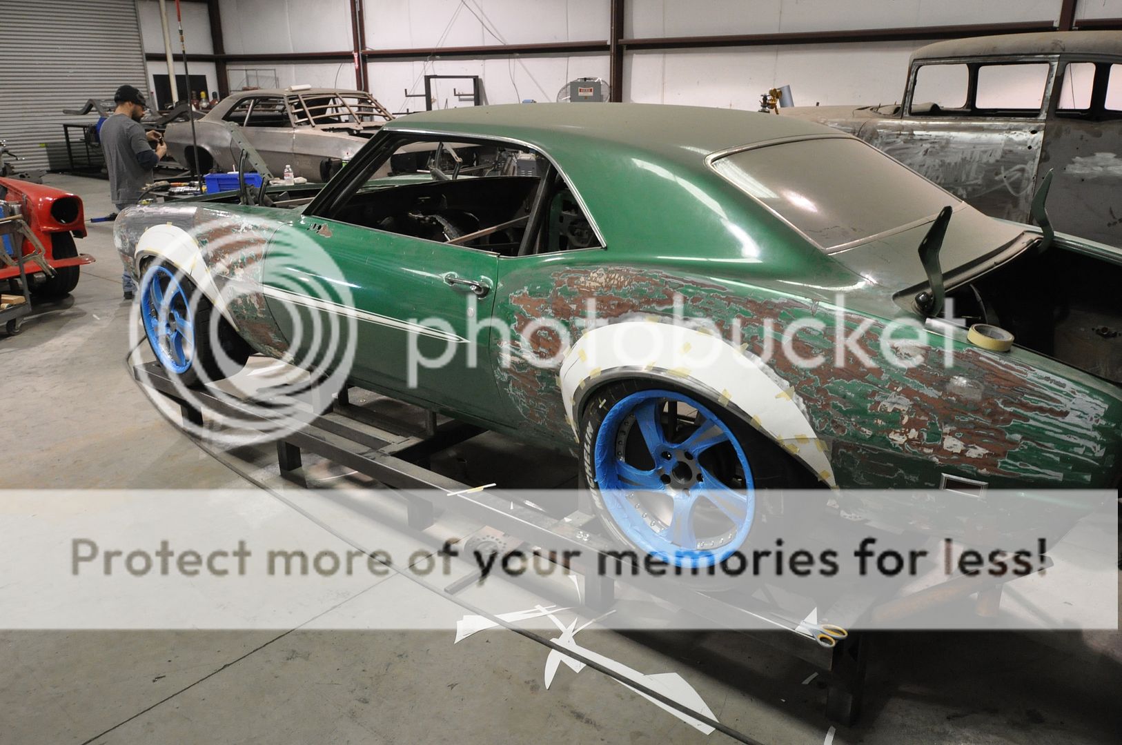

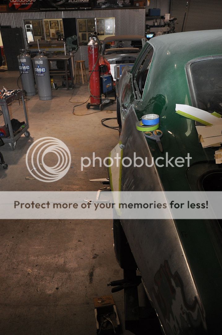

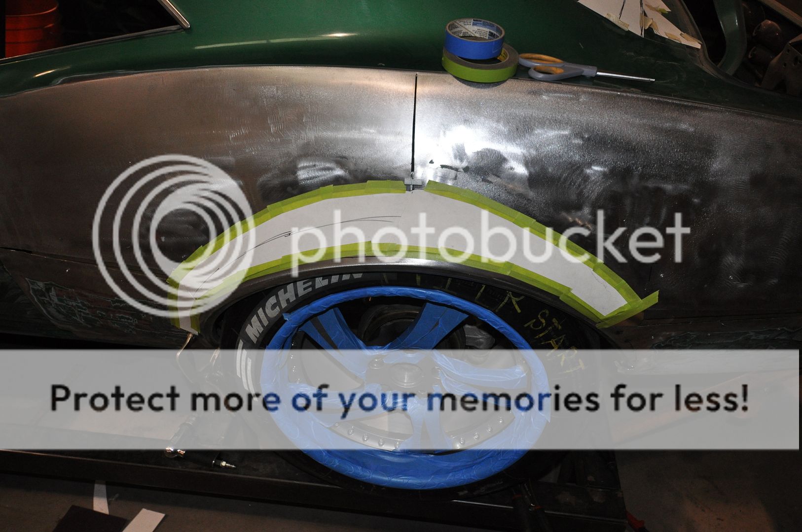

Teetoe_Jones 12-17-2010 04:01 PM

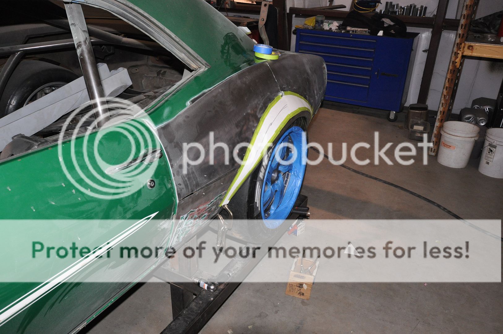

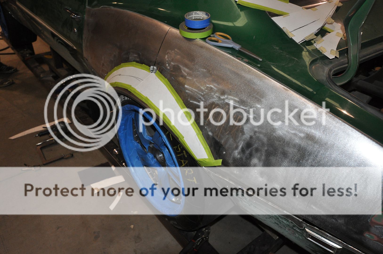

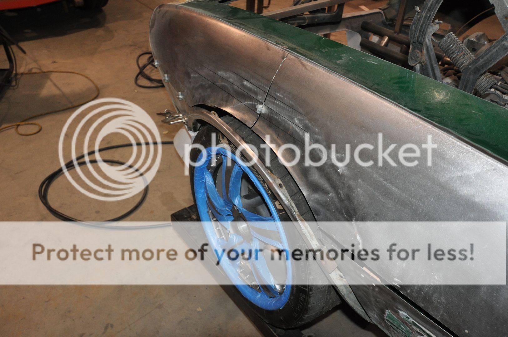

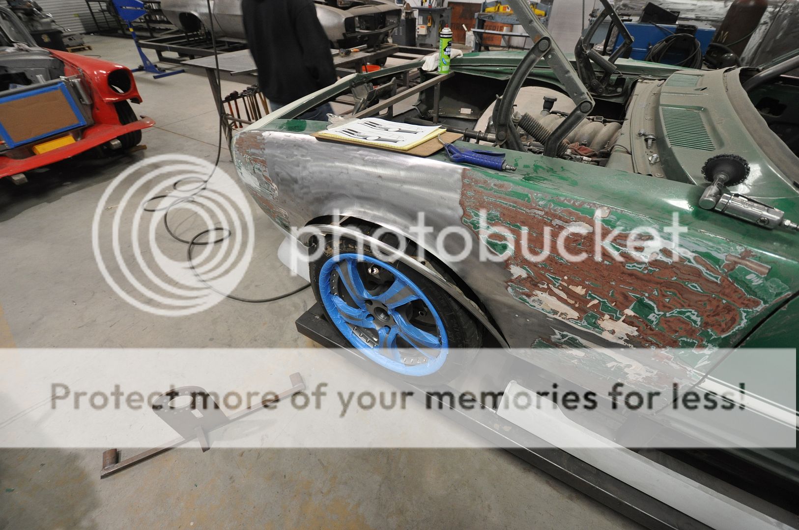

Don't get too close to Rodger, he will cut you up.
So he started the fender cuts to reduce the flare bubble size and make it appear more subtle.
He stripped the fender and rear 1/4 down to bare metal and sliced it at the 9, 12, and 3 O'clock positions to pull the body line outward.
http://i616.photobucket.com/albums/t...ber2010007.jpg
http://i616.photobucket.com/albums/t...ber2010008.jpg
http://i616.photobucket.com/albums/t...ber2010006.jpg
http://i616.photobucket.com/albums/t...ber2010010.jpg
Still working on the front, but same idea; just checking at full lock/compression-
http://i616.photobucket.com/albums/t...r2010003-1.jpg
http://i616.photobucket.com/albums/t...r2010004-1.jpg
http://i616.photobucket.com/albums/t...r2010005-1.jpg
http://i616.photobucket.com/albums/t...ber2010009.jpg
