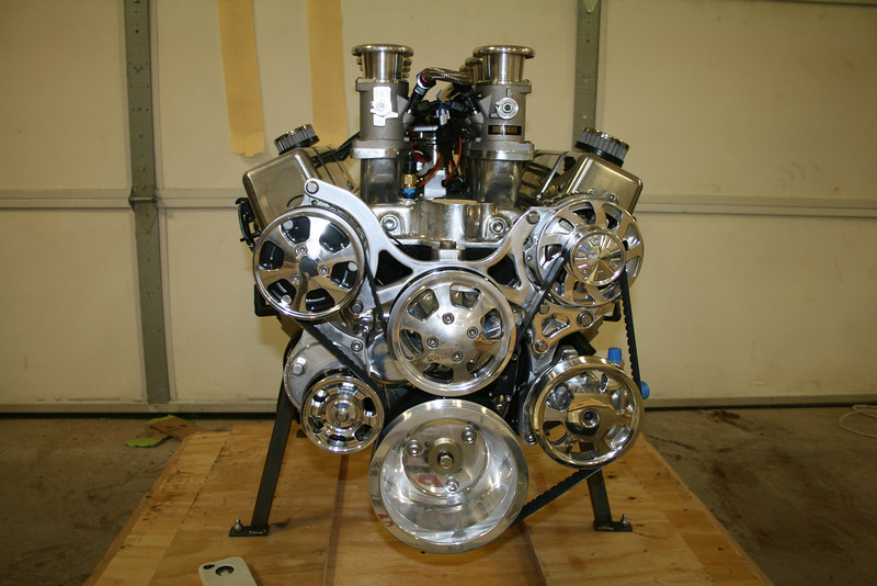

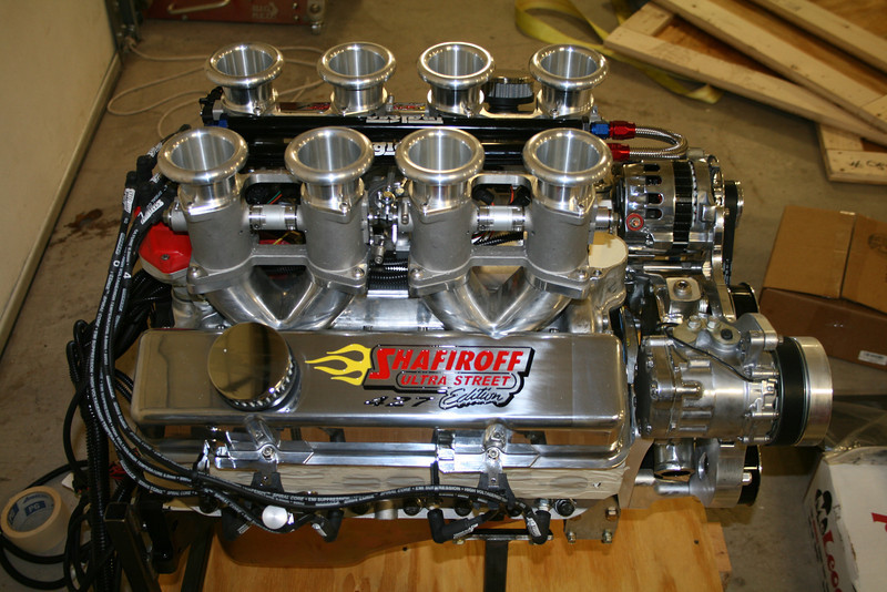

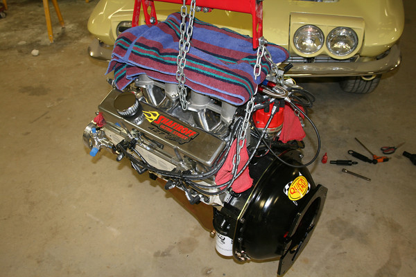

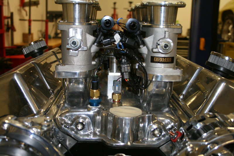

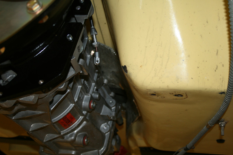

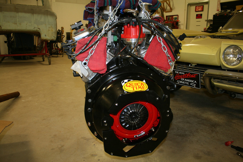

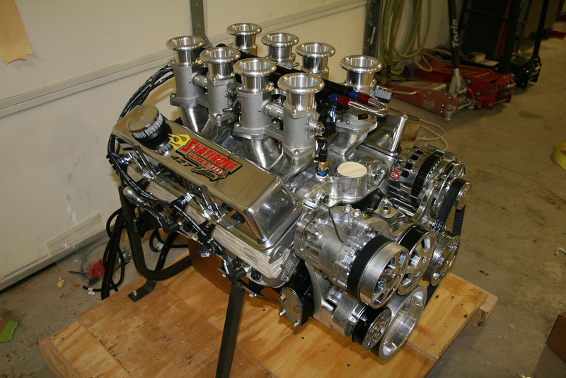

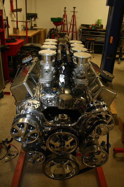

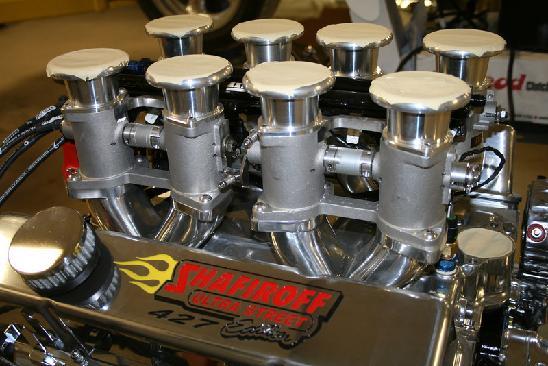

This SBC is getting installed my my 65 Corvette Coupe. It is mated to a Tremec 6sp with a final drive of .50.
Take Care - Jerry Clements
Attachment 33654
Attachment 33655
Attachment 33656
Attachment 33657
Attachment 33658
Attachment 33659
Attachment 33660
Attachment 33661
Attachment 33662
Click on the pics and they will enlarge. Im not sure what Im doing wrong to cause this problem.
