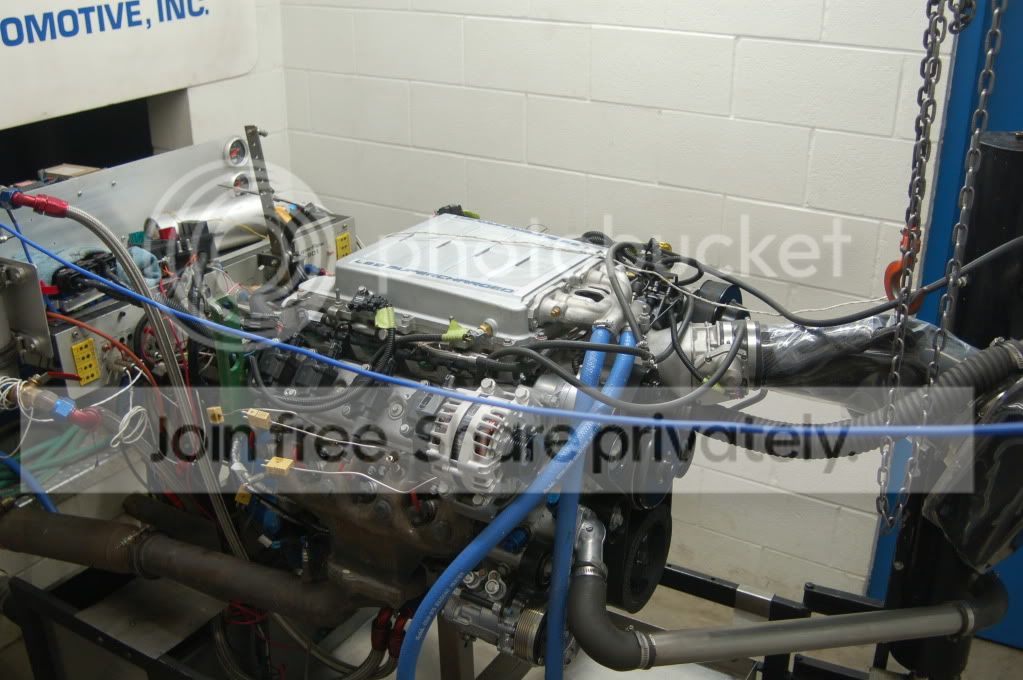

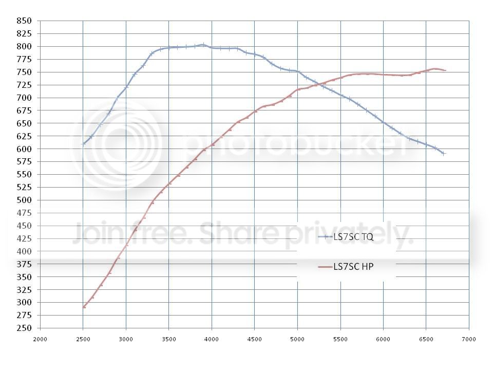

This is the dyno curve off my new engine-
http://i439.photobucket.com/albums/q...low65/dyno.jpg
http://i439.photobucket.com/albums/q...5/DSC_2987.jpg
A LS9 based engine with the following changes
7.0 L instead of 6.2 L
3 to 1 pulley ratio
LS7 Throttle body
Revised cam
Revised blower inlet
Should run good.

Autokraft 02-24-2010 04:59 PM
Wow Mark, just exactly how are you going to refrain from melting the tires off with that much power? :hail: :hail: :lol: :lol:
Vegas69 02-24-2010 05:00 PM
That's all you got?:unibrow:
GregWeld 02-24-2010 05:01 PM
Mark ---
That's a WOW..... Nice TQ numbers!
Terrible name... hope you're just kidding.
Autokraft 02-24-2010 05:01 PM
I just looked at that graph again. Over 600ft lbs at 2500??? Thats crazy!!:thumbsup:

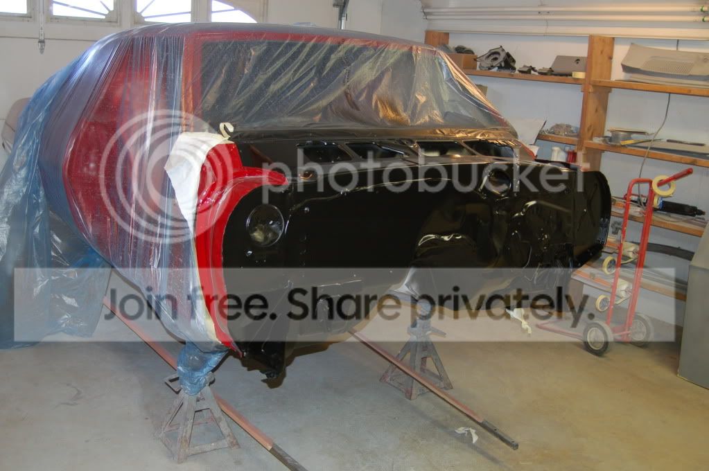

Paint update
Should get the car back from paint next week. It is all painted and Paul and Joe are doing the final assembly and rub oub out.

Stielow 02-24-2010 05:12 PM
And that is with STOCK exhaust manifolds and 93 octane fuel :thumbsup:
It idles at 650 rpm like a stocker. Ultimate sleeper.
All stock blower and intercooler bricks.
GM stuff is the best but I'm tainted. :_paranoid

customcam 02-24-2010 05:29 PM
So the dyno pull was done with Stock headers? Omg
800 ft/pds of Torque at 3800 or so :wow:

It amazes me the power and reliability these factory GM peices provide. I'm in the middle of assembling an LS7 for my Mustang, some of the parts in that engine are so far beyond anything the aftermarket had just a few years ago. Love the build Mark. Ron
Stielow 02-24-2010 05:47 PM
Yep stock stuff
Stock LS7/9 headers
LS7 block with ARP studs and piston oil squiter added
Stock LS9 unported heads with better exhaust valves
Stock LS9 blower with new inlet and pulley ratio
Callies crank less heavy metal to balance
Oliver 6.125 Rods
Lingenfelter 6 bolt flywheel for Callies crank to take LS9 clutch
Diamond brand coated pistons
Thomson Auto (http://thomsonautomotive.com) custom hyd roller cam
Thomson Auto engine cal
This is the best engine I have ever had.
I can't wait to get it done and to the track.
I don't think I can make Road America but I should be at Putnum Park.
Stielow

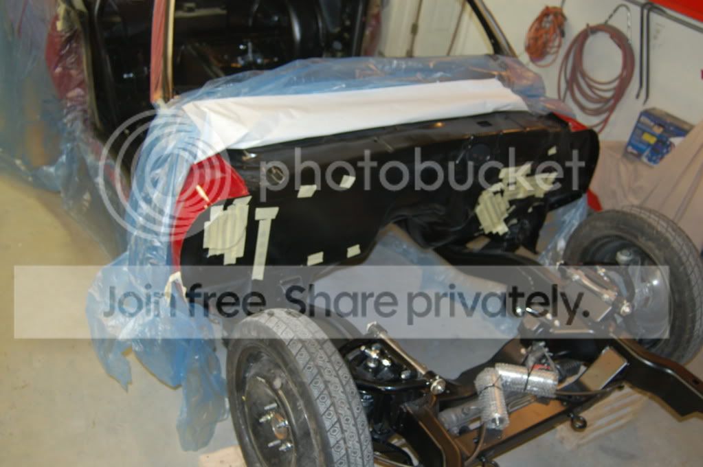

Sales@Dutchboys 03-03-2010 02:06 PM
getting close! got the doors on today and going hang the front sheetmetal tonight. then she goes back to Marks house this weekend!
http://i784.photobucket.com/albums/y...s/DSCF2584.jpg
Paul
J2SpeedandCustom 03-03-2010 02:31 PM
Looking nice and straight Paul! You must have taught your dad a few buffing tricks...:lol:
