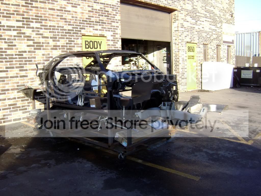

-   -   It's finally out my 69 Camaro! (https://www.lateral-g.net/forums/showthread.php?t=26298)
waynieZ 11-15-2010 07:39 AM
Looks good !
pro-touring.no 11-25-2010 11:43 PM
Can't wait to see this ride
:thumbsup: it will be a killer
DOOM 11-26-2010 05:50 AM
It should be Kjell its an exact copy of yours....:D
