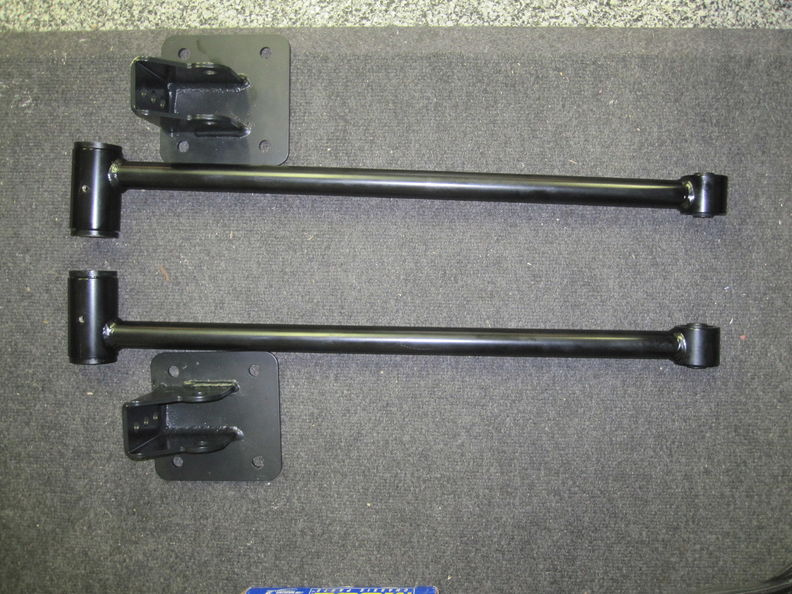

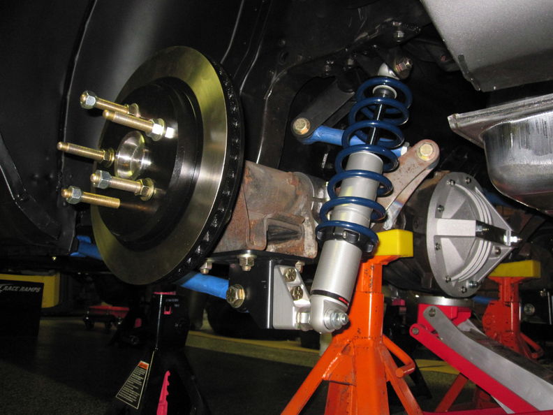

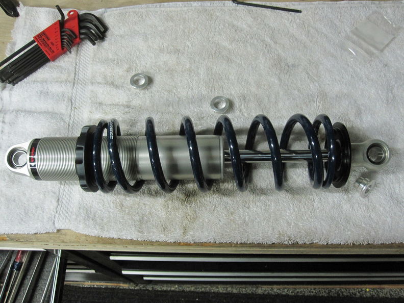

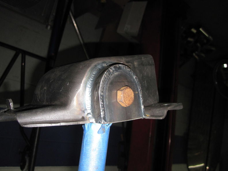

Good Morning all,
For the rear suspension I upgraded to the Ride-Tech Coil Over set up. However we've added a few new
parts that Ride-Tech offers. First is there offset lower link bar and offset spring mount which gives you an
extra 3/4" of tire room. There will be plenty of room to fit the BFG 295 (12.5" wide) and most 315's.
http://garagescene.net/_data/i/uploa...2652e18-me.jpg
There new Coil overs - what else do I need to say.
http://garagescene.net/_data/i/uploa...6dd5715-me.jpg
Very Simple Install.
http://garagescene.net/_data/i/uploa...821bf02-me.jpg
Okay Plan B

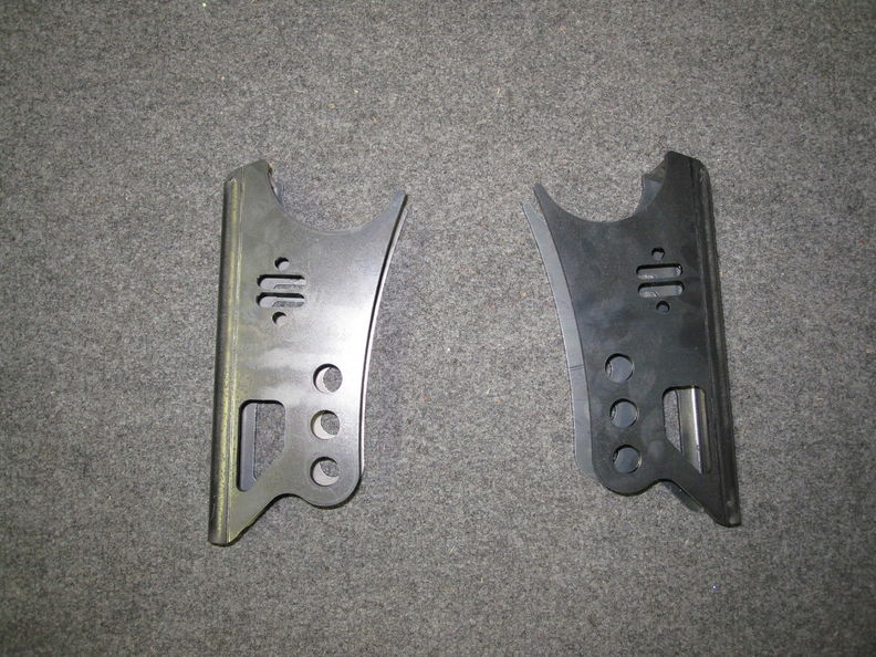

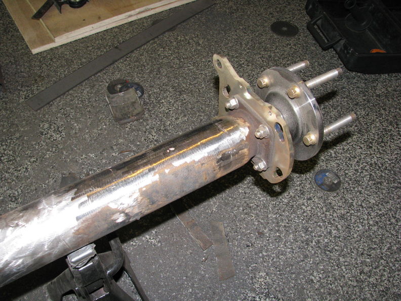

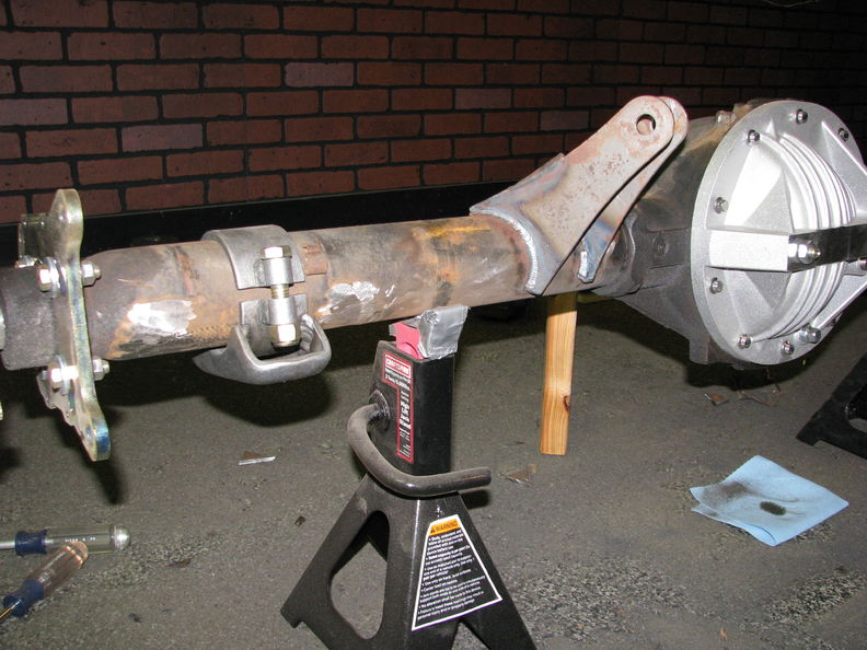

Yes I am changing things just a little. I am going to remove the factory spring perch and install Ride Tech's
new weld on lower bracket. I think they are going to clean up the area. The plan is to move the arm over
another 1/2 which will allow me to fit the BFG 335. It will also allow me to fit the Michelin 345 which is an 1"
narrower then the BFG 335.
Before I bring the car to High Speed Welding I am going to cut off the spring perch's off the axle.
http://garagescene.net/_data/i/uploa...80bc5ad-me.jpg
http://garagescene.net/_data/i/uploa...0d869bc-me.jpg
In order to get it back to High Speed Welding I used some of my extra parts. This cool little part came from
DSE. Originally I was going to keep the leaf springs but since they wouldn't sell me the front spring pocket
parts I needed that idea was soon scrapped. I made a quick call to Ride-Tech and purchased there
complete rear kit. So if anyone needs these brackets there just sitting on a shelf at my shop.
Priced to sell cheap !!!
http://garagescene.net/_data/i/uploa...bc02bb9-me.jpg
http://garagescene.net/_data/i/uploa...1b9a759-me.jpg
Ready for Transport
http://garagescene.net/_data/i/uploa...e43042d-me.jpg
http://garagescene.net/_data/i/uploa...84d91c5-me.jpg

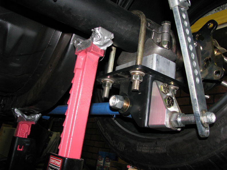

Here are the new brackets from Ride Tech. They are really going to clean up the area.
http://garagescene.net/_data/i/uploa...995da70-me.jpg
Pictures hosted by www.garagescene.net
coolwelder62 04-15-2012 08:03 PM
Marty,I love the new weld on bracket's Ride Tech is offering.They are very nice pcs.And priced right too.:thumbsup: :thumbsup:
syborg tt 04-16-2012 10:46 AM
2nd Chance Camaro - Ride Tech Coil Over Rear Suspension Part II
2012 04-16 Update - Ride Tech Coil Over Rear Suspension Part II
www.2ndchancecamaro.com

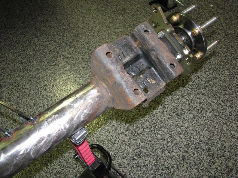

http://garagescene.net/_data/i/uploa...52ea2e0-me.jpg
Here is what the bracket looks like when it is removed.
http://garagescene.net/_data/i/uploa...4a82933-me.jpg
I need to thank a couple people here.
Mario from US Collision for letting me borrow his 345 Michelin tire and Chris at JCG Customs www.jcgcustoms.com for letting me borrow his 3 finger wheel tool. The 345 fit perfectly after this very simple modification.
http://garagescene.net/_data/i/uploa...cf0eeda-me.jpg
http://garagescene.net/_data/i/uploa...921f582-me.jpg
The new Ride Tech lower bracket installed. Much cleaner look and no more ugly u-bolts.
http://garagescene.net/_data/i/uploa...d2a70ab-me.jpg
