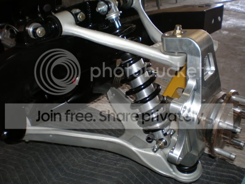

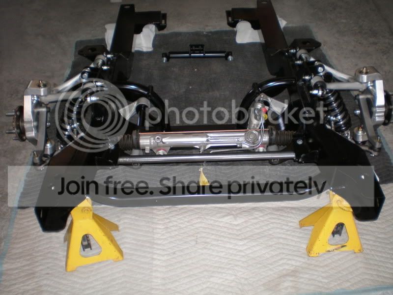

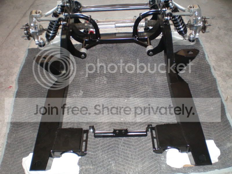

Ron in SoCal 06-29-2011 04:19 PM
How about a little eye candy?
http://i885.photobucket.com/albums/a...olFrame001.jpg
http://i885.photobucket.com/albums/a...olFrame005.jpg
http://i885.photobucket.com/albums/a...olFrame004.jpg
http://i885.photobucket.com/albums/a...olFrame002.jpg
http://i885.photobucket.com/albums/a...olFrame003.jpg
http://i885.photobucket.com/albums/a...olFrame007.jpg
MODO Innovations 06-29-2011 04:39 PM
I really like the red pinstripe. Great job.:thumbsup:
96z28ss 06-29-2011 04:56 PM
Where did you get the billet uprights?
GregWeld 06-29-2011 05:21 PM
Who's sub is that Ron??
Vegas69 06-29-2011 05:24 PM
Looks like a Wayne Due.
Gandalf 06-29-2011 05:26 PM
That be one of them fancy Art Morrision sub frames ;-) Lookin' good Ron.
G.

Ron in SoCal 06-29-2011 05:56 PM
Thanks Shannon!
What that is is an AME sub w their HD adjustable sway bar, LG Billet Spindles, Pfadt Poly bushings and Lower BJ. Travis modified the Spindles to work as AME does and designed/oversaw the custom billet steel steering arms for the modified geometry. Arms are powdercoated silver and the uprights are cleared. It really was a big a** project. BTW, thanks to Trav, Rupp, AME Matt and Fernando (Killer67)...:thumbsup:
ZR1 hubs are sitting at home waiting to be put on!
Iowa public schools in the house. I half expected you to say it's a Scott Mock..:lol:
G.
Thx G. I knew you'd spot it first! It kinda freaked me out when I saw the rack arms about an inch and half forward of the rack. Matt calmed me down though...:lol:
Originally Posted by GregWeld (Post 356977)
AH HA --- that's why it looked so familiar -- I had a Wayne Due with C5....
GW - I am not 100% positive, but I think there's some connection WD->AME. Maybe you can refresh me on that?

having everything finished on that sub makes it pure car porn!
and those uprights are sexy!!!

LG uprights
Are those the ones with the 1 inch drop built in? Pretty cool stuff right there.

Ron in SoCal 06-30-2011 08:00 AM
Exactly. The genesis was that I got the render and was talking w Matt and JCG Cris about ride height. Cris (the man) said 'no prob Ron, we can do anything you want.' AME has some low cars on their site, but Matt thought drop spindles would be the best approach and put me onto LG. The 1" drop in a c6 spindle does not have the same issues as what you see on a stock spindle; basically the same geometry can be achieved with a lower COG. Mr Rupp really had the roadmap on this so we started talking about design/weak points - one fix creates a new issue to look at so I had to go all in. Turns out LG has some track proven stuff and recently came out w these extruded pieces which made them within my reach. Fernando sourced them for me. Really a team effort.
BTW, I used full height body mounts but I know I'm in a world of hurt on my tunnel and inner fenders. Pretty sure the tubs and rear suspension is fine. Oh well, add two more items to the punch list...:yes:

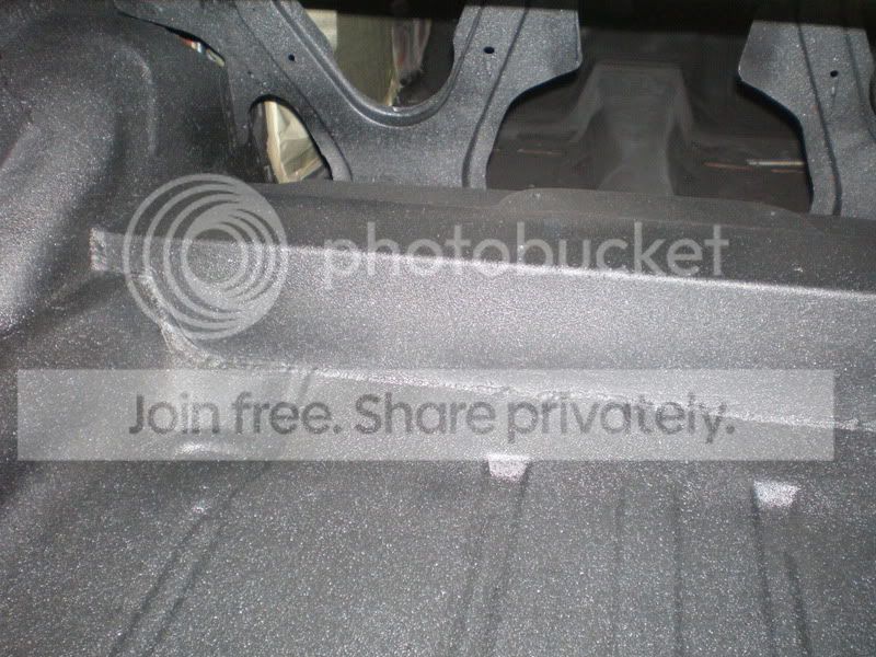

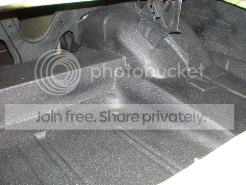

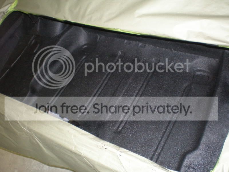

What Brand undercoating did you use? came out very nice :thumbsup:
