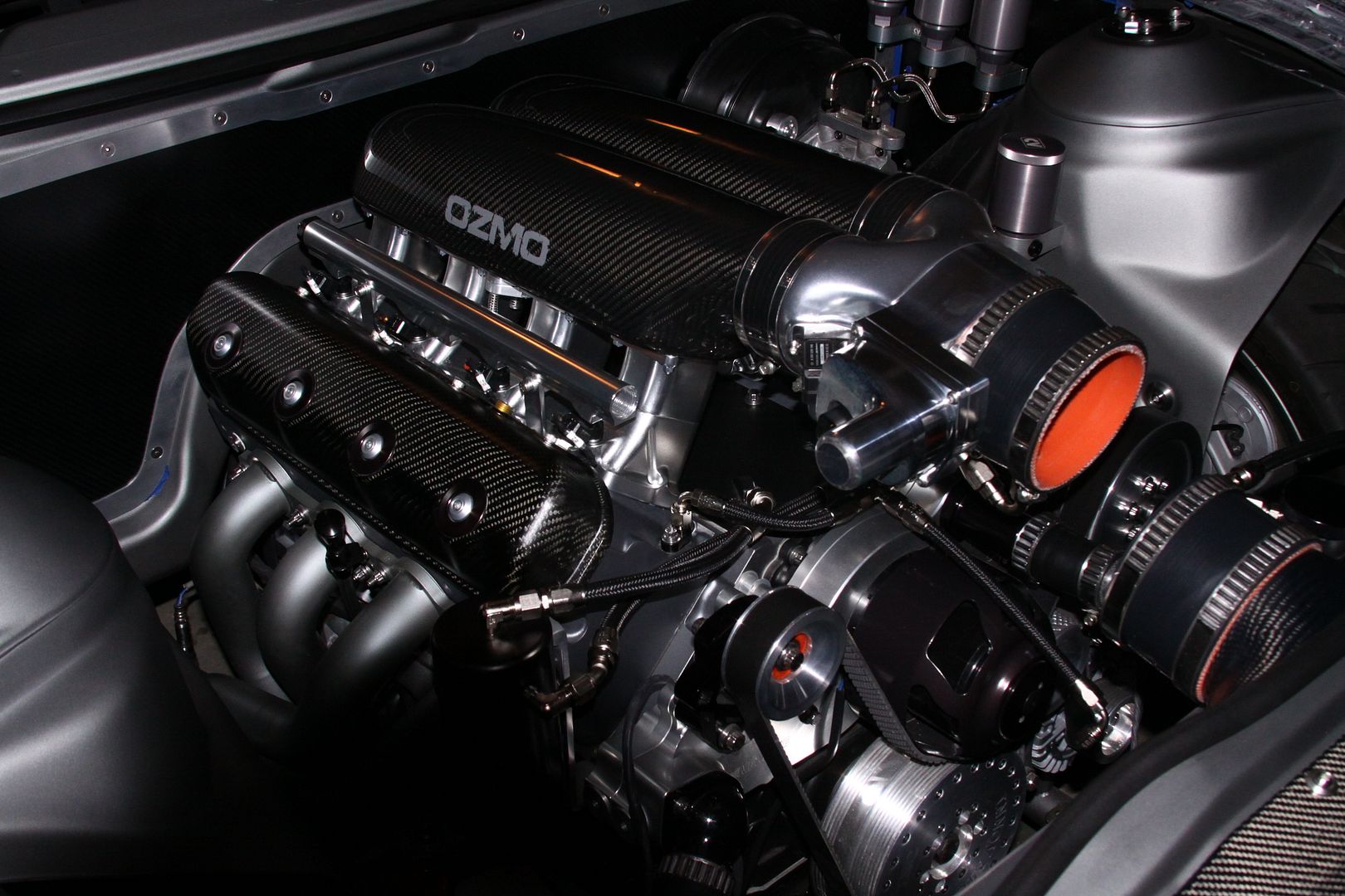

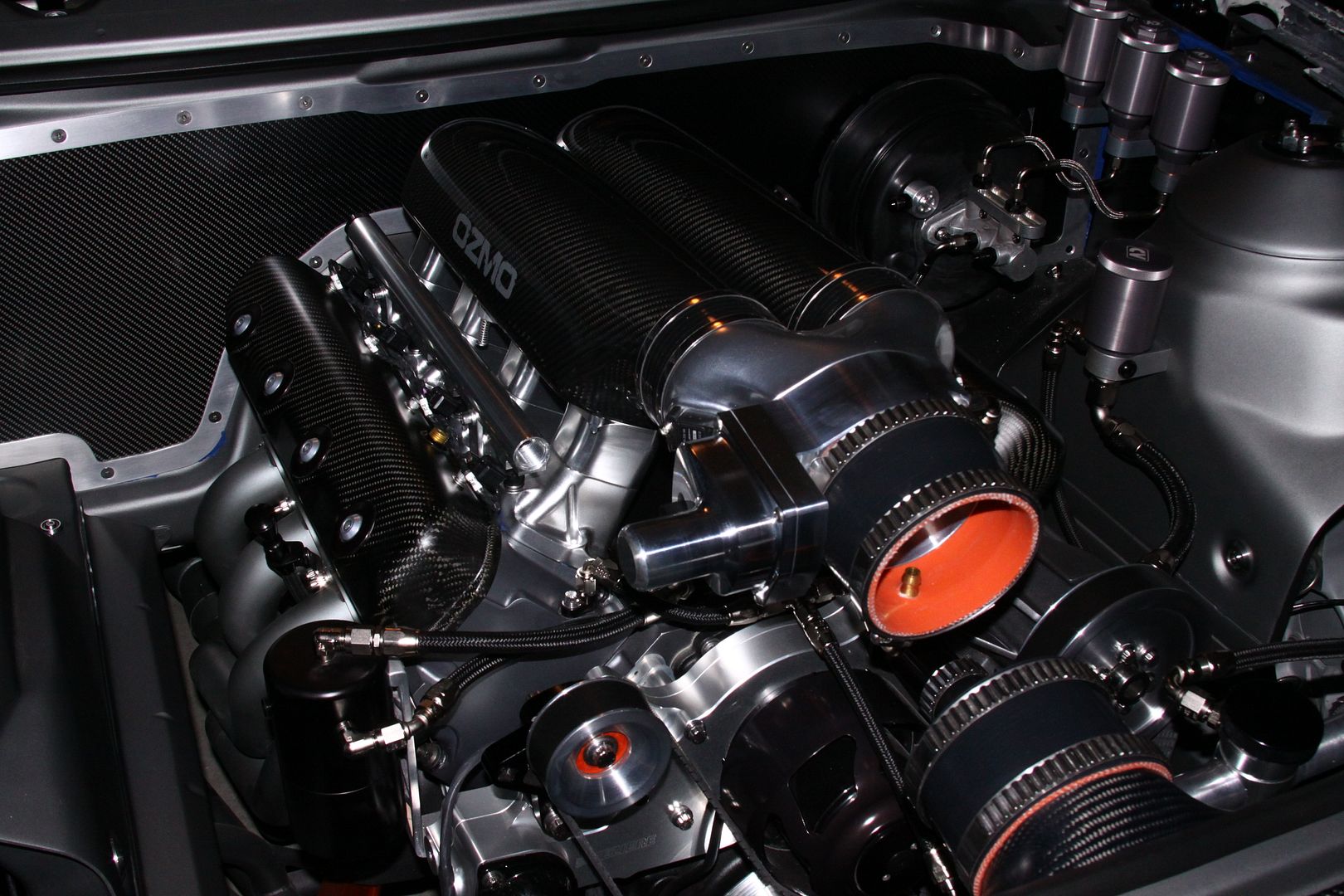

Beautiful!! The intake is slick! Where do you get those radiator hose clamps?
Thanks in advance!

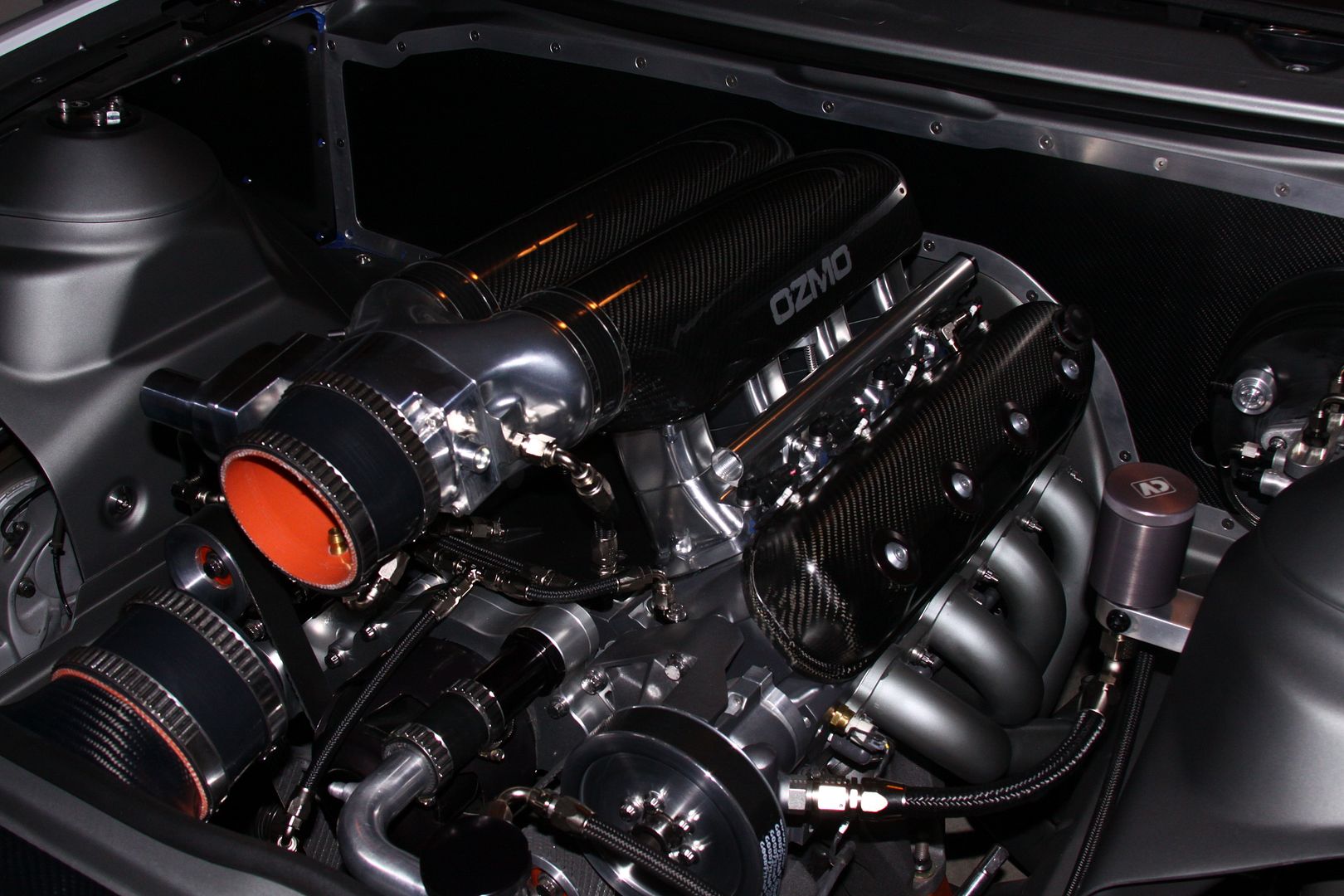

Sometimes "less" is "more"..... I'd vote for mounting the rails on the inside so as not to distract from the best million dollar intake in the Universe!
Love ya AL!
GW
Ron in SoCal 02-08-2014 12:03 PM
Greg wouldn't that require removal of the intake just to get to the injectors? Of course, if it's just a showcar then who cares : D
GregWeld 02-08-2014 12:05 PM
How many times anyone on here had to mess with their injectors....
I've had EFI cars for years now -- never had to mess with 'em after the build was done and tuned.

Awesome looking intake. I like them on the inside too but outside won't detract anything.

It is! Is there any info what kind of low speed / street manner it has? Can it be used with stock cam ?

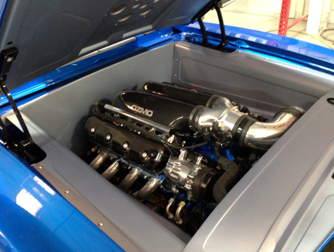

Al asked if I could respond to this question regarding the intake manifold: We designed this intake primarily for street guys who want good midrange torque, whilst still maintaining high flow for high HP.
Anytime you make a change to the heads or intake, a custom cam should be specified for maximum performance. That said, the runner length on this intake is only about 1" shorter than a stock GM LS7 manifold and will work well on a stock cam.

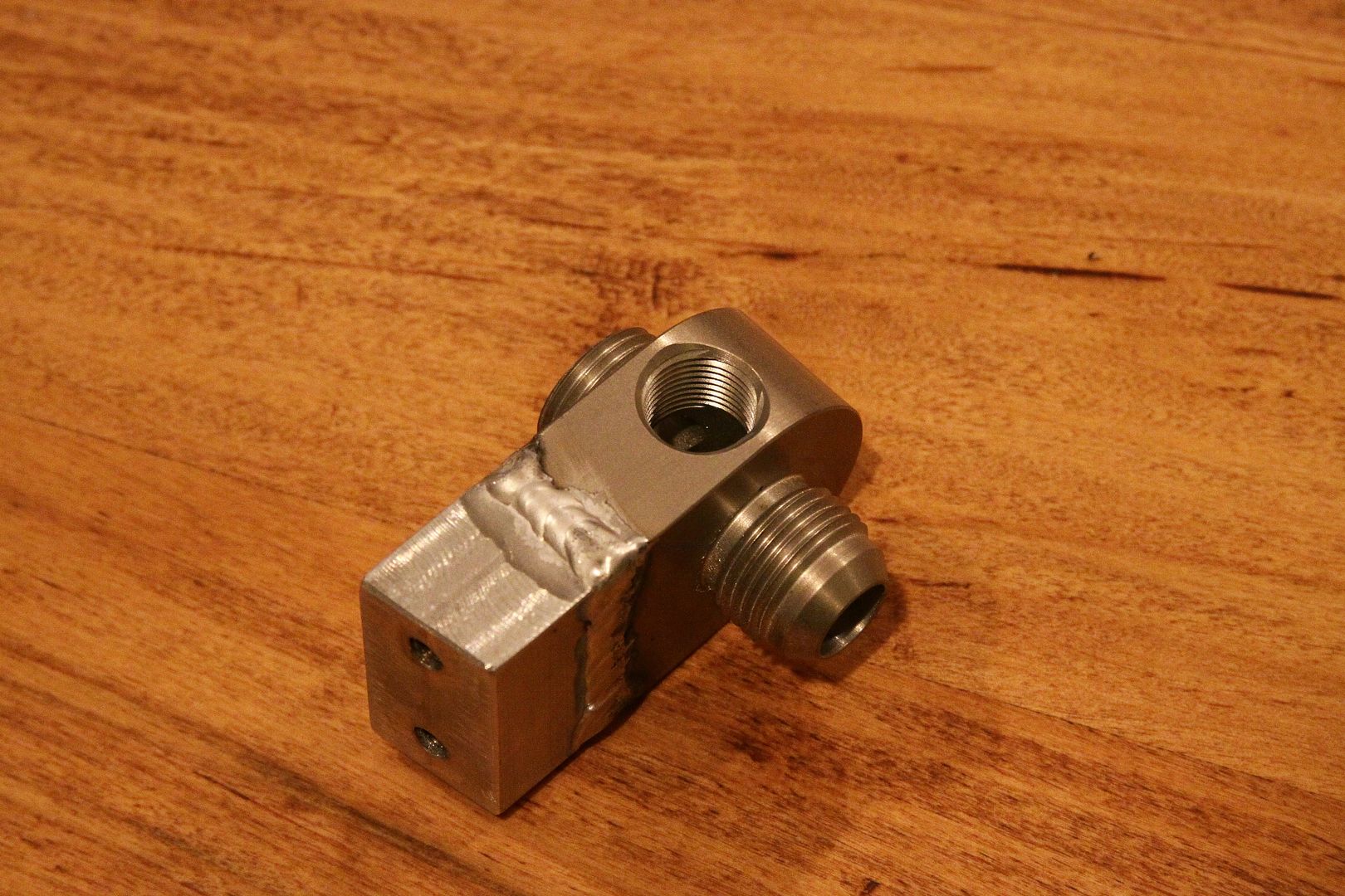

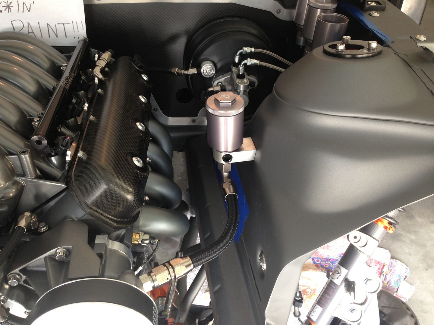

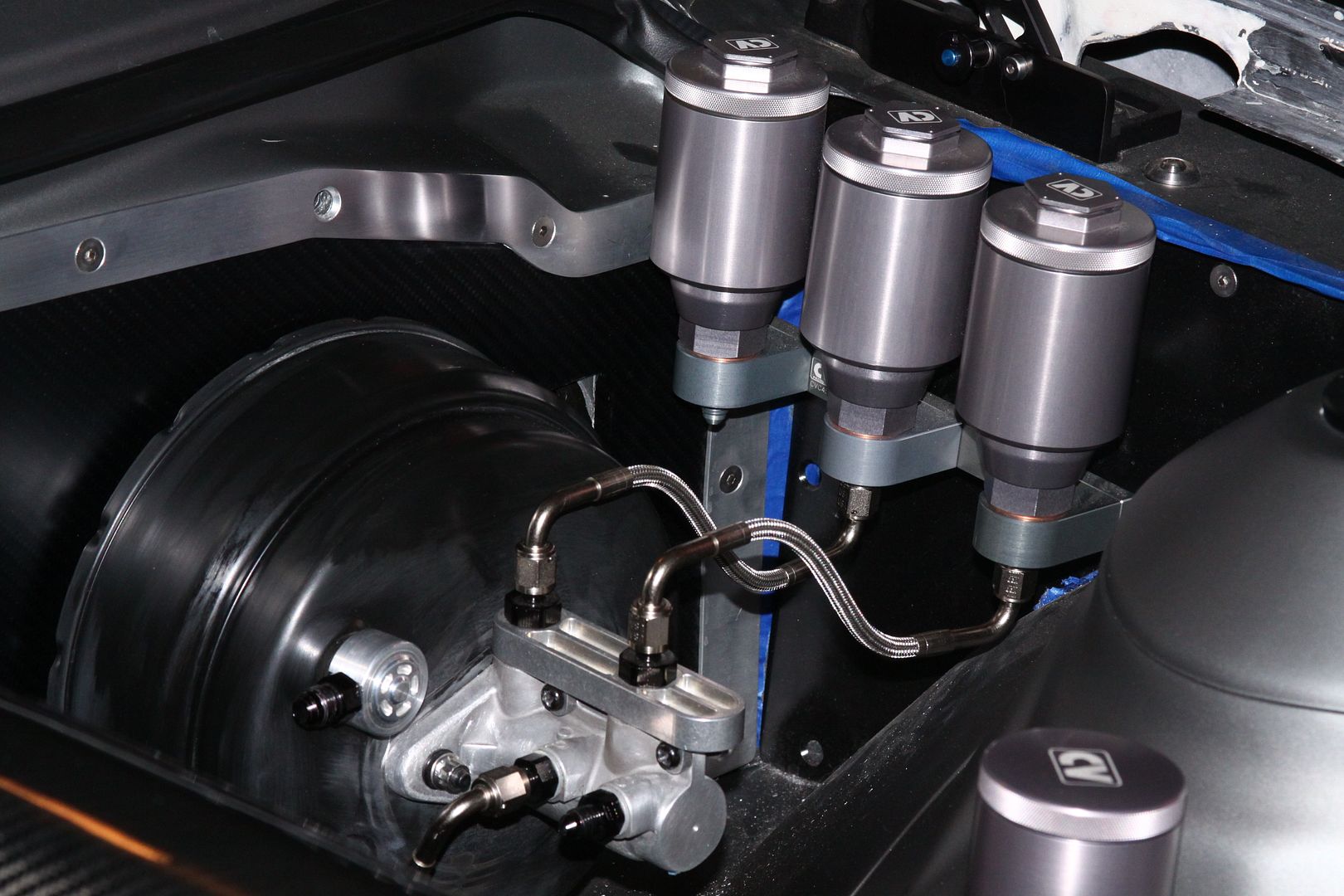

Speaking of details......
The plastic factory PS tank wasn't in keeping with the rest of the project so a CV kit was ordered.
http://i1231.photobucket.com/albums/...ps07722170.png
The kit brings two sets of bracket to giving different mounting options. Unfortunately neither of the two brackets worked with the fifth gen setup.
So it was decided to mount the tank remotely. Unfortunately again the piece the tank mounts to was to short to mount it to the shock tower. So it had to be extended.
My buddy at HM Racing and Design milled a piece to weld onto the CV piece.
http://i1231.photobucket.com/albums/...psc1aa3681.jpg
The two pieces were then welded together. The back side was given an angle cut to match the slope of the shock tower. Holes were drilled at the same angle as the shock tower so that the bolts would sit flush to the sheet metal.
http://i1231.photobucket.com/albums/...psa2c57776.jpg
Finally the boys smooth it out so it would like look like it came that way from CV.
http://i1231.photobucket.com/albums/...psbc70ff99.jpg
And finally the almost finished product.Still need to get anodized.
http://i1231.photobucket.com/albums/...psd95220be.jpg
Lot of work went into making something look so simple. What I covered was just the high lights.

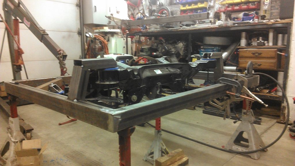

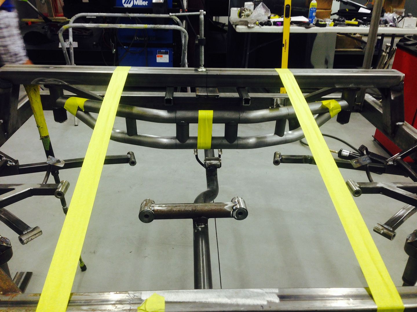

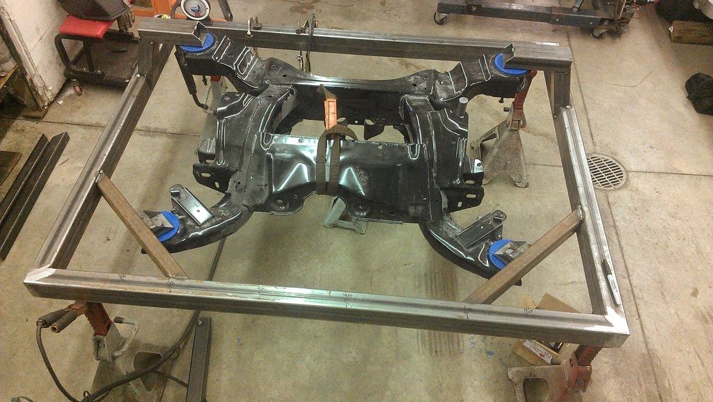

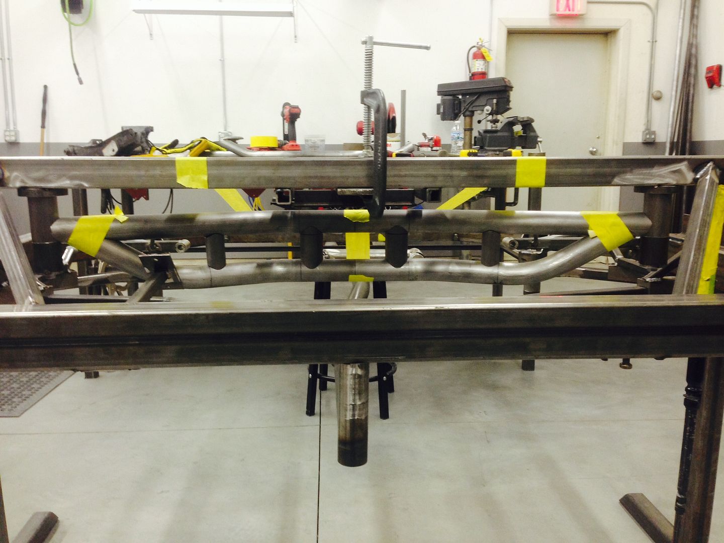

The stamped factory rear cradle is being replace with a custom chrome-moly tubular deal.
Here are a couple of pics of the jig being fabricated. Should drop another 60 - 70 lbs.
http://i1231.photobucket.com/albums/...ps46c6d9eb.jpg
http://i1231.photobucket.com/albums/...psaff16a07.jpg

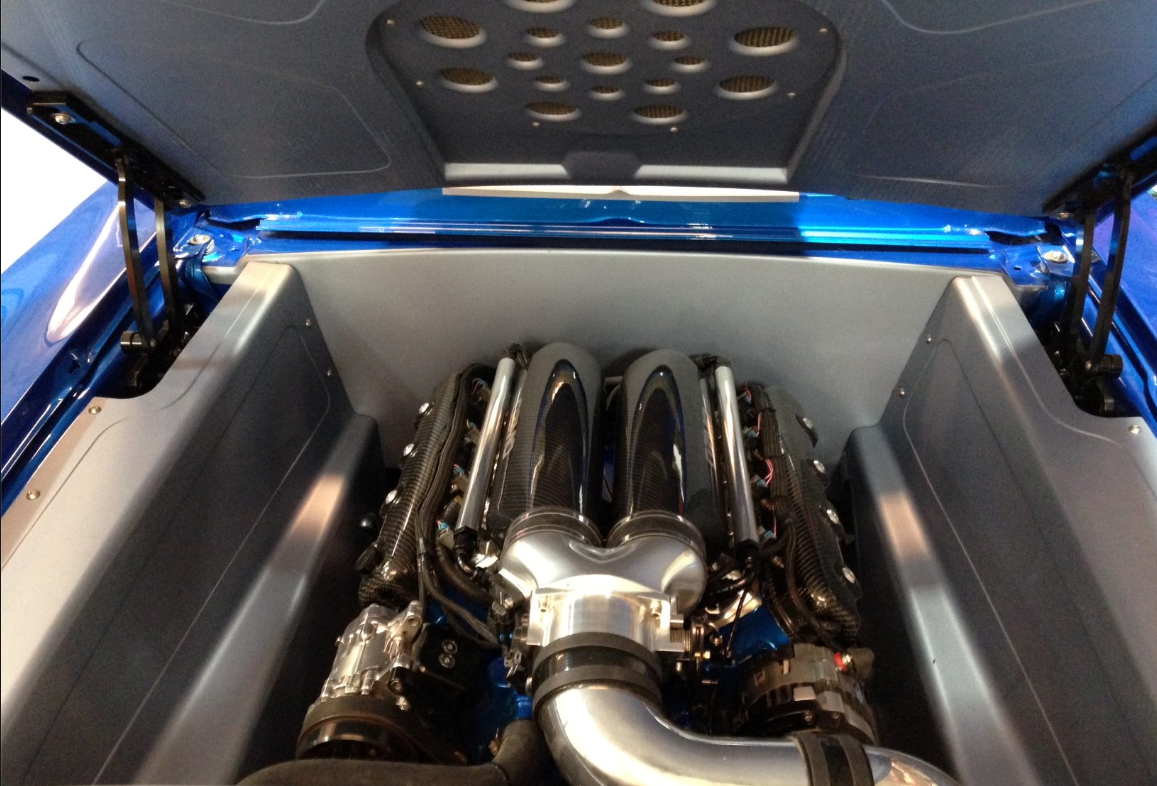

The new OZMO and NW TB are in. Jamie (Owner) said it's his favorite intake. The boys are still giving it their touch". Some guys can't leave well enough alone, LOL. Jamie is also milling a billet valley plate. Should be here in a week or so.
http://i1231.photobucket.com/albums/...ps317168b1.jpg
http://i1231.photobucket.com/albums/...psc31146d8.jpg
http://i1231.photobucket.com/albums/...psd8d0af17.jpg

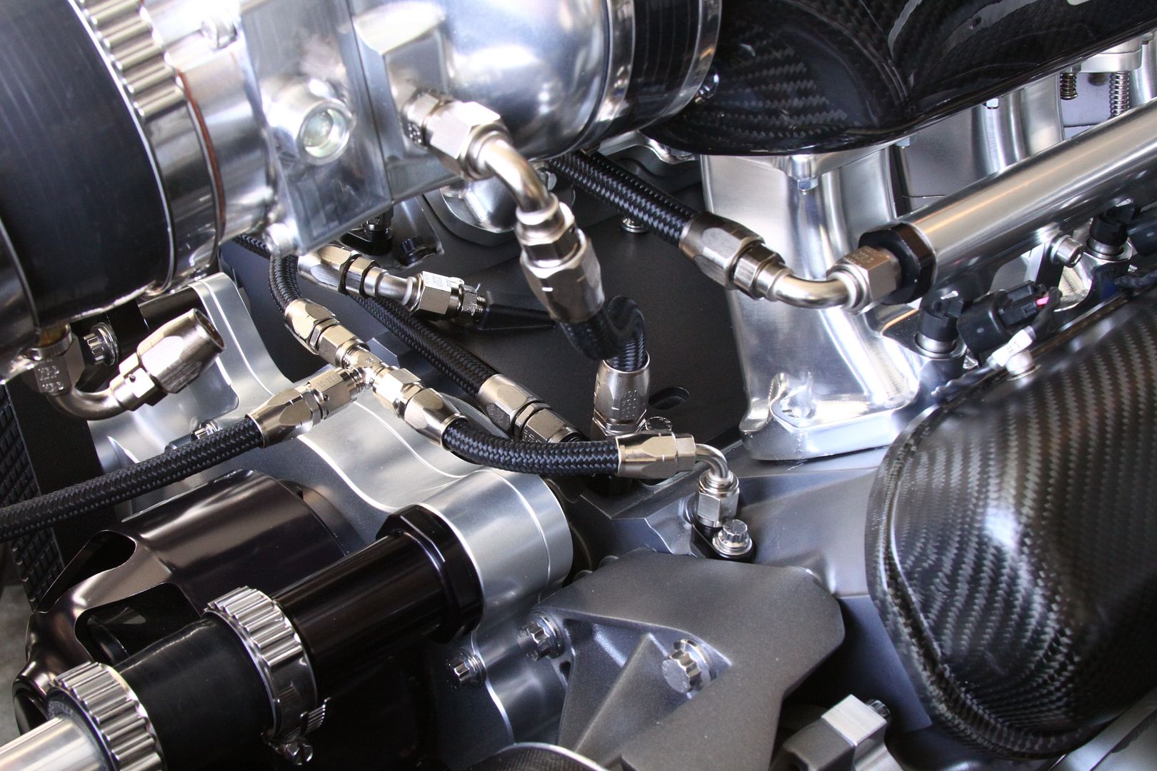

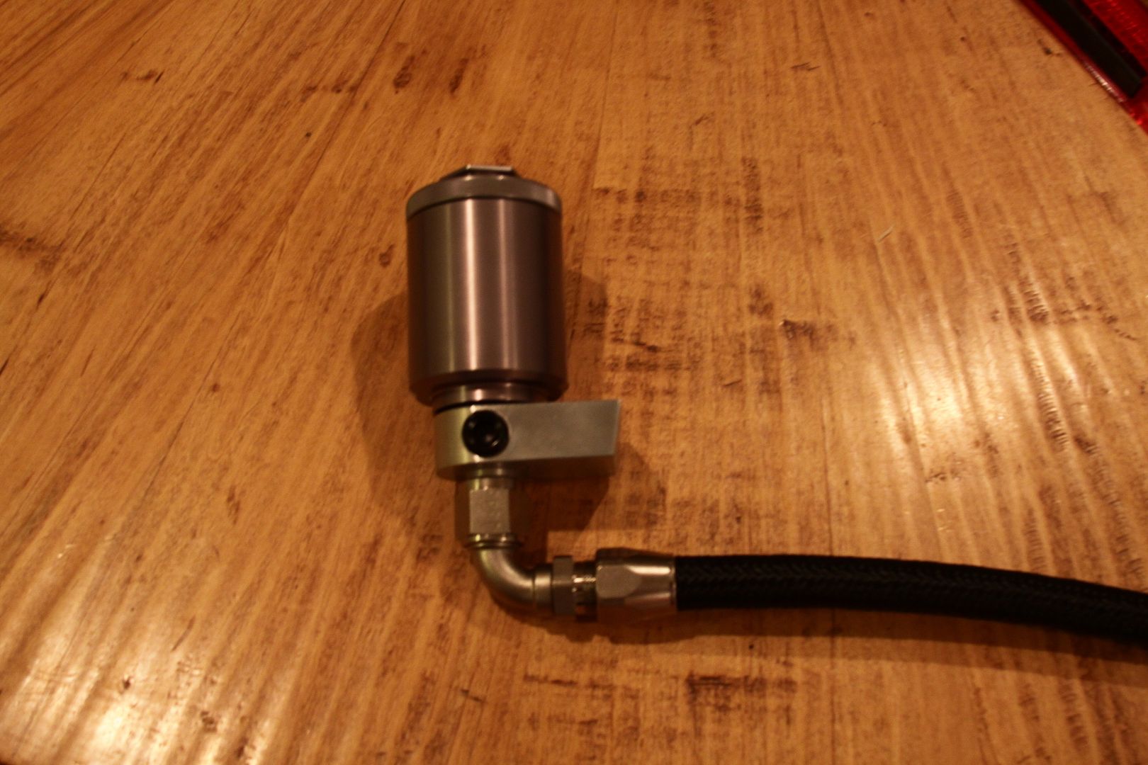

The lines on the reservoir were replaced with crimped end for a cleaner look. (See the pictures on the top of the page to compare the difference)
http://i1231.photobucket.com/albums/...ps5324d81e.jpg
One of the implication with the new intake is the TB now sits higher and further forward. This created to steep of an angle downward from the TB to the air intake for the shorter distance. The solution is to push engine back 2" and lower it 1". The domino effect is that the radiator hose, motor mounts, trans mount, exhuast cross bracing, drive shaft will need to be modified. Currently the headers are the lowest point under the car. They sit about an 1.5" below the frame rail. To compensate for the engine drop a new set custom one off headers and exhuast setup is also part of the plan. When done the frame rails will be the lowest point.
Seems like a lot of work but the added benefit will be the transfer of weight. Craig explained as a rule of thumb in racing every inch takes 100 lbs off front It might actually just be 75 lbs but 100 lbs is the rule of thumb. Lowering the center of gravity which should help.

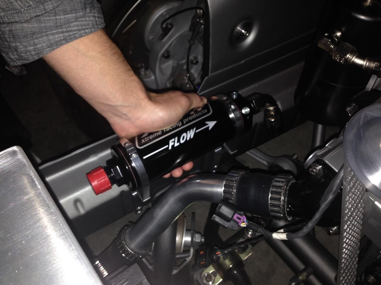

Still waiting on a few parts to start on version 2.0 of the track inspired engine. Drive sump pan, pump and dampener are in. Just waiting on the new track inspired cam and TD rockers. The Lingenfelter LS3 heads might also get replaced with Trick Flow new casting. Pat G likes them better the the Mast.

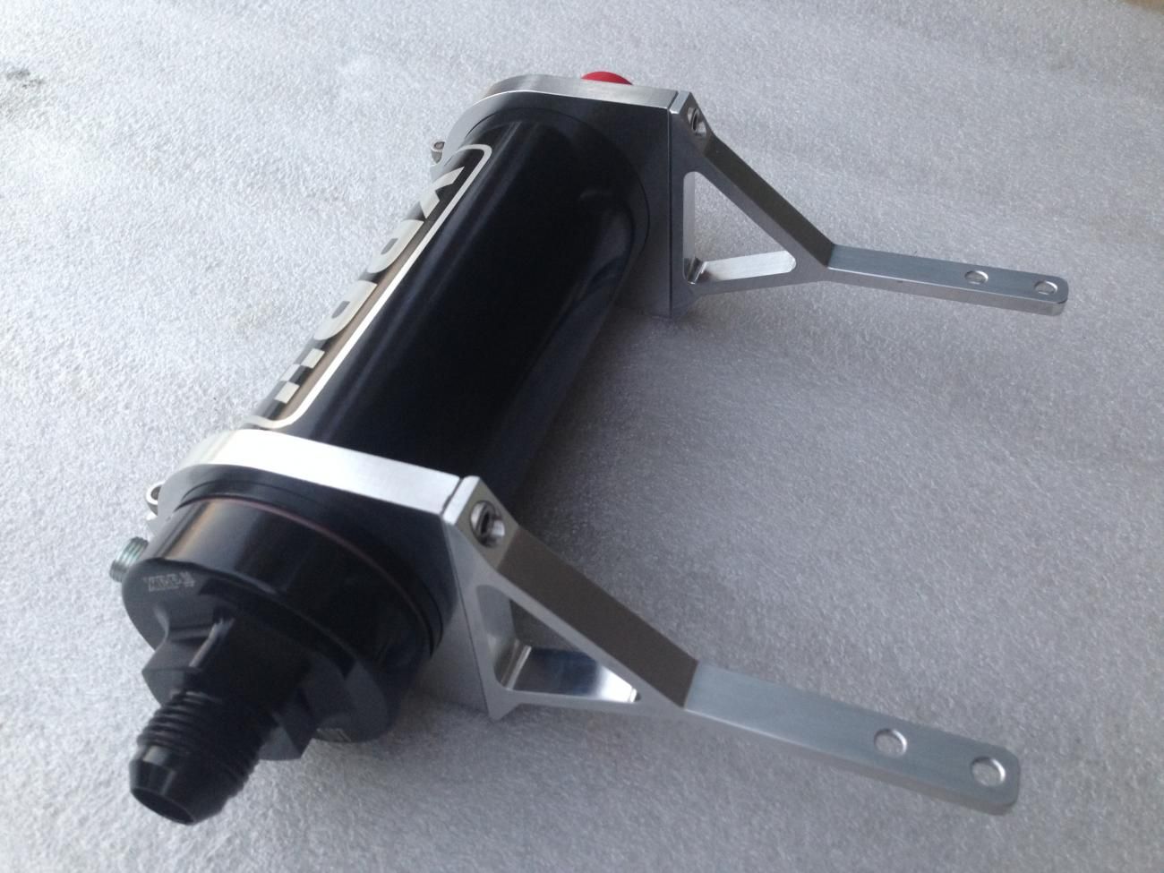

Bill Dailey recommended to use two separate inline filter. A 75 micron from the pump to the tank. A 25 micron from the cooler to the engine. Justin design on Auto-CAD these cool clamps to mount one on each frame rail. The brackets follow the contour of the rails and the filters appear to be siting on the top of the actual rails.
http://i1231.photobucket.com/albums/...psdc0fcf29.png
http://i1231.photobucket.com/albums/...ps116623a9.jpg
http://i1231.photobucket.com/albums/...ps1904f1d9.jpg

Art. Pure art. I want an engine like that so I can encase it in glass and use it as a centerpiece in my living room.

That's a great compliment but yes, Cris from JCG is actually going to help tune the car as hes the hot shoe in the area.
Mark said this pluming stuff is like an art in and of itself and hes not kidding. It takes as much thought as just about anything else.

i love this photo. perfect balance of color, finish, and texture.
