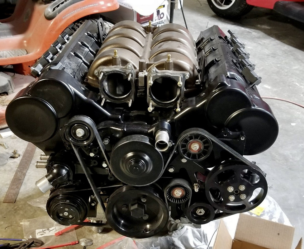

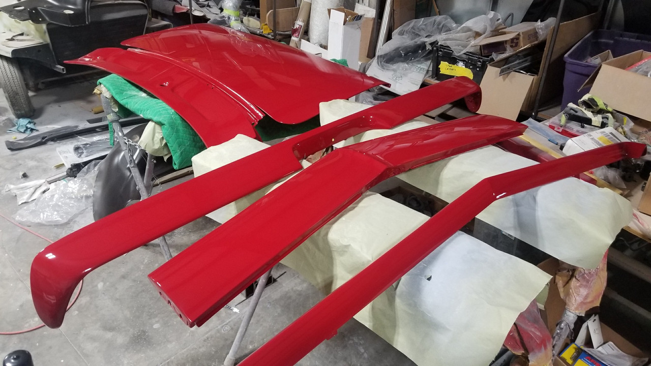

I have not been here much lately....a couple teaser pics.
https://i.postimg.cc/vTCJgQR8/F78-EE...7168-DA3-F.jpg
https://i.postimg.cc/xqrZjtHc/2-C03-...-B77-BDAEF.jpg

214Chevy 12-07-2019 09:34 AM
Nice addition with the touch of gold.

WSSix 12-08-2019 05:34 PM
Really like how you made the hockey stick stripe different. It's a great look. Congrats on getting the car in color.

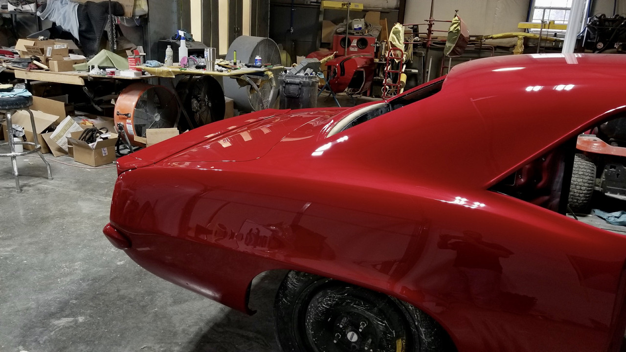

cjfirstgen 12-16-2019 01:43 PM
Major milestone....excited to finally have it in color!
https://i.postimg.cc/xTkGz93M/37-D0-...0-BDF525-D.jpg
https://i.postimg.cc/SNw6LHg5/C1-C6-...96-CD38-F3.jpg

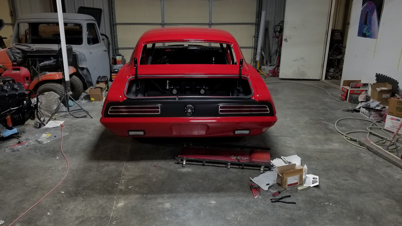

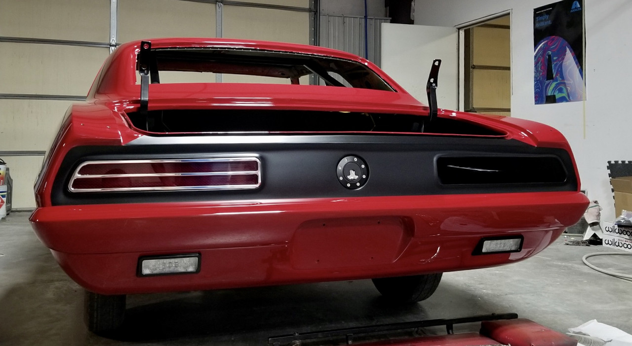

cjfirstgen 12-17-2019 08:38 AM

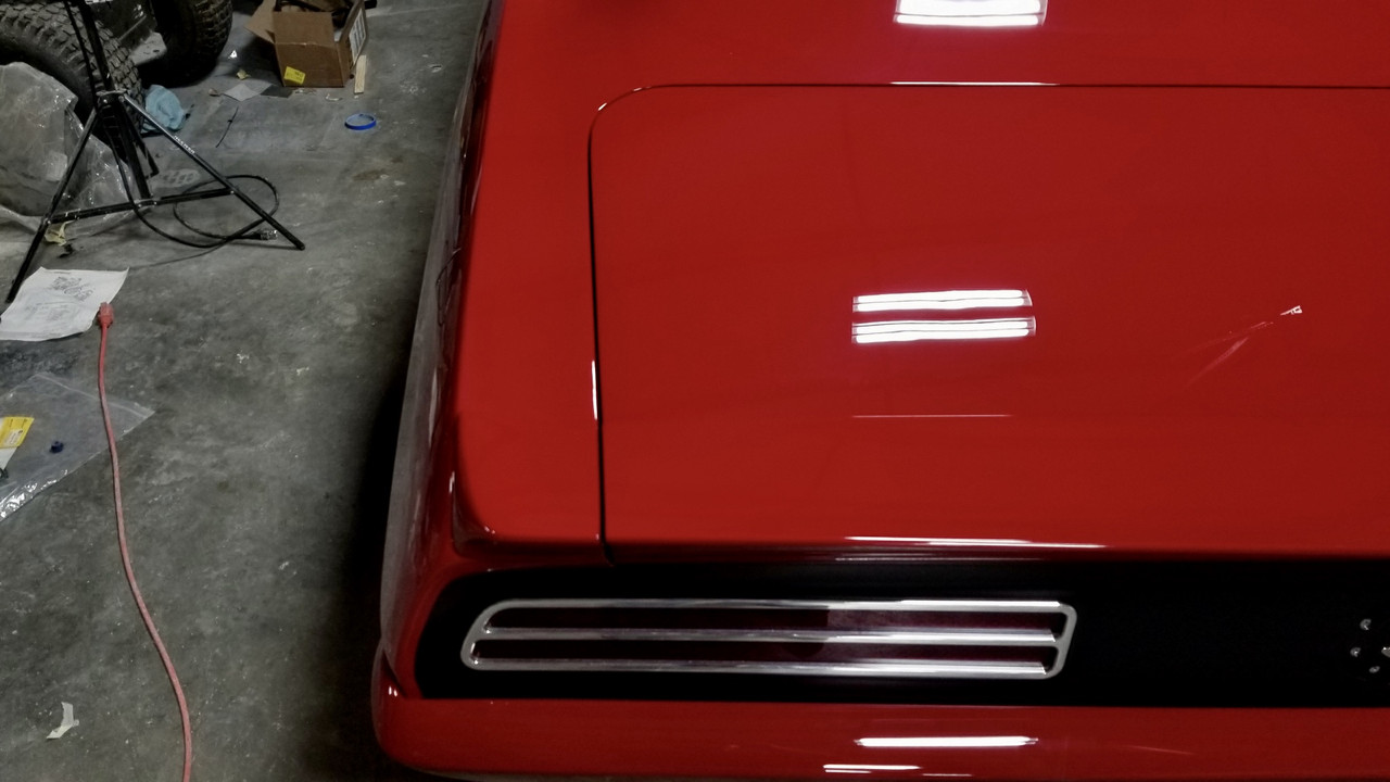

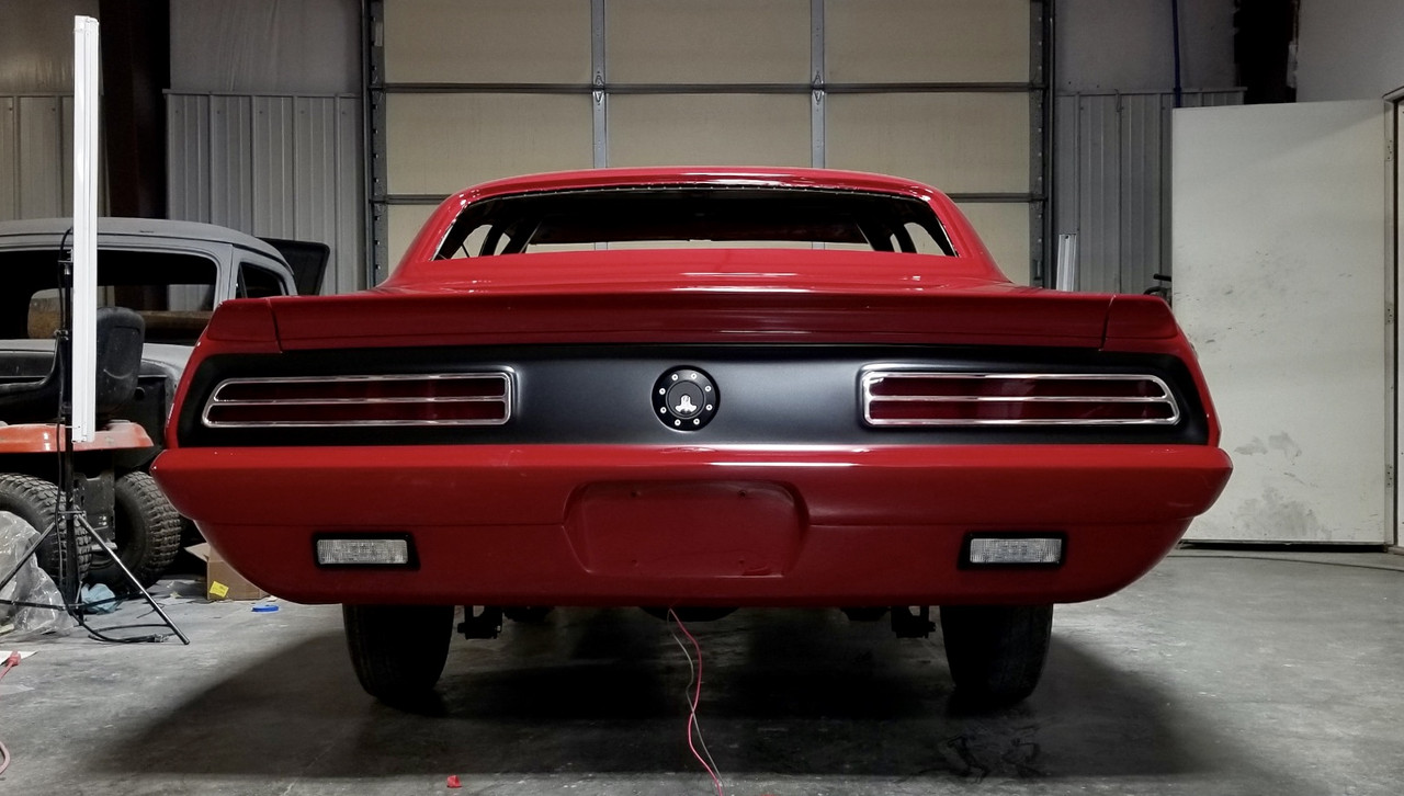

better lighting with the bumper and the Jupiter Red
https://i.postimg.cc/1X5cR56T/7-F975...-EF64849-E.jpg

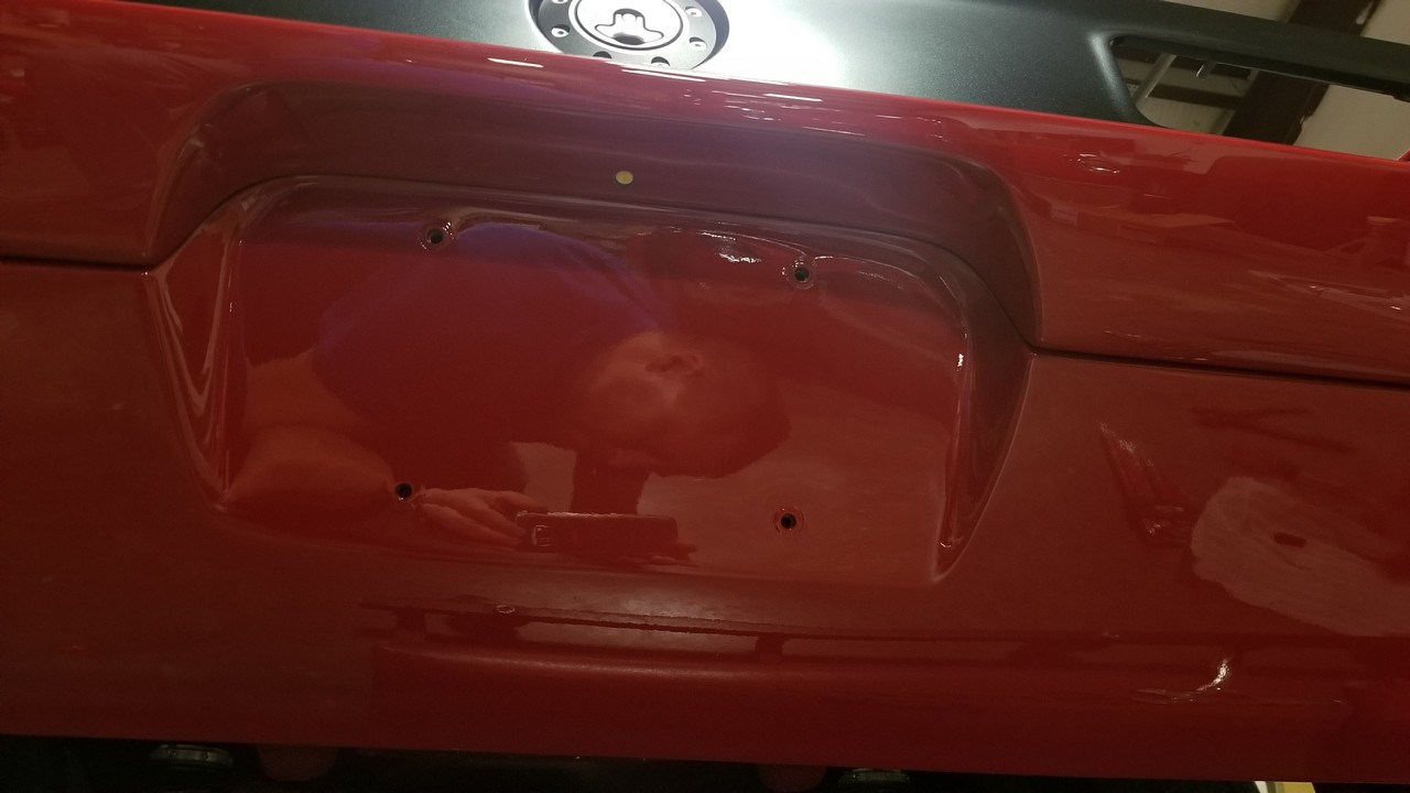

Hidden LED license plate light.
https://i.postimg.cc/yYGXBKNQ/43-C15...B356312257.jpg
214Chevy 12-17-2019 03:12 PM
The deeper tones of red are so sweet..

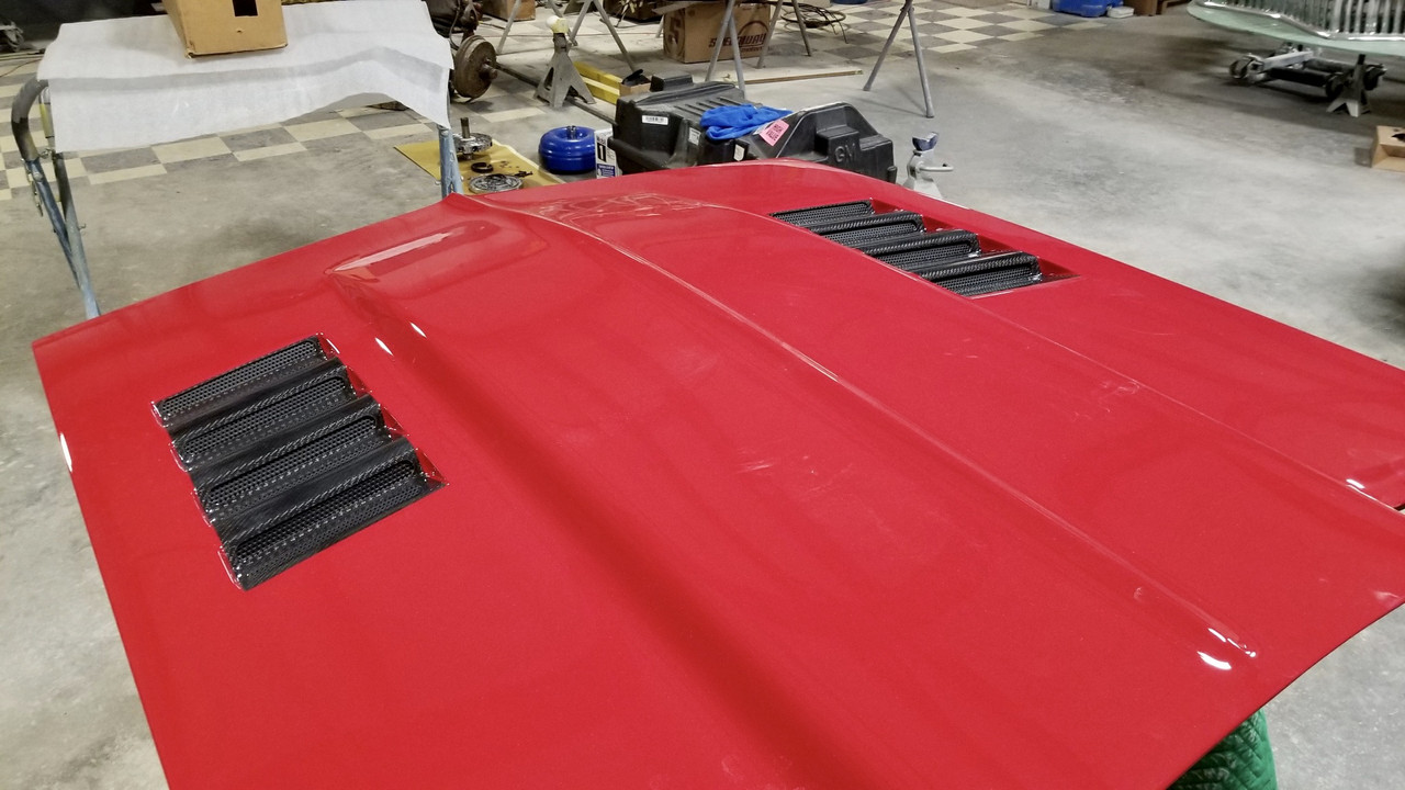

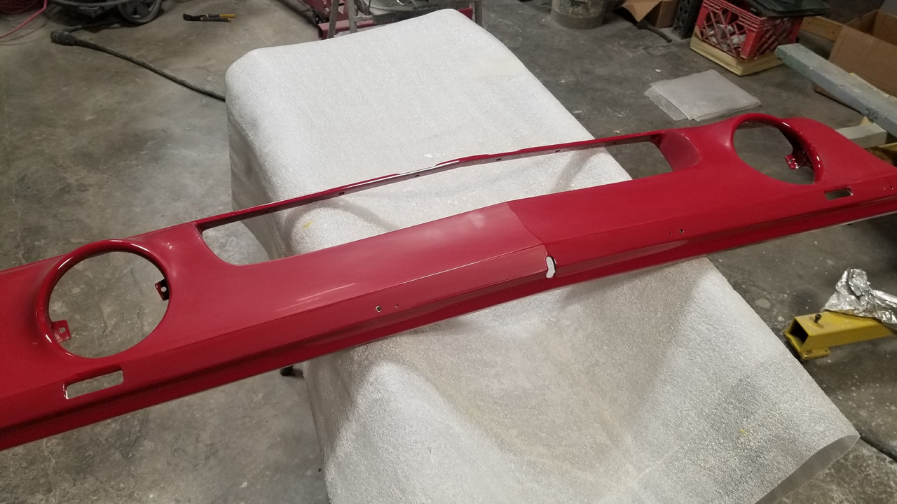

cjfirstgen 01-06-2020 03:51 PM
The last of the painting completed....now onto wet sand, buff, repeat.
https://i.postimg.cc/W1C9NCdM/8-B501...-FAFEEEBE8.jpg
fleet 01-06-2020 09:35 PM
That’s a lot of winning right there!

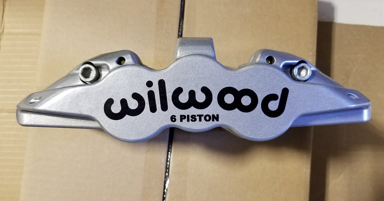

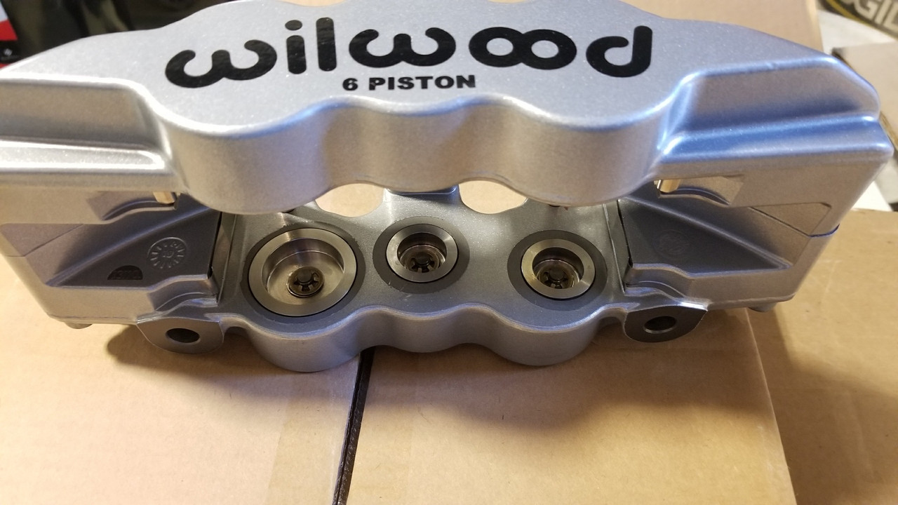

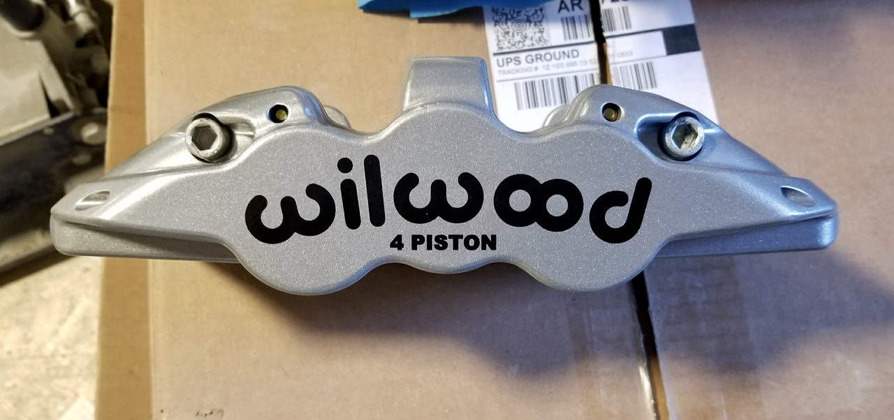

And the new brakes came in...Aero6 and Aero4 both in race spec and custom color. :G-Dub:
https://i.postimg.cc/mDgDD3nz/D616-B...-EF5-F87-F.jpg
https://i.postimg.cc/7ZSbQZ76/51755-...-F597-F647.jpg
https://i.postimg.cc/J4fGqksv/4-B2-C...37-A237-FF.jpg

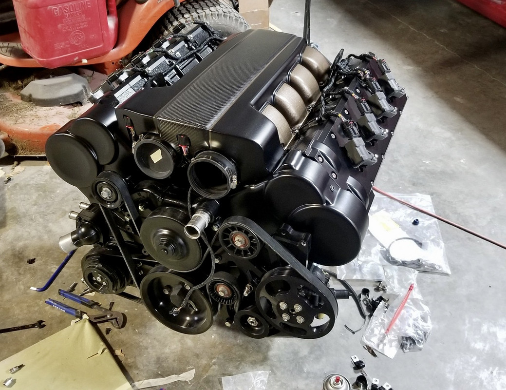

cjfirstgen 02-06-2020 05:36 PM
https://i.postimg.cc/y8Fz23rt/DF69-C...7-F4-A10-D.jpg
Front drive assembly completed...engine harness next...pardon the dust
https://i.postimg.cc/JzwLT5Kj/C4454-...F184-FBFAC.jpg

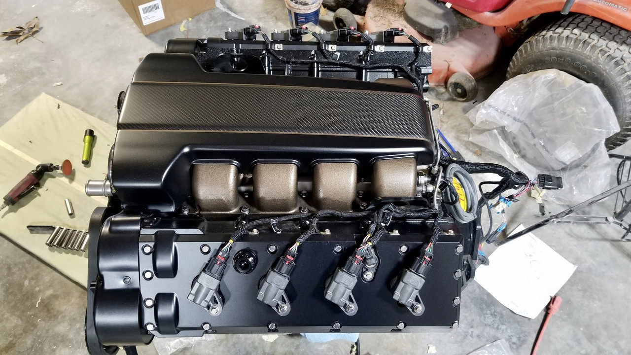

cjfirstgen 02-10-2020 09:03 AM

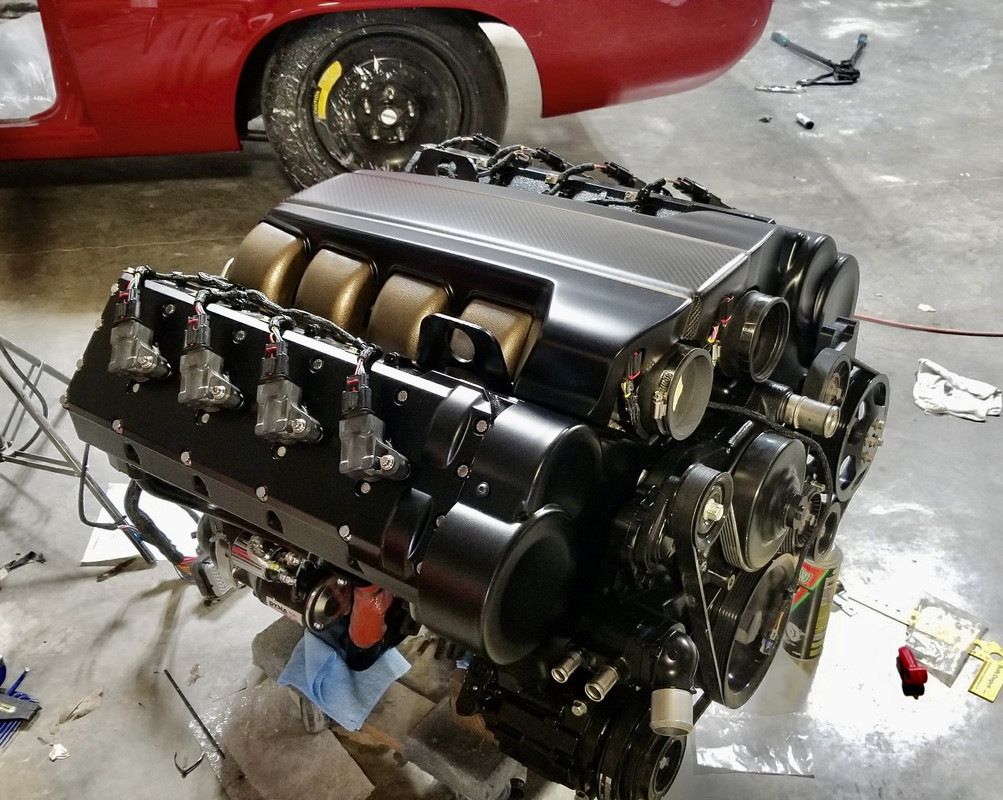

Engine is assembled and wired. Most visible hardware replaced with ARP SS 12pt bolts. Have to come up with a 3d scanner and make some coil covers. Open to other ideas as well....anyone?
https://i.postimg.cc/DfP94nFs/2-BC61...CDFDF0-B73.jpg
https://i.postimg.cc/MHqg3r0v/0-B9-D...-BA572-F94.jpg
https://i.postimg.cc/tJkwKtDD/0-E493...8-F9683770.jpg

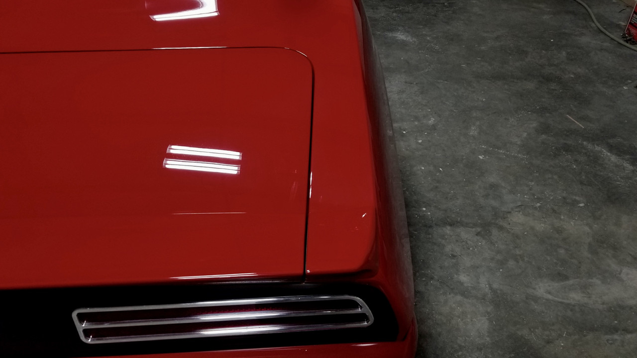

A few more pics...

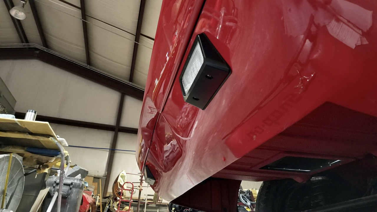

License plate LED light flush mounted
https://i.postimg.cc/28gvhq4X/A2-D37...F61-FBED13.jpg
https://i.postimg.cc/QNJ7WssG/8-CD93...42-D943349.jpg

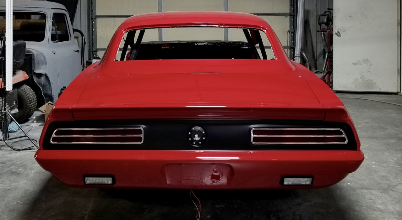

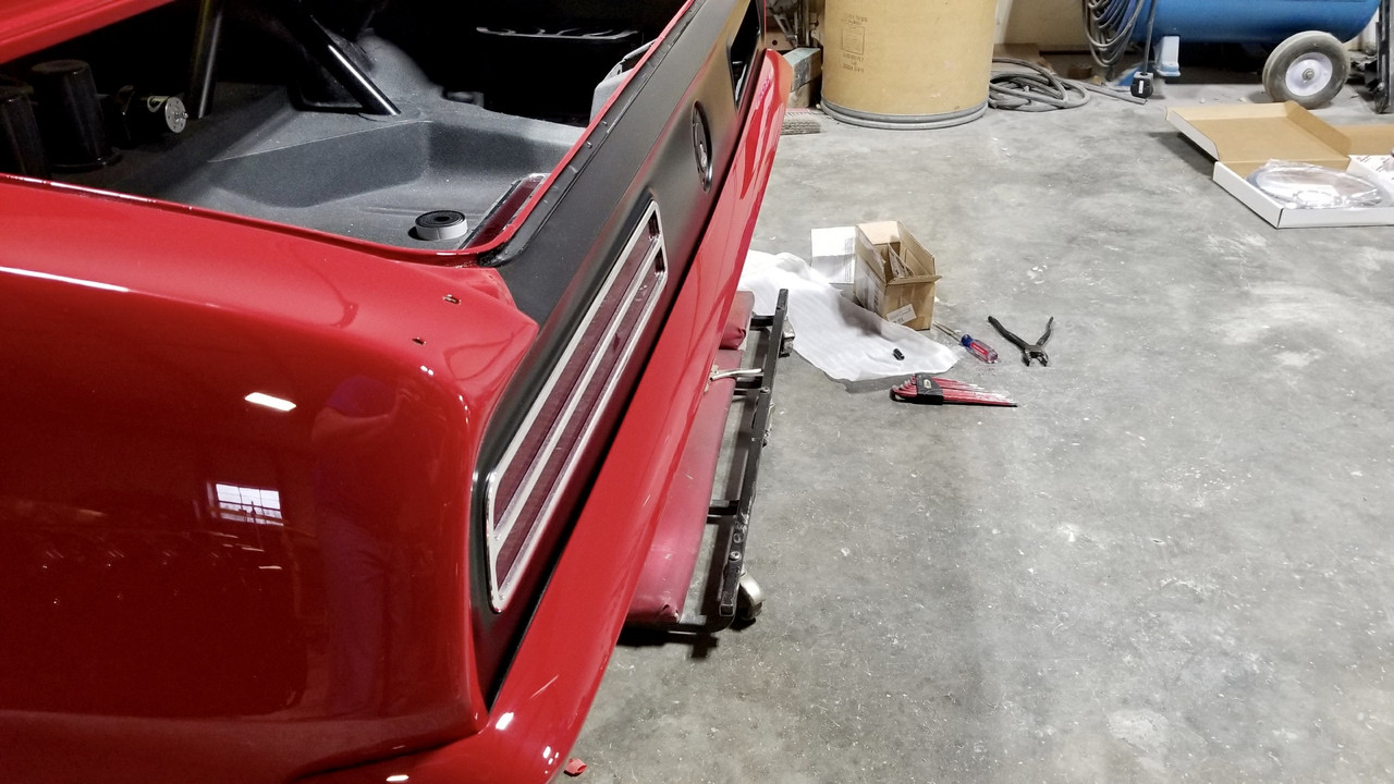

A lot of time getting those gaps right around the bumper and tail lights....
https://i.postimg.cc/J4TBPqGp/50-CA8...67-B4036-B.jpg
More tomorrow.....

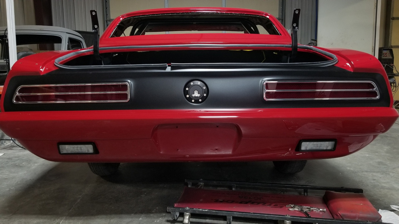

cjfirstgen 02-11-2020 02:57 PM
Those gaps though….:drool:
https://i.postimg.cc/PrrMP5C9/5-C136...-A94039-CC.jpg
https://i.postimg.cc/KjQrJdH0/B66405...E39-CB5-F0.jpg
https://i.postimg.cc/zG4wtwxY/3-B9-E...-AFD3-CF28.jpg
https://i.postimg.cc/K81rDpr5/3778-F...AC7-D5-DF0.jpg
https://i.postimg.cc/X7HkF6FJ/C40225...6-B1717-B1.jpg

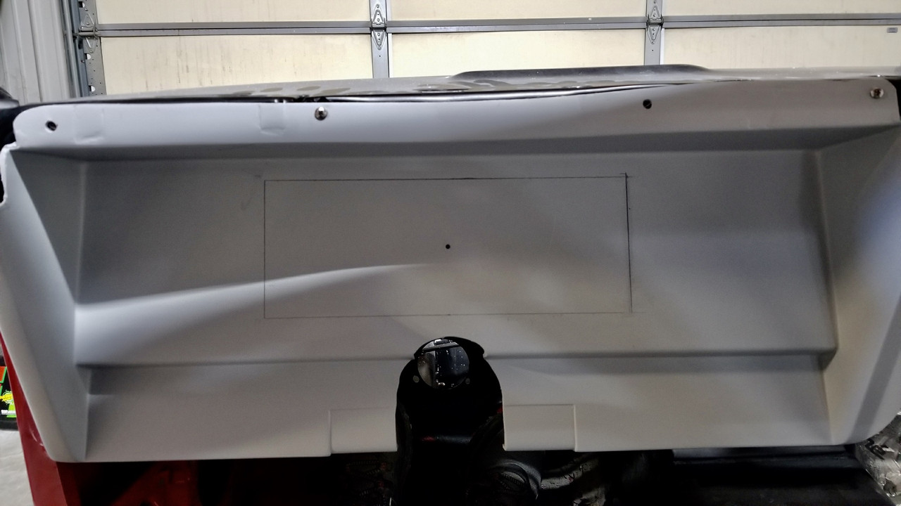

What is going on here.....
https://i.postimg.cc/GhWdNNKb/1-F5-A...3-E9130009.jpg
Goosesdad 02-15-2020 12:13 PM
I'm guessing something sweeeet!
cjfirstgen 02-15-2020 02:40 PM
You guessed right...haha. Going away from the analog dash and mounting a Motec C1212 datalogger behind the dash. The box drawn is the viewable screen area. Allow me to get a little technical and maybe provide some insight for others considering and short stop the research like I had undertaken.
Fortunately I connected with Mercury Racing and Motec engineers to figure out my options and best direction. What led me to this was the CAN Bus signal coming from the Mercury Racing ECU. When someone goes with the Mercury Racing SB4 engine you have a few options. First the CAN signal is Mercruiser's Smartraft std from the ECU which is used in their marine applications that are plug and play with Lowrance, Garmin etc. Think large flat panels in the boats sold today.
1. Gauge packages from Livorsi are plug and play with Smartcraft data but not a great option for a car.
2. Obtain a Smartcraft to analog gauge convertor. Good option and certainly the cheapest but you can't take advantage of all the data coming from the ECU.
3. Obtain a Mercruiser Smartcraft to N2K (aka NMEA 2K) converter with is a standard CAN data signal in marine platforms. Great option but whose platform can read N2K CAN data? MOTEC is the only one that can from what I have found for off the shelf as they do have significant presence in marine applications. Then a programmer just has to map the signals using the ECU Protocol Group Numbers. Sounds simple right?
The C1212 or similar also has both analog and digital input/output's outside the ECU environment or CAN signal like trans and diff temp for instance or traction control. In addition the Motec datalogger provides track data, times, etc. As far as the display with their display creator you can create multiple custom gauge layouts. Expensive route to go but very versatile.
Hope all that may help others considering the SB4 engine.
