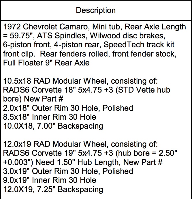

Hey Steve,
I'm trying to figure out some measurements for my rearend and wheels.
Do you know your rearend width, hub face to hub face?
And what backspace on front and rear wheels?
I dig the shallow lip:thumbsup:
gerno 05-30-2014 05:53 AM
1 Attachment(s)
Scott,
Here are the dimensions.
It's difficult to read the invoice from Speedway for the axle but from what I remember I narrowed the axle 1" on each side as compared to a stock axle with LS disc brakes installed. The measurement I see on the invoice is 59 3/4.
Here are the specs for the wheels. I am also running a 1/2" wheel spacer on the rear. I was nervous of the interference on the inner fender due to the flare so I specifically went conservative on the BS so I could adj with the spacer. With the PS2 test tires the fit was much tighter than the RE11's I'm running now
Attachment 48444
CURVES 05-30-2014 02:21 PM
Thanks bud,
Looks pretty close to what I came up with, Frickin tight in there....:superhack:

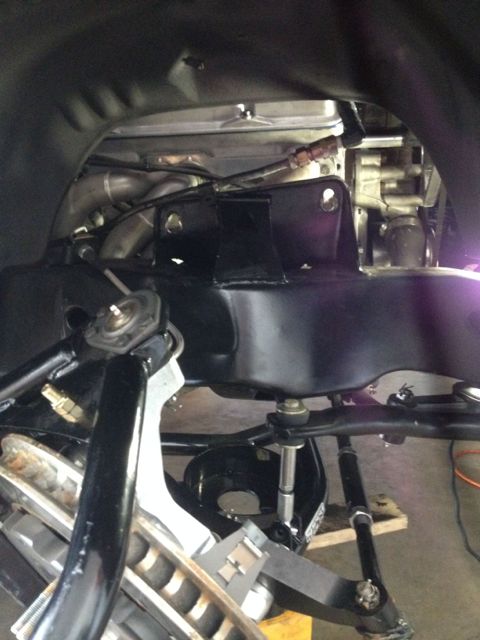

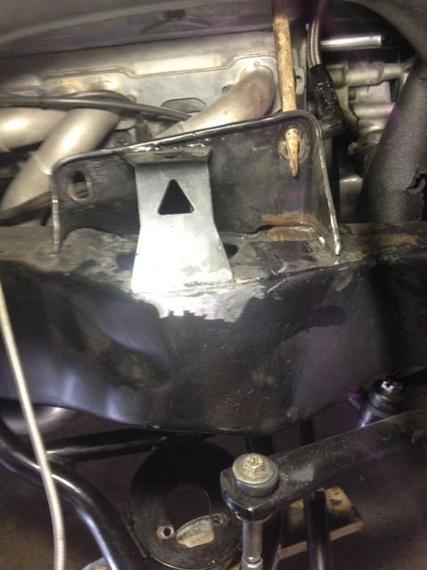

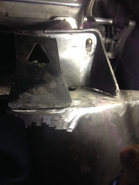

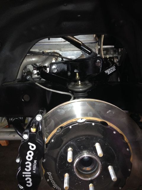

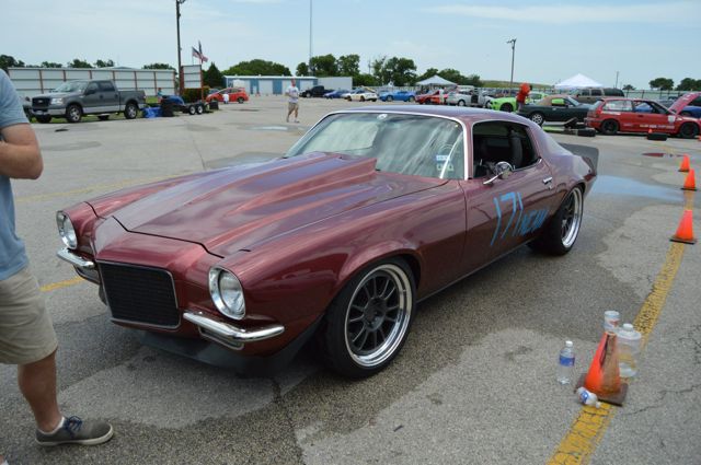

This weekend I modified the UCA mounts a bit and took the car out for the first real test.
For the mounts what I decided to do was to cut the bottom weld on the front of the factory mount and bottom of the Chicane mount. I then cut another ~1/4" out and bent the factory mount outward ~1/4". I then welded it all back in place. I took it to the alignment shop and it's still not at the -.5 to -1 degree target but is closer at -1.5 on both sides.
After finishing this up at ~ 730 sat night I cleaned and prepped the car for an autocross the next day.

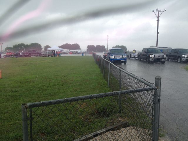

The autocross was fun and interesting. Day started out very nice but a bit overcast. I was working the 2nd group and running the third (of 3 groups) so I was excited the course would be cleaned up. A total of 169 cars were running so it was a full day.
During the end of the first group a huge storm came in and dumped rain. The course turned into a lake. It was enough to were the 2nd run group was knocking down cones with water splashing instead of actually hitting the cones. Luckily the rain stopped, sun came out and the course dried in most areas by the time I ran. Overall the course was fun and designed by a Vette driver. It was basically a 3 straights with 3 180's tying them together and a tights bend at the beginning and end to slow you down. It was fast and well suited for my car.

Is it ok that you have the UCA bolt holes slotted like that? I would think the UCAs could move up the slots given enough force.

The UCA mounts are meant to be slotted. As per the directions from Speedtech, its a necessary step with the installation...

A little update on the brakes and the overall project.
Last week I ordered up in axle tube seals and installed them over the weekend. this also gave me a chance to pull the pumpkin out and make sure everything was looking good. I installed the seals and pulled the hubs apart one more time to repack the grease. In general the install took a while but was uneventful. I also cleaned off the pads and rotors really well. It was a snug fit for the seals so hopefully I don't have to pull them out anytime soon...
I also changed out the 1/2" rear wheel spacers for 1/4" spacers. After I got it all together I took it for ~10 mile drive to check it all out. Got home and sure enough more grease was on the rotors. Good news is the outer tire was not rubbing anymore. Plan was to head to an autocross on sunday but after seeing that I opened up a few beers and called it a day....
Next day I put the car up on stands and checked it out again. I didn't see any visible leaks from the seals so I decided to just clean the hell out of everything and try it again. I also noticed the wheels were actually rubbing on the inner wheel wells now... I was shocked since there is ~3/4" clearance. I assume under hard cornering there is a bit of body roll since the pan hard bar should be holding the axle very still
I picked up ~5 cans of brake cleaner and sprayed the hell out of all the rotors with focus on cleaning the vanes and the pads. I also decided to go ahead and use a butane torch to heat the pads in case oil/grease is embedded in the pads. Sure enough while heating them up I could see a slight amount of oil bubbling out of the pads. After al this I also bled the brakes one more time to ensure it was completely solid. I bolted the wheels back on and went for a drive.
Sure enough the brakes were MUCH better. The pedal was more firm and the car really slowed under hard braking. I got them a little warm but I don't think it was enough to put some real heat in them. I got home and sure enough no oil on the rotors... SUCCESS... ( I also followed this up with a commute to and from work...still no oil) :D
