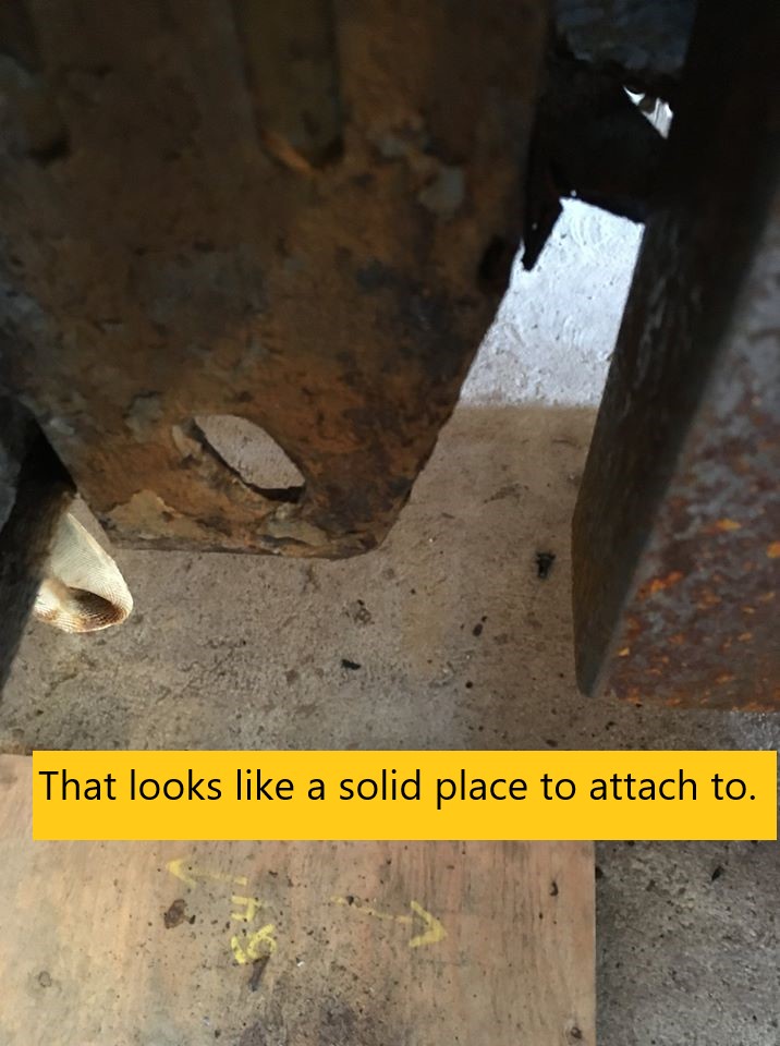

Motor mounts for a SBF are quite easy as they are a flat plate. I would have preferred to have some flexible motor mounts but with limited clearance under the cowl I have chosen solids for the engine.
https://lateral-g.net/forums/attachm...1&d=1631069574

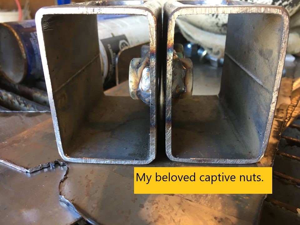

egoman 02-07-2022 06:19 PM
10 Attachment(s)
After waiting on a colleague to do some plasma cutting for me I finally found what I needed laying on my desk. Thanks to Paul Jonker for helping me out. These pieces will become my coil-over mounts. You have seen the drawings for these several posts ago. I also had an adventure to acquire myself some inner wheel tubs for the rear of the car. I phoned the trailer place and they said that they had a few hundred in stock. GOOD, I will be right there. ½ hour drive and at the desk! We don’t have any of those here? I just talked to you guys and you said you had hundreds. “Oh was that our OTHER store”? Two hour round trip to the “other” store and I had them in my possession.

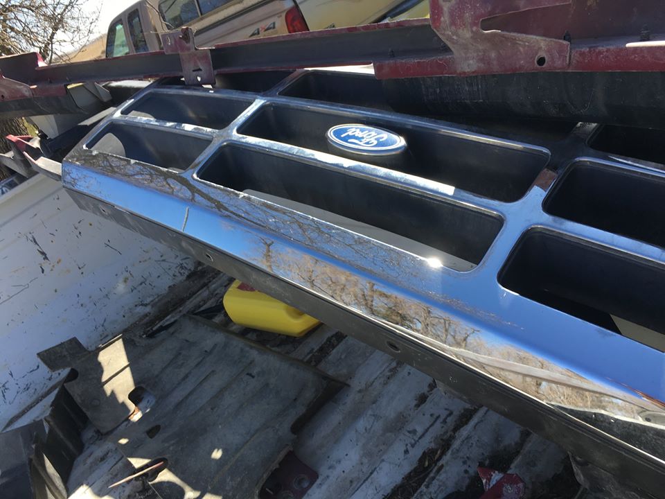

10 Attachment(s)
The unicorn truck needs to become a lot less of a truck and more of a Cougar. We will strip it down and retrieve what we need and sell as much off as we can. I recouped way more than I originally paid for the truck anyways. Despite all that was removed today it still drives around the yard.

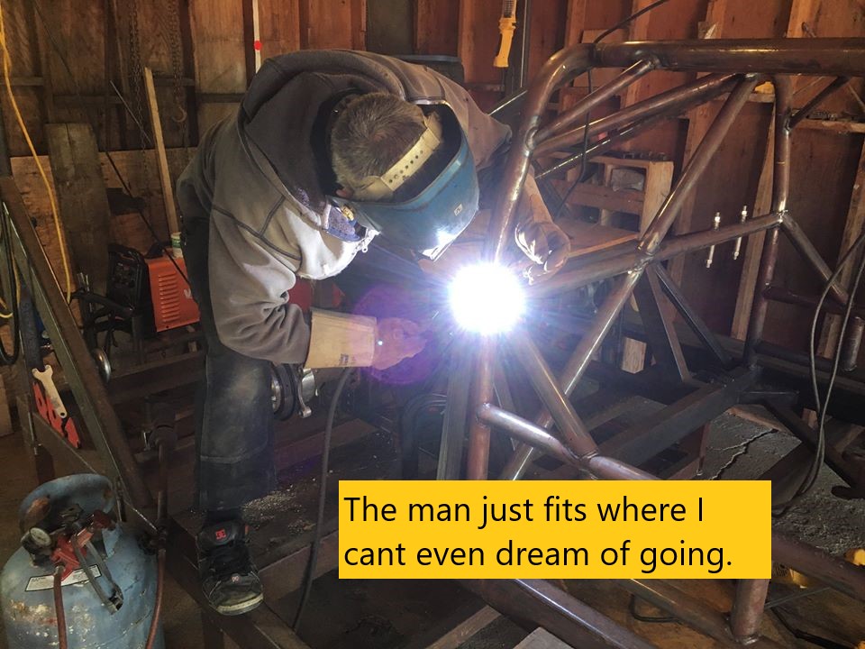

egoman 03-14-2022 05:50 PM
10 Attachment(s)
Even though I already MIG welded the car, I felt that for a better looking cage I would have my friend Brent Johnston over to TIG weld all the visible welds. We ended up grinding a lot out so they wouldn’t be all lumpy. Brent worked for a local chassis welder for several years and welded aerospace for 18 years. I hounded him to join the union and he now is one of our best stainless welders. He also is now the shortest welder in our hall, a title formerly held by my other friend Dwayne Rudkavitch.

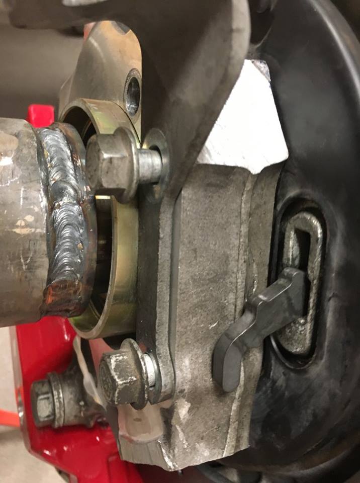

egoman 03-28-2022 06:48 PM
7 Attachment(s)
I ordered the Ride-tech R-joints along with my suspension links and the coil-overs and it finally got here. Well most of it got here. They didn’t ship the suspension links. SIGH!
