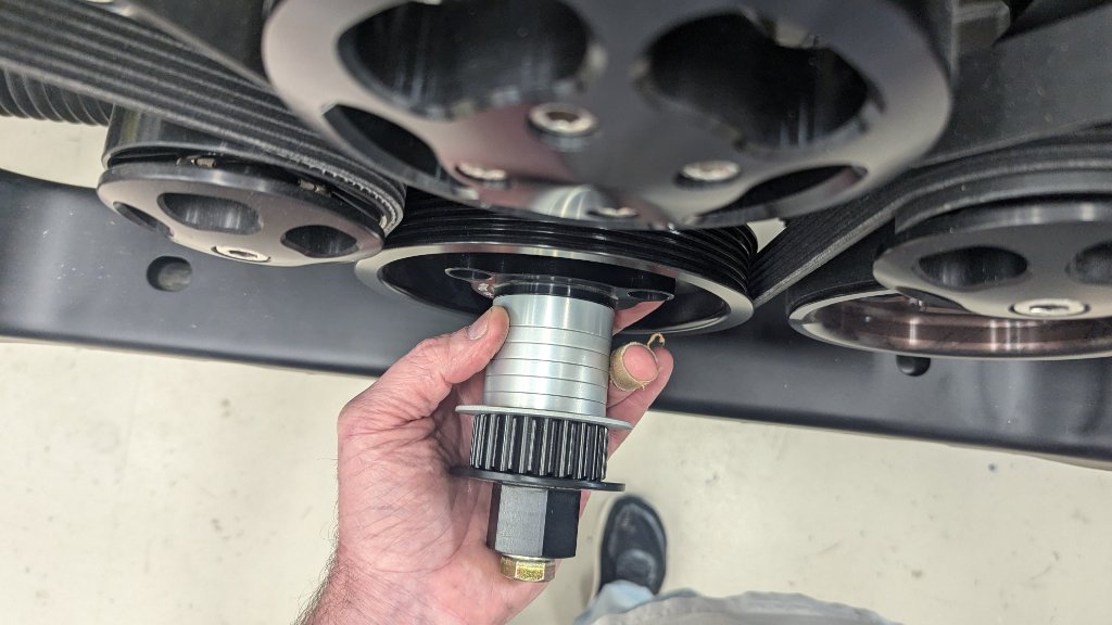

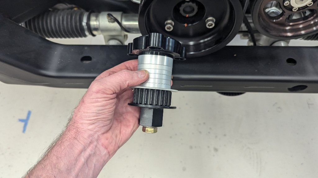

2 Attachment(s)
Appreciate any advice here.
The original plan was to drive the dry-sump pump from a pulley behind the crankshaft pulley. However, a 4 stage pump will not fit here with a DSE subframe...without significant modification to the crossmember, engine mounts and the exhaust. Significant is an understatement.
Aviaid has suggested this drive pulley which would mount on the front of the crankshaft pulley which would pull the pump forward. It doesn't completely solve the problem but makes the modification manageable. It will require that I build a custom mount for the pump but it seems doable.
The fear with some I've spoken to is the torque on the crank, bearings and the pulley with this hanging off the front.
Though some think it's no problem.
DSE doesn't know of anyone running an LS7 with an external dry sump pump with their subframe.
Appreciate opinions and any advice.
Attachment 82289
Attachment 82290
CJD Automotive 10-07-2024 08:47 AM
While it does stick out a good bit, remember there is no tension on a dry sump belt. The drive mandrel and spacers are aluminum, so don't weigh much, and small in diameter, so not much centrifugal force. Unless your spinning it 10,000 RPM, I wouldn't be too concerned. I'd probably be more concerned with belt protection on a street driver. Not sure if you have a belly pan under the nose/engine? if so, I'd still want some protection from top in case the serpentine belt cam off, or broke, so that it wouldn't knock the dry sump belt off. Maybe that's overkill, but I put a shroud on mine. Very least, set up an oil pressure safety that kills the engine, in the ecu.
