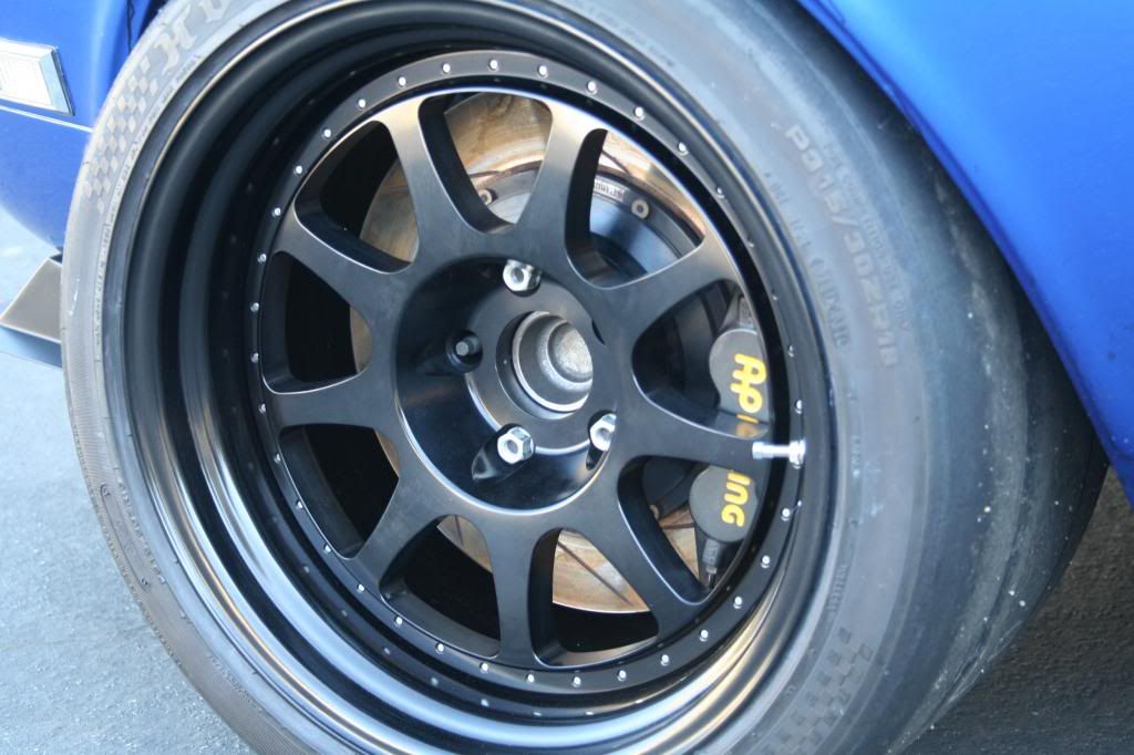

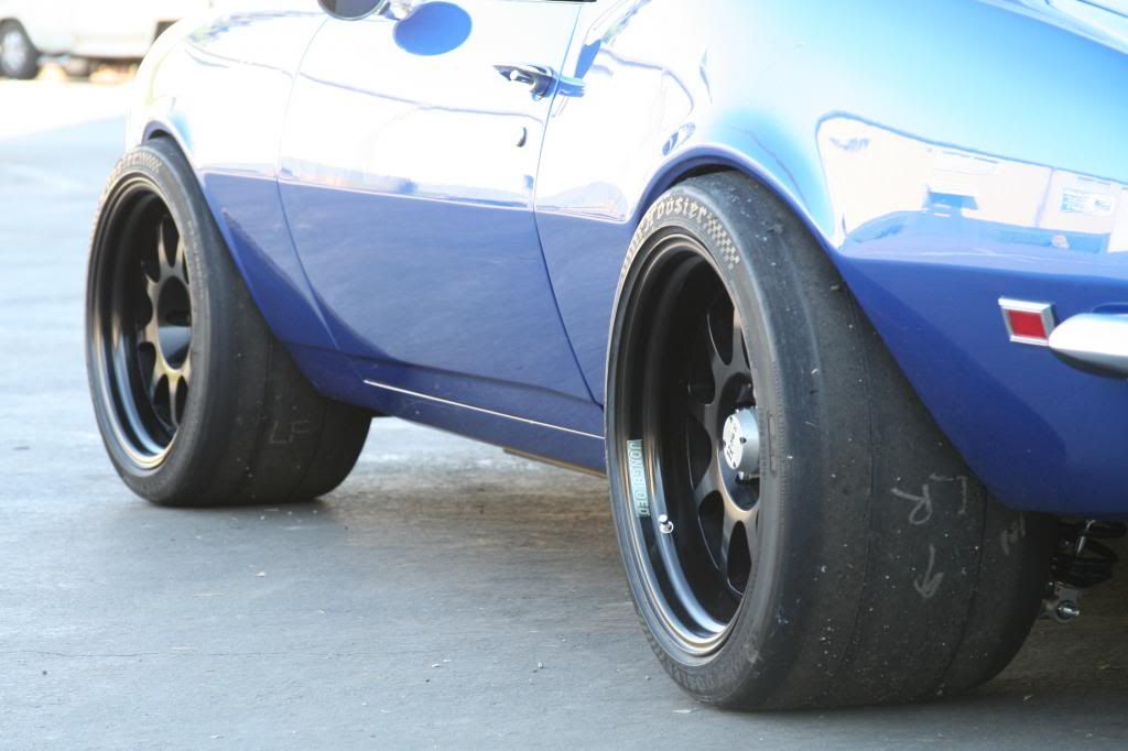

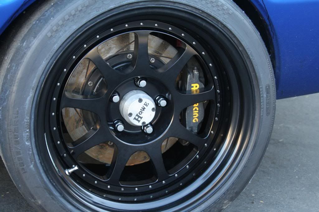

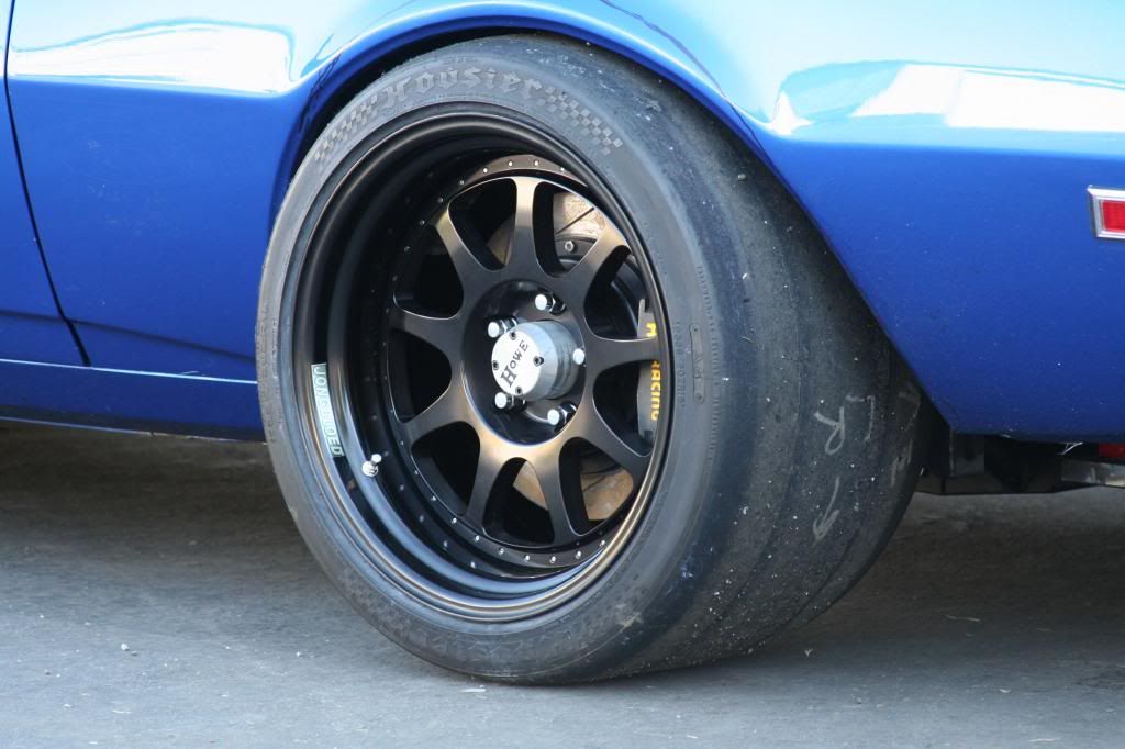

Ok.... wheels are finally done and on the car. I give you the Jongbloed Racing 330 wheel.... done locally in Morgan Hill.
18x12 front and 18x13 rear on 315 and 335 Hoosier A6's.

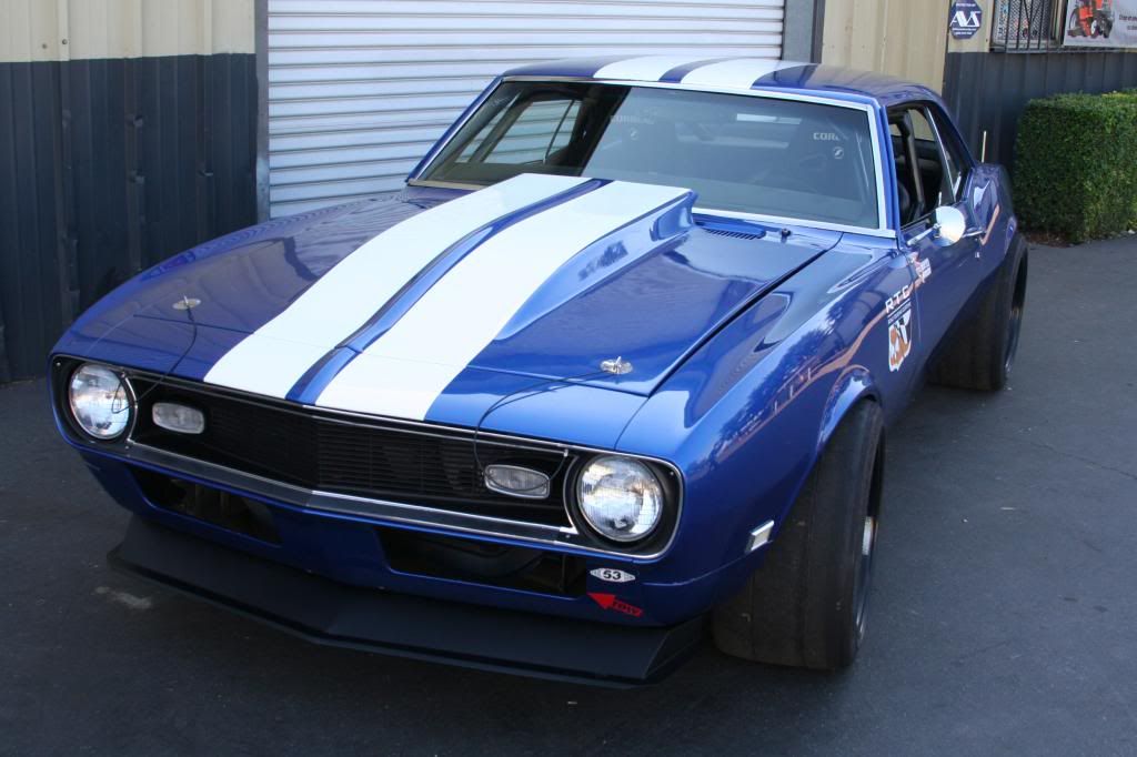

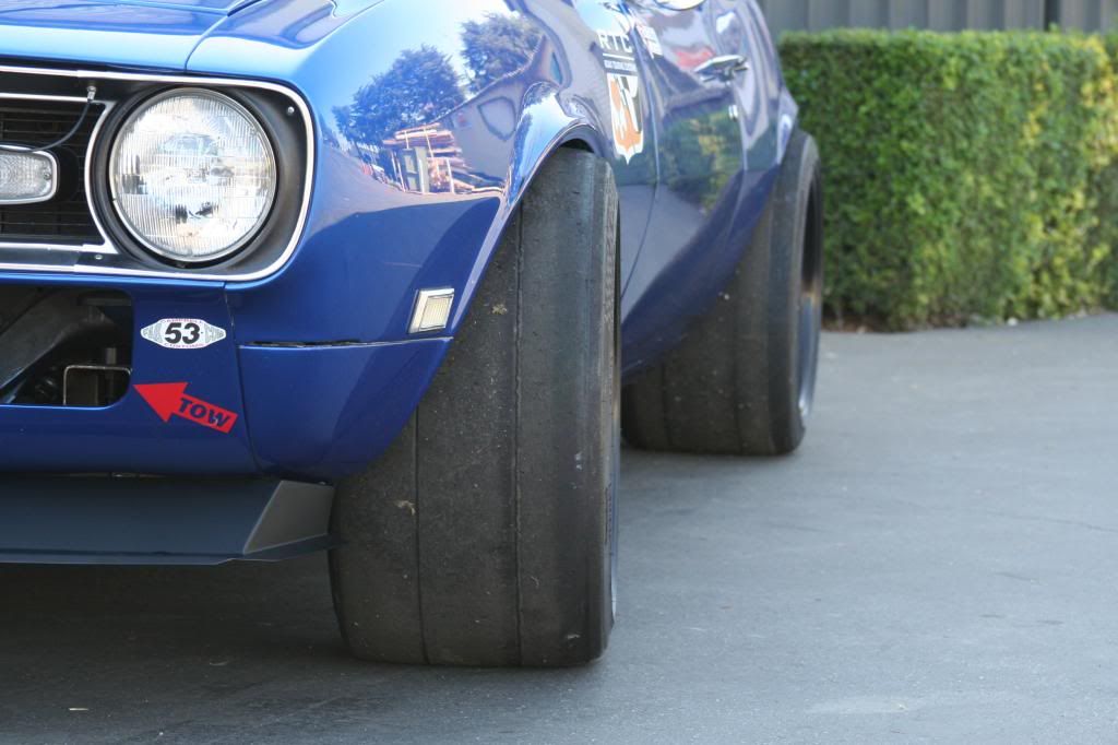

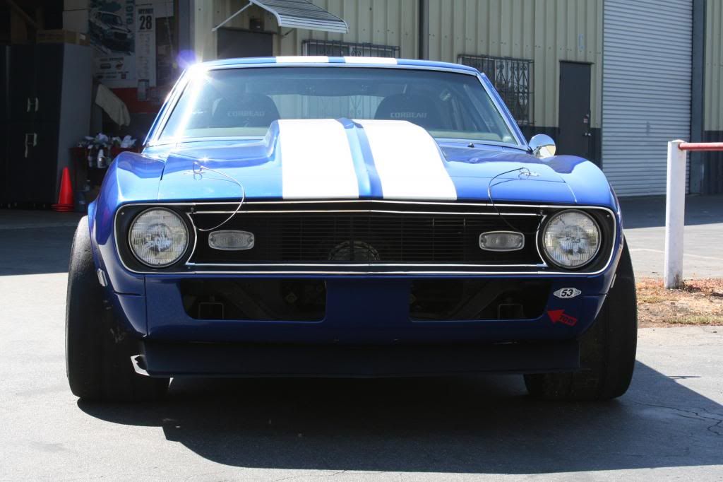

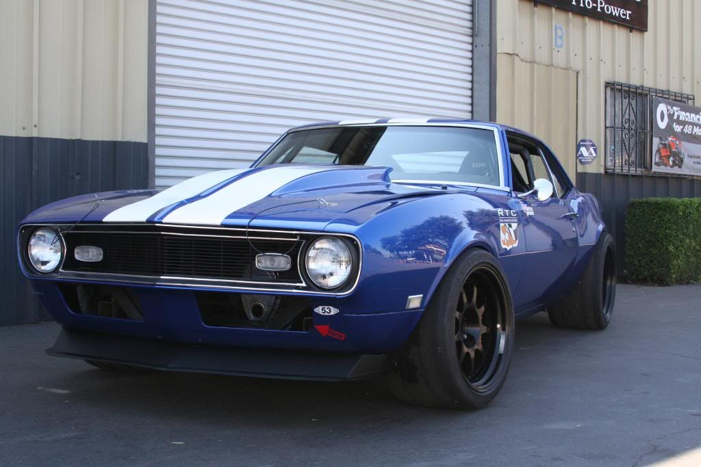

And the car is one the ground off the lift for the first time in probably 6 months. That's always a step forward.
http://i236.photobucket.com/albums/f...ps2bdec2e1.jpg
http://i236.photobucket.com/albums/f...ps614a2794.jpg
http://i236.photobucket.com/albums/f...psf5870c00.jpg
http://i236.photobucket.com/albums/f...ps0eb423bd.jpg
http://i236.photobucket.com/albums/f...ps445c9600.jpg

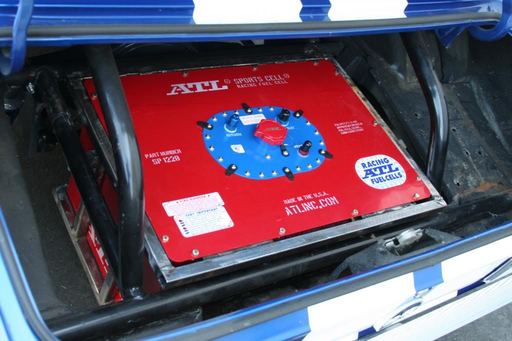

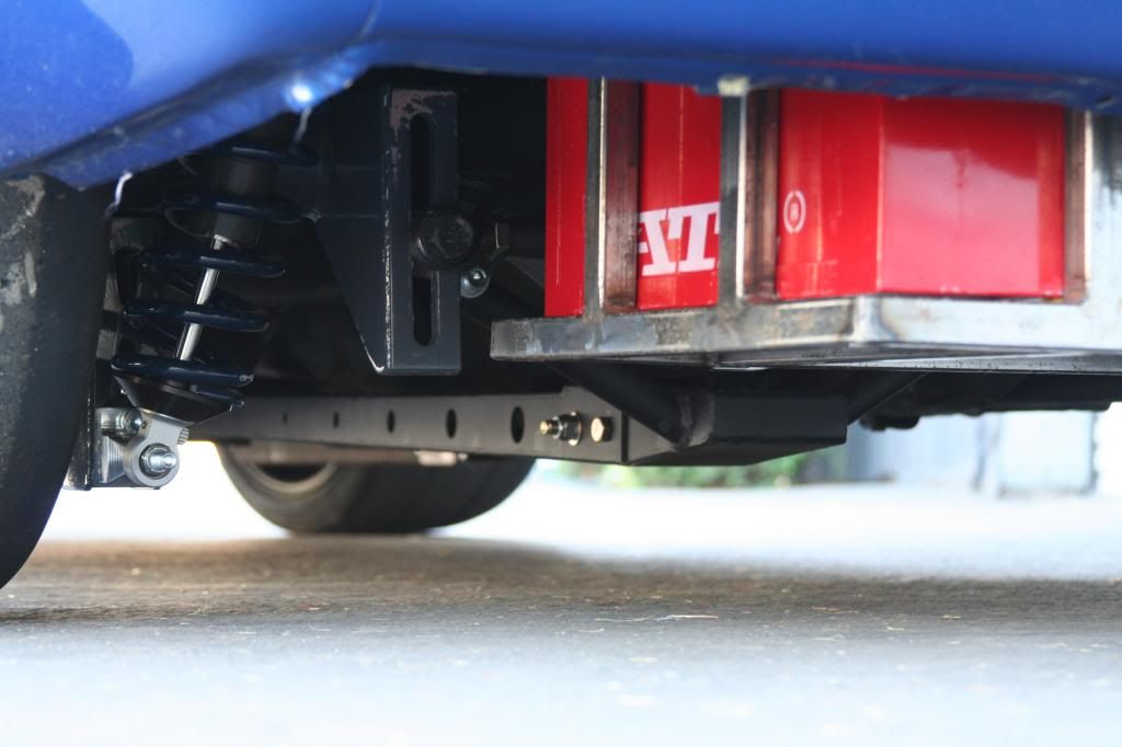

Rich has been working on the fuel cell cage and I am really happy with how it's turning out. Just needs some top bars/straps and powdercoating. I gave Rich the "blueprints" for the cage found in Circle Track magazine. It uses about 50 feet of 1x1 square tubing. Heavy and a little overkill but about as safe as I can get I figure.
http://www.circletrack.com/safety/ct...d/viewall.html
http://i236.photobucket.com/albums/f...psa33dd1c3.jpg
http://i236.photobucket.com/albums/f...ps66aefdf2.jpg
http://i236.photobucket.com/albums/f...psb348448c.jpg

Matt@BOS 08-11-2013 12:00 AM
And I thought the front of my car had stupid amounts of camber when I was looking at it the other day. BMF looks nothing but serious business now. And those wheels... I kind of really want some now.
Flash68 08-11-2013 12:06 AM
Well this is only 2.5* actually, which is what Jake specs for my setup. I don't consider that too extreme. But maybe that's part of my problem... since I don't consider this car too extreme. :peepwall:
FETorino 08-11-2013 12:20 AM
Matt Are you sure you can accept that hellafflush 315 on a 12" wheel up front.:cheers:
Sieg 08-11-2013 01:35 AM
BMF'n Outlaw :unibrow:
Flares :secret:

Outlaw 10.5?? :guns:
Without the flares... it looks like a dirt track car :drive:
:hello: :thumbsup:
