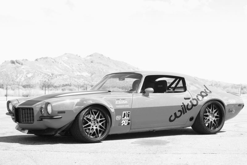

73CPCAMARO 10-04-2011 07:23 PM
Playing around with my photos and I kind of like this one.
http://i80.photobucket.com/albums/j1..._9449-Copy.jpg
Vince@Meanstreets 10-04-2011 07:56 PM
nice, I spy new spoiler?
73CPCAMARO 10-04-2011 08:10 PM
:_paranoid
GregWeld 10-04-2011 08:34 PM
Great -- super driver.... now super photographer... :willy: :D
It is a nice shot. I've always like black and whites.
73CPCAMARO 10-04-2011 08:41 PM
I wish I could take credit for the photo. I had a pro take a bunch of high quality shots when I was at Willow Springs. I just played with the colors,:D
See you at SEMA and OUSCI
