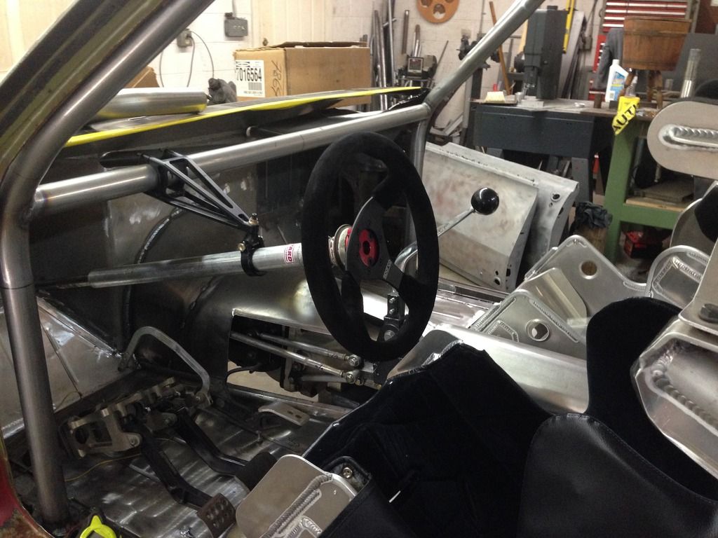

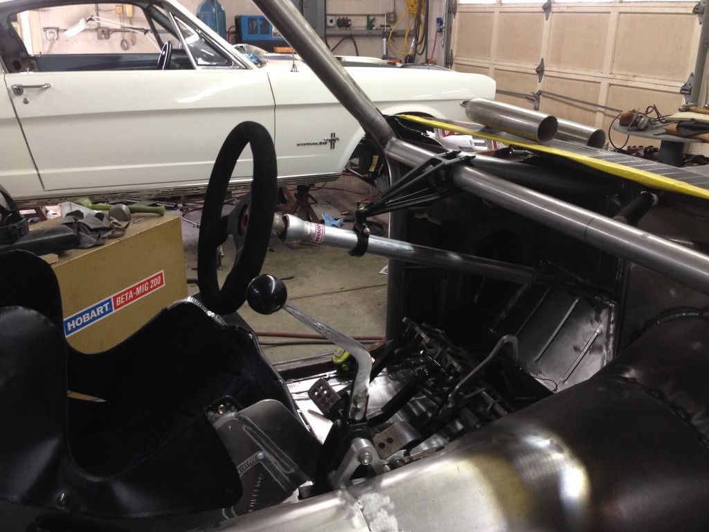

Time for some updates

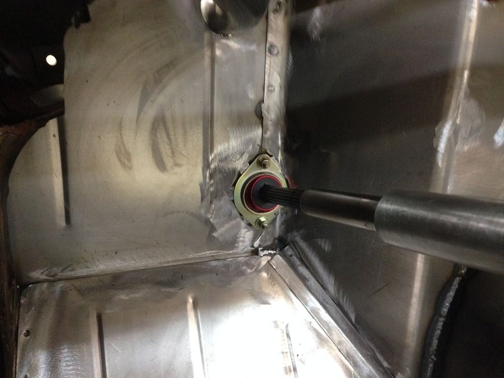

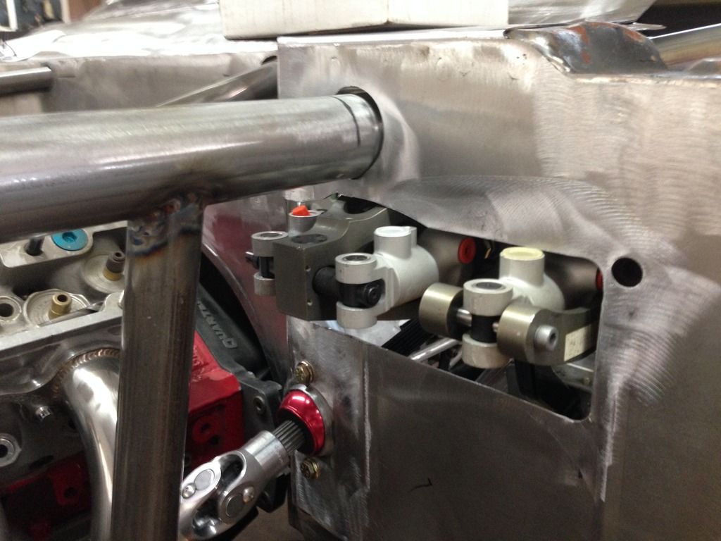

Getting steering column in place and driver position
http://i1138.photobucket.com/albums/...psnaukyuty.jpg
http://i1138.photobucket.com/albums/...psurnjvu1v.jpg
http://i1138.photobucket.com/albums/...psjy858ys2.jpg
http://i1138.photobucket.com/albums/...ps7s9pbku9.jpg
http://i1138.photobucket.com/albums/...psyuaprbhs.jpg

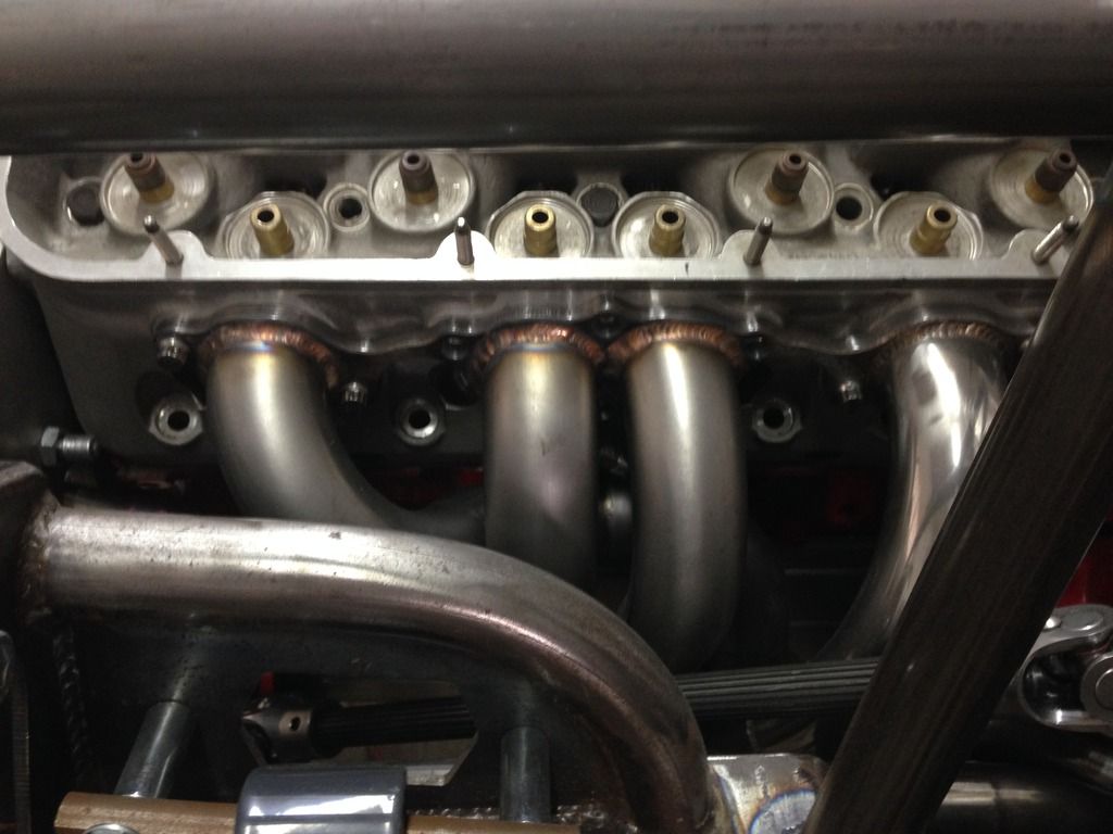

Payton King 08-14-2015 11:47 AM

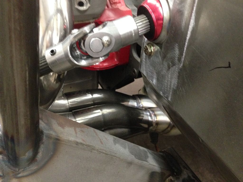

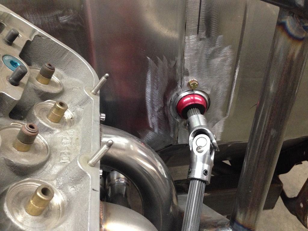

Had to move a couple of tubes on the headers for clearance and also rolled the rack back for a better u-joint angle.
http://i1138.photobucket.com/albums/...psua1goww2.jpg

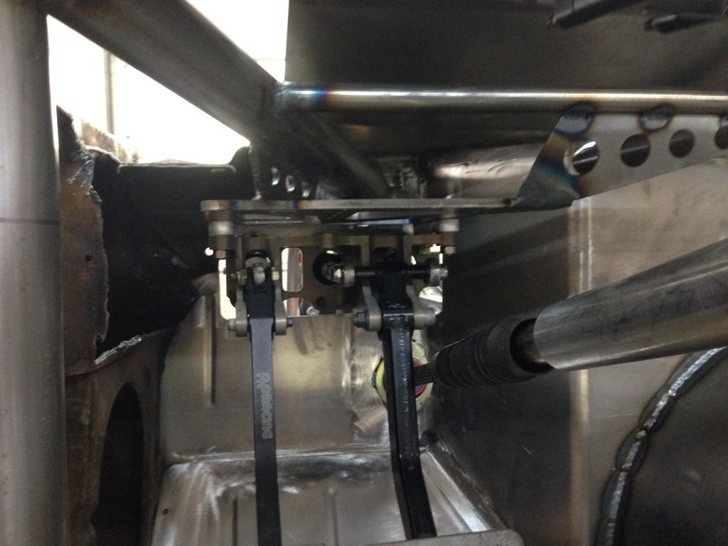

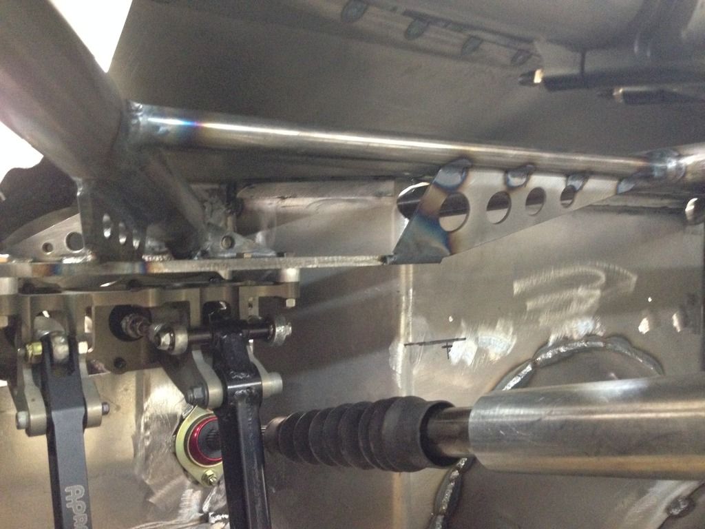

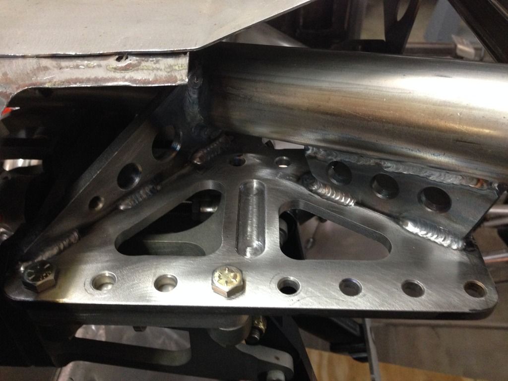

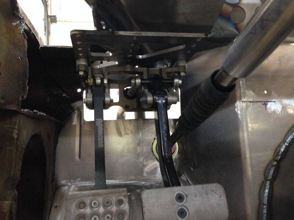

After the steering shaft was final, Jim fabbed up a mount for my pedal box. It is made where I can change the pedals front to rear instead of moving the seat.
http://i1138.photobucket.com/albums/...pseiqtywsz.jpg
http://i1138.photobucket.com/albums/...psnsejfe10.jpg
http://i1138.photobucket.com/albums/...psrpwrqvb4.jpg
And yes he did mill the mount
http://i1138.photobucket.com/albums/...ps2xgk6lkm.jpg
http://i1138.photobucket.com/albums/...psxylosafe.jpg

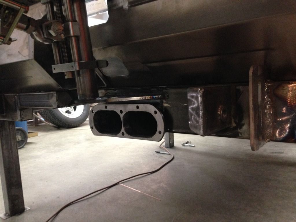

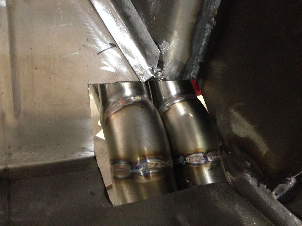

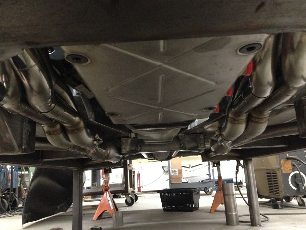

Payton King 08-14-2015 11:56 AM

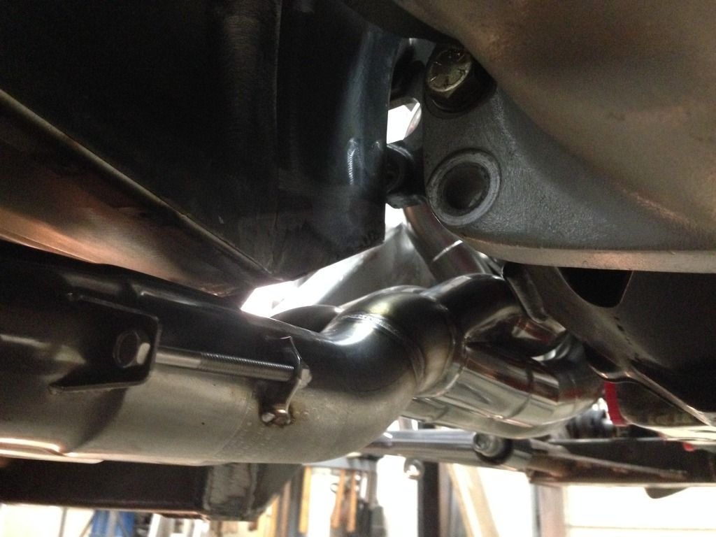

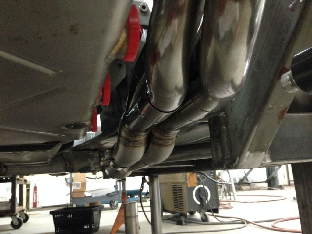

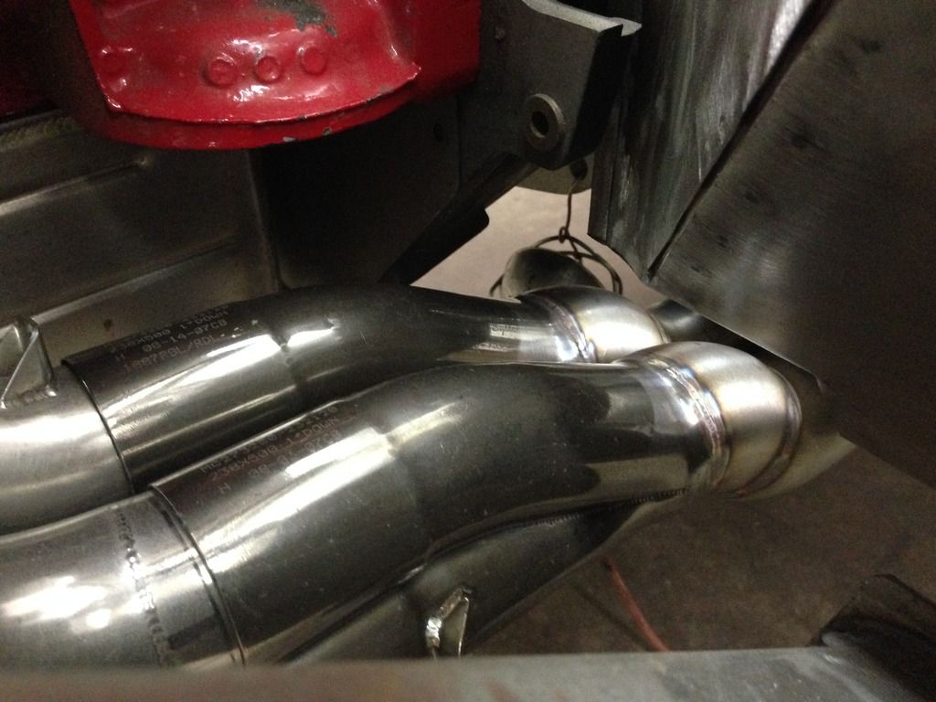

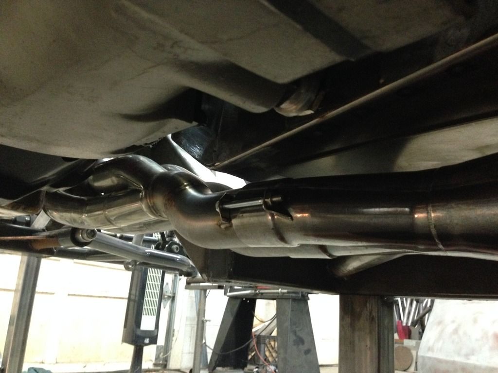

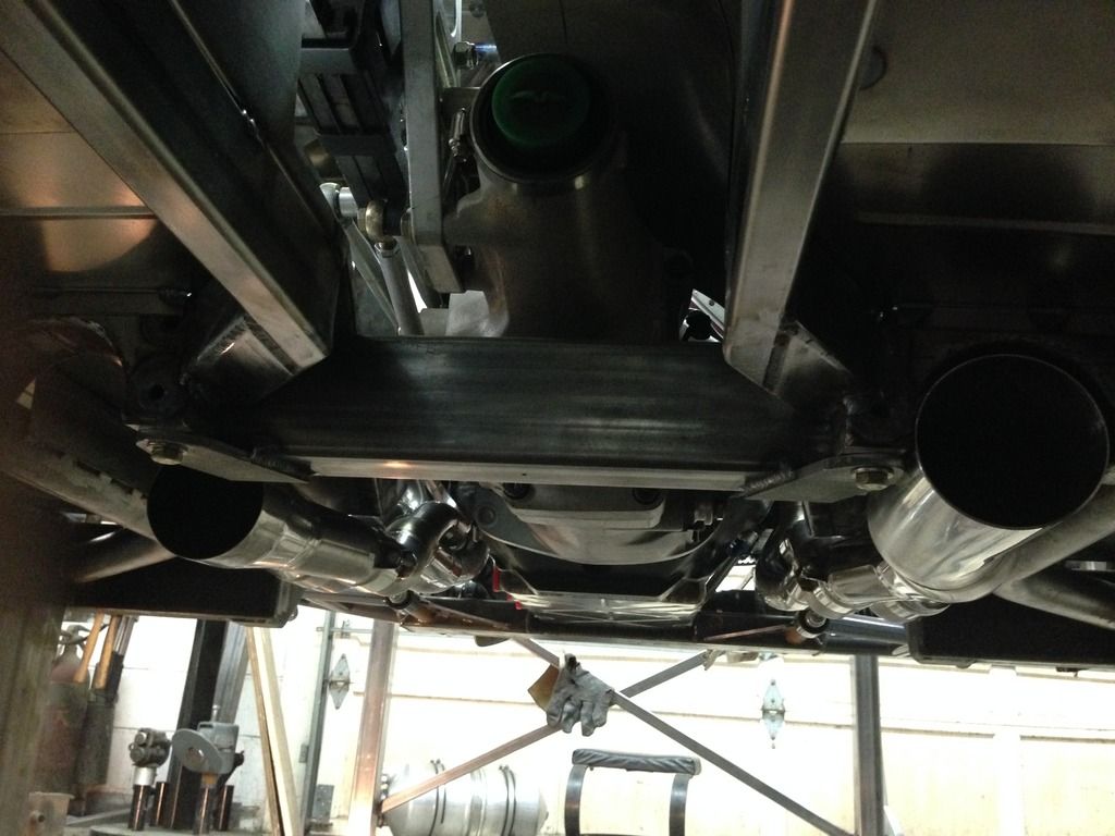

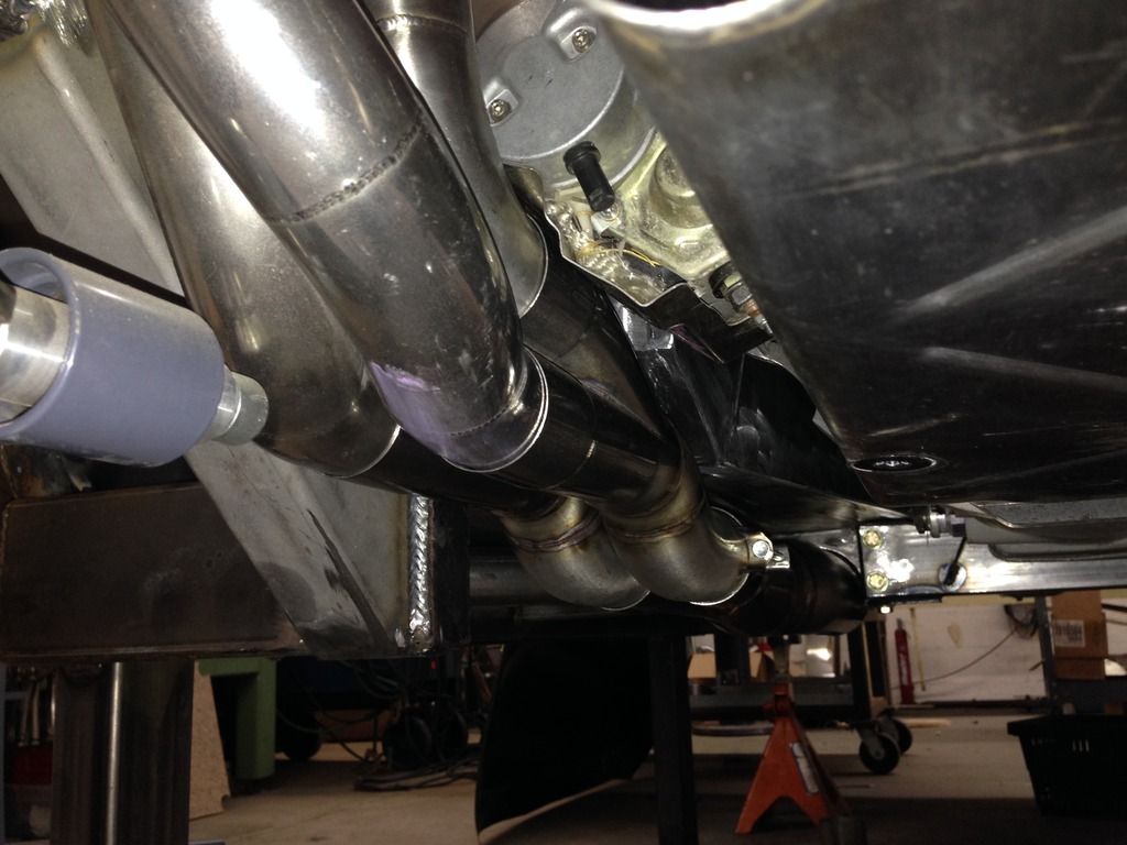

From there, Jim moved onto getting the exhaust routed. He had to drop the intermediate collectors 2 inches to get them under the car and he still had to do a small mod on the floor. Those headers are off a cup car...Jimmie Johnson's 48 to be exact.
http://i1138.photobucket.com/albums/...pspp8kfkbn.jpg
http://i1138.photobucket.com/albums/...ps43kcxv9r.jpg
http://i1138.photobucket.com/albums/...psuvwivayi.jpg

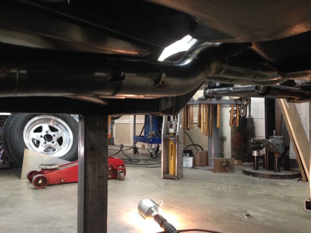

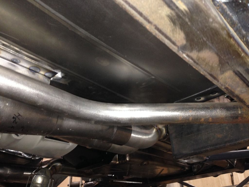

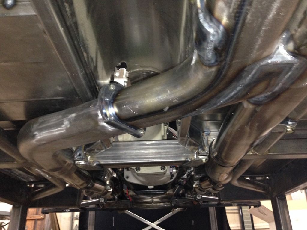

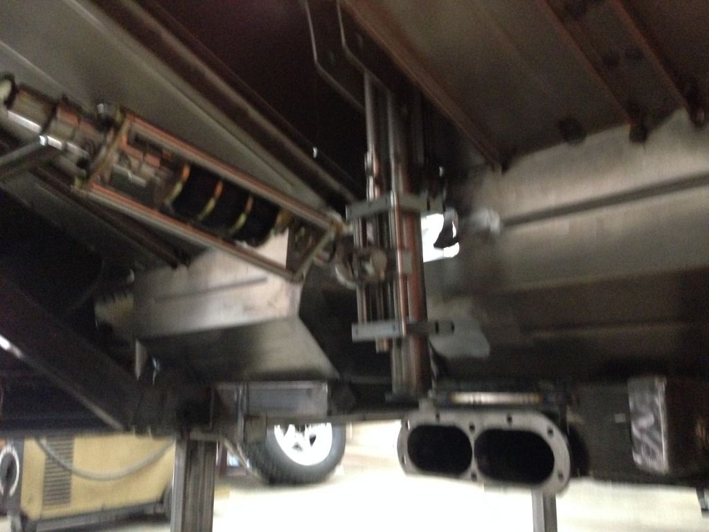

From underneath
http://i1138.photobucket.com/albums/...psbrgqecnu.jpg
http://i1138.photobucket.com/albums/...pstczysvkx.jpg
http://i1138.photobucket.com/albums/...psydqbglgf.jpg

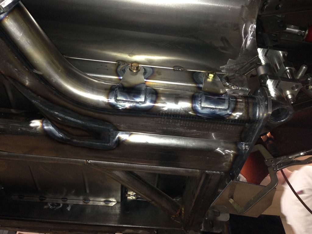

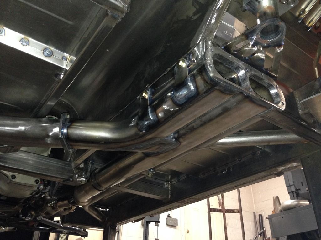

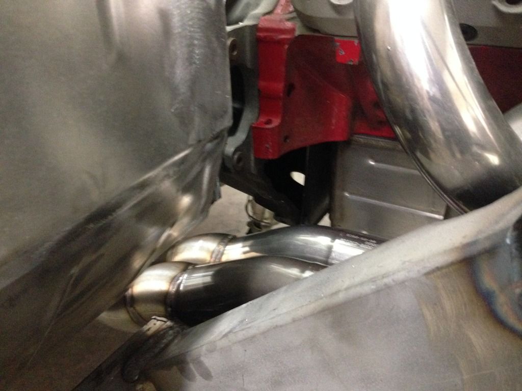

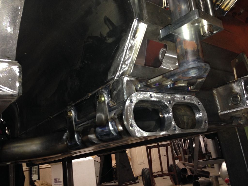

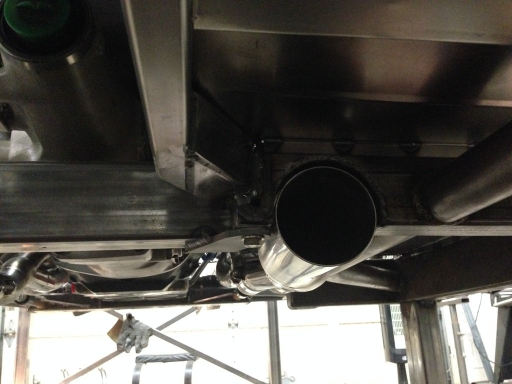

Payton King 08-14-2015 12:22 PM

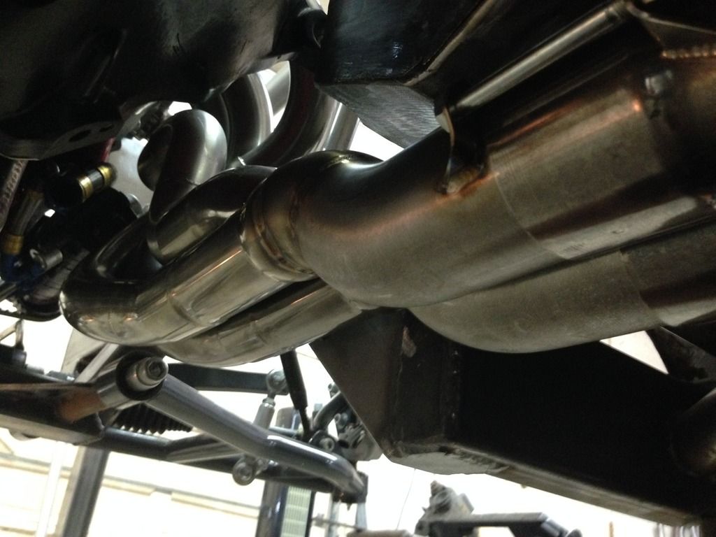

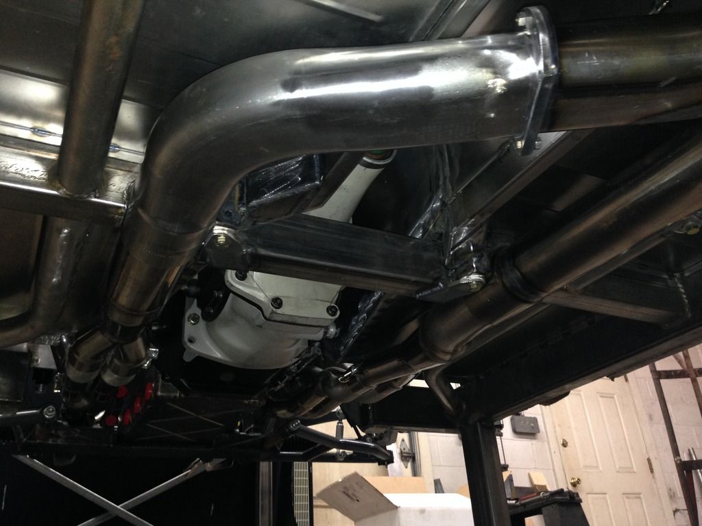

We are trying to keep as much heat away from the driver's side of the car and also keep the exhaust as high up in the car as possible for ground clearance.
http://i1138.photobucket.com/albums/...psej56g4wn.jpg
http://i1138.photobucket.com/albums/...psbu2gzzm6.jpg

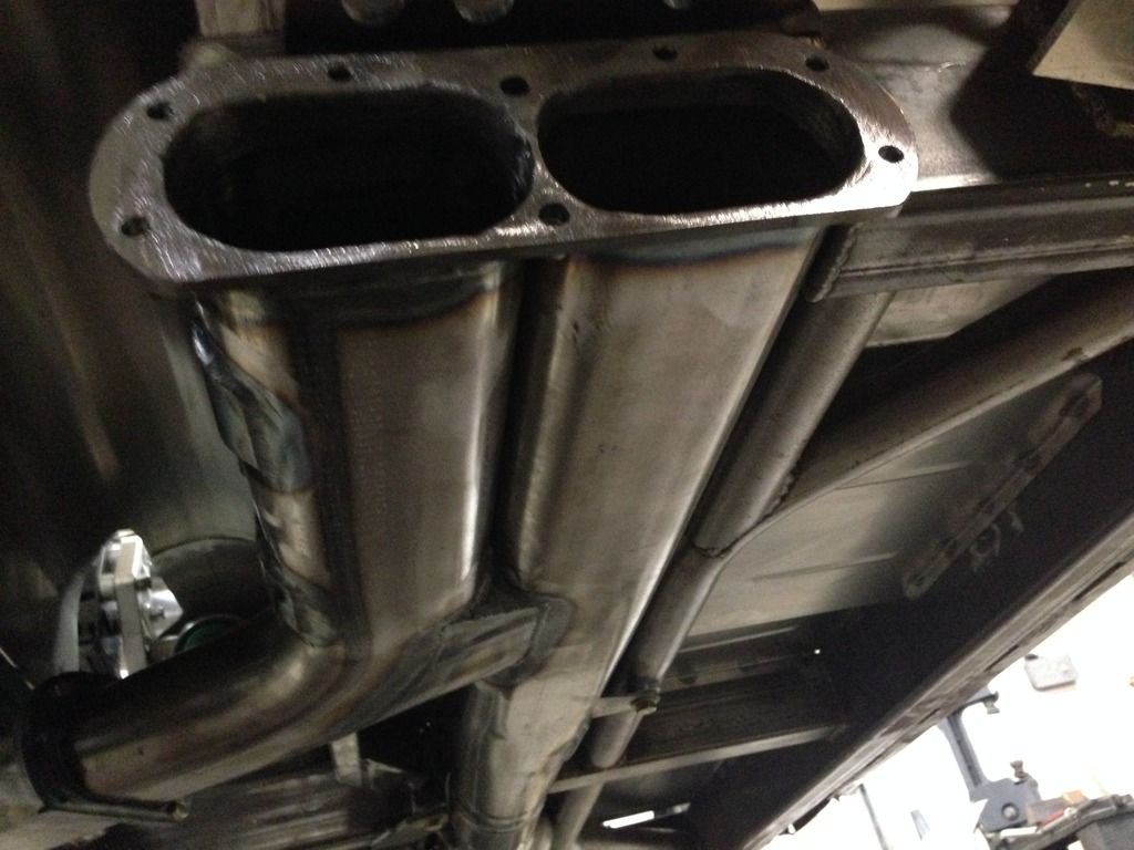

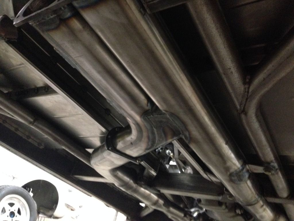

Jim made the transition to oval tubing. Notice that he made a connection between the to oval pipes as a H pipe/balance tube.
http://i1138.photobucket.com/albums/...pslnksg608.jpg
http://i1138.photobucket.com/albums/...psy8rgacom.jpg
http://i1138.photobucket.com/albums/...ps3tazcn3m.jpg
http://i1138.photobucket.com/albums/...psx69hvsuk.jpg
