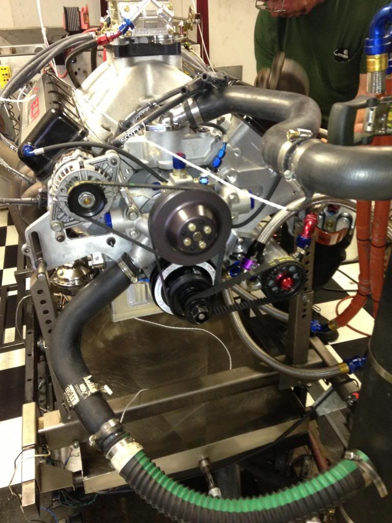

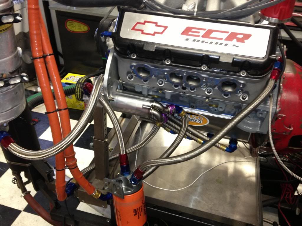

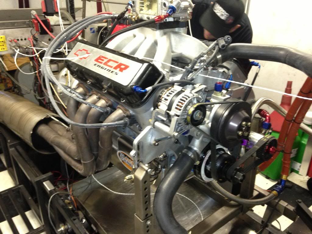

Flash68 08-21-2013 05:39 PM
I feel like I should be more excited but I'm honestly just relieved that all went well. The excitement is starting to build though. :cheers:
Best numbers of the session:
795 hp @ 7200
643 ft lbs @ 5700
600+ ft lbs from 4800 to 6900
30* timing (tried 32* but roughly the same output)
No jet changes
1" 4-hole spacer
after warm up oil pressure settled at 30 psi @ idle
WOT oil psi still kinda high but Mike likes it
Mike is happy with the conservative timing & fuel numbers and thinks that gives me plenty of leeway for any future operator error. :D
I give you the FE Eater... turn up the volume if you'd like.
(and that's Pete on the right... he guards my motor from any Ford saboteur)
http://i236.photobucket.com/albums/f...ps1bfd5f9f.jpg
http://i236.photobucket.com/albums/f...psc3e683a7.jpg
http://i236.photobucket.com/albums/f...pse59519d9.jpg
http://i236.photobucket.com/albums/f...ps419e0eae.jpg
http://i236.photobucket.com/albums/f...ps2de208c2.jpg
