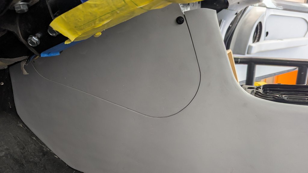

Goosesdad 04-25-2025 06:54 AM
1 Attachment(s)
Fuse box access panel done. Realizing this is sorta boring!
Attachment 84153

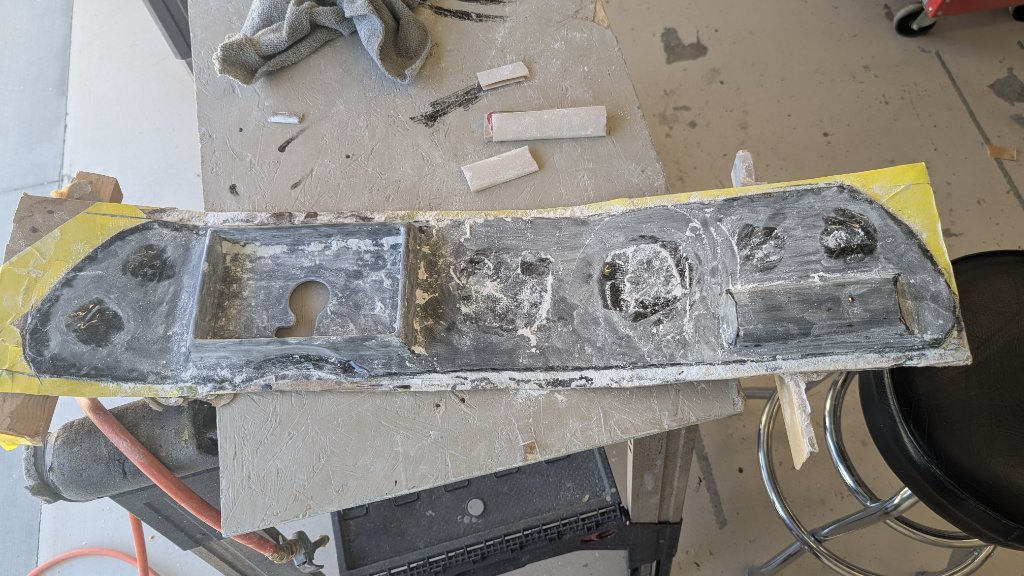

Goosesdad 05-11-2025 07:59 PM
2 Attachment(s)
Sand, sand sand. 120 to 400. More interesting pics coming.
Attachment 84387
