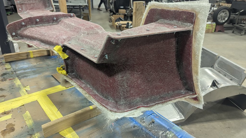

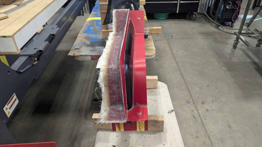

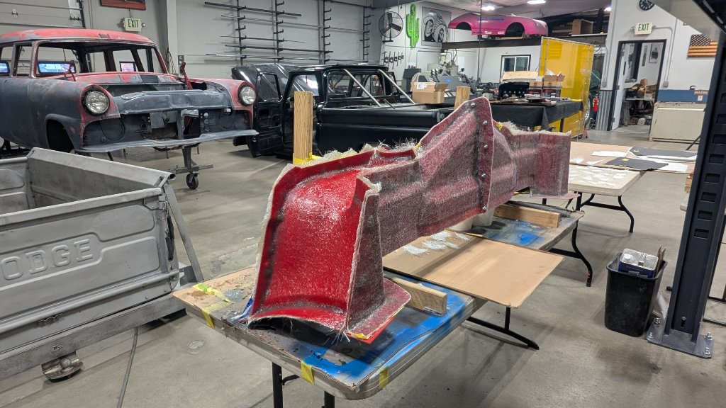

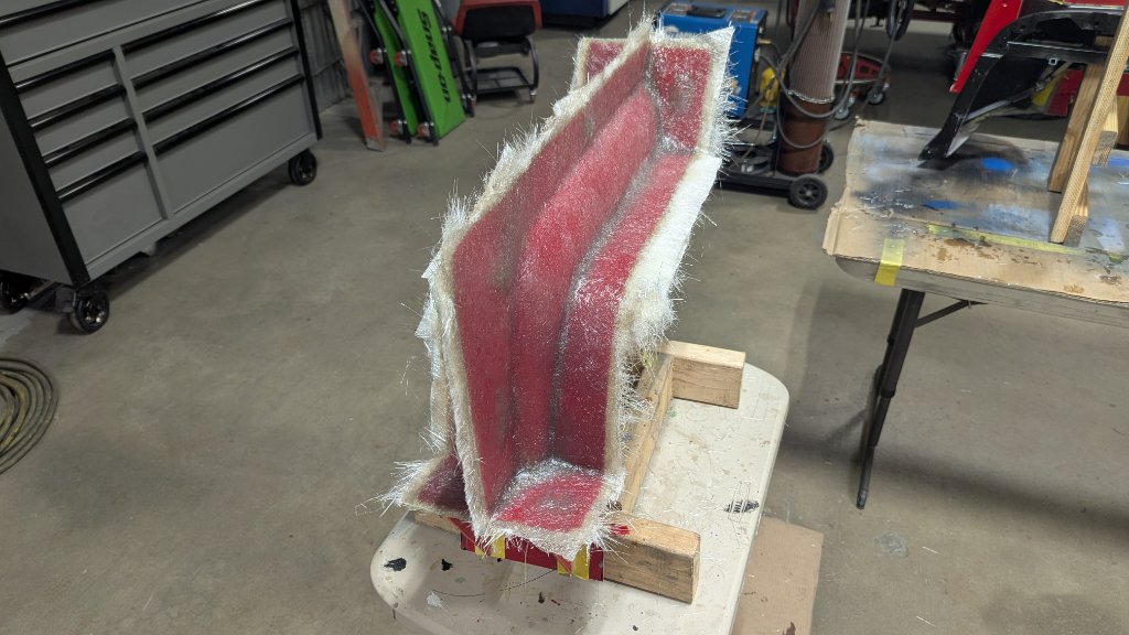

Making progress on the molds, it's just a slow process with curing and making flanges. Tedious but I'm making the spoiler mold pretty stout as there is a decent chance I may need to.... I'm not gonna say it.

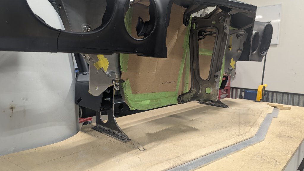

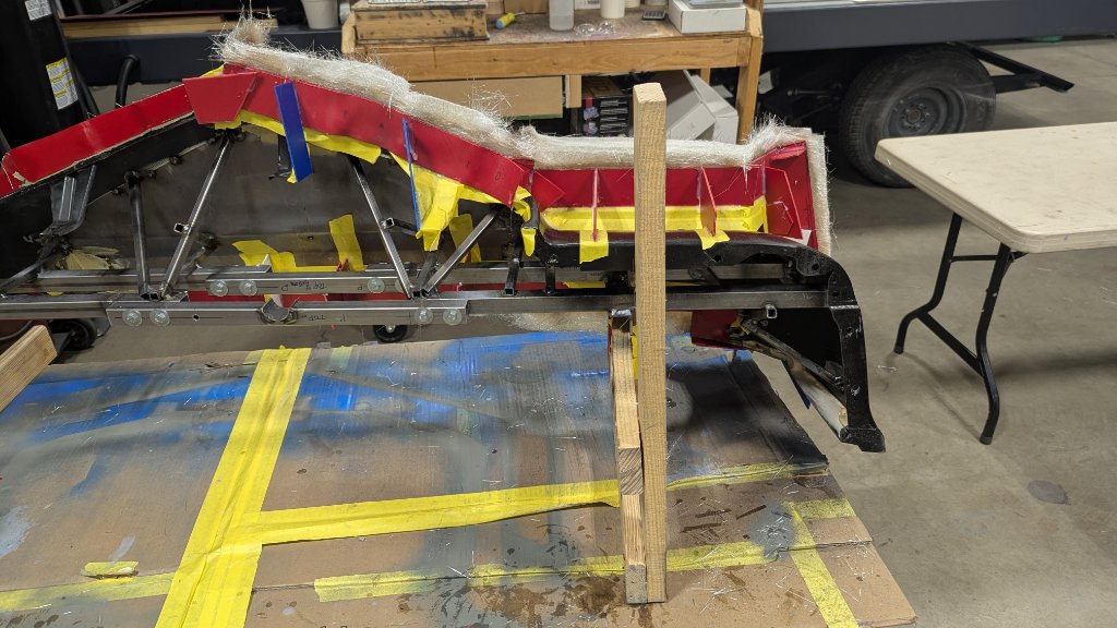

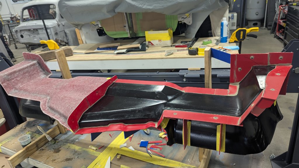

I use sign makers plastic for making the mold flanges. It's cheap, cuts nicely and shapes with very little heat, and easy to get.
Masking tape so the hot glue doesn't permanently stick to anything.
Use a lot of cripples so the plastic doesn't move or break off during laminating, last thing you need with wet 'glass!
Attachment 85650

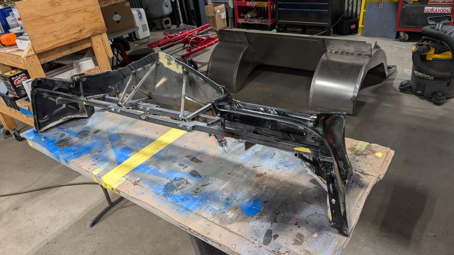

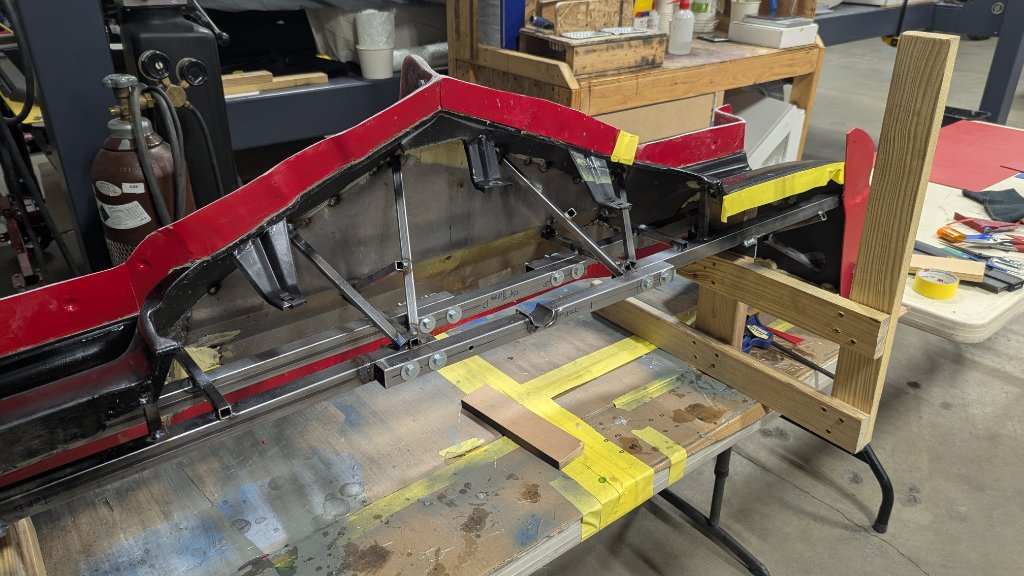

I welded in a fairly stout inner structure while the valence was still on the car. Given the weak-@ss nature of how the shape of the spoiler was created, can't have anything flexing once it comes off the car.
Attachment 85651
Attachment 85652

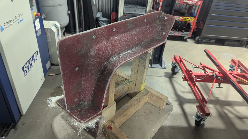

Other side of the bumper mold laminated.
Attachment 85653

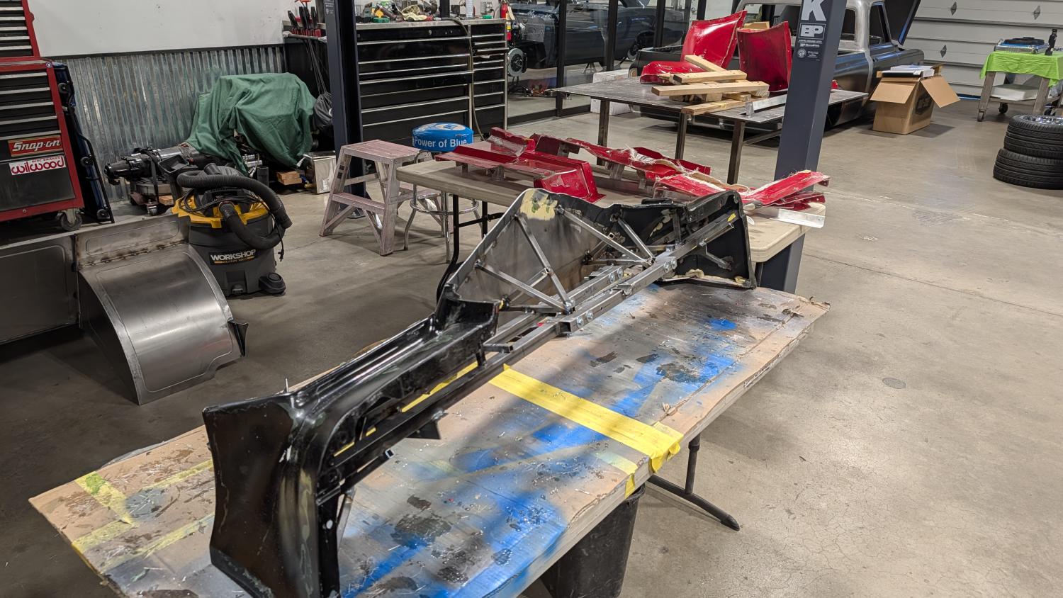

Tacked up the spoiler mounting brackets.
Attachment 85667

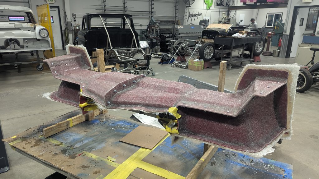

Bumperette mold almost complete
Attachment 85668
Spoiler mold almost complete
Attachment 85669
Attachment 85670
Attachment 85671

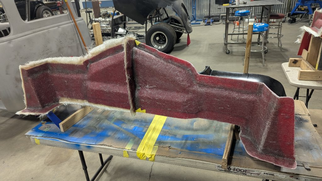

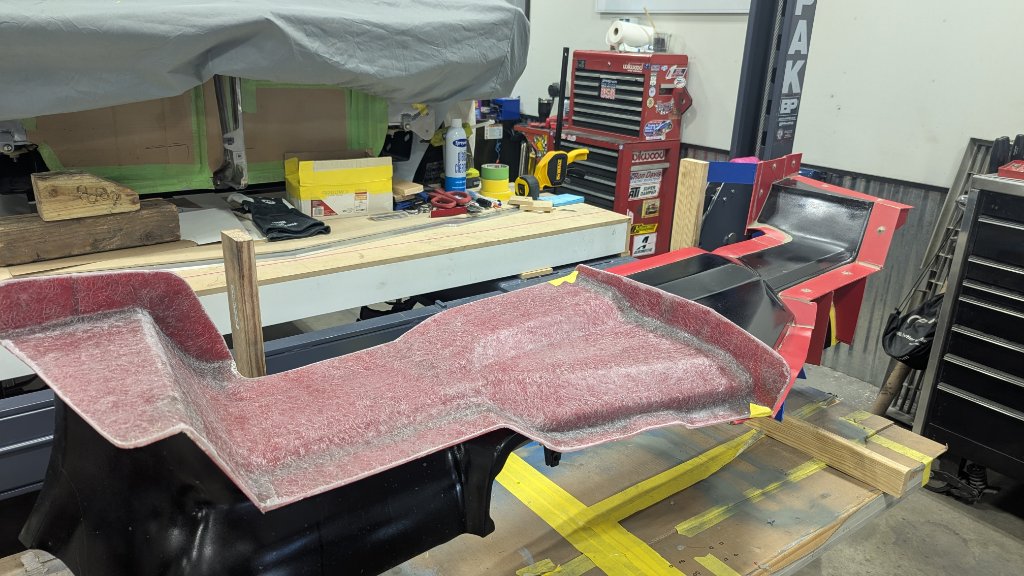

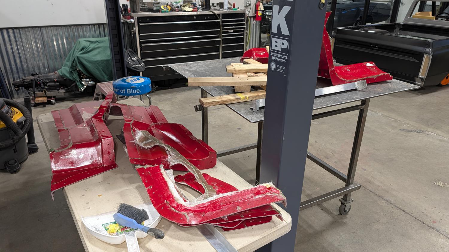

2 of the molds are complete now, here is the mold sections right after pulling them off the plug.
Attachment 85808
The mold parts and the plug.
Attachment 85809
The plug getting ready to go in the trash. I cut off some of the nose piece mounting brackets. I will use them on the final part, it will make sense later.
I set the mold aside and forgot to take pics of it, will do next week.
Attachment 85810

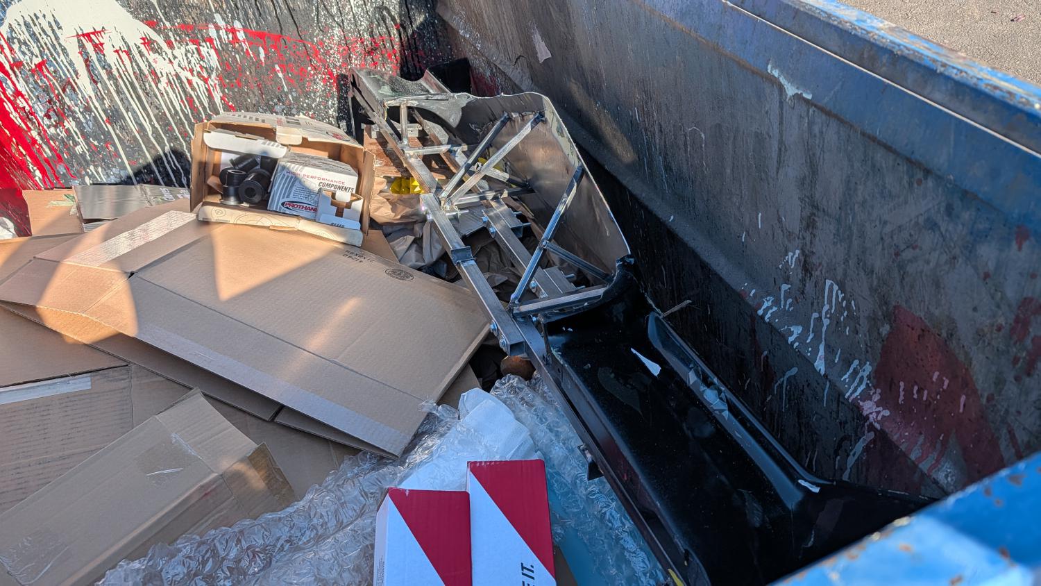

Threw the plug in the trash. That's always weird! I made this mold pretty darn stout and braced the heck out of it so it doesn't warp once I make the part and put it up on a shelf. Hopefully I'll never need it but if so, at least it should be as straight as the day I made it.

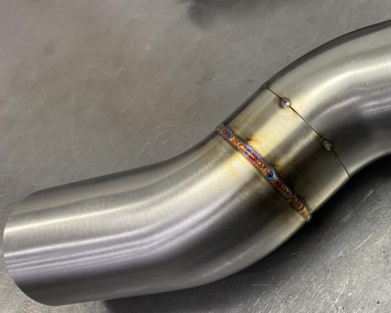

Wanted to ask a question about you mentioning using a scotchbrite on the headers. Is that to give it a brushed look?
I'm going to have some exhaust work done on some 304 stainless next year and like the brushed look as opposed to the mill finish. Any tips to offer this novice are appreciated to achieve a finish like the pic below, TIA.
Attachment 85818
