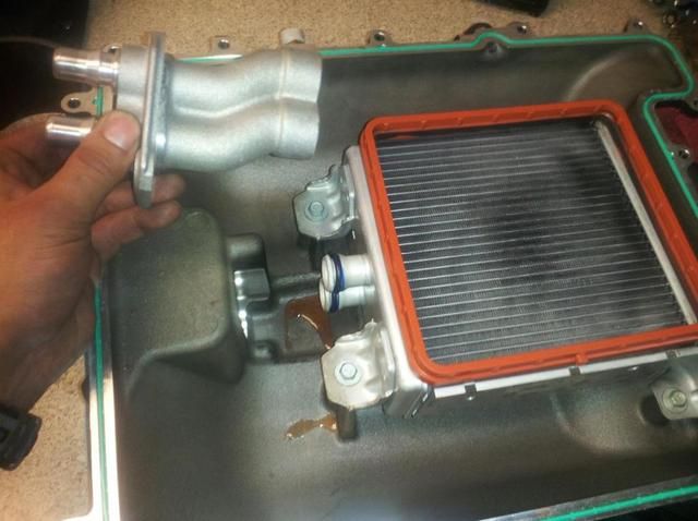

Originally Posted by Stielow (Post 605261)
We have the 40 mm taller intercooler bricks and spacers in from C&R. We hope to dyno is in a couple weeks.
http://i439.photobucket.com/albums/q...psvuh10qua.jpg
http://i439.photobucket.com/albums/q...pseadmdu1j.jpg
I had to purchase 4 sets to cover the tooling so if someone needs/wants a engine set IM me.
Mark

Stielow 05-13-2015 12:45 PM
Originally Posted by Ketzer (Post 605300)
Hmmm, I wonder if those would fit my CTS-V....?
A CTS-V lid and a ZR-1 blower lid have the same bolt pattern.
So will it bolt up... Yes. I would need to look at the sealing inside on the bottom of the bricks to the blower.
Mark

waynieZ 05-13-2015 03:11 PM
It won't fit, the LSA has a single brick and it sits right in the middle over the opening in the supercharger. I already asked if C&R was going to do something similar for the LSA and they told me not right now but you never know. They would probably sell a ton of them if they did.
