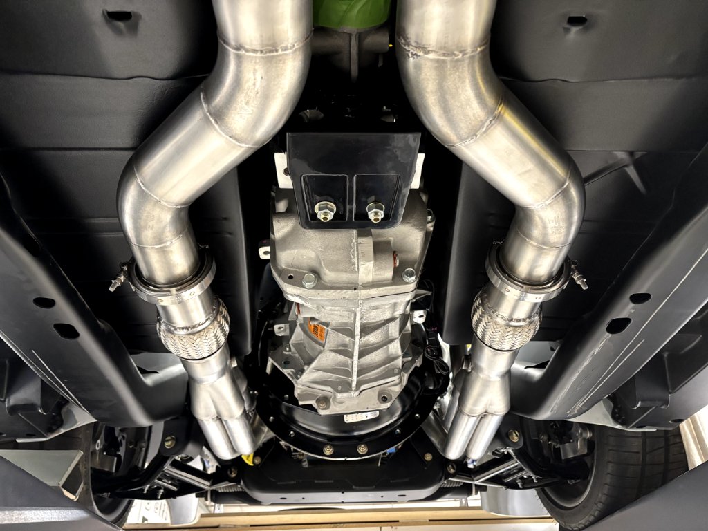

Yep, Scotchbrite just to clean up the tubes and the welds. Your pic is probably more likely done with a tubing belt sander. I'm going to wrap my entire exhaust so I'm not really super concerned with super detailed finishing but you should easily be able to duplicate your pic.

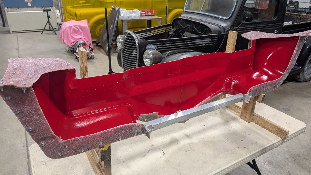

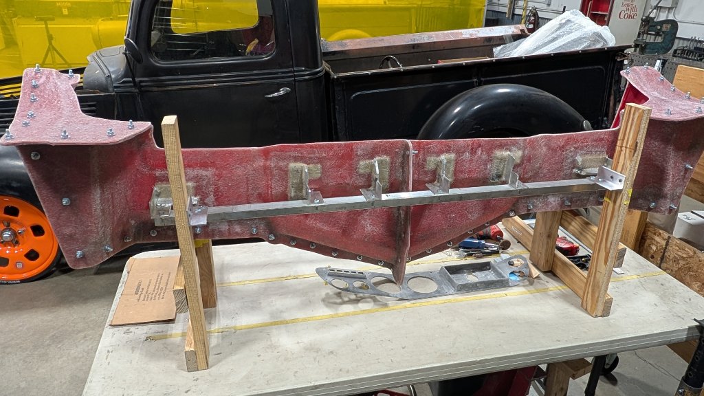

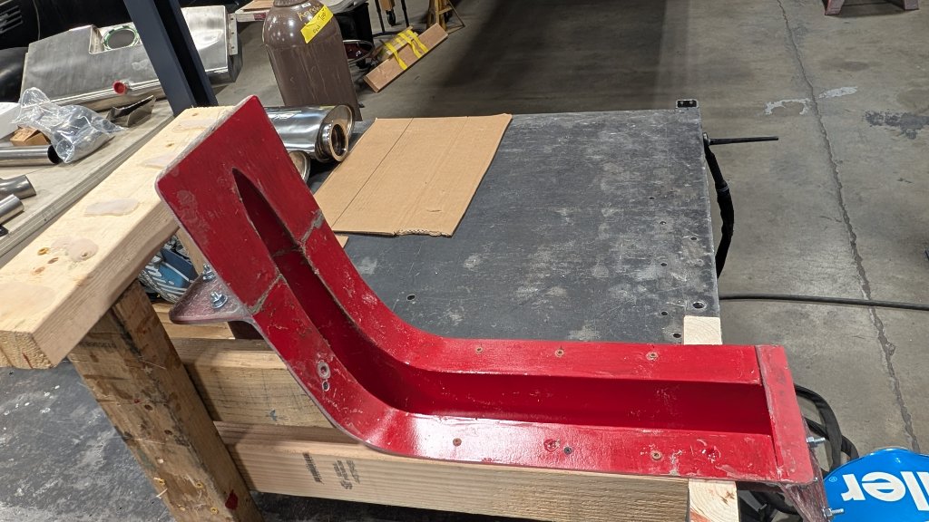

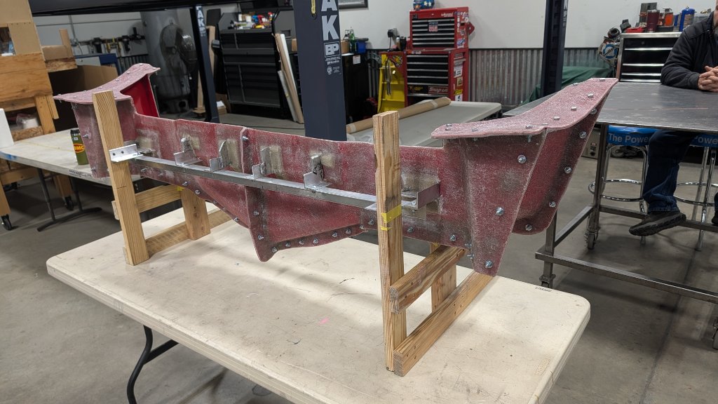

Here are the pics of molds put back together and the stands mounted. I still need to do final wet sanding and polish of the gelcoat before making the parts but that should get underway next week.
Attachment 85839
Attachment 85840
Attachment 85841
Attachment 85842

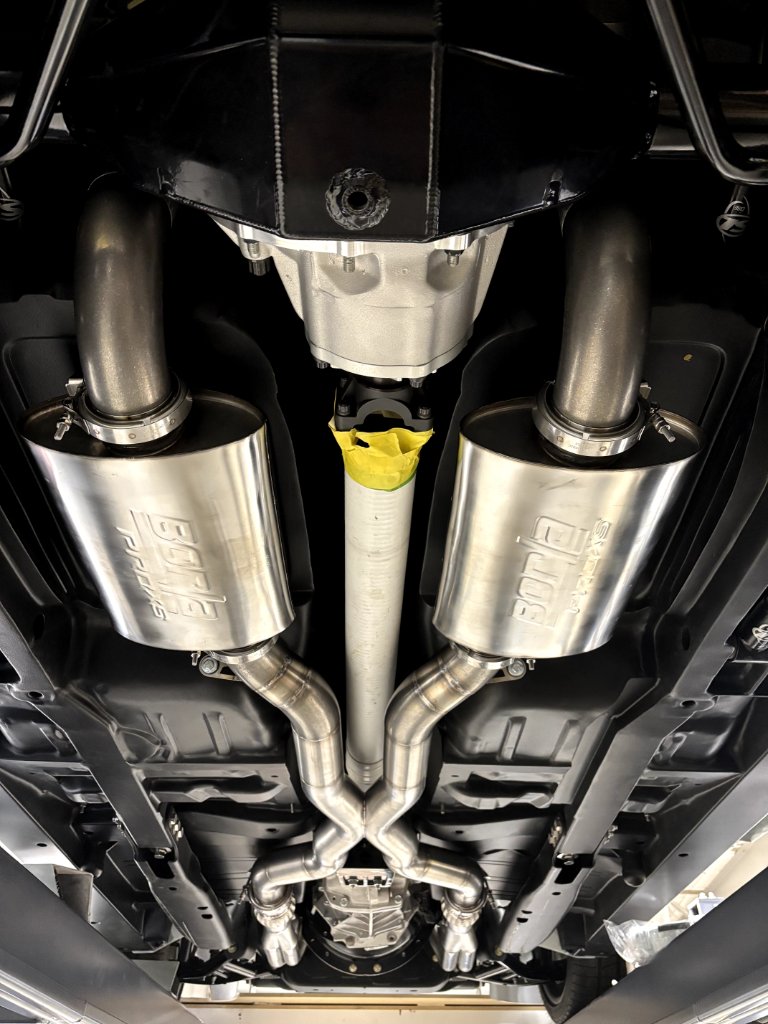

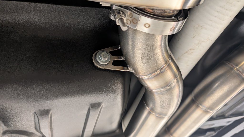

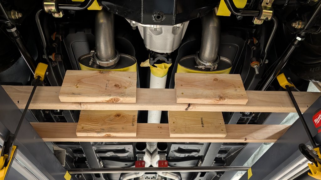

Yes, that's 3" irrigation drain pipe subbing in for a 4" driveshaft. Ha!, use what you got!
Attachment 85924
All buttoned up to the rear-end. We will continue out the back next week.
Attachment 85925

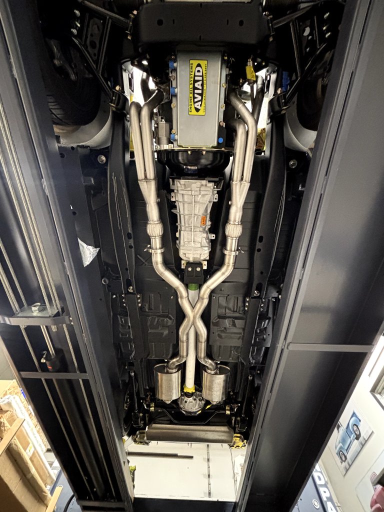

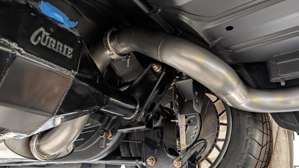

I'm so thankful for Kenny Welch of Kenny's Rod Shop for helping me for the last 2 weekends get the exhaust looking real nice. So awesome to be around dudes with this level of talent.

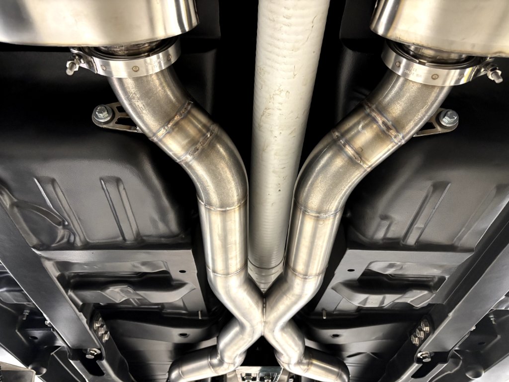

On Kenny's advice.... Though I did buy a Borla Universal kit, he likes to use sanitary pipe elbows from an industrial piping supply house. Super clean way to have perfect flat surfaces at exactly the right angle. So, I didn't need the Borla kit but I'll find a good home for it - lesson...ask the experts before ordering! When the dust settles, I think the cost of those pieces and a couple straight sections is less than the Universal kit but the fit is sooo tight! Highly recommend!
Attachment 85926
CamaroAJ 11-30-2025 03:00 PM
Sanitary pipe bends are hydro-formed so they don't oval out when you cut them like mandrel bends do. More expensive, but higher quality end product.
Cramer4918 12-01-2025 06:00 AM
Great info on the sanitary pipe bends. I learned something new! Exhaust looks awesome and super clean.

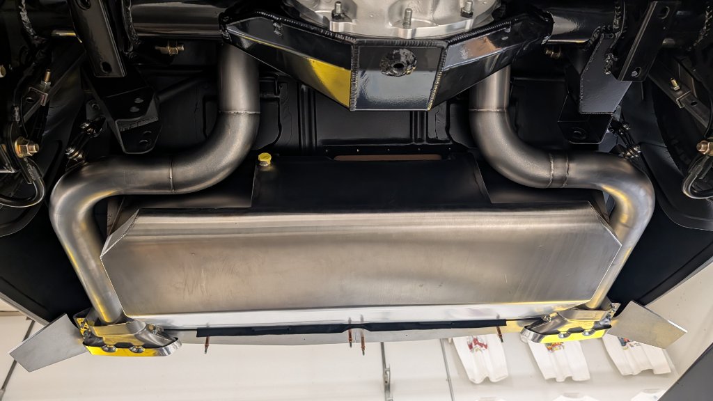

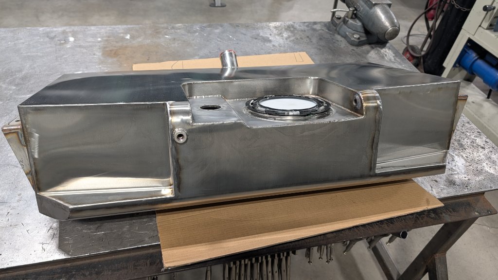

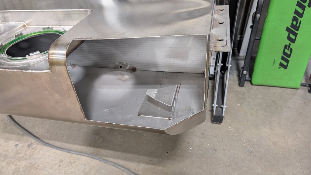

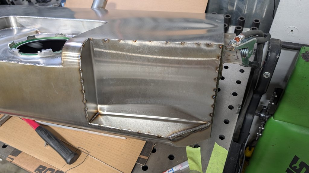

99% finished with the exhaust, still working out how I'm going to connect or not connect to the exhaust tips. Again, more skilled help from one of Kenny's guys! I wouldn't pick up the torch around here! So much fun going to "work" everyday.

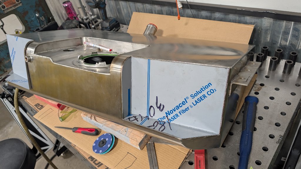

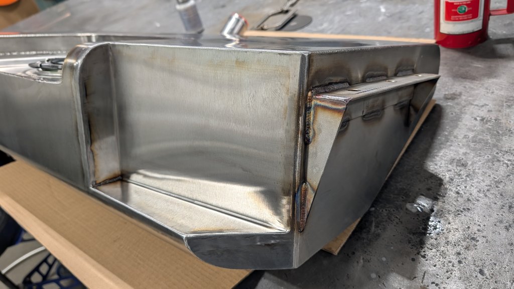

Gas tank needed significant notching.
Attachment 85966
Attachment 85967
Attachment 85968
Added some bracing to support the tank mounts that I did long ago.
Attachment 85969
Attachment 85970
Attachment 85973
Attachment 85971
I know it looks real close, it is! Only about 1/4" but I'm going to wrap the entire exhaust so it should be fine.
Once I finish the aluminum surround/side skirt around the exhaust tips (for sure it won't hang down as it is now - just haven't inked it yet), I'll figure out how the exhaust attaches.

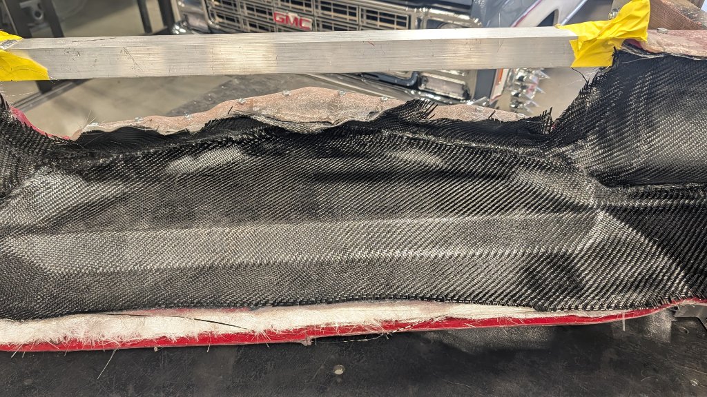

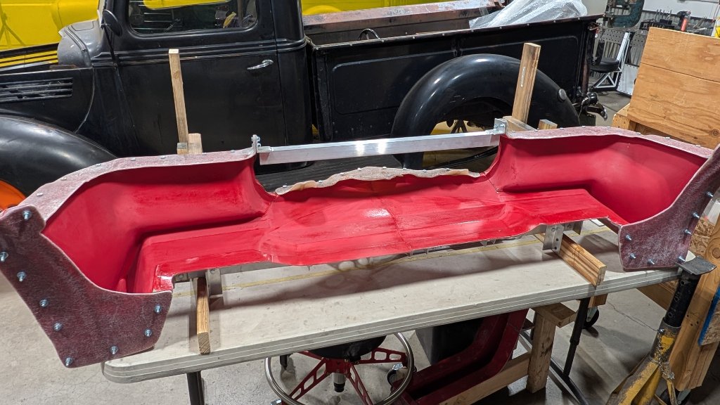

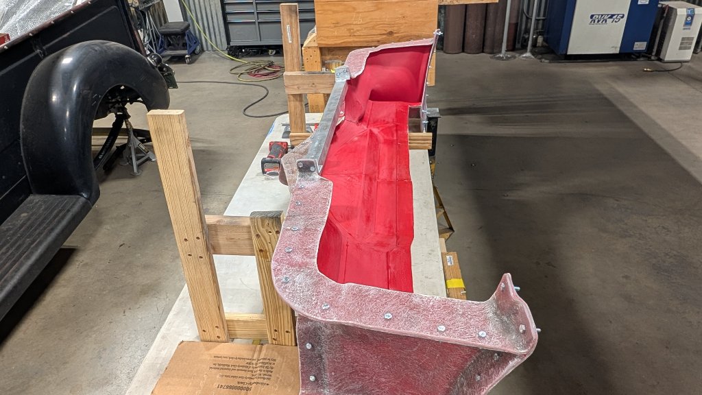

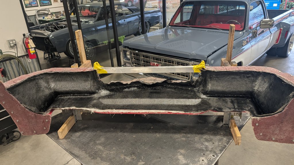

Mold put back together, prepped for laminating the part.
Attachment 85977
Sprayed PVA Mold Release.
Attachment 85978

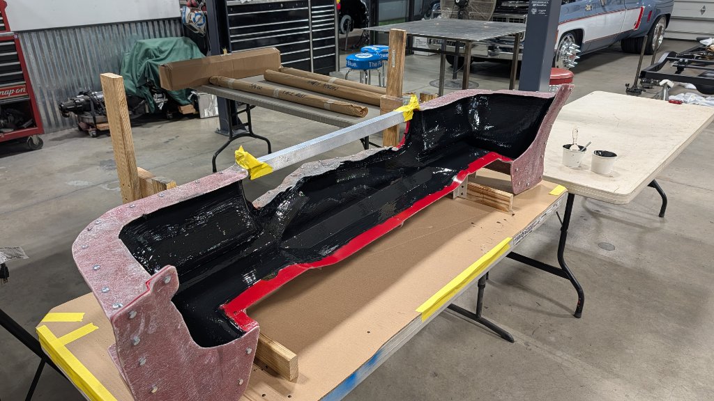

Brushed on the gelcoat. No great way to accurately spray it with this mold, just to many tight areas to insure a consistent layer. Brushing is an OK alternative but will have pin holes. This thing will get body-worked during paint so no worries.
Attachment 85979

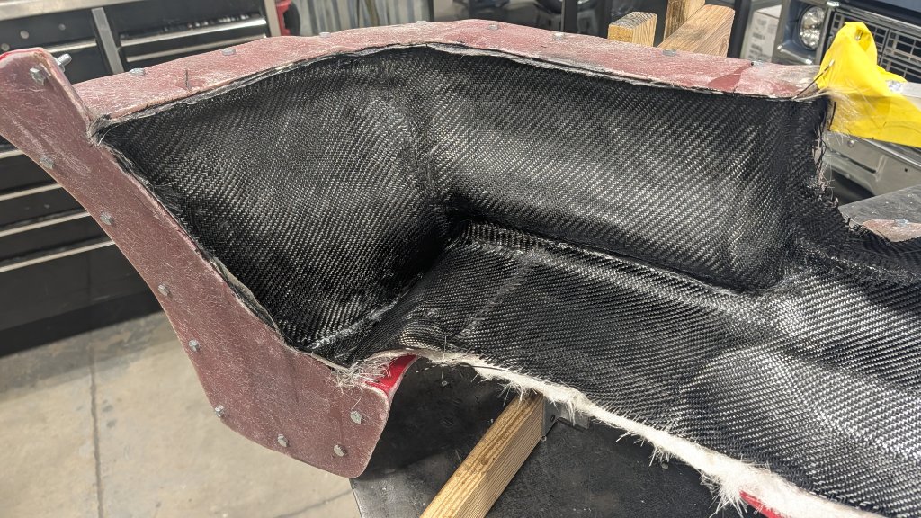

First layer of 3/4oz mat fiberglass and 3/32" glass fibers in the tight corners.
I also added a small piece of 3/8" aluminum in the outer most section for the splitter to bolt up to later. Buried it in with the carbon Will drill and tap. Didn't get pics of that as I was elbows deep in resin.
Attachment 85980
Added the carbon.
Attachment 85981
Attachment 85982

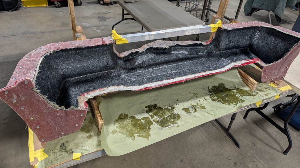

This will sit in the mold for a couple weeks. More to come soon. Hope everyone has a wonderful Christmas and Holiday!!
Attachment 85983
