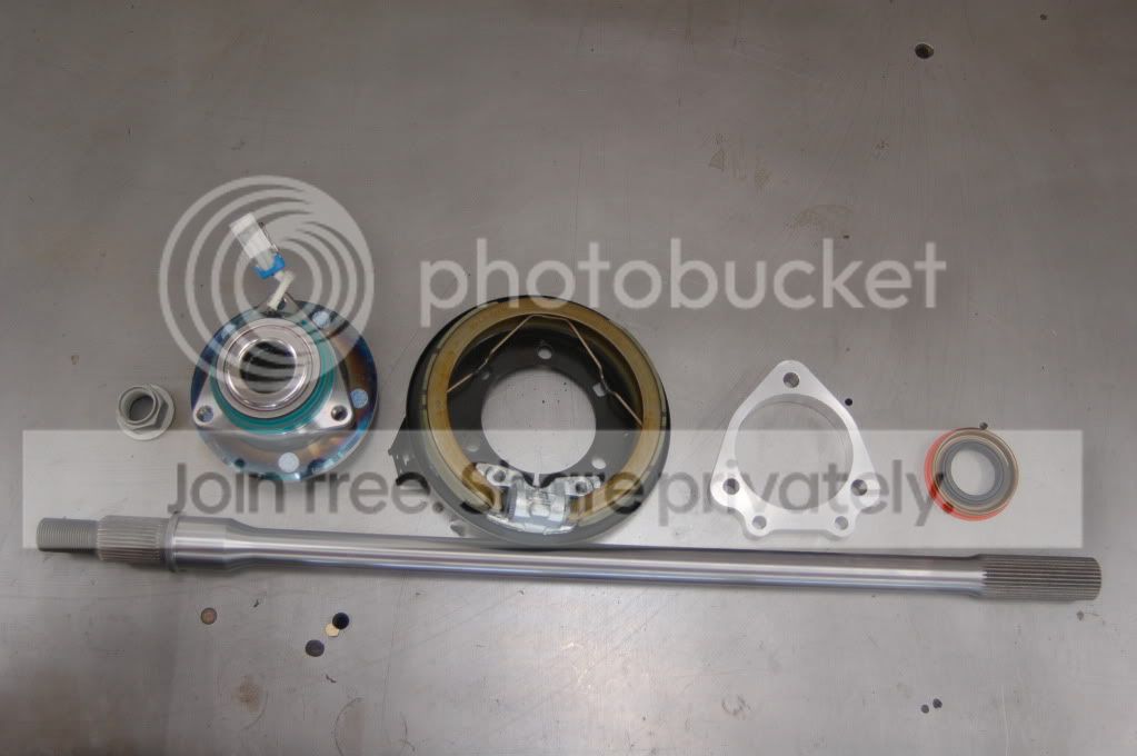

The new rear axle ABS set up had zero issues. No ABS drop out, no brake knock back and no leaks. My new axle uses Corvette ZR-1 bearing set up to go on the end of a Currie Ford 9 inch housing. I was having issues with my old Ford Big Bearing set up dropping the ABS signal. This set is basically a full floater with Corvette ABS sensor. It also allows me to use the Corvette park brake and a GM axle seal. The whole thing is awesome!

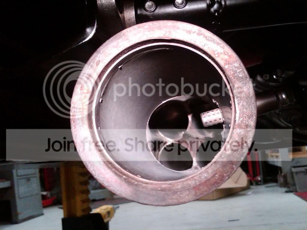

The new blower is giving me 2 psi more boost so we had to move the over boost calibrations up and verify the new calibration. The engine ran great with the highest stabilized water temp of 231 degrees. On a cooler day I will make even more power. At 230 we are just starting to pull spark. I know you GEN I SBC guys freak out at coolant temps above 200. The new engine will work fine up to 235 degrees. They are happier at 210 -220 but it is still OK. I pulled a spark plug tonight and they look great and the inside of the headers are a nice light tan. The engine calibration is dead on. Since I put my Thomson Auto engine in my car I have had very little issues. We have driven this deal hard and it keeps on pulling. I love the fact it idles at 650 and rips when you hit it.

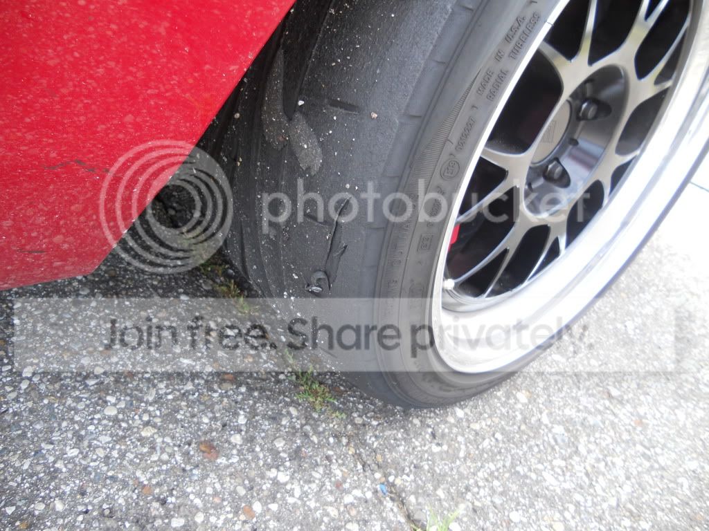

I used up the last of the old Goodyears, once they showed signs of the tread de-laminating we called it a day.
I think on fresh tires and a slightly cooler day we can go a little faster.
