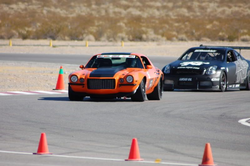

How much camber were you running in the pick ? looks like a ton from that angle .Any chance you shortened the upper A arm and took some -camber out ? Just guessing here .

The backspacing I use is simular as the rear on a C6 Z06. I use that on all four corners. The rear wheels are 13" wide and 9.25" back space. The fronts are 11.5" wide 8.5" back space. The wheels will be priced dependant on size and color choice. Mine are special made wheels that on not on the website. DPE does a great job with their wheels and and come up with many setups. $1200 per wheel is about average. Mine might be a bit more than that.
