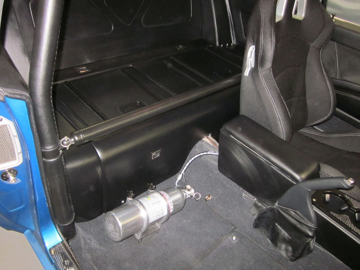

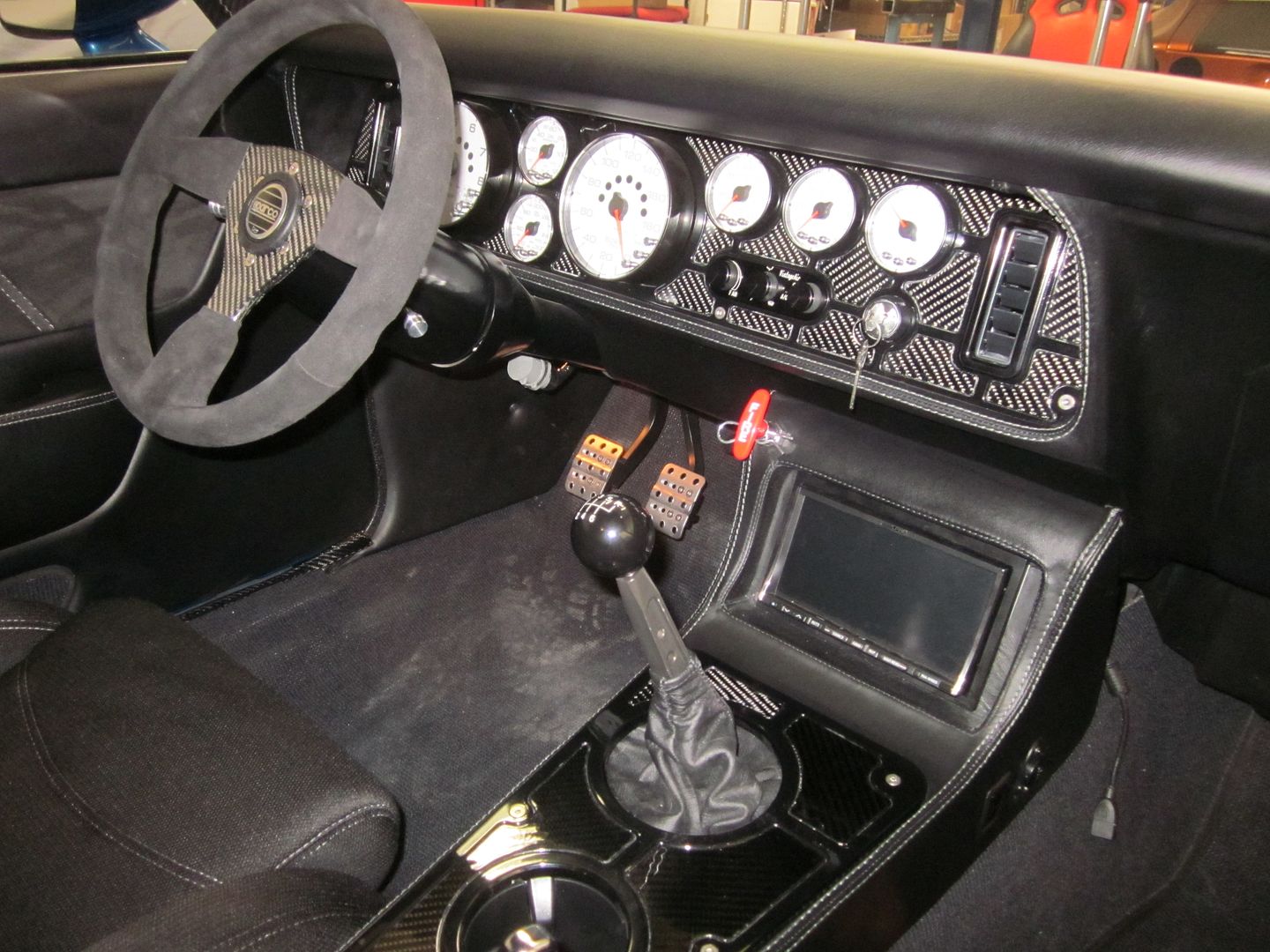

Been working on wraping up the interior on the 68... Got the stereo system done.. got the correct fuel gage in.. finished the A/C system.. & got all the fire system on the car..

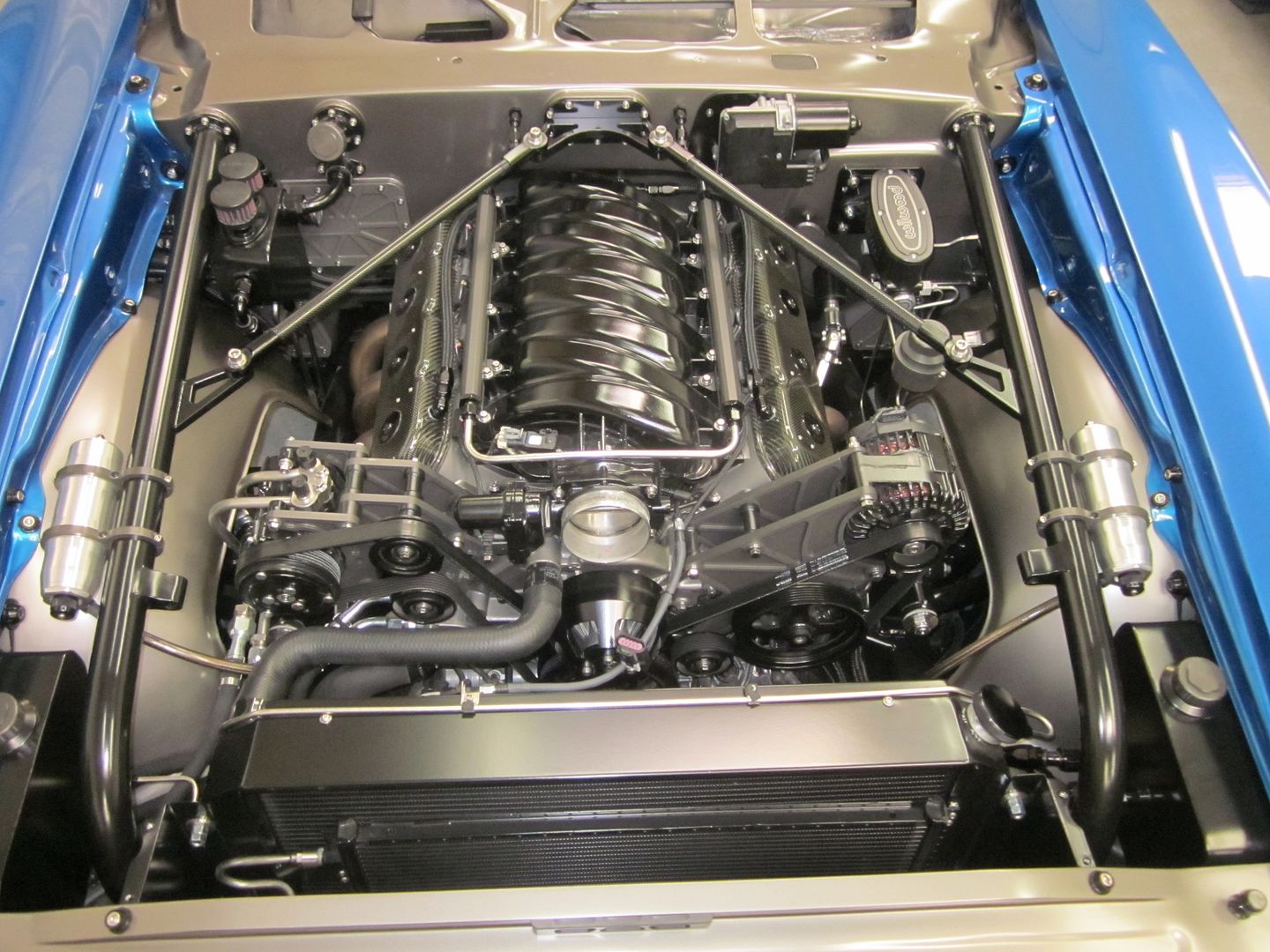

Got all the front sheet metal back on the car.. The new inner wells fit perfect! No modifications.. Thanks Brett @ Fab53! no more tire rub either..
http://i1015.photobucket.com/albums/...n/IMG_1972.jpg
I just got back from having the car on the chassis dyno... The Mustang Dyno gave 495 RWHP.. I was told that is pretty good.. I wanted more! But I guess that is not bad for a Stock LS7 that was just blueprinted & cammed!
