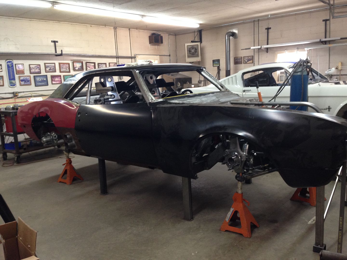

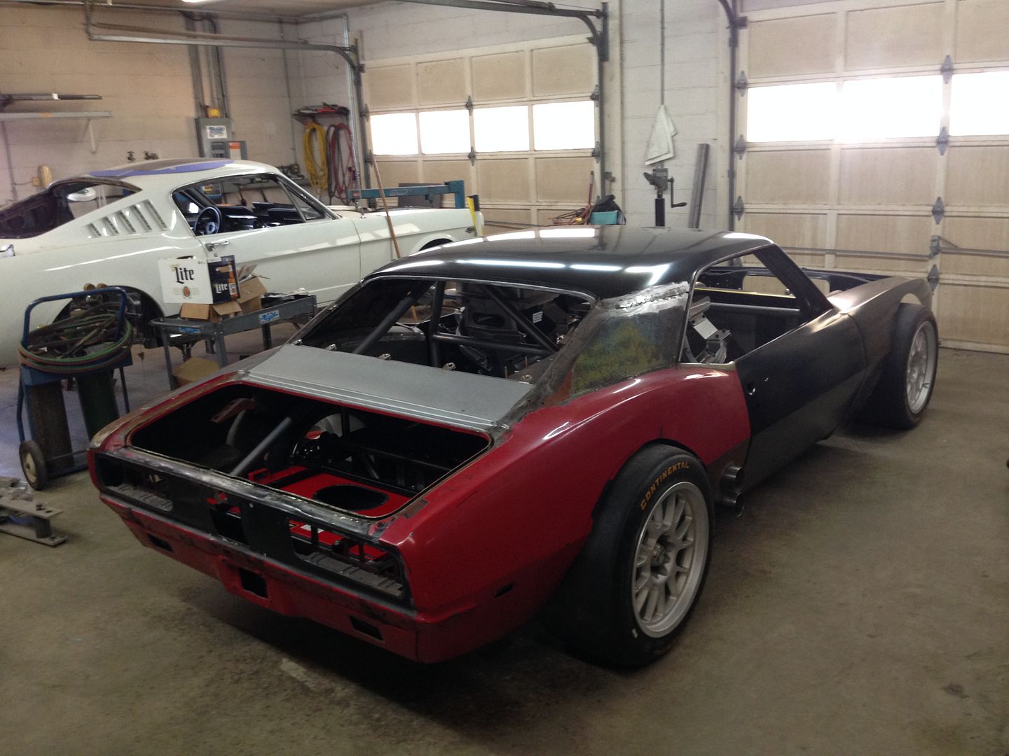

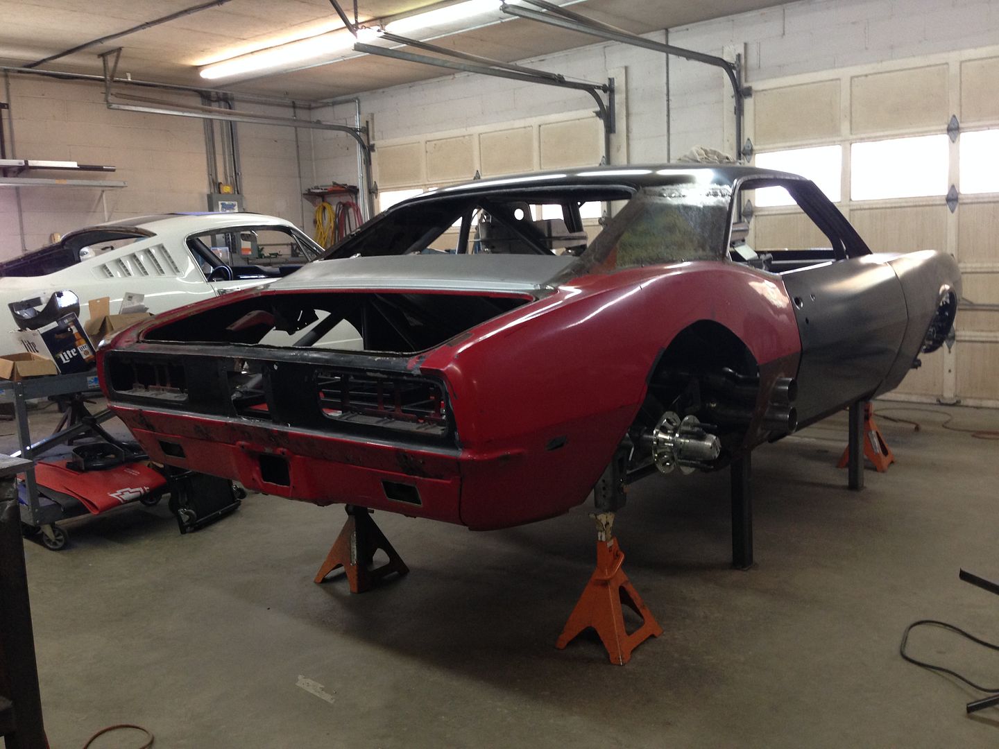

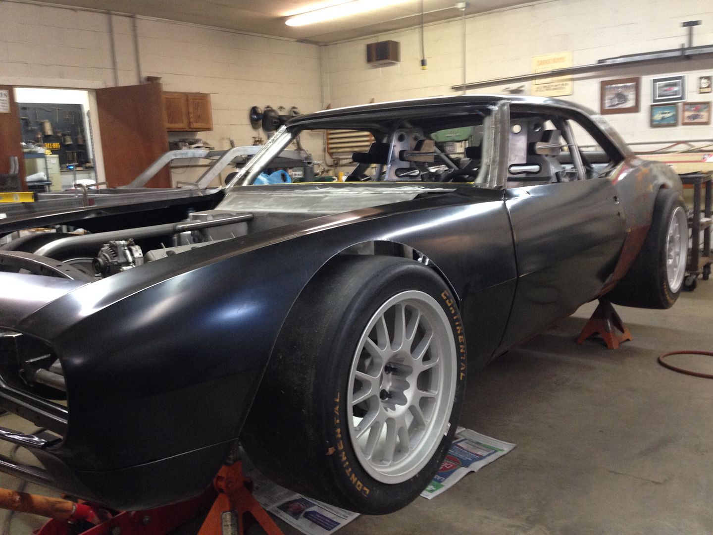

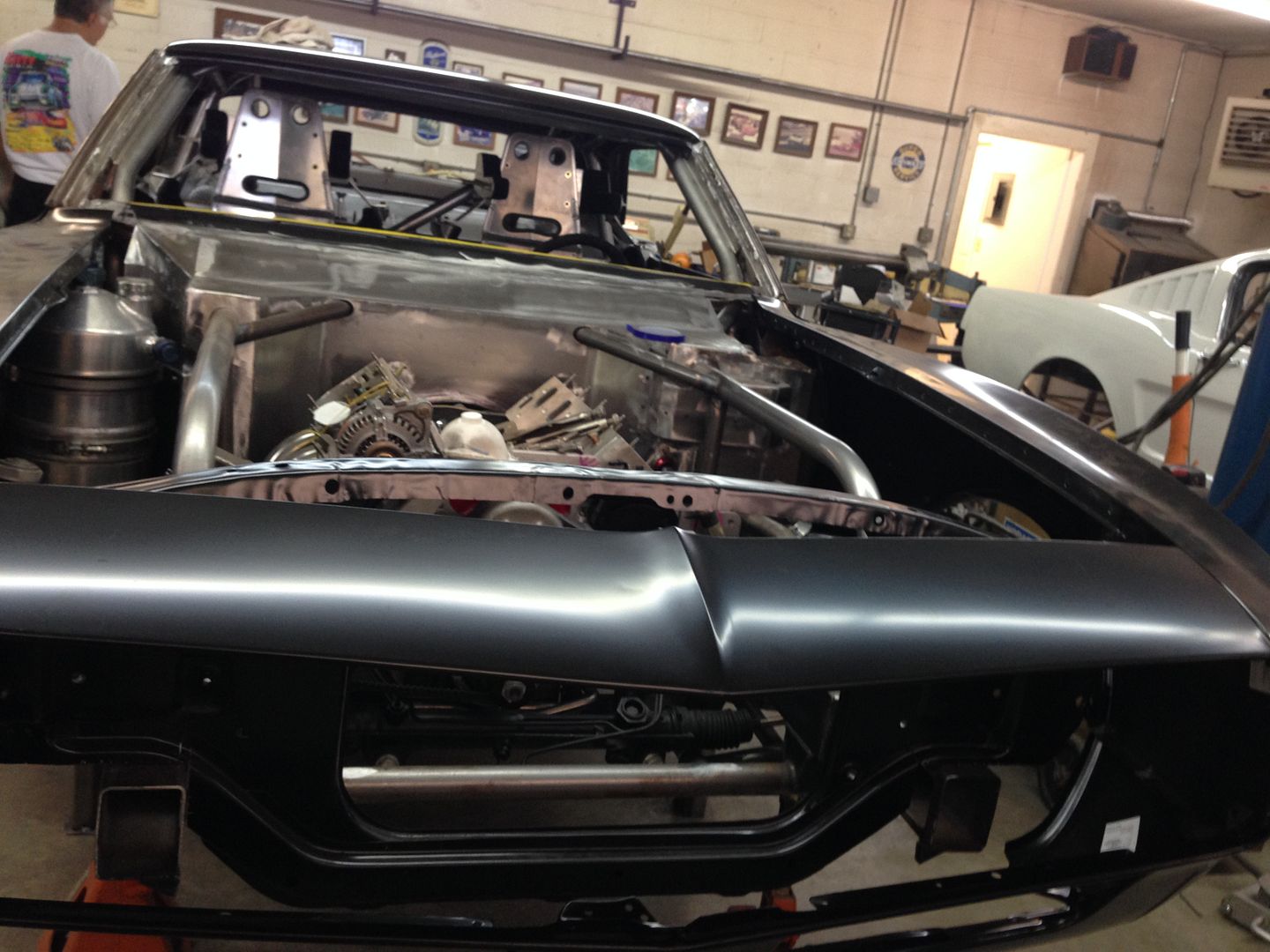

So DG's car arrived at Pettigrew's and i decided I had to see it with sheet metal on it before we stopped for a while.
http://i1138.photobucket.com/albums/...psziisdms4.jpg
http://i1138.photobucket.com/albums/...pswxn8tuqb.jpg
http://i1138.photobucket.com/albums/...psyojvc1do.jpg
http://i1138.photobucket.com/albums/...psefd7djku.jpg
Payton King 01-24-2016 10:31 AM

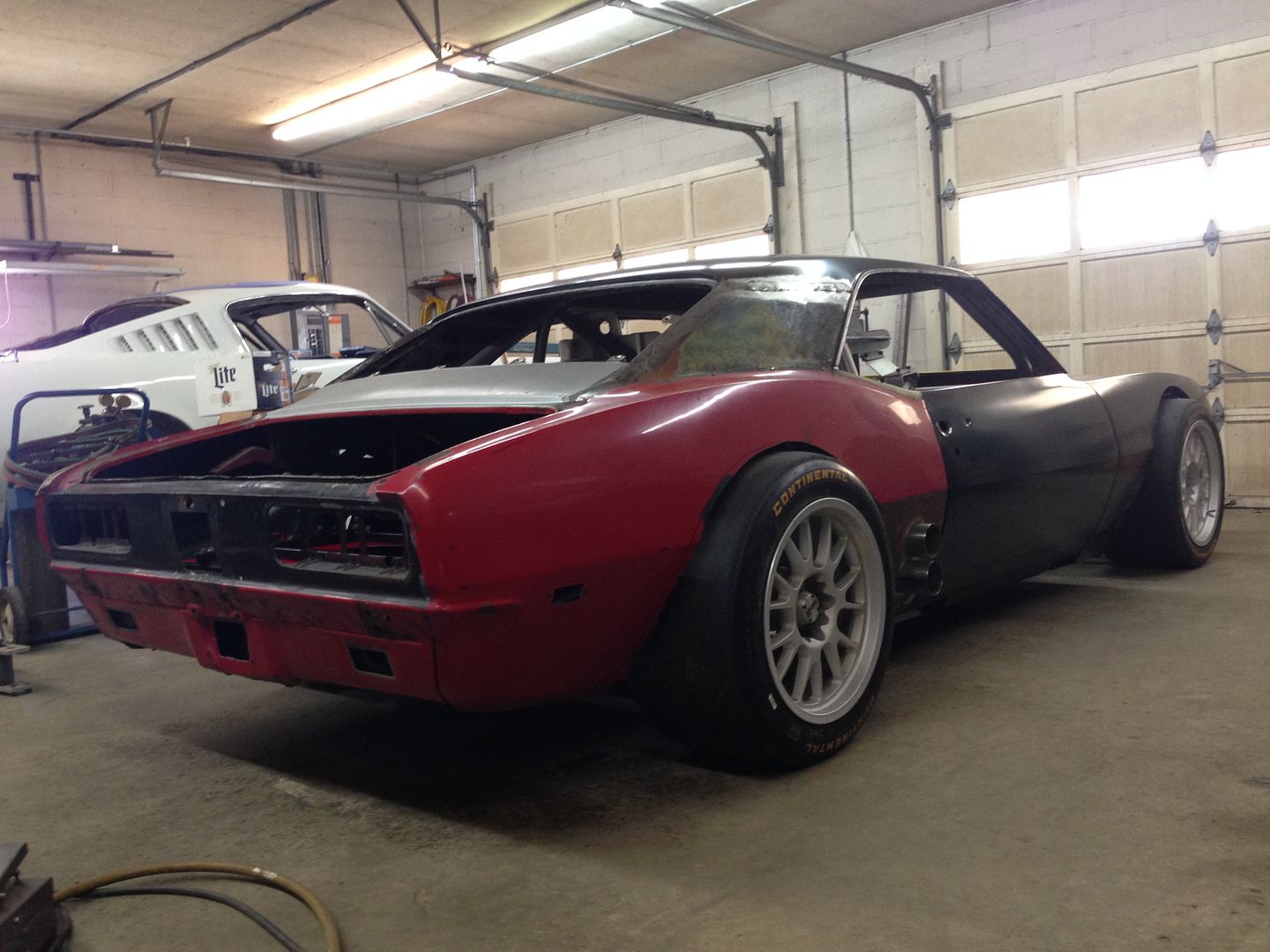

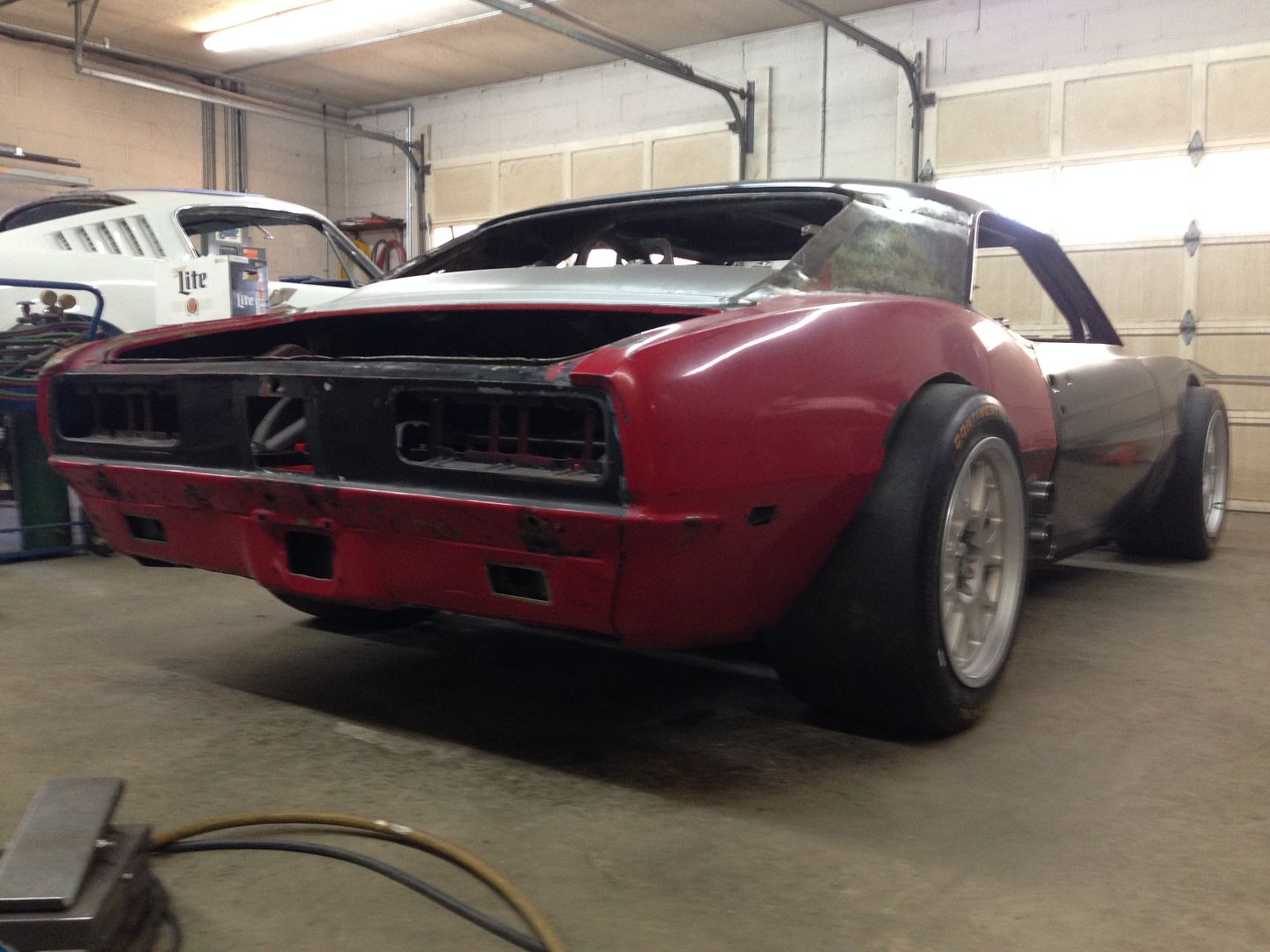

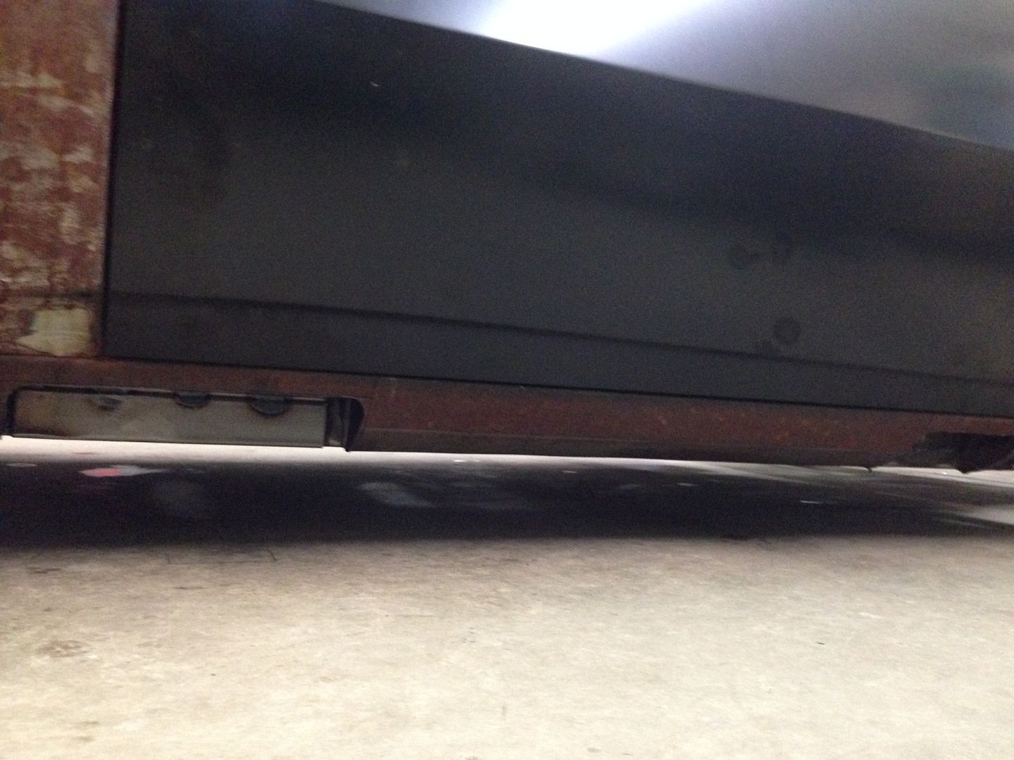

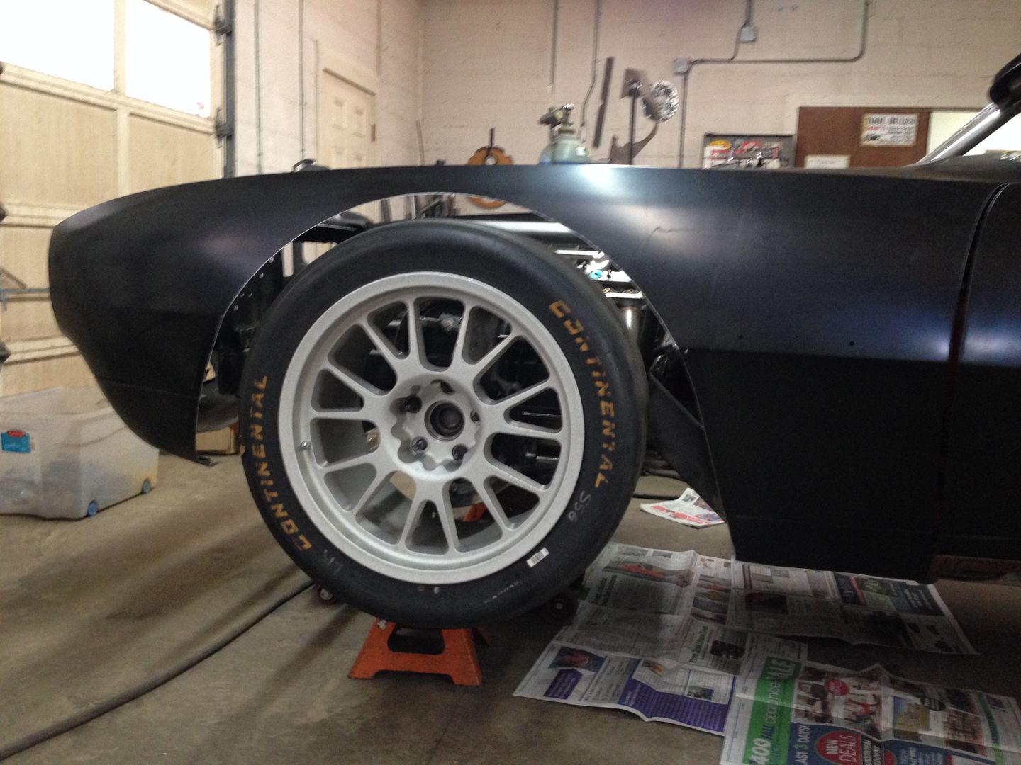

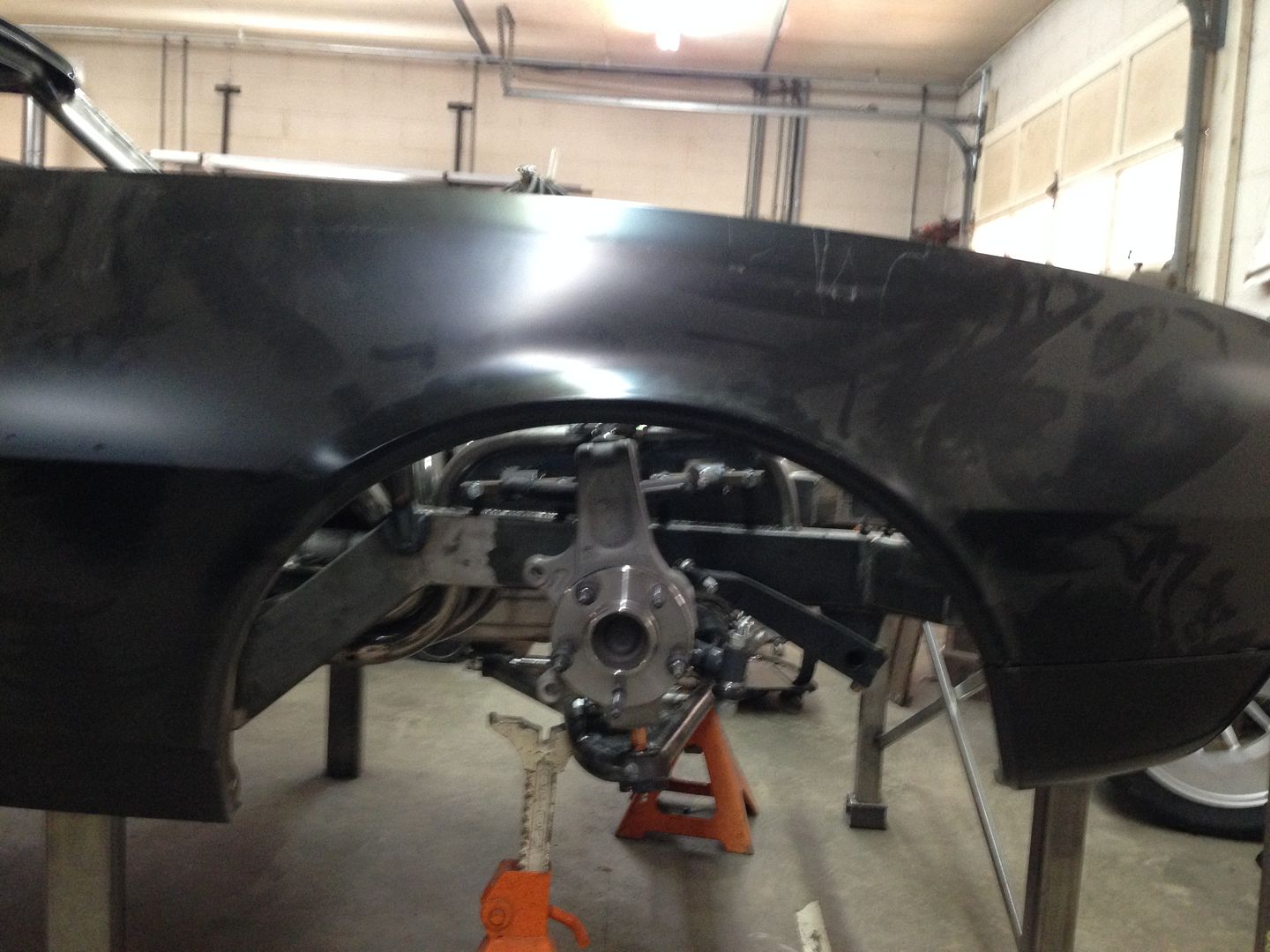

As low as this car sits, 4 inches at the frame at the firewall and 4.5 inches at frame in front of rear wheels, we were going to need to cut the front fenders. This is the first rough cut just so we can get the wheels on. I am going with Sutton's high travel low roll strategy and will be traveling the front wheel 3.75 inches.
http://i1138.photobucket.com/albums/...pszisj44yx.jpg
http://i1138.photobucket.com/albums/...pspwajvd5e.jpg
http://i1138.photobucket.com/albums/...psudtxnyd5.jpg
http://i1138.photobucket.com/albums/...psggokqojk.jpg

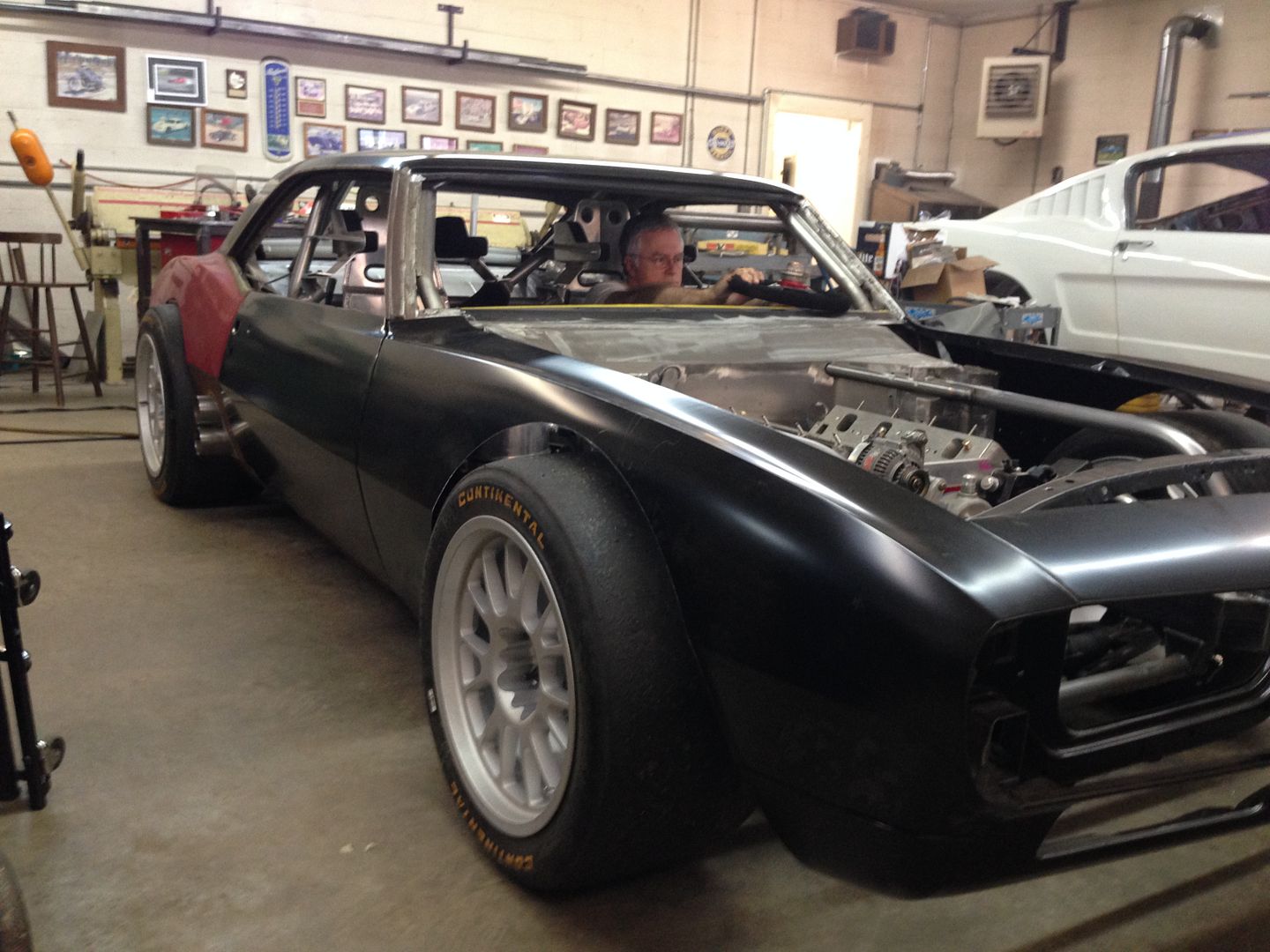

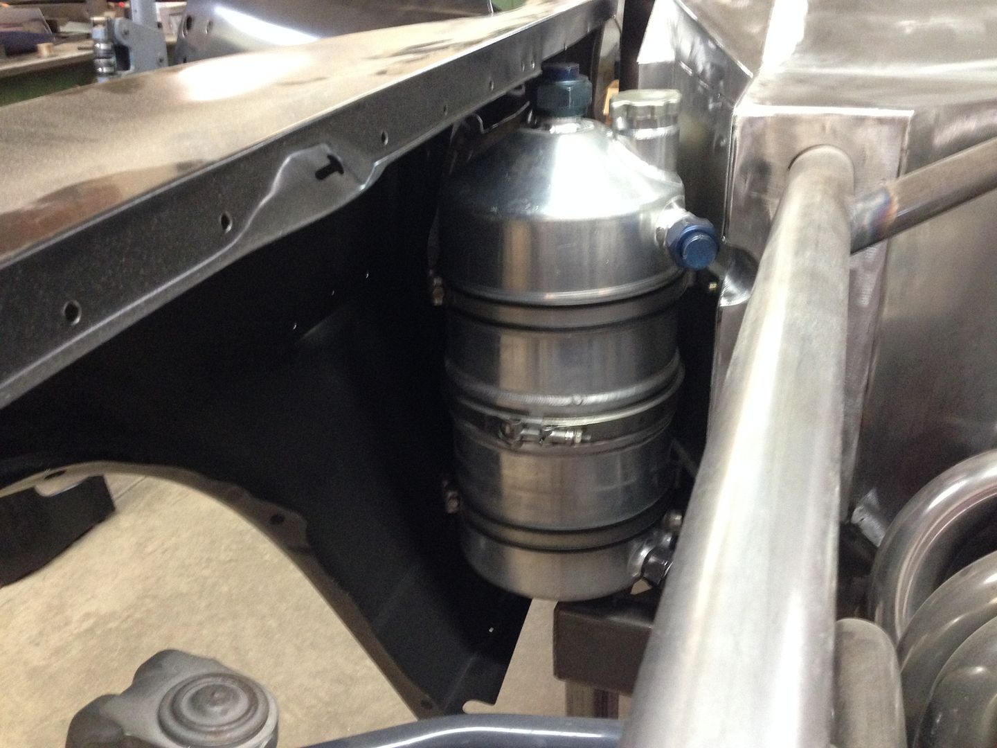

Payton King 01-24-2016 10:37 AM
http://i1138.photobucket.com/albums/...ps738wfafq.jpg
http://i1138.photobucket.com/albums/...psu3vffk7g.jpg
http://i1138.photobucket.com/albums/...psr3xwiqpz.jpg
http://i1138.photobucket.com/albums/...psmxi0a9tk.jpg

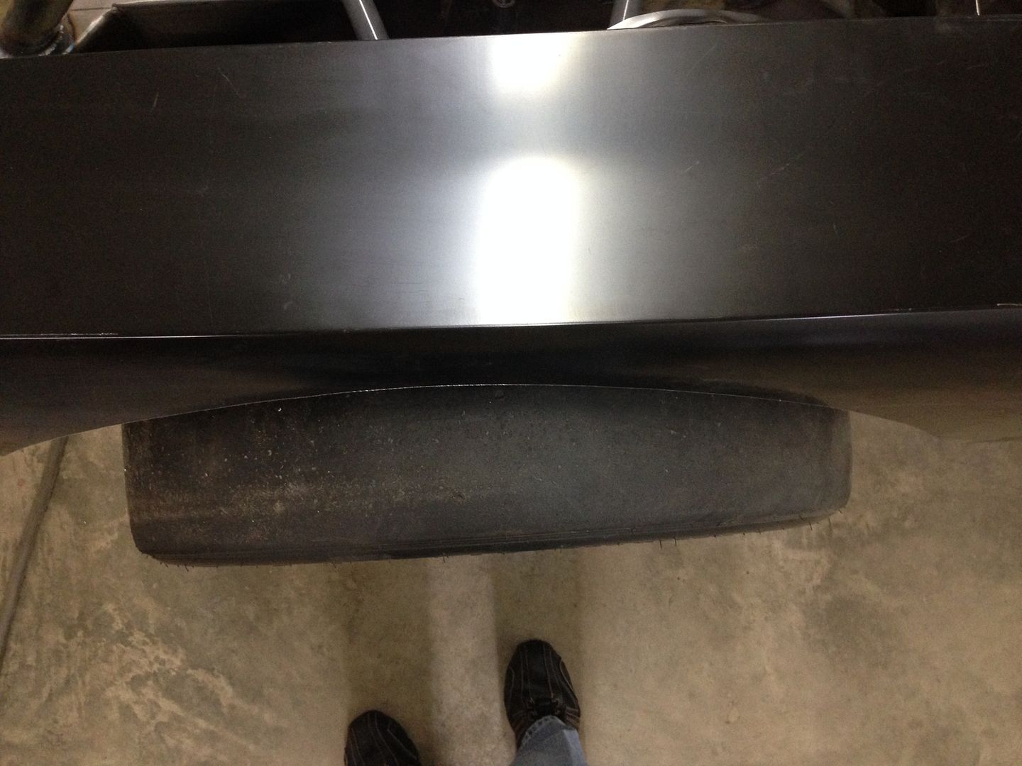

Payton King 01-24-2016 10:44 AM
http://i1138.photobucket.com/albums/...psk0c2uh9z.jpg
http://i1138.photobucket.com/albums/...ps9zbq1ytn.jpg
http://i1138.photobucket.com/albums/...ps8hxihwab.jpg
