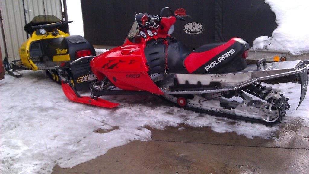

Uhh...Eric, you still didn't tell us what the shocks came from mister! :headscratch:
ok this picture should give ya a hint or give it away.
Originally Posted by Che70velle (Post 472393)
Yup. Fess up. Year, make, and model, please.:hello:
this pict. should give it away
Originally Posted by HEEP (Post 472423)
E-Rod
I'm liking what you are doing on the suspension. Totally different than anything else. Keep up the updates.
As for the shocks, they kind of look like something off a Jeep. Aftermarket of course.
HEEP
not aftermarket well they could be but they came factory on this.
http://i643.photobucket.com/albums/u...psa3da0402.jpg
Bet you did not see this coming they are off my snowmobile.lol. not kidding just had them revalved we will see how this works
Che70velle 03-27-2013 07:54 PM
Eric my man, I definitely did not see that one coming. You know, it's not cool to steal from one toy, for the benefit of another. That's wrong, just wrong! :poke:

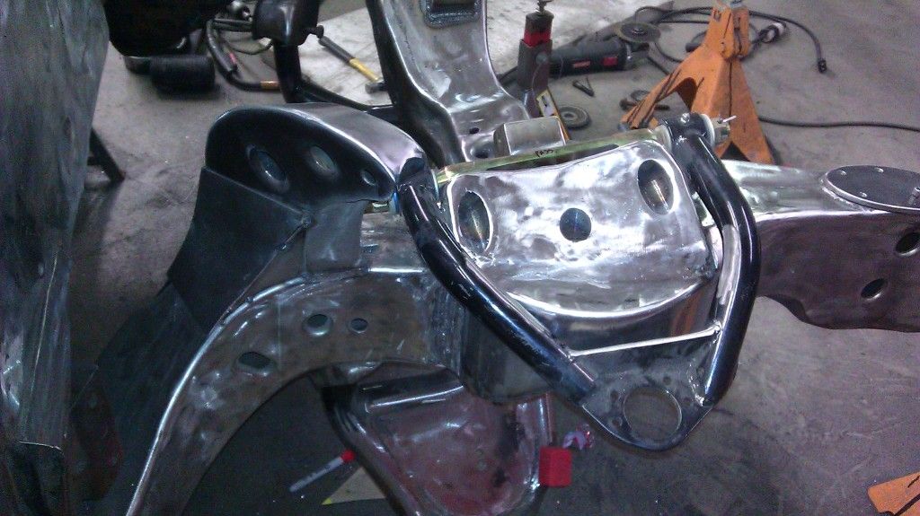

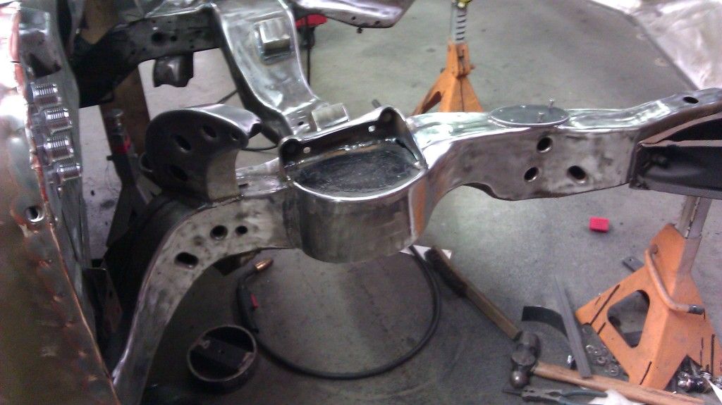

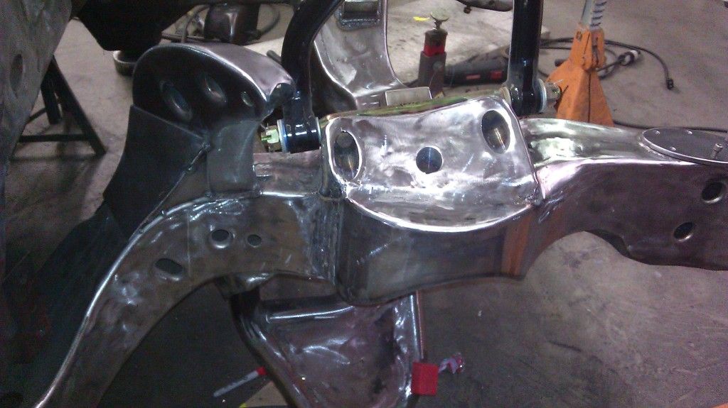

still chipping away a little at a time. Life has really sucked latley have not really had much free time the body is coming off this week and the rear suspension is next.
http://i643.photobucket.com/albums/u...psf80cb895.jpg
http://i643.photobucket.com/albums/u...psa49b12ef.jpg
http://i643.photobucket.com/albums/u...psf2e20dfc.jpg

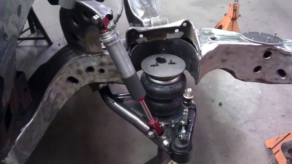

Are you sure these shocks are going to work for this application ?
daemon2 04-02-2013 02:00 PM
An average snow machine weighs about 500 lbs total - wet.
I agree there may be some issues with putting these on a car, this car probably has move than 500lbs per corner without the sheet metal :)
the car is what 3600lbs without bodies in it? I see that the air bag bares the weight but the ability of a shock absorber to do its job depends on the effective area of the working piston. It will be interesting to hear if these can keep up in discharging all that thermal energy.
Are those Walker Evans RMK Dragon air filled?
E.rodz 04-02-2013 06:07 PM
Marty I did do some research on this before and really thought about it and the valving in the shocks is completly tunable for the difference in weight. this makes such a huge difference on my sled getting the dampening dialed in it is just incredible how big of a difference a couple of clicks makes so after talking to my shock guy for building snowmobile shocks he custom makes all kinds of shocks and assured me I was not crazy he revalved them to care of my concerns I am confident they will work but I am not afraid to fail if they don't I am going to run the same in the rear.
these are off a 2002 pro x no air in these.
Marty I did do some research on this before and really thought about it and the valving in the shocks is completly tunable for the difference in weight. this makes such a huge difference on my sled getting the dampening dialed in it is just incredible how big of a difference a couple of clicks makes so after talking to my shock guy for building snowmobile shocks he custom makes all kinds of shocks and assured me I was not crazy he revalved them to care of my concerns I am confident they will work but I am not afraid to fail if they don't. I am going to run the same in the rear. glad to see your still making progress on your car

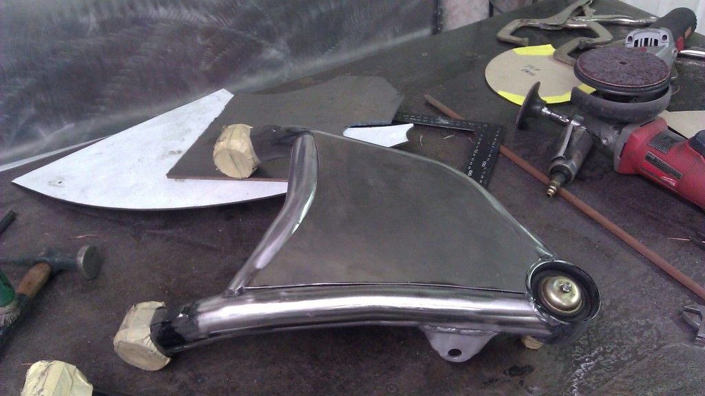

man there is so many little pieces to this getting it to look molded is taking forever I hope this turns out to be worth the extra effort.
http://i643.photobucket.com/albums/u...psd3db3b92.jpg
http://i643.photobucket.com/albums/u...psb6cb8442.jpg
http://i643.photobucket.com/albums/u...ps28e9a667.jpg
