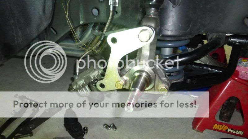

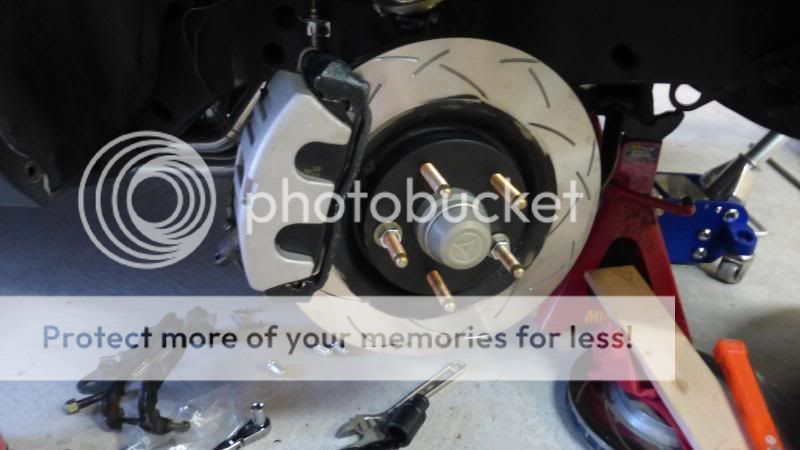

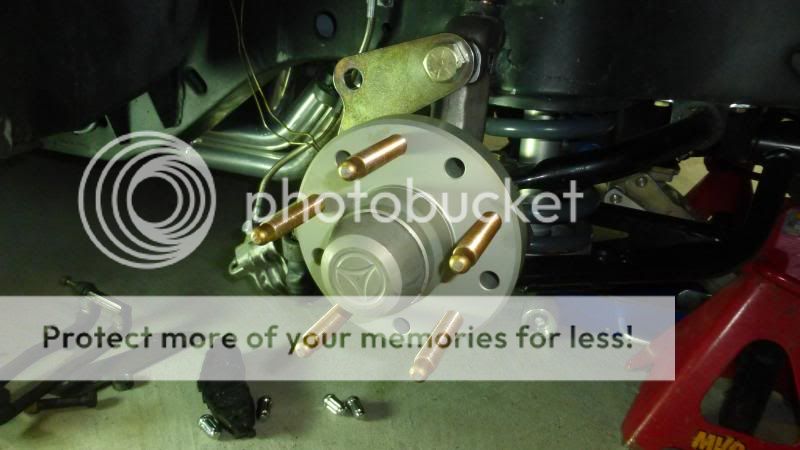

Quick update-installed the Kore3 brakes. Everything went perfectly, although I had to shim the brackets as the rotor was not parallel to the caliper bracket on the pass side, and was not centered on the driver side.

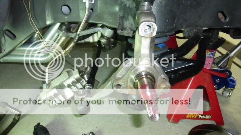

Pulled the old brake off, cleaned up the spindle and installed Kore3's bracket/hub.
http://i616.photobucket.com/albums/t...ps00c14565.jpg
http://i616.photobucket.com/albums/t...psf27b56ca.jpg
http://i616.photobucket.com/albums/t...ps70b73377.jpg

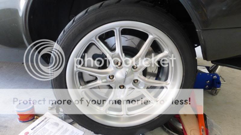

Put the wheel back on to check for clearances. The rotor fills up the wheel nicely.
http://i616.photobucket.com/albums/t...psc92b035c.jpg
Repeat for the DS. Now I just need to bleed the brakes, bed in the rotors and I should be good to go.

Thanks guys. Took her out for a test run and bed in the pads. Took her up to 60 mph, and slowed down to 20 mph. Did that a few times, with some cool down periods in between. The new brakes work much very well, with much better feel.:thumbsup:
