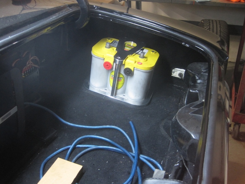

Battery re-located and mounted in the trunk. Will still be able to use my trunk close out panels with no modification.
Attachment 45412

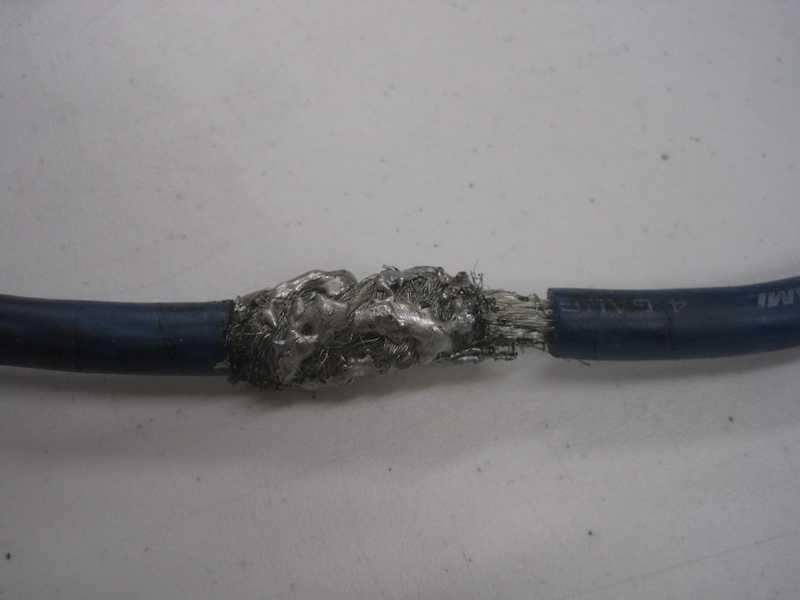

This was a good find. Look at the picture of the main power wire for the stereo. Needless to say this was fixed.
Attachment 45414

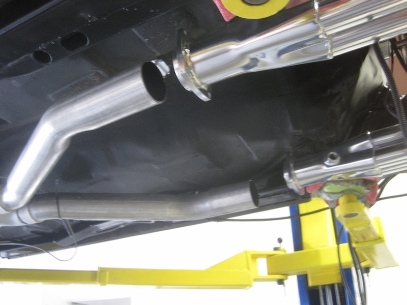

The headers were installed and the exhaust was trimmed and being measured for fittment of new collectors.

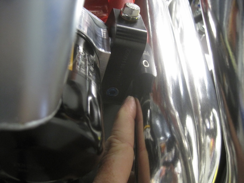

The oil cooler adapter was machined for clearance to fix this.
Attachment 45418

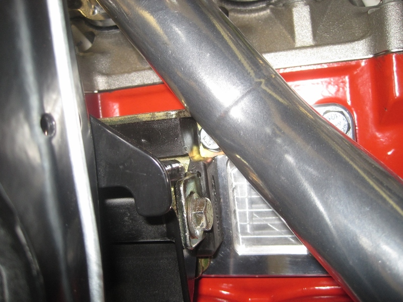

The motor mount has been notched to fix this.
Attachment 45417

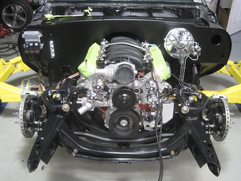

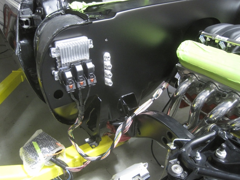

The ECM is installed and wiring is underway.
Attachment 45416

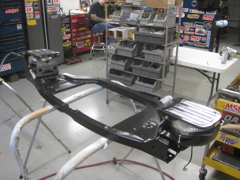

Re-assembled the headlights on the new core support. Hope to get the front
clip back on next week.
Attachment 45419

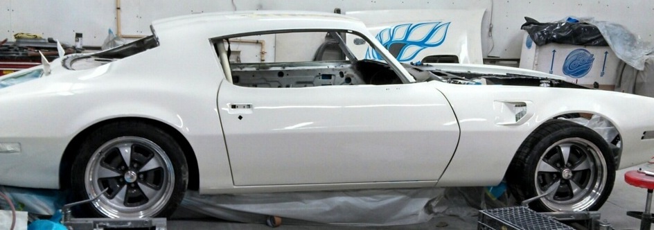

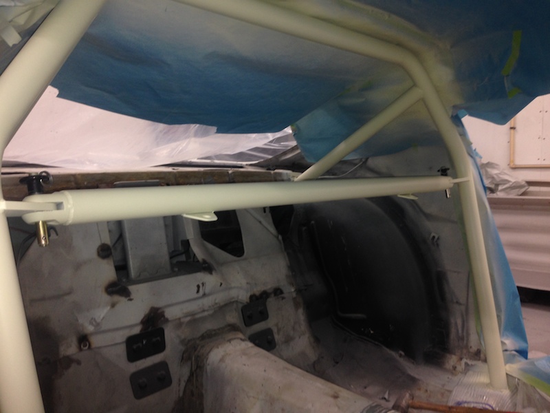

Nothing too exciting but the interior paint is underway. The door panels, rear sails, seats, dash, rear quarters, trim and headliner are being re-done as well. Hope to get some pics posted of that work soon.
The roll bar is being color matched to the interior surfaces. Pretty close to Pontiac factory deluxe white. The car is an original white on white car so trying to maintain some originality.
Attachment 45427

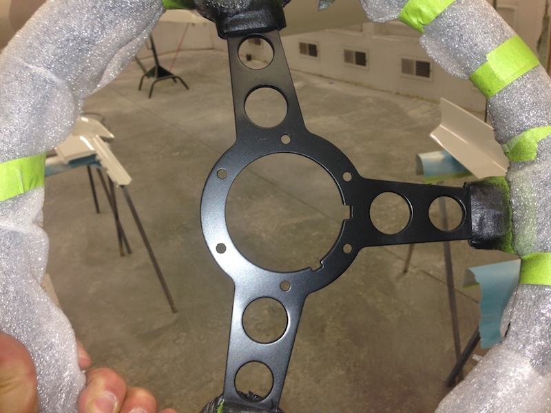

The steering wheel was sanded down and painted black for a factory fresh look.
Attachment 45428

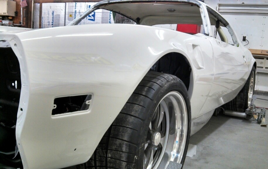

The TA is getting closer!!
1 Attachment(s)
The TA is getting closer. :tv_happy:
Attachment 45500
