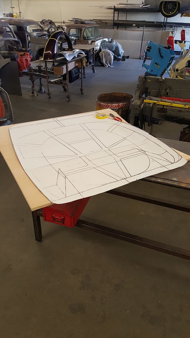

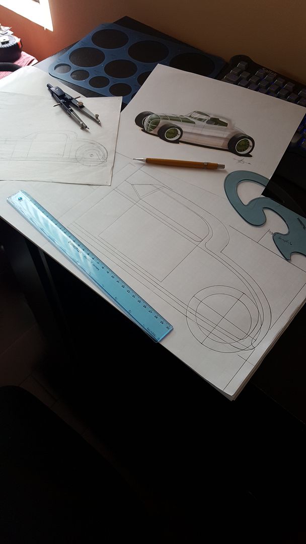

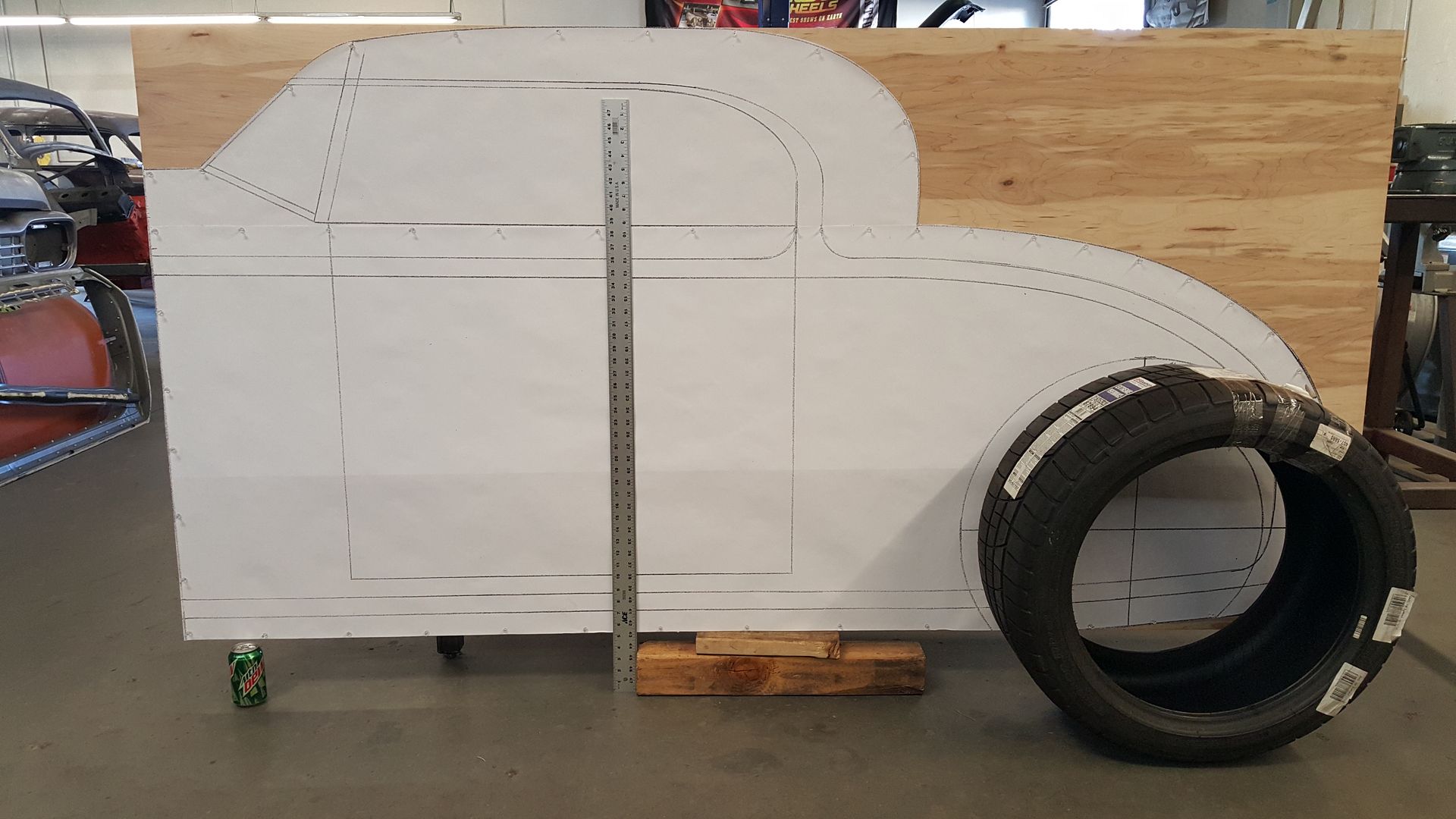

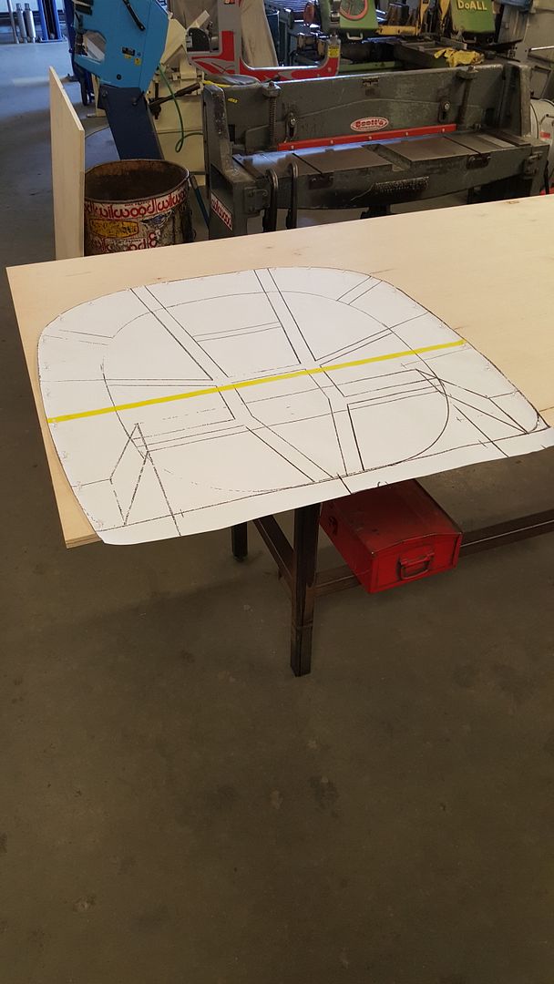

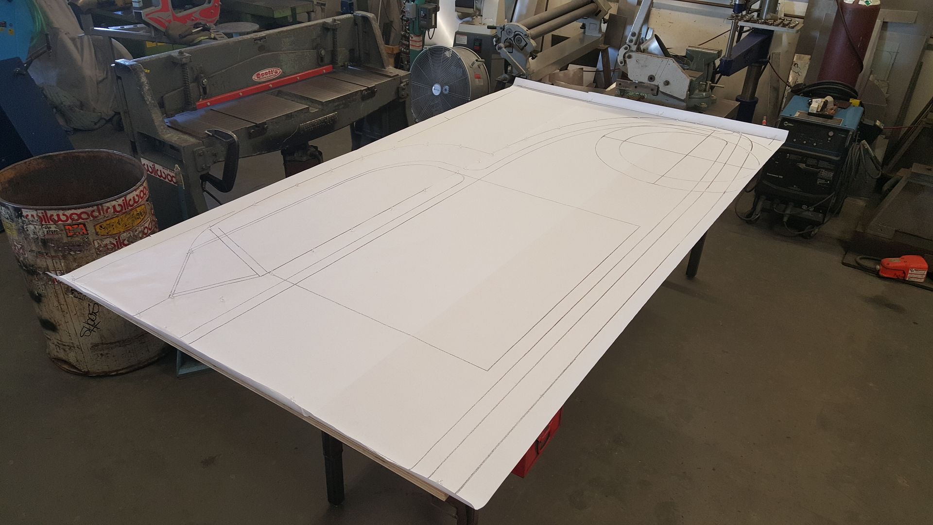

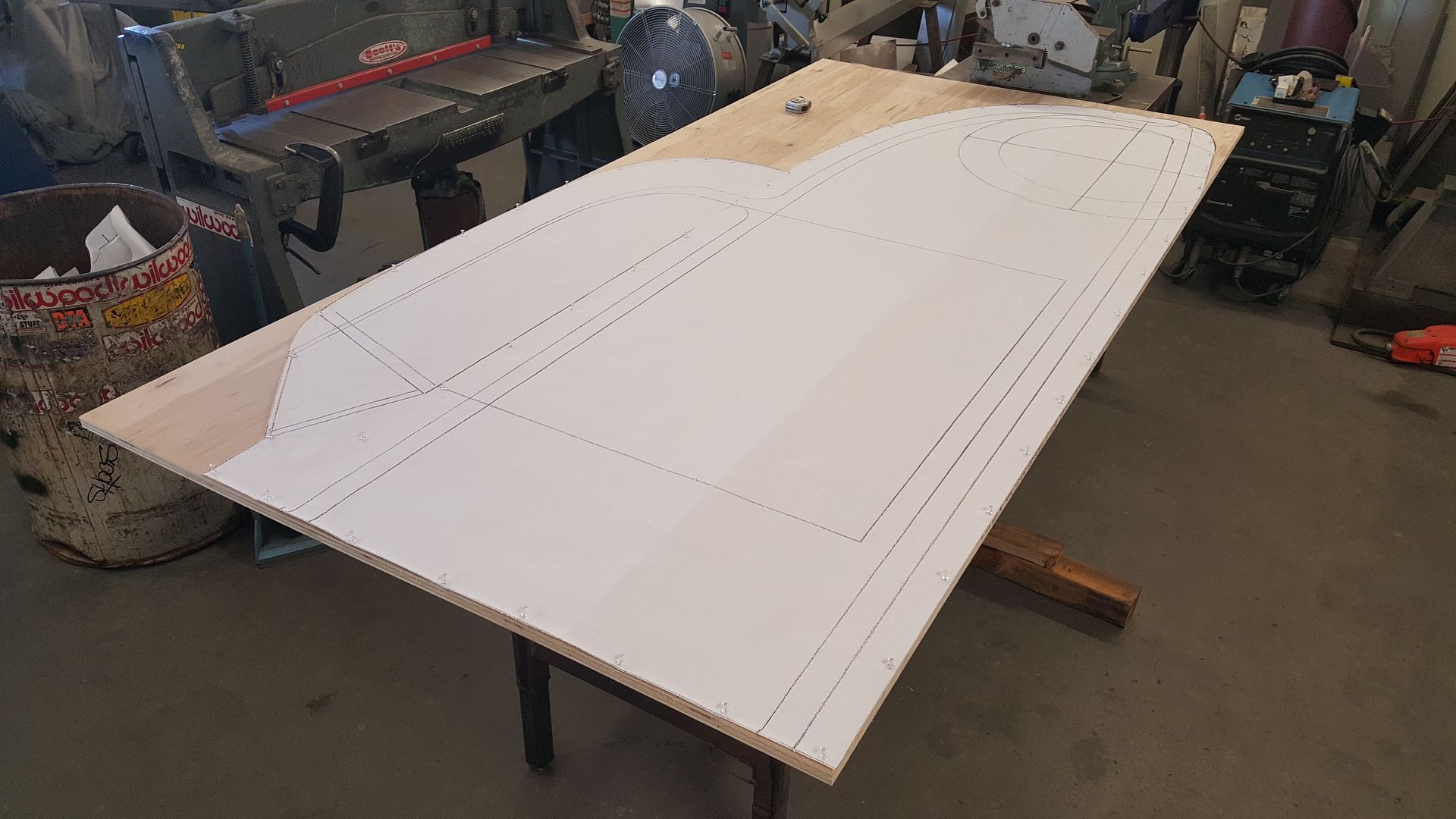

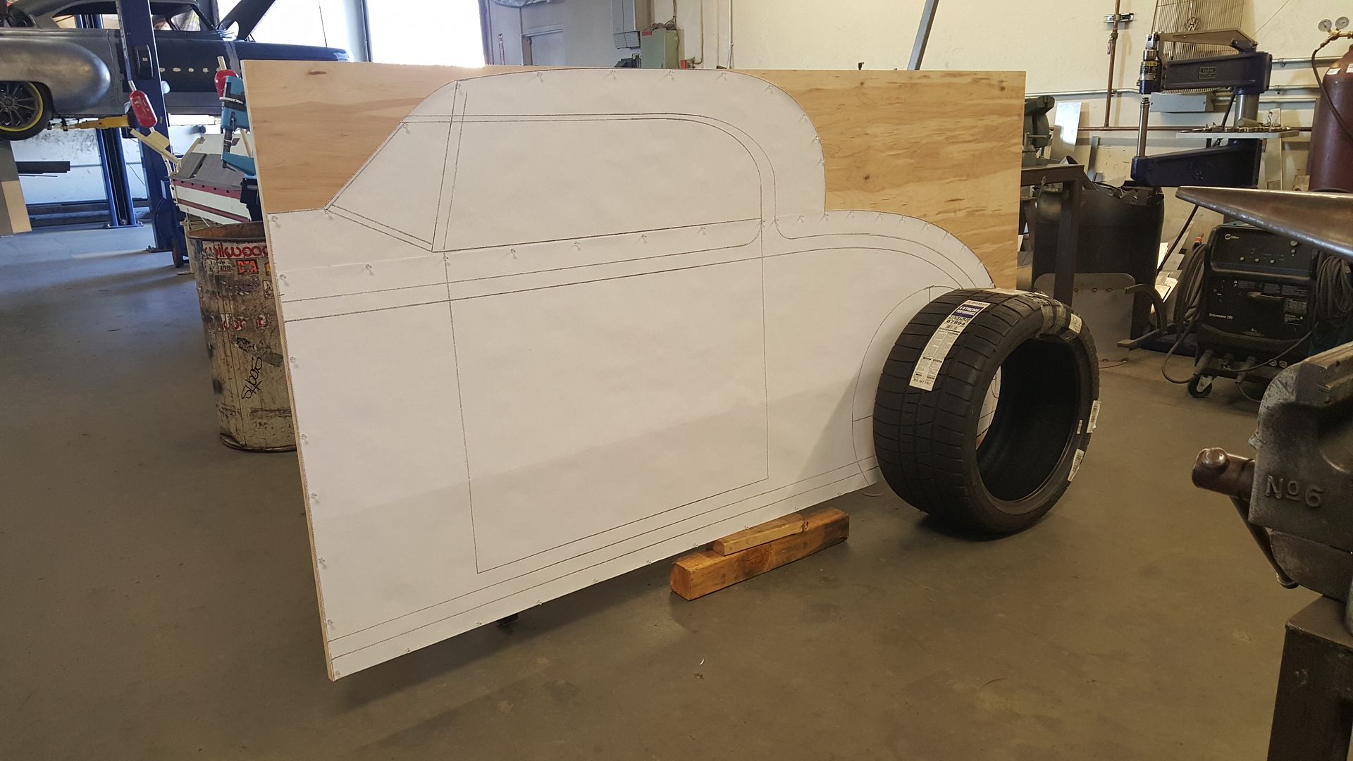

well its been a while since I gave an update on the duck. so here you go.

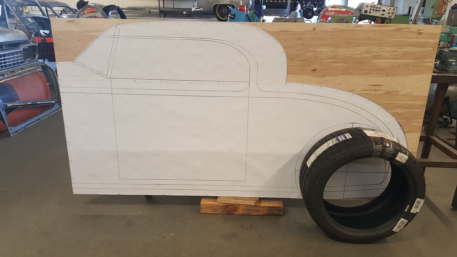

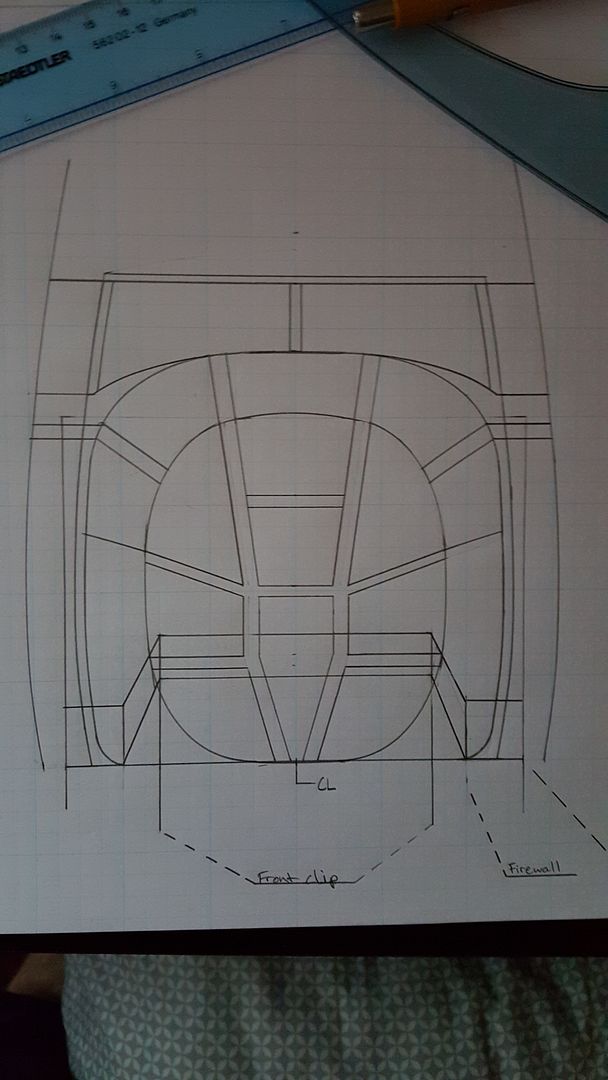

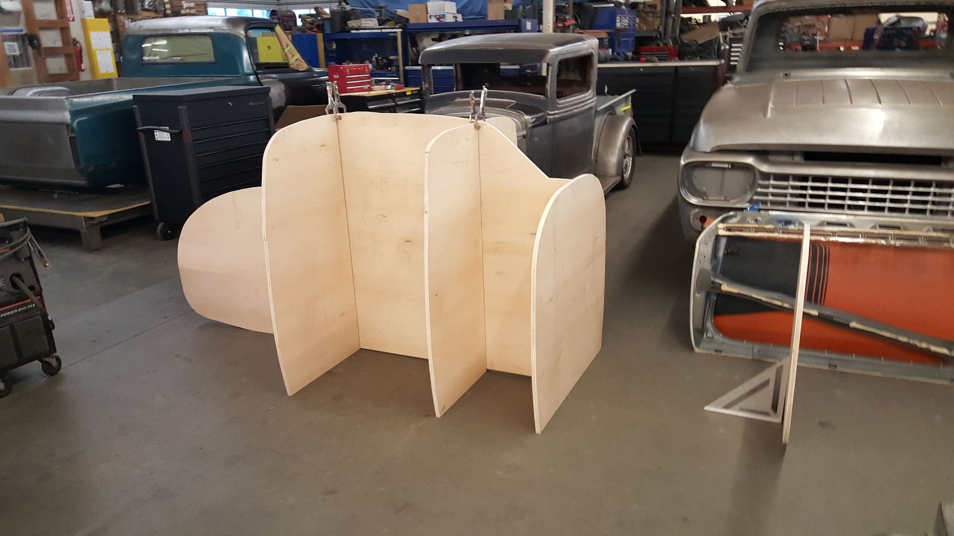

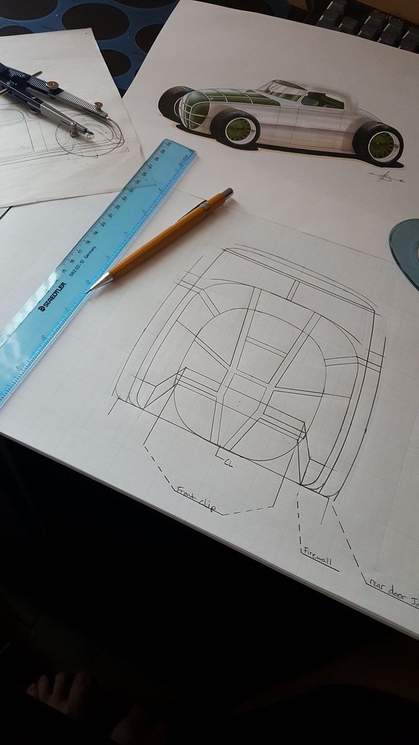

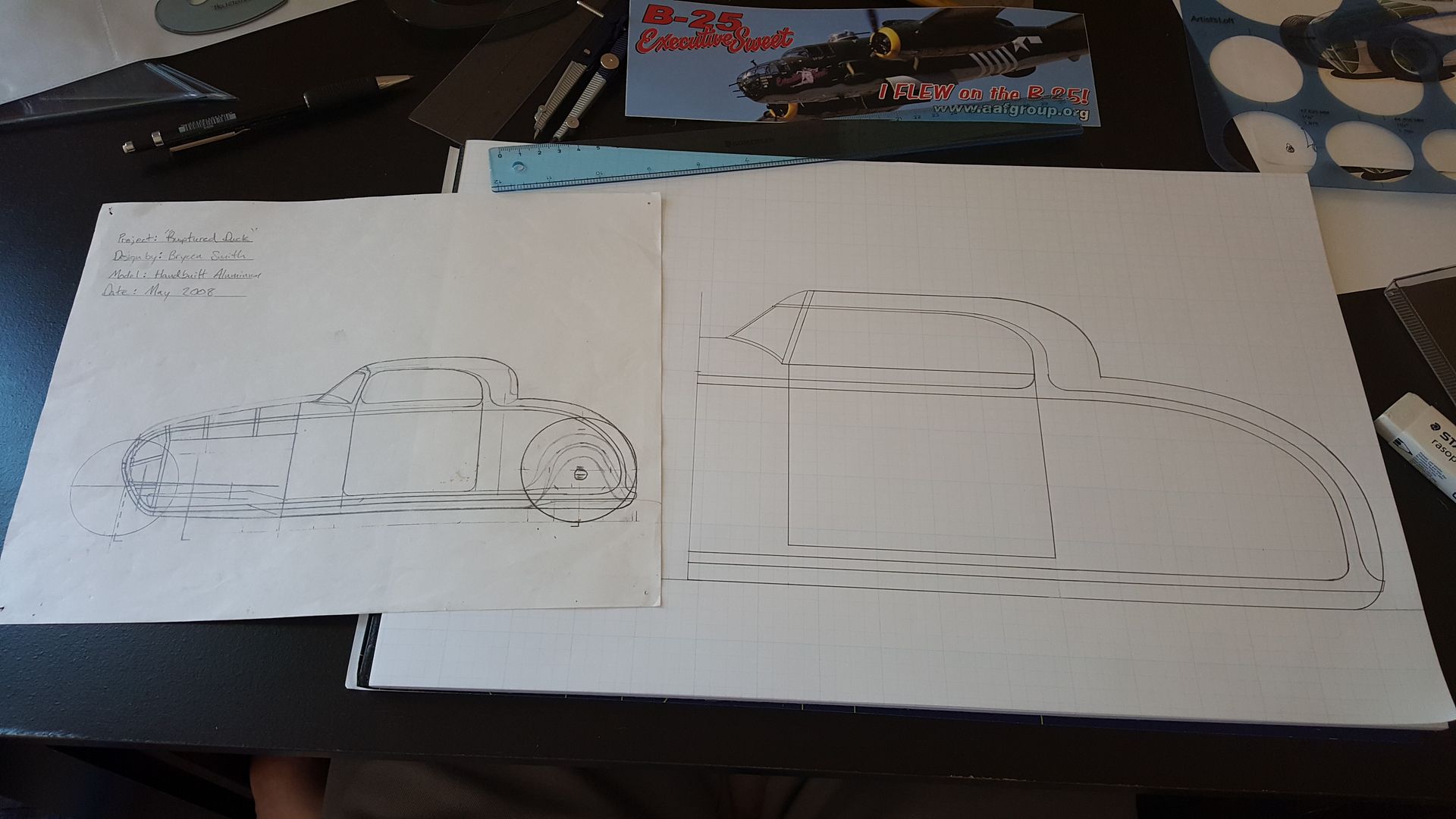

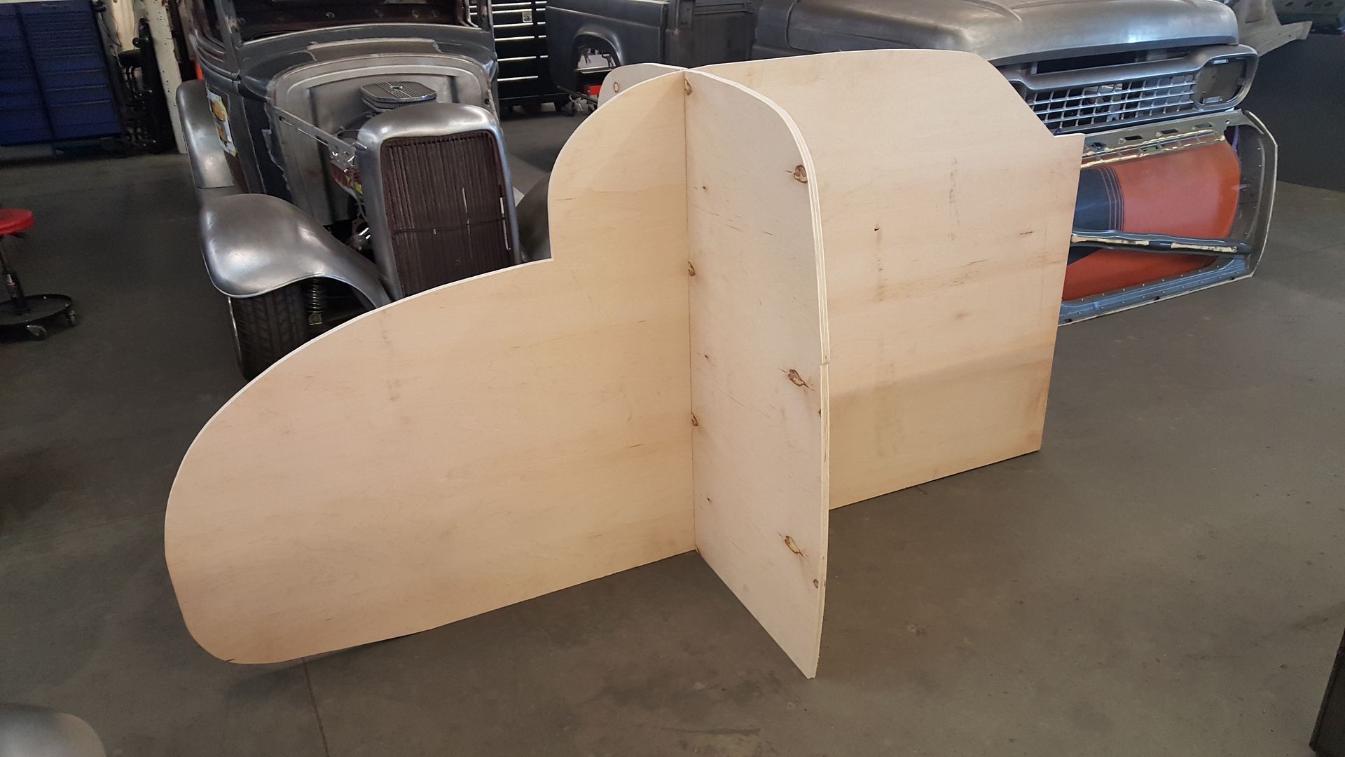

I have been locking down the final body shapes and lines and because of that I spent quite a while laying things out on paper in the form of scale drawings. Once I locked in the side profile I wanted, I then moved onto a direct front view. Once this was finished I had both views printed out in full scale and from there used them to cut out the start of the wooden buck.
Here are the pictures. enjoy.

This is honestly one of the coolest things I have seen, and it's just plywood!

Thanks guys, im stoked to be getting to this point of the build. And to be able to share it with others

Full scale print outs, that makes sense. I wondered how they set up the profiles for a buck.
