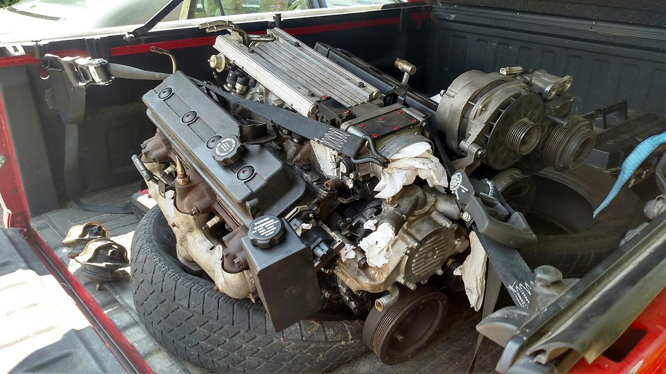

Well completion has to wait as my cheap clutch purchase bit me and now I'm going to fix it with more power. I picked up a 93 Corvette LT1 for $500 with nearly everything on it including the OBD1 ECM and harness and motor mounts.
Attachment 63040
The is a plan is cam it, 500hp clutch kit (don't know what company yet), bigger valves and gasket matching, 52mm TB, and the other bolt ons that I already have.

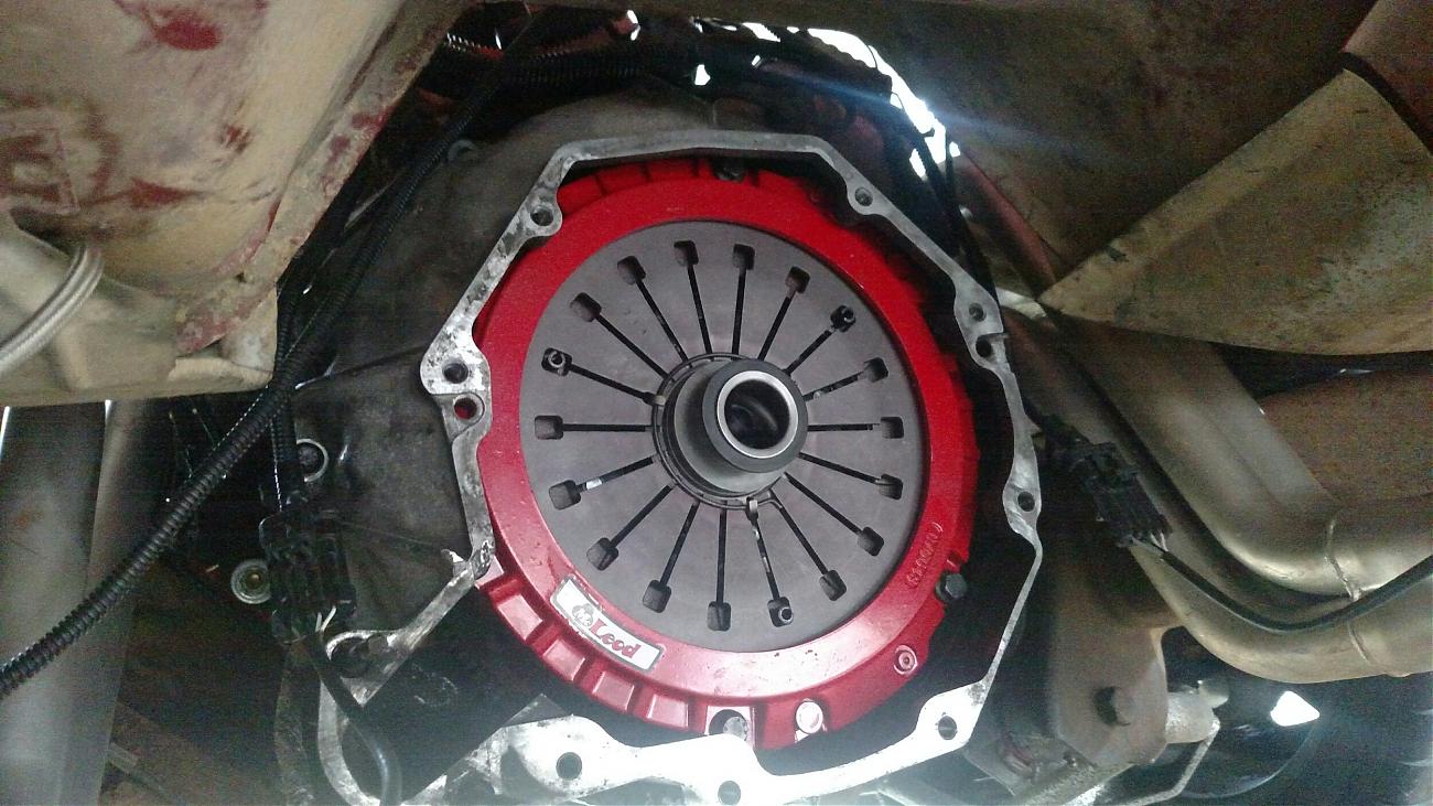

Attachment 64581
The clutch got done a while ago, bought a McLeod Street Pro clutch and after a couple of thousand miles and runs like a dream.

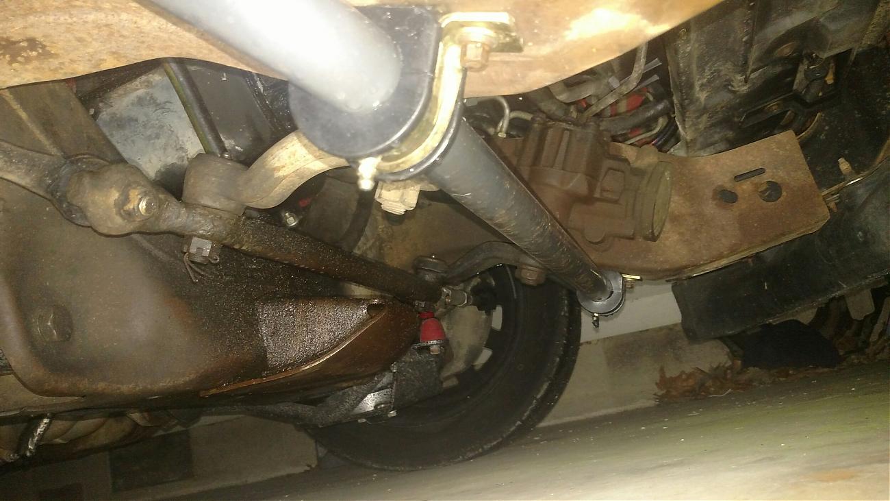

Attachment 64580
Installed a Belltech 1⅜in front sway bar.Attachment 64582

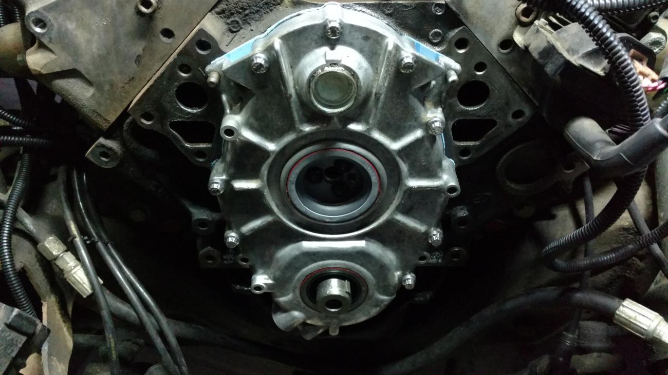

Attachment 65862
Pulled the cam for a Lunati Voodoo 219/227 cam. Also swapping out any visible bolt with ARP stainless steel 12 point bolts.

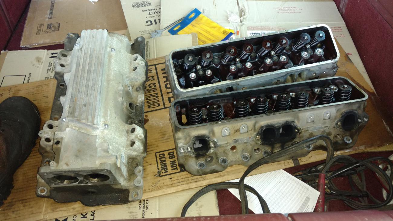

Attachment 65863
Then got the heads and intake off and sent to Texas for porting. Looking to max out the stock bottom end before going to a 377ci short block.
