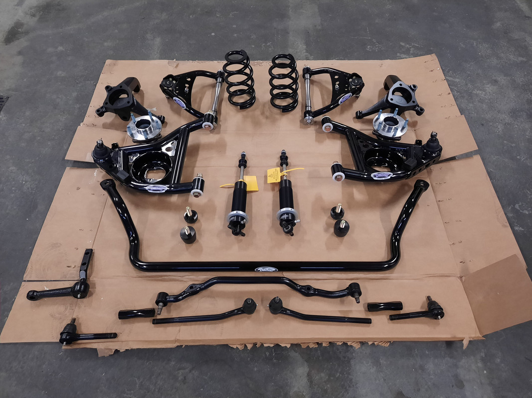

streetbird 09-09-2020 02:11 PM
subframe installed, painted and now roller for the first time

Tell me about the 9/16 drill bit.
streetbird 09-22-2020 06:00 AM
Originally Posted by syborg tt (Post 706739)
Looks fantastic.
Dse lower control arms need 9/16 bolt.
Instruction tell to use a unibit but I wasnt able to drill the hole on the rear mount.
I use a 9/16 drill bit. Shank side was 1/2. I welded it on a 1/2 rod and it worked real good.

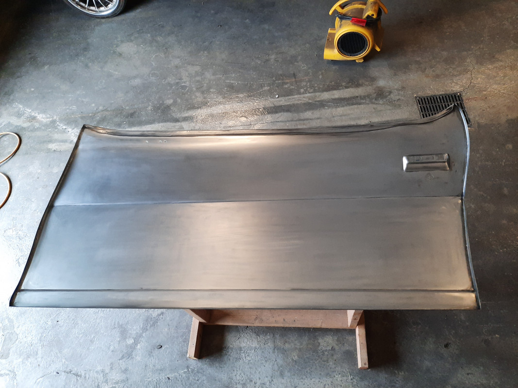

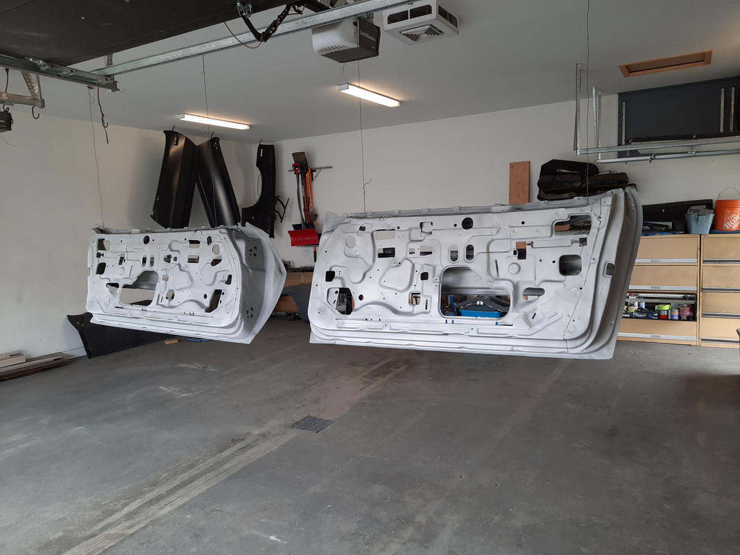

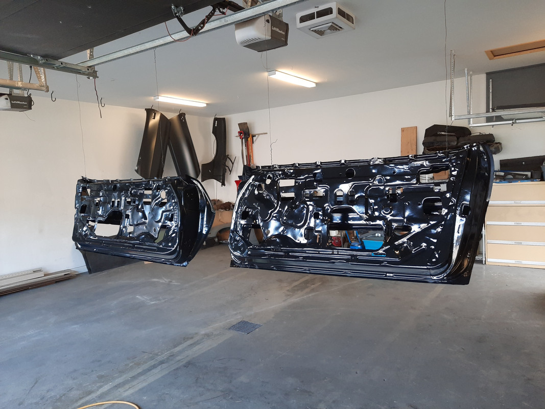

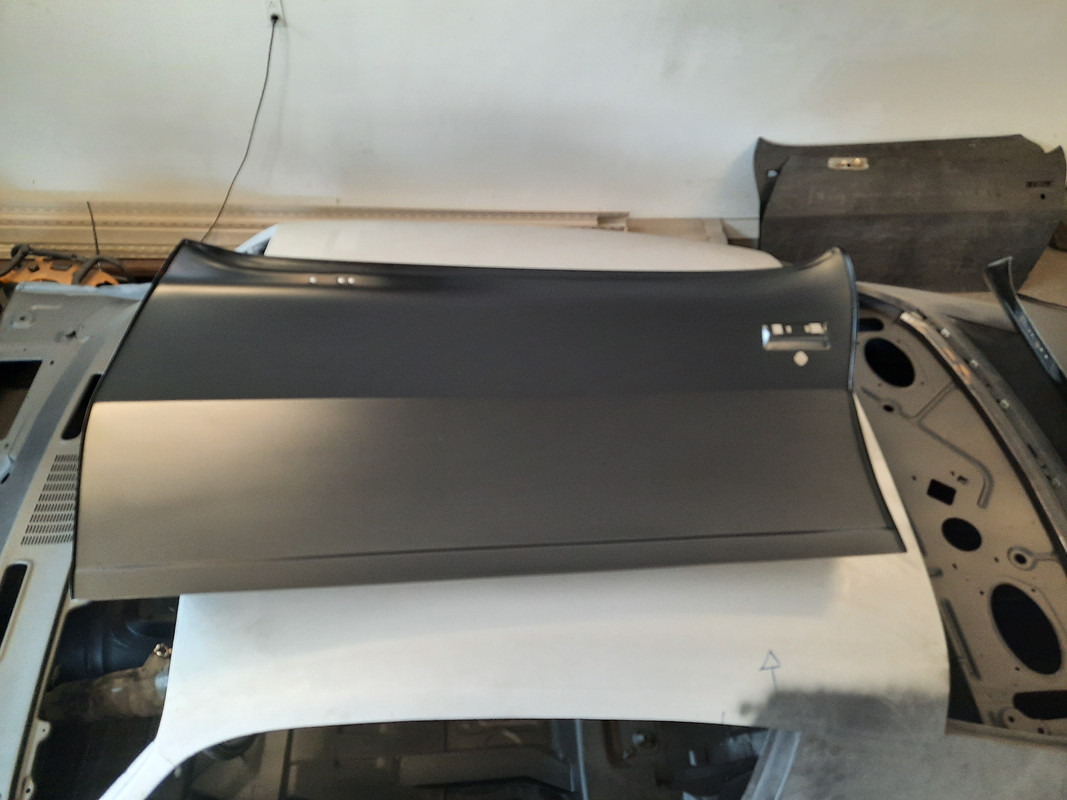

streetbird 11-05-2020 11:41 AM
Just finished to repair lower doors frames and reskin them
https://i.postimg.cc/tRSWFF9N/20200922_134312.jpg
https://i.postimg.cc/dthd6D1P/20201015_123854.jpg
https://i.postimg.cc/vHCnNMg1/20201015_143802.jpg
https://i.postimg.cc/DwsGVDLx/20201022_102643.jpg
https://i.postimg.cc/Lsp1mTV2/20201023_121310.jpg
https://i.postimg.cc/tgNVJxrP/20201105_114734.jpg

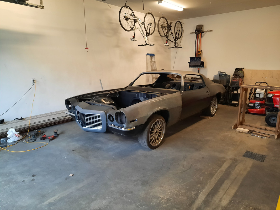

streetbird 11-07-2020 07:28 AM
I just started to fit the front end but all panel was off.
1'' gap on the nose in the beginning but it turned ok.
Still some work to do on the fenders.
So close to look like a car for the first time
