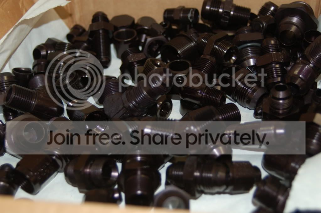

I got my fitting back from anodizing----
Jody gave me a ton crap about my red - blue fittings so I stripped the colors and re-anodized black
http://i439.photobucket.com/albums/q...5/DSC_3069.jpg
Mark.. Who did the anodizing for you ?
Stielow 03-04-2010 06:41 AM
McNichols Anodizing did it http://mcnicholsanodizing.com/
It is call bright black. Not as durable as hard coat anodizing but if you want it to have a sheen the bright black is what you want.
It is about a 1 week turn around and the minimum charge it $100.
Nice guys good service.
Mark

DOOM 03-04-2010 06:49 AM
Mark what did you use to strip the fittings? I hope its not that hard I'll be doing it for days , with all the fittings you sent me..:lol:

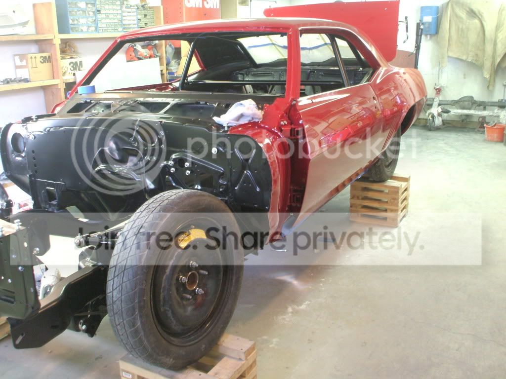

Originally Posted by chevy2boy333 (Post 272843)
getting close! got the doors on today and going hang the front sheetmetal tonight. then she goes back to Marks house this weekend!
http://i784.photobucket.com/albums/y...s/DSCF2584.jpg
Paul
Can you tell me what spare tire this if from?
Thanks.
Stielow 03-04-2010 07:22 AM
They strip them for $50. For assembled hose ends it may cost more due to the stainless steel pin in the fitting that can't be anodized. You will need to call them to get the details on hose ends. I only did adaptor fittings, trim rings, battery holders and knobs.

Stielow 03-04-2010 07:24 AM
Thanks.
Corvette C-4 spare wheel 17 inch. I got them off Ebay for about $20 each. The are aluminum and clear the DSE front spindles. But the are only rated for 50 MPH... :unibrow:
Mark

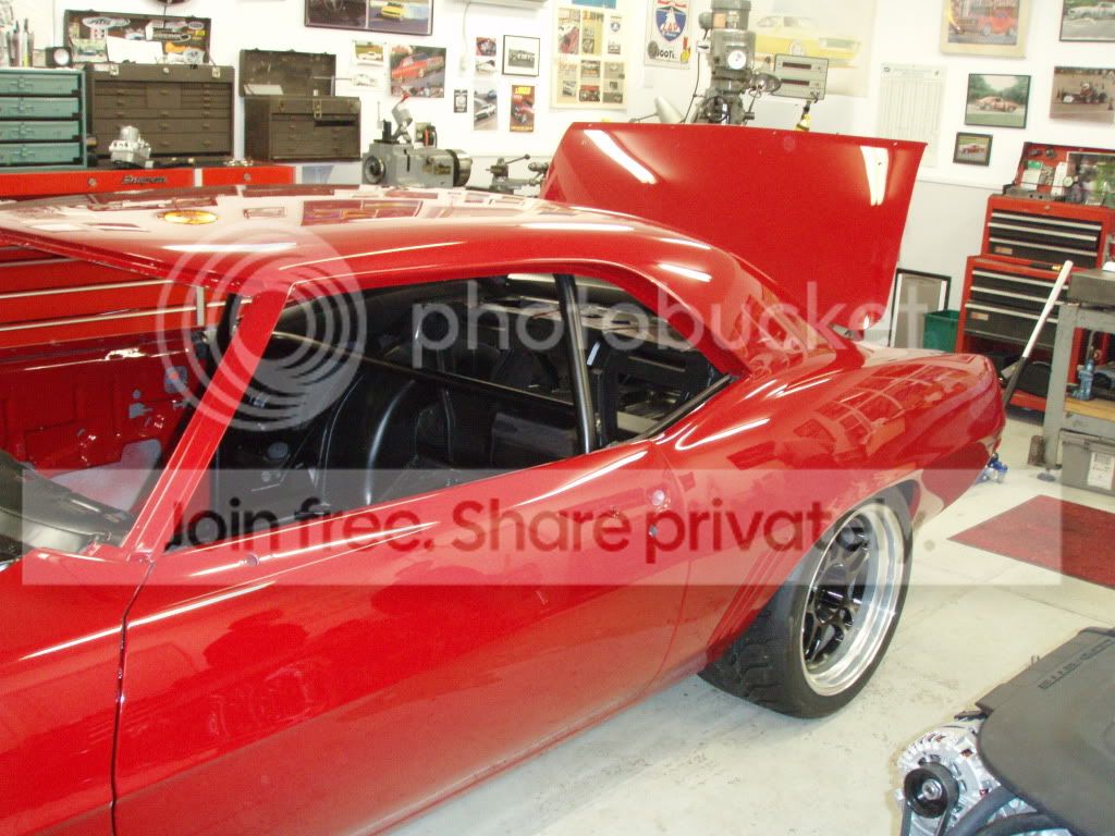

Stielow 03-07-2010 06:04 PM
Cars back
Paul and Joe just dropped the car off it looks great.. :thumbsup:
http://i439.photobucket.com/albums/q...5/P3070200.jpg
http://i439.photobucket.com/albums/q...5/P3070201.jpg
http://i439.photobucket.com/albums/q...5/P3070199.jpg
http://i439.photobucket.com/albums/q...5/P3070203.jpg
http://i439.photobucket.com/albums/q...5/P3070207.jpg
I'll get some pictures outside tomorrow.
Mark
Aschle 03-07-2010 06:06 PM
:thumbsup: :hail: I'm speechless....
customcam 03-07-2010 06:07 PM
Awesome...Awesome...
You know how to pick them Mark! :thumbsup:
camcojb 03-07-2010 06:38 PM
looks great Mark, congrats!!!!!
