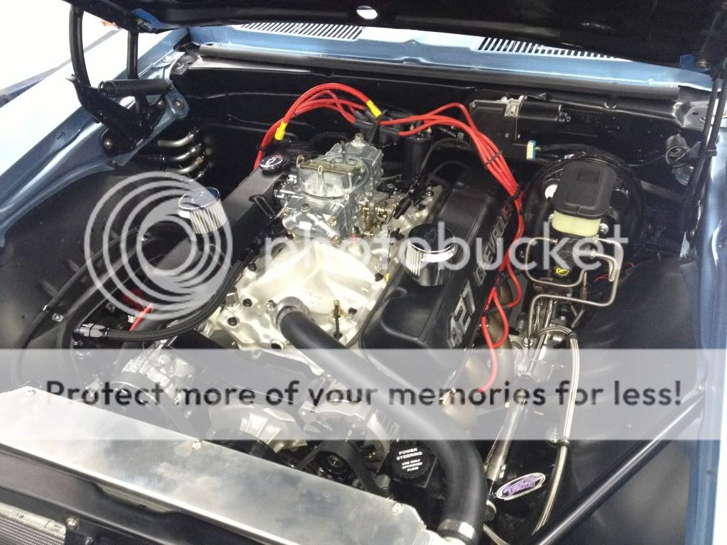

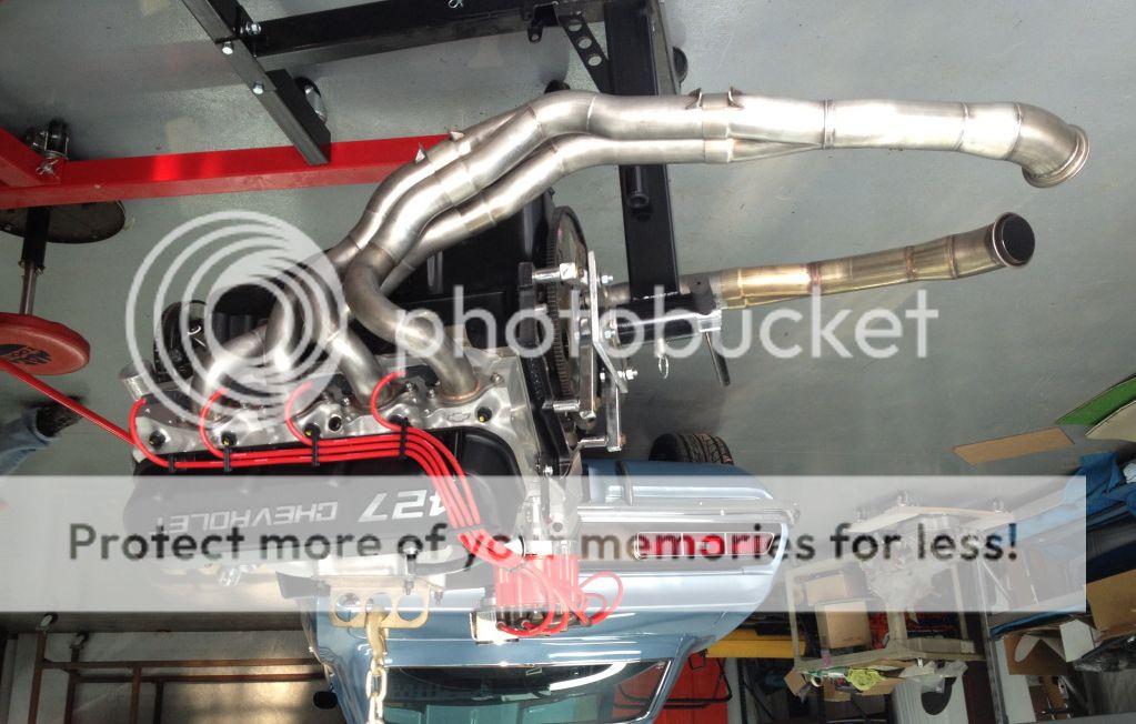

Its been awhile but Im making some progress again. Here a couple of engine pics with mock up of stainless headers and dash installed
This is the ZZ427 crate engine that GM says is 480 hp and 490 tq. I dynoed it last Sat and it made 526 hp and 518 tq.
I changed the oil pan and added a very good Miledon windage tray, used the tri-y headers shown and a 1" carb spacer. Spacer added 10 hp and 9 lbs tq.
http://i416.photobucket.com/albums/p...y2451858PM.jpg
http://i416.photobucket.com/albums/p...y0365345PM.jpg
http://i416.photobucket.com/albums/p...r2440531PM.jpg

Those headers are pretty badass, are they custom made?

Thanks. I bought them used. They were custom built by Calvin Elston who builds headers for pro stock and NASCAR. They are made from burns stainless pieces and are a tri-y (4-2-1) design. Each pipe is individual.

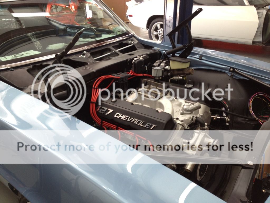

Installed engine and trans
http://i416.photobucket.com/albums/p...y2640157PM.jpg
http://i416.photobucket.com/albums/p...y2644040PM.jpg
Stance is getting there. :yes:
http://i416.photobucket.com/albums/p...y2644109PM.jpg

Thanks Jeff. I want the engine bay to look semi-factory with not all the bling. I know its not LS, but since the car was an original BBC, I went back BB with just a few added cubes. :yes:

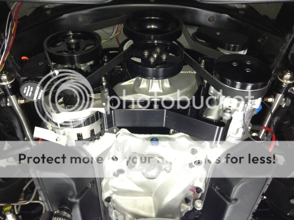

Jay Hilliard 06-08-2012 07:39 AM
VA frontrunner installed
http://i416.photobucket.com/albums/p...n0772206PM.jpg

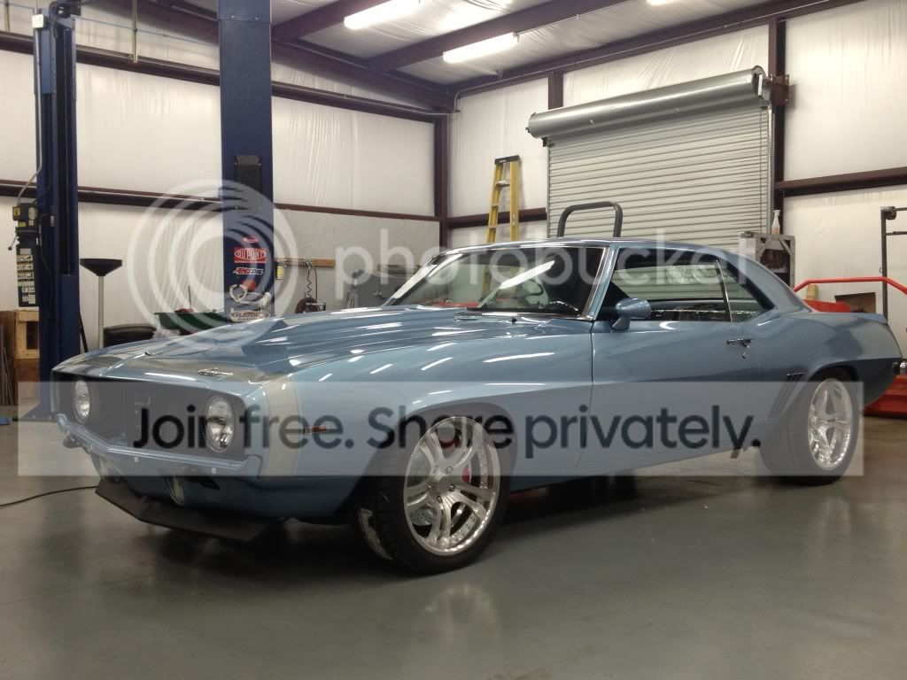

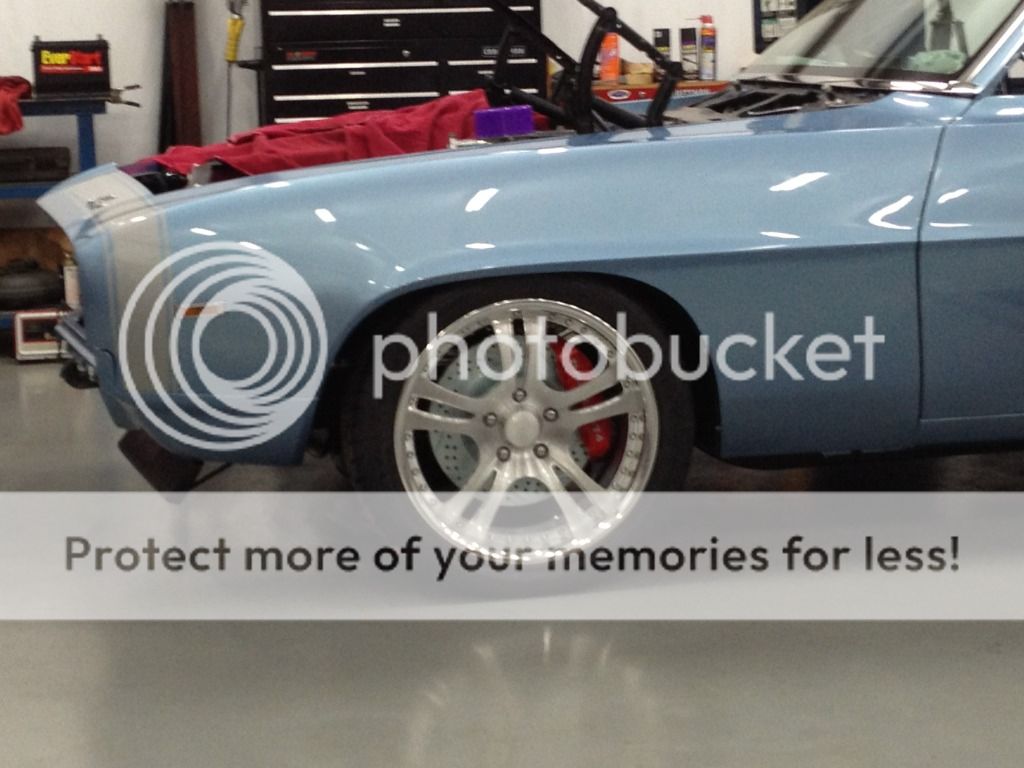

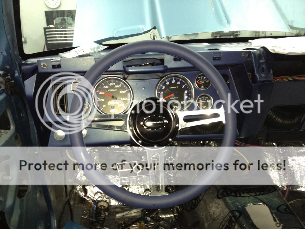

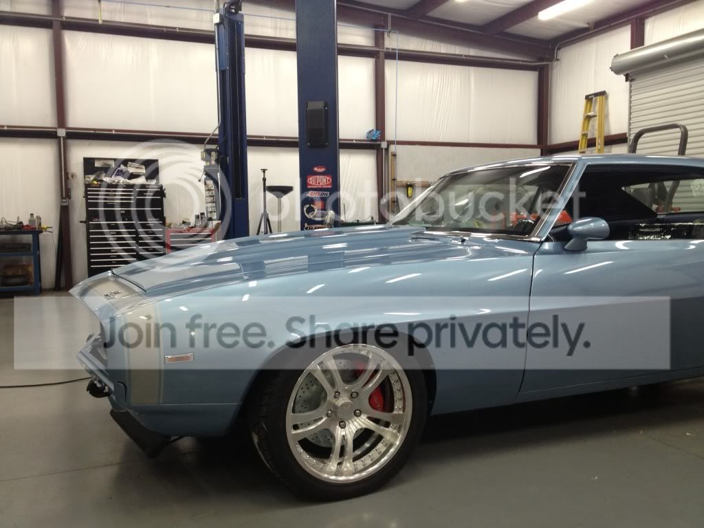

Jay Hilliard 12-27-2012 12:39 PM

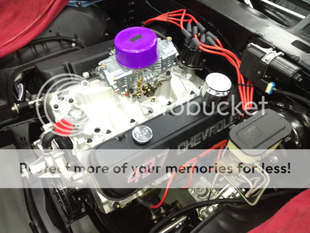

Been awhile...
but making some progress.
http://i416.photobucket.com/albums/p...c2642912PM.jpg
http://i416.photobucket.com/albums/p...c2643004PM.jpg
http://i416.photobucket.com/albums/p...c2642944PM.jpg
