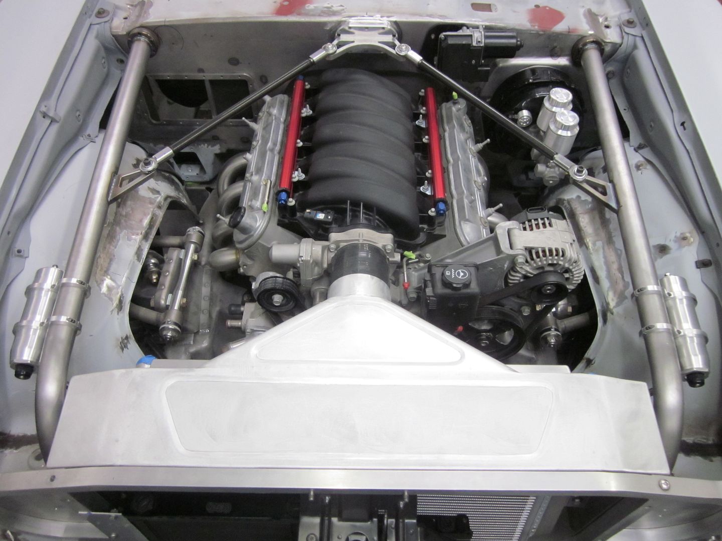

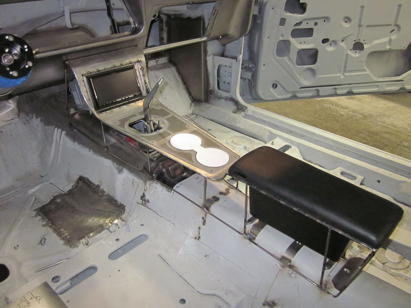

Cris@JCG 04-21-2011 08:41 AM

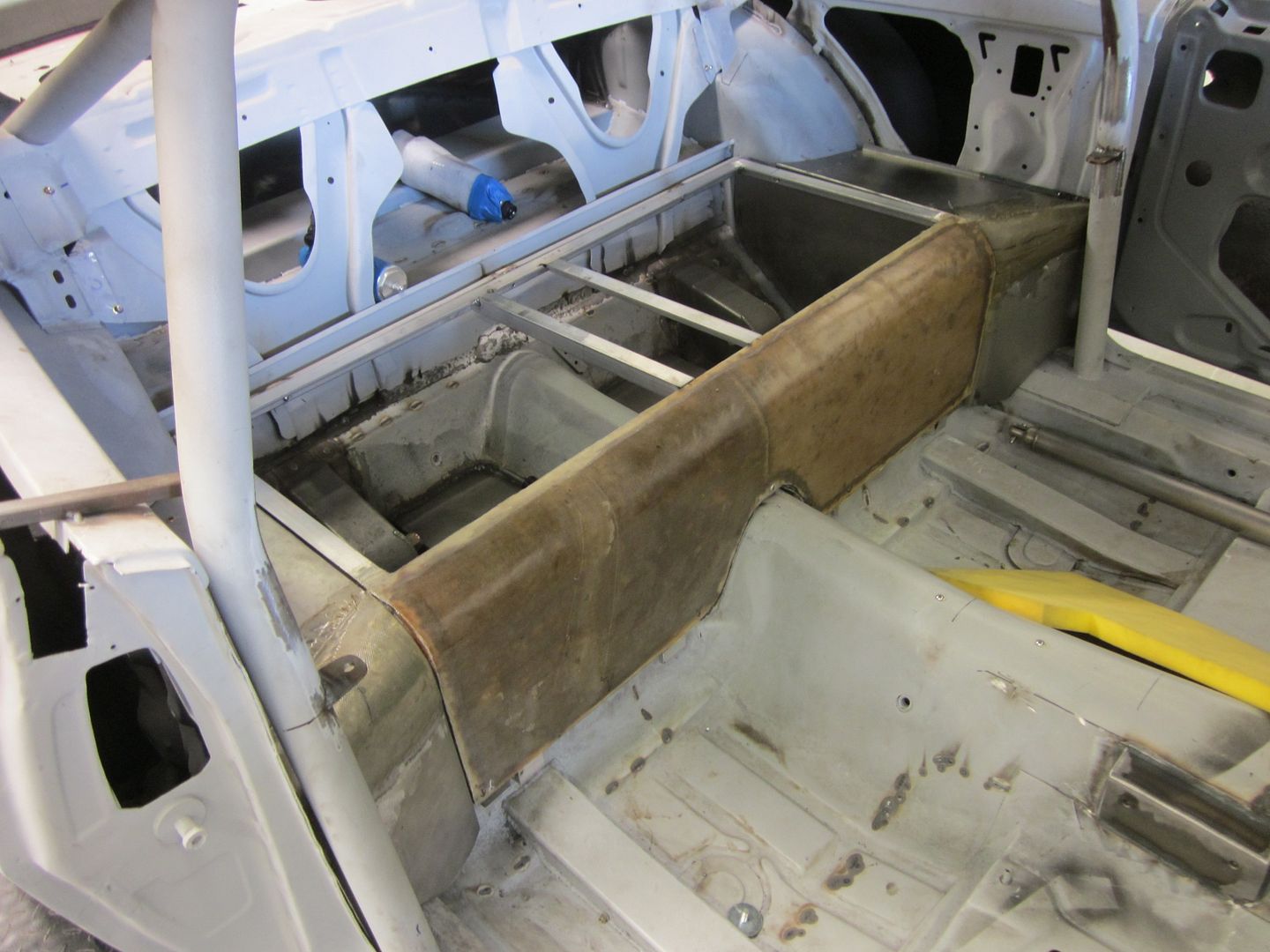

Ok Ron! here are some pics..
We are working on the rear interior pcs. with Eric Thorsen..
http://i1015.photobucket.com/albums/...n/IMG_1061.jpg

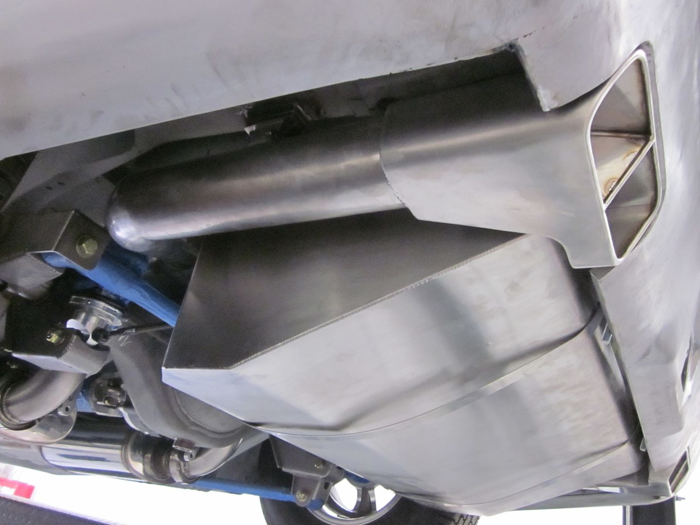

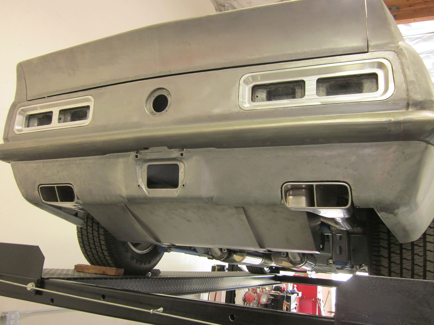

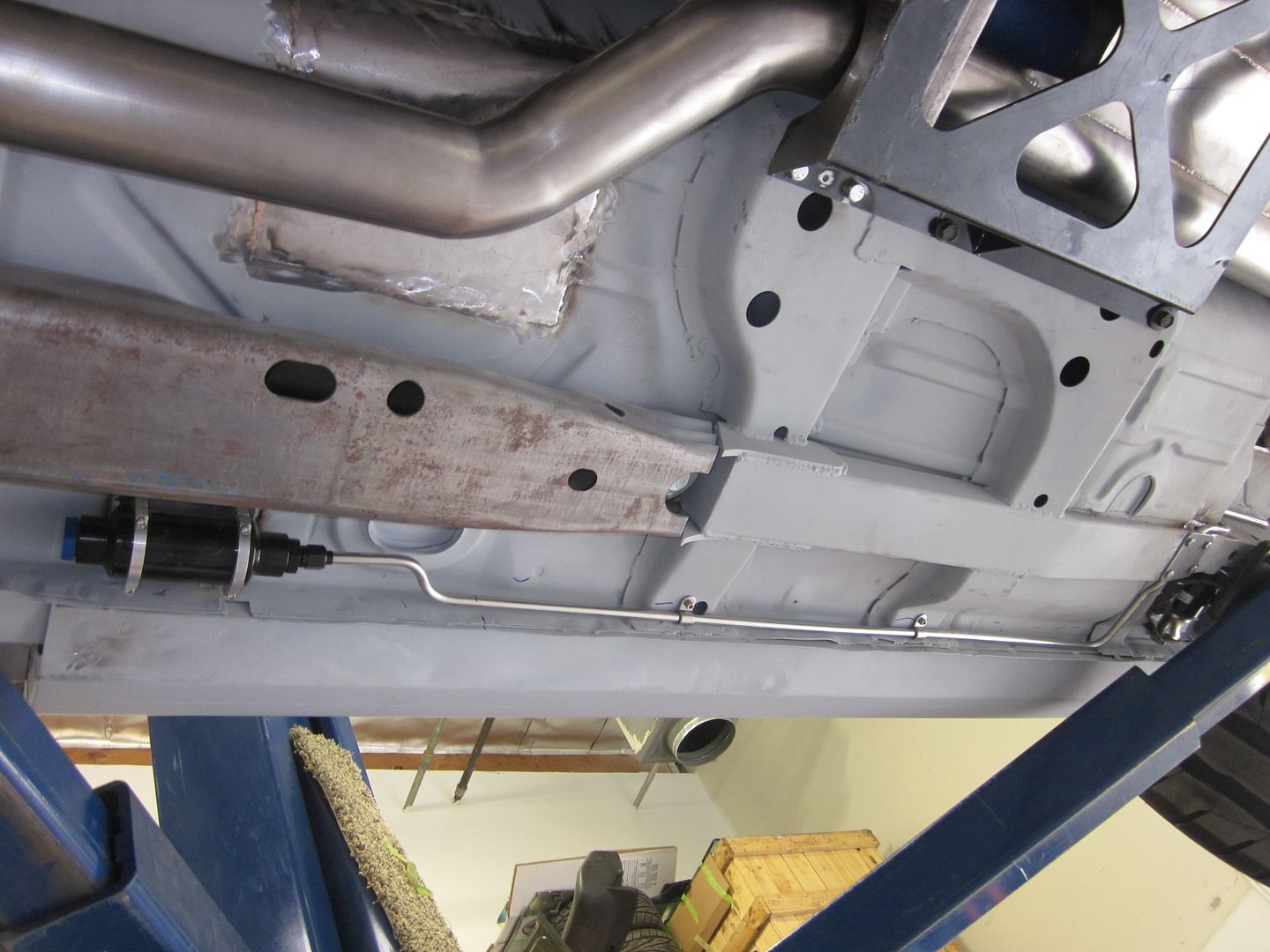

Some exhaust pics..
http://i1015.photobucket.com/albums/...n/IMG_1062.jpg
http://i1015.photobucket.com/albums/...n/IMG_1064.jpg
I will explain this one later :D :D
http://i1015.photobucket.com/albums/...n/IMG_1070.jpg

wow, that exhaust looks good. that tight area must have been a real joy to work the pipes thru. talk about hours of work!

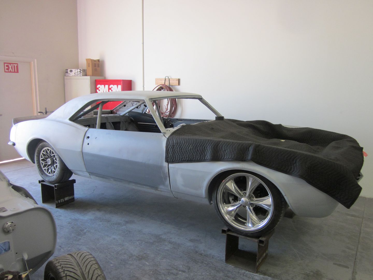

Cris@JCG 05-04-2011 09:29 AM
Staged in the body shop!
http://i1015.photobucket.com/albums/...n/IMG_1107.jpg

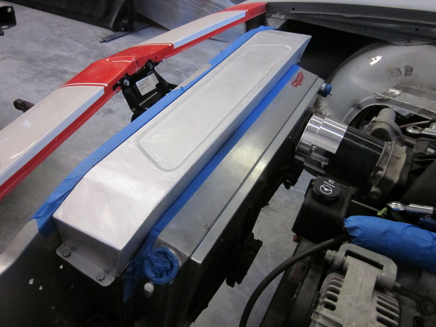

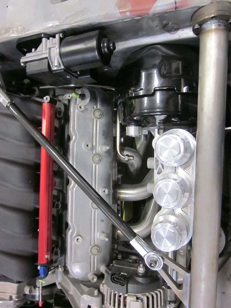

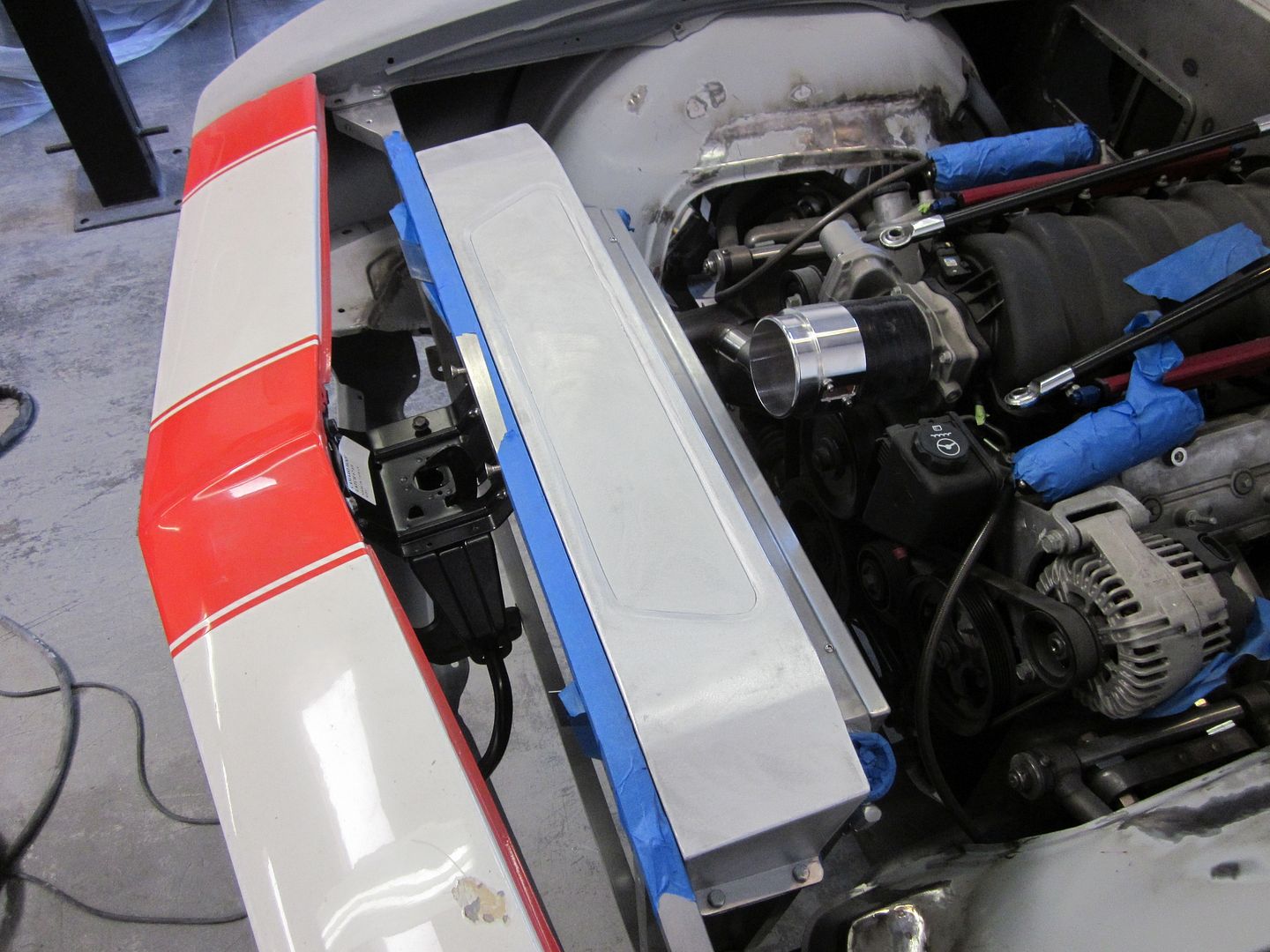

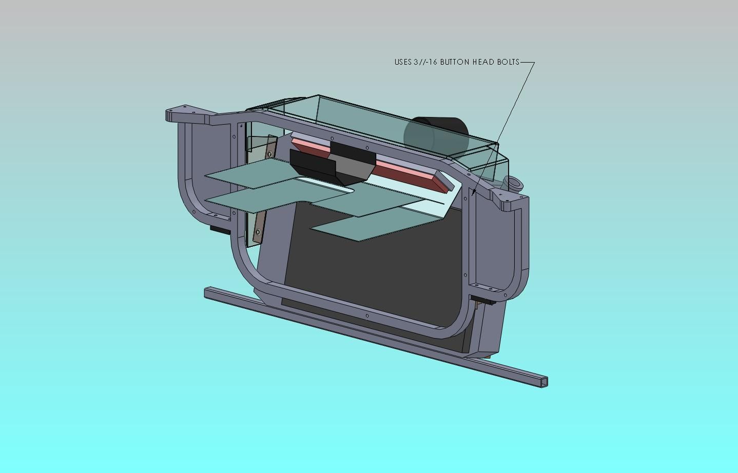

Cold Air Box!
Here is a little update!
http://i1015.photobucket.com/albums/...n/IMG_1143.jpg
http://i1015.photobucket.com/albums/...n/IMG_1146.jpg
Rough sketch!
http://i1015.photobucket.com/albums/...ator_Assem.jpg

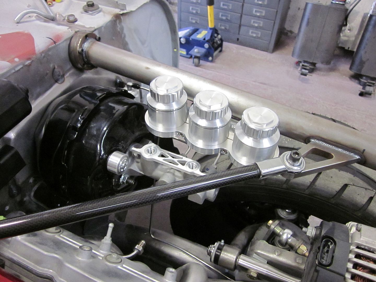

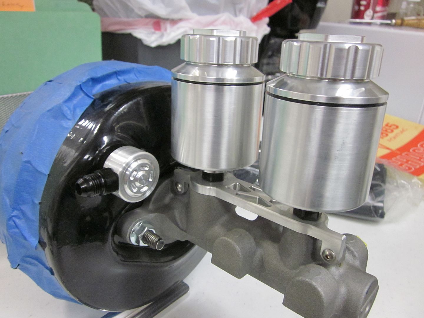

Booster Check Valve!
Ok Traven.. We are done dressing up this booster master cylinder set up! :D
http://i1015.photobucket.com/albums/...n/IMG_1159.jpg
Originally Posted by T_Raven (Post 336061)
Reservoirs look great. you've gotta get rid of that ugly plastic piece for the booster vacuum line and make an aluminum one lol.
T_Raven 05-14-2011 02:33 PM
Nice! That looks really good.....but uh.....now you gotta do something about that ugly cast master cylinder ahahaha

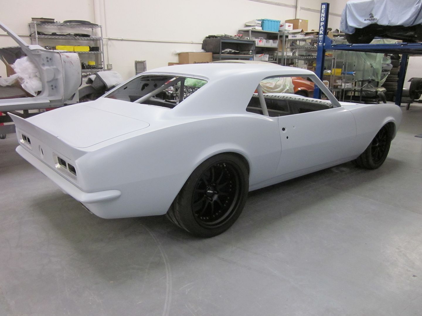

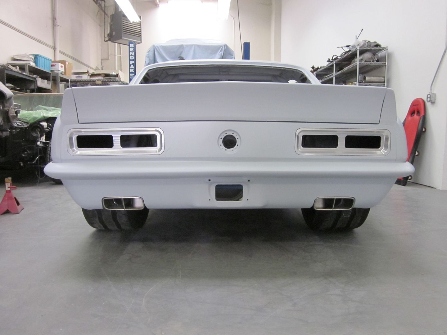

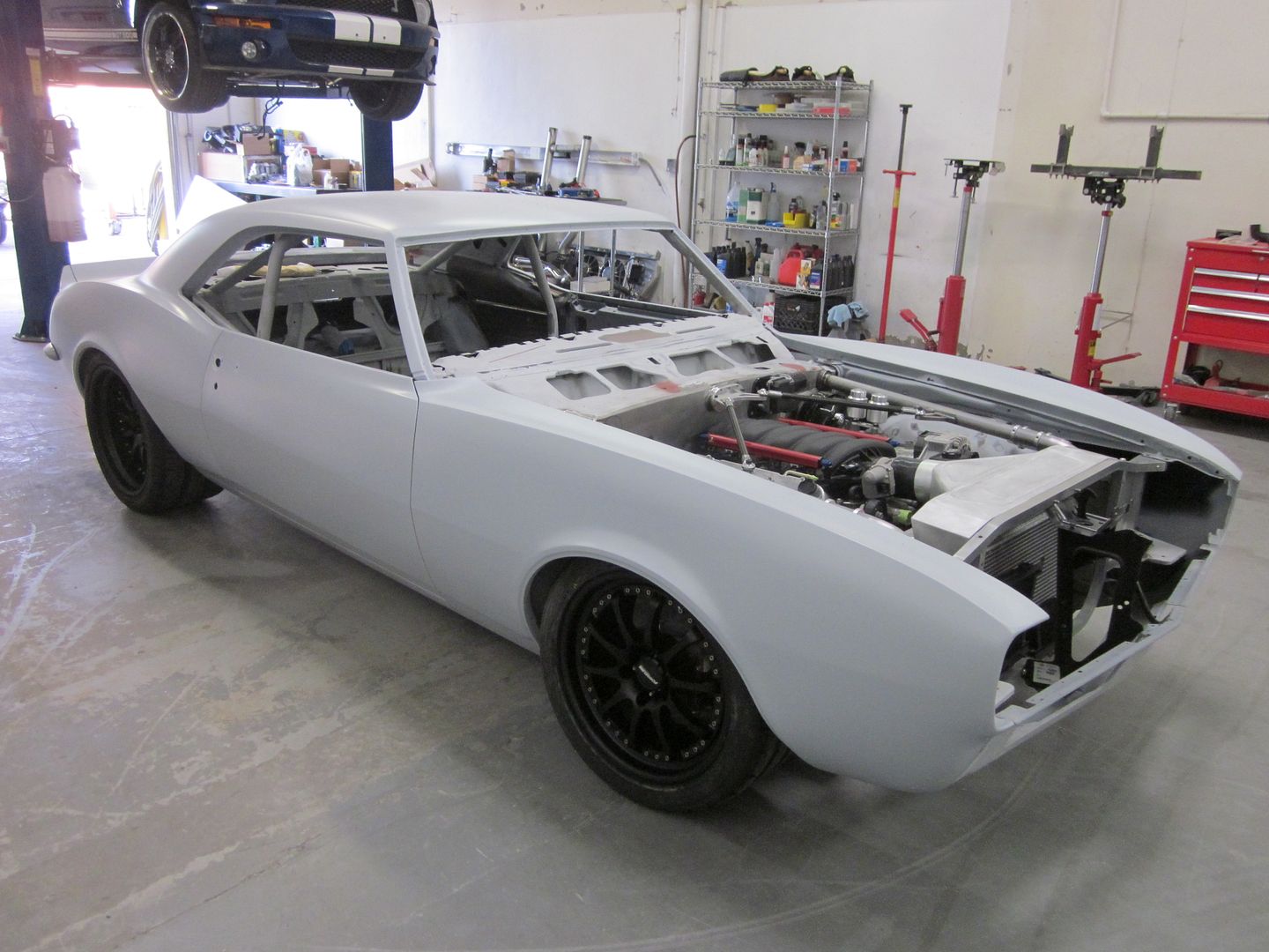

Some progress!
Got the new Forgeline wheels yesterday.. & the we are about 80% on the body work...
http://i1015.photobucket.com/albums/...n/IMG_1236.jpg
http://i1015.photobucket.com/albums/...n/IMG_1234.jpg
http://i1015.photobucket.com/albums/...n/IMG_1237.jpg

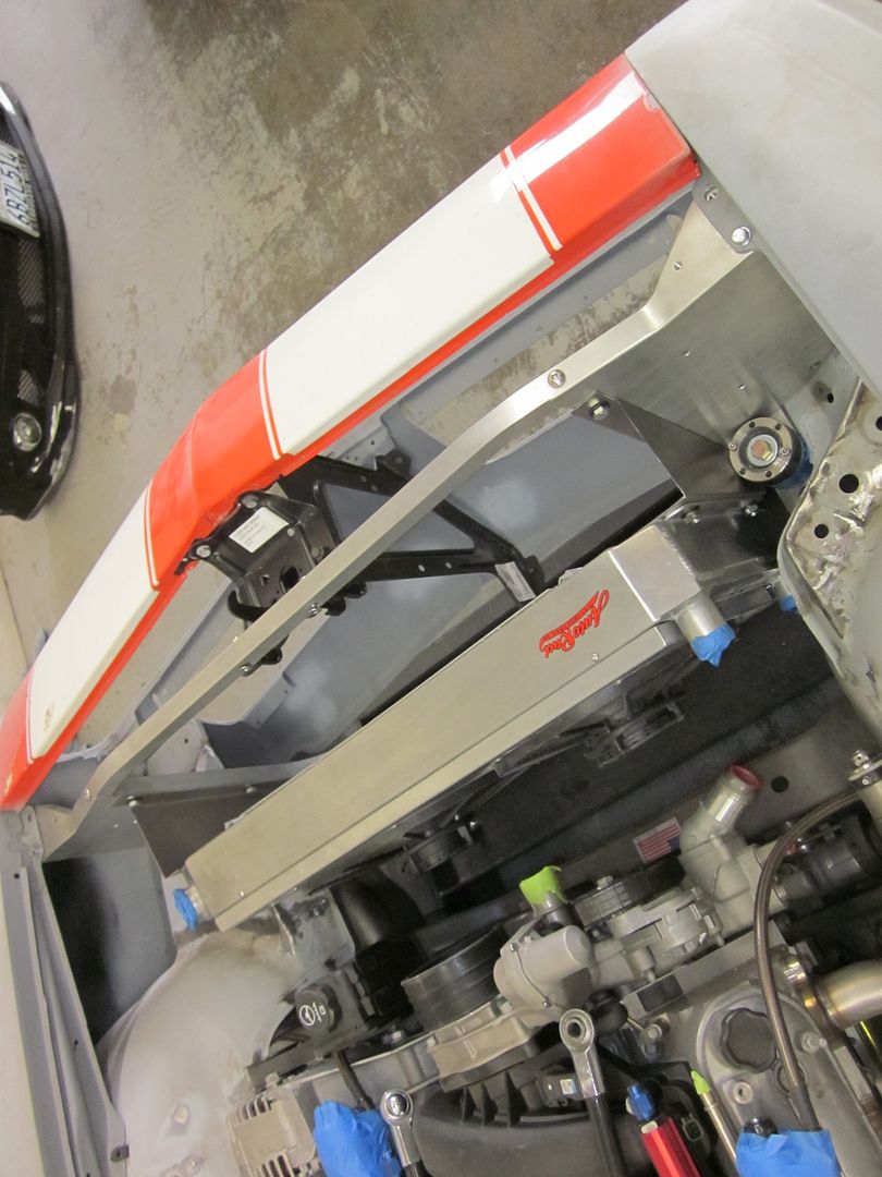

Plumbing this week! Gonna run out of engine compartment space!
http://i1015.photobucket.com/albums/...n/IMG_1238.jpg

Yes! We did stretch the fronts.. 18x10 with 285-35-18.. & still have plenty of room.. Got a few more custom parts coming on the plumbing..

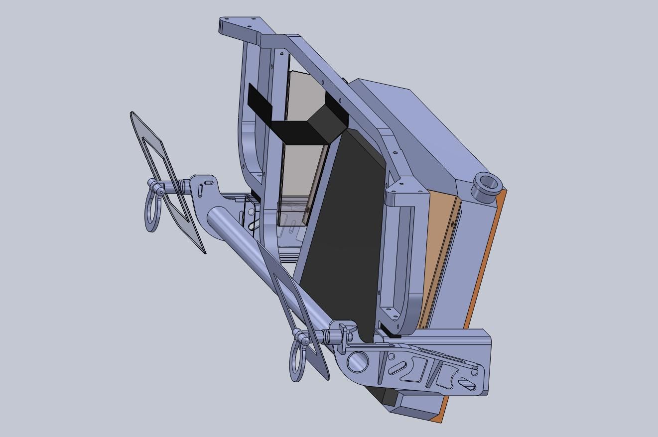

Hidden front Bumper!
This car 68 will driven alot.. & since we removed the front bumper from the exterior... We are making one that will be on the inside of the lower valance & also will retain the fold down tow hooks.. but I am also thinking it will also hold my oil coolers & cold air induction coming in from the grill.. Maybe! :D
http://i1015.photobucket.com/albums/...Hook_Assem.jpg

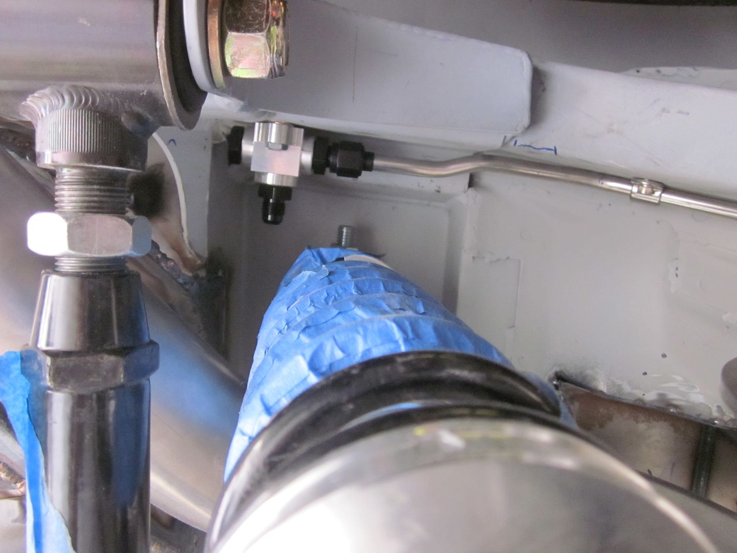

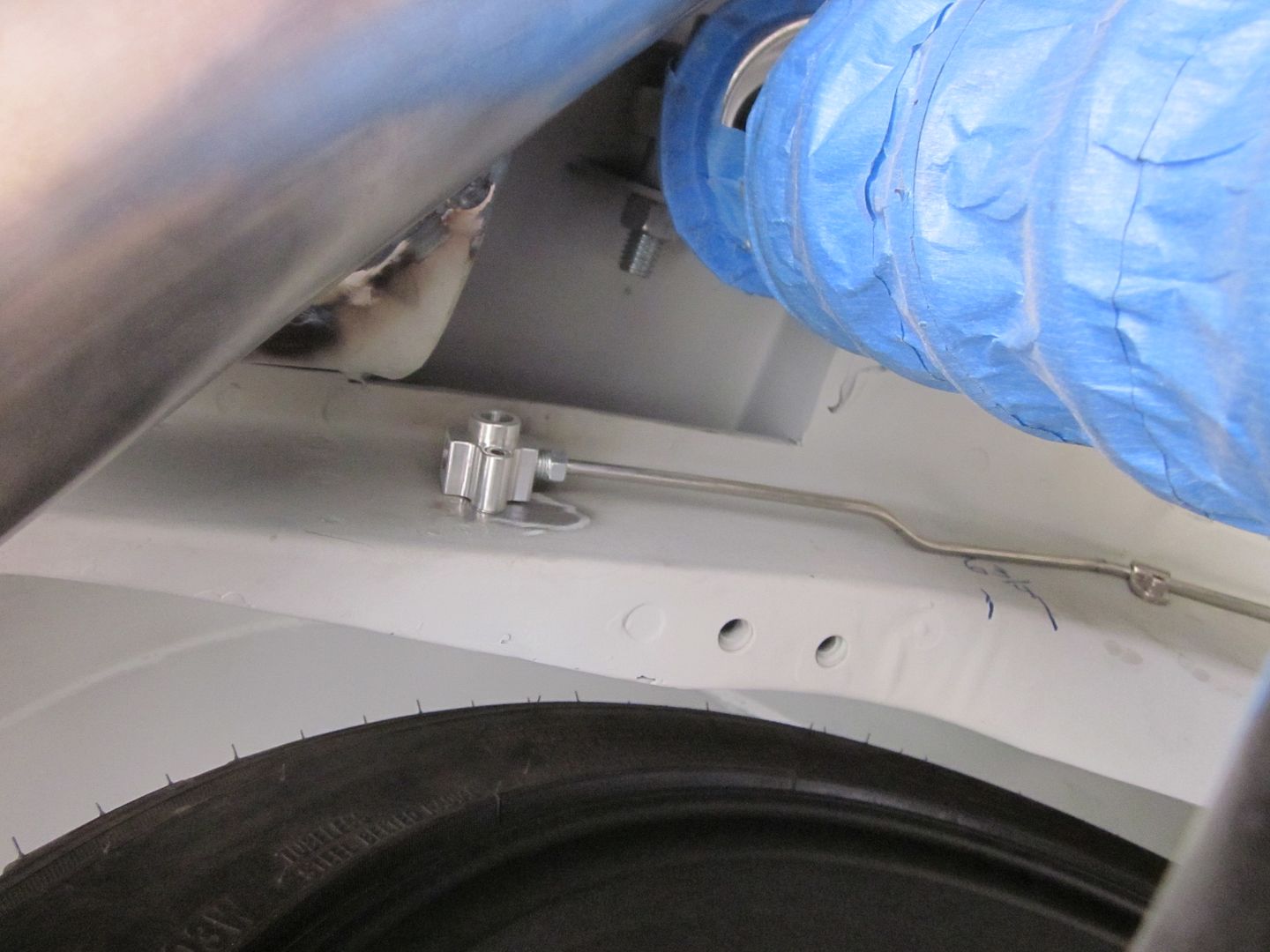

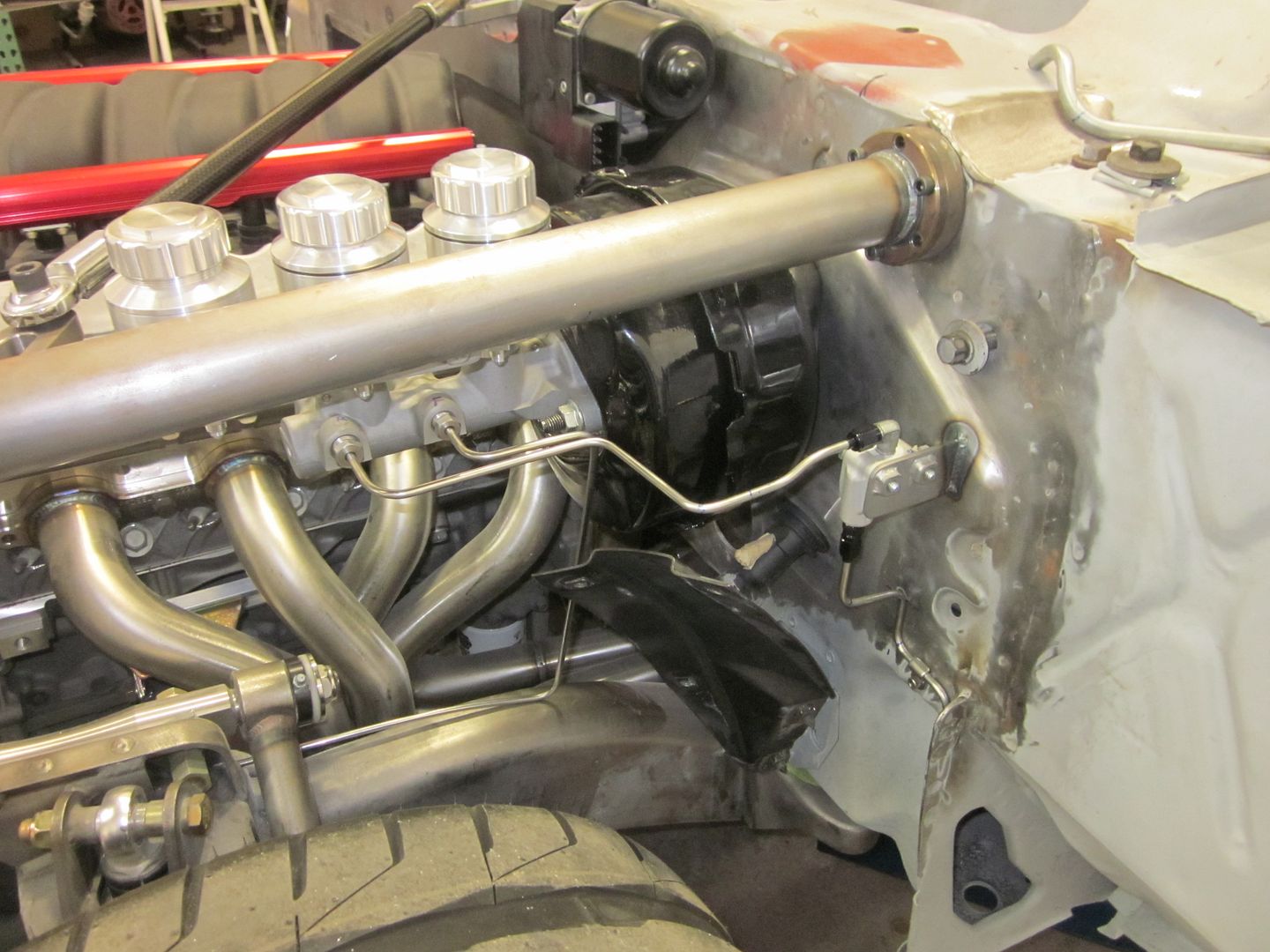

Some plumbing progress
We are a little behind schedule on the plumbing.. We had to work all the front of the car with the grill , header panel & lower valance with headlight buckets for nice fit..
Here are some progress pics on the plumbing... We have been getting allot of custom fitting done lately with distribution blocks.. My machinist is on vacation & fishing somewhere Arkansas... But have a list of more fitting I need.. like a stainless 3/8 tube bung to -8 male.. I try to avoid using pipe plugs whenever we can.. & use o-ringed fittings with either BUNA, Viton, or EPR o-rings... Got an idea on how we are going to do the valve covers for breathing with reservoir tanks for P/S & overflow tank with surge..
Just a few more custom pcs... & I am done.. I think!
Could not find a location for the clutch reservoir without burring in some location that you could not get too.. changed all reservoir locations with mounting..
http://i1015.photobucket.com/albums/...n/IMG_1264.jpg
http://i1015.photobucket.com/albums/...n/IMG_1265.jpg
http://i1015.photobucket.com/albums/...n/IMG_1266.jpg
http://i1015.photobucket.com/albums/...n/IMG_1268.jpg
http://i1015.photobucket.com/albums/...n/IMG_1269.jpg
http://i1015.photobucket.com/albums/...n/IMG_1270.jpg

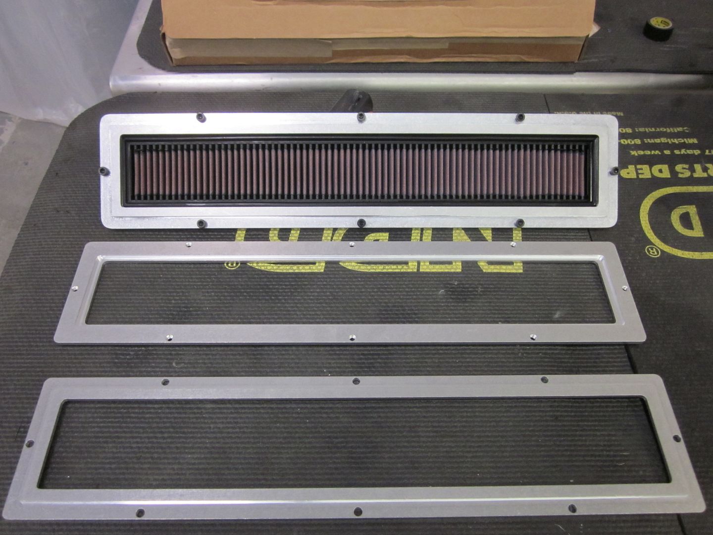

Air filter retainer!
http://i1015.photobucket.com/albums/...n/IMG_1267.jpg
